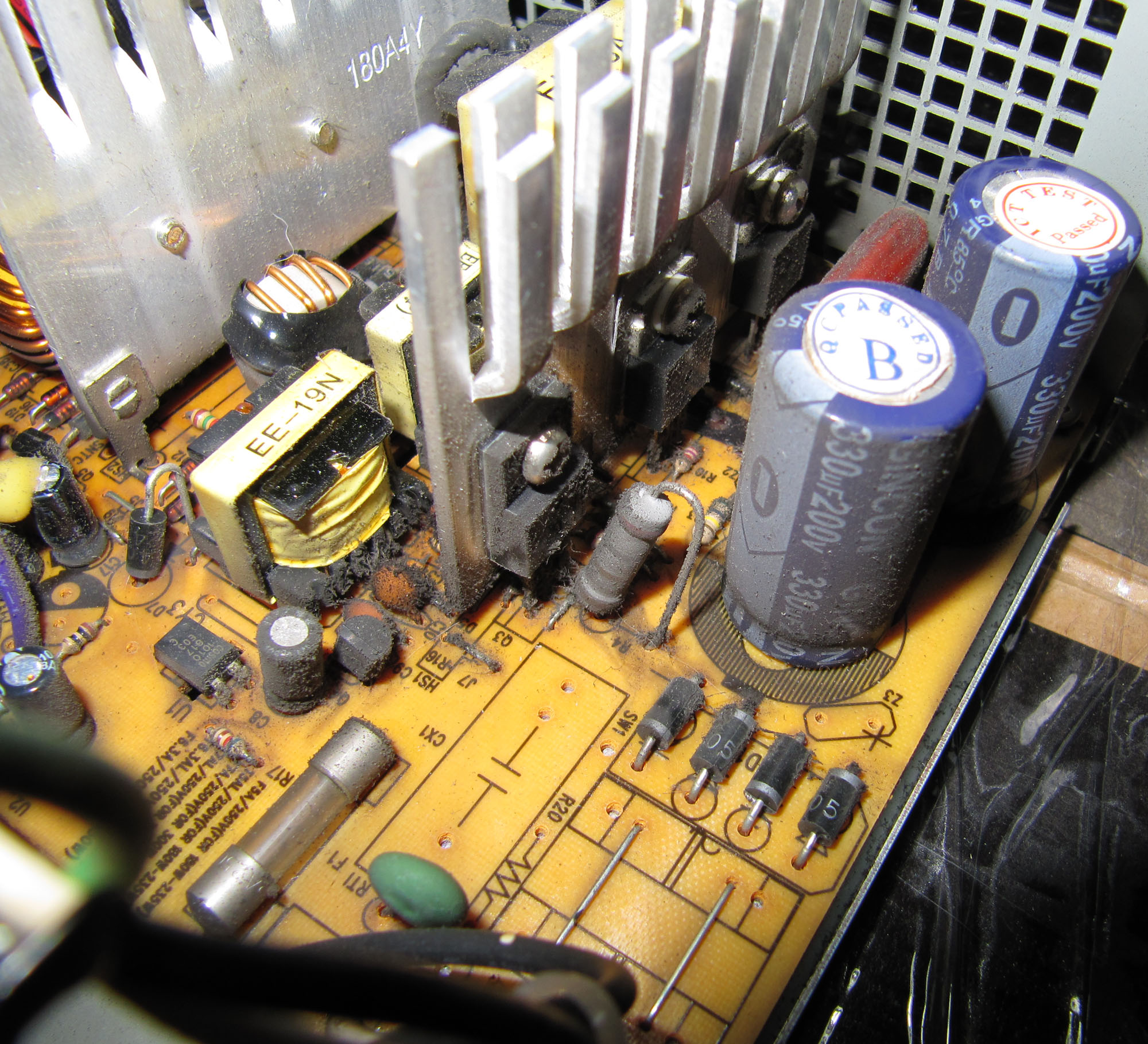

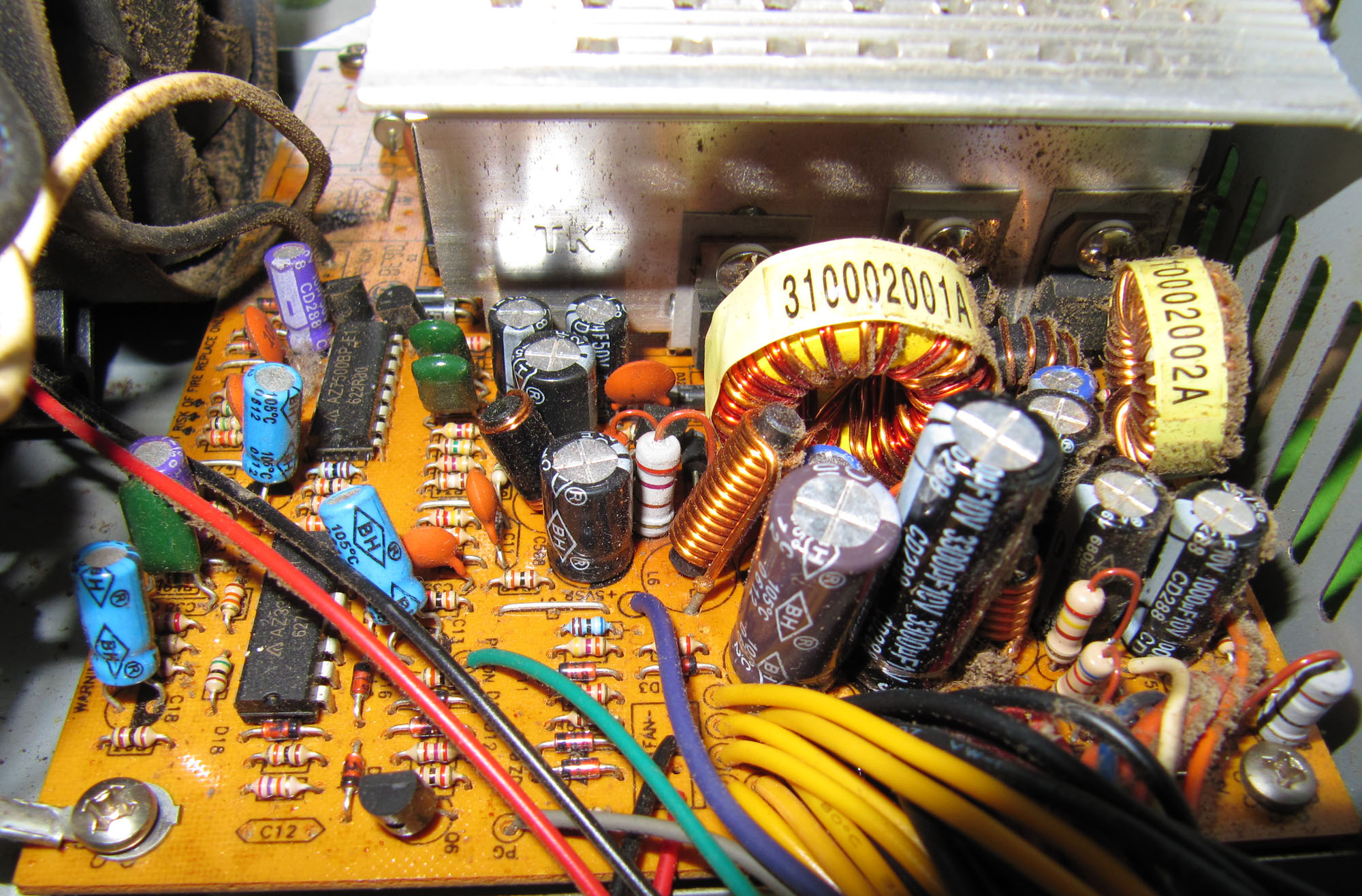

                    Re: the gutless, bloated, and fried power supply hall of shame
                    Excellent Power IT ATX 350
                    But I couldn't find anything excellent about this psu.
                    It's a Deer, the 2003 platform with the 2003 chip of the year.
                    The fan seized, the 12V output uses the 2 diode on a bracket treatment, some caps bulging, but the thing still works!
                    SB1040CT for 3.3V
                    sbl1640ct for 5V
                    2x 13007 main switchers
                    and 2x 330uF 200V ultra small primary capacitors.
                    And of course a lot of space on PCB for extra caps and coils that have not been installed
                          Top Power 500W
                          Not to be confused with topower OEM
                          Another boring cheap psu.
                          But I really like the names they give their fans. This is the Bestcooler fan brand.
                          Did you notice anything unusual? The primary caps are Chemicon 200V 680uF .
                          I put those out and tested them some time ago. Those are fakes. Real C was a lot smaller than the rated.
                          Someone stole the input filtering because the psu doesn't have any.
                          Nice that they put a proper bridge rectifier...
                          And pi coils on all output rails (hope they are not fake ).
                          the main switchers are 2X d304x , probably good for 300W.
                          5V and 3.3V have 20A schottky rectifiers but 12V has ultrafast 16A rectifier. This is really bad for a modern power supply.
                          Also, notice the big resistor next to the PWM IC getting too hot and discoloring PCB.
                            That nameplate is a legend, it shows the fake rating of 5v in one column and then the real 5v rating in the next column?
                            Also the S, N and FI ratings are very obvious fakes.
                              I think the second "+5V" column is for the -5V output. IMO, the chances the -12V and -5V outputs are capable of 1A are pretty low if they are regulated by a 78xx 3-T regulator.
                              The Semko and Nemko marks are pretty badly done, .
                              I'd guess the realistic output power at 250W-300W. Do NCC KMH series large-can lytics have black sleeves? Or the usual NCC brown?
                              PeteS in CA
                                Yup.
                                Bad caps on the 5VSB output will do that to a 5VSB circuit with a 2-transistor design. Usually, the 5VSB will start to "loose" voltage/regulation, but the secondary-side auxiliary that feeds the PWM controller will go up and up and up until the PWM bites the dust. The secondary-side aux. rail is typically anywhere from 12-20V on a properly-working 5VSB (that has a sec. side aux. rail.) On a 5VSB with bad output caps... well... conisder this: DBL494 / KA7500 PWM controllers are rated for up to 42V DC input and usually have a "dropper" resistor right before them and the sec. side aux. rail. So for that "dropper" resistor to burn or for the PWM IC to burn, imagine how much higher the voltage goes.
                                That's why I never ignore bad caps in a 5VSB circuit on a PSU I care about. Even if they test good, leaving potentially crappy brands on the output of a 2-transistor 5VSB circuit is pretty much playing Russian roulette with the PSU (and sometimes the attached hardware too.)
                                  QFT. Almost all Deers I have sport either Sanyo, Rubycon, Nichicon or UCC KZE in the 5vSB section. At least if anything fails first, it ain't gonna be the standby rail.
                                    T&P-LIW Meiji-420 ATX
                                    No name junk psu.
                                    The input filter is missing and the fuse is blown.
                                    The shape of the legs of the 4 diodes is interesting.
                                    All the output rails rectifiers are rated for 20A continuous but 12V is BYV32E-200 ultrafast, not schottky.
                                    I can see some pin coils on the output rails.
                                    main switching NPN transistors are 2x 13007
                                      There is a hole in a resistor on the primary side here, under the heatsink.
                                      Really beautiful fuse, they cause so much mayhem when they go like that lol!
                                        PhotonicInduction to fuse: "I popped it!"
                                        Curious what the failure was.
                                        Garbage PSU is garbage, though.
                                        Like the rest of these, I suppose:
                                        https://www.badcaps.net/forum/showth...&highlight=KYS
                                        But, hey, at least you can scavenge some 20 Amp rectifiers out of the one here now.
                                          The thing's 13 or 14 years old (PCB datecode 0638), so it lasted a while. But the heatsinks and main transformer put it in the 200W-250W range, IMO. It's be an EMC nightmare, and the output noise probably sucked.
                                          I'm going to guess one or both of the 13007s are silicon slag inside. That glass fuse (!!!) met a violent end.
