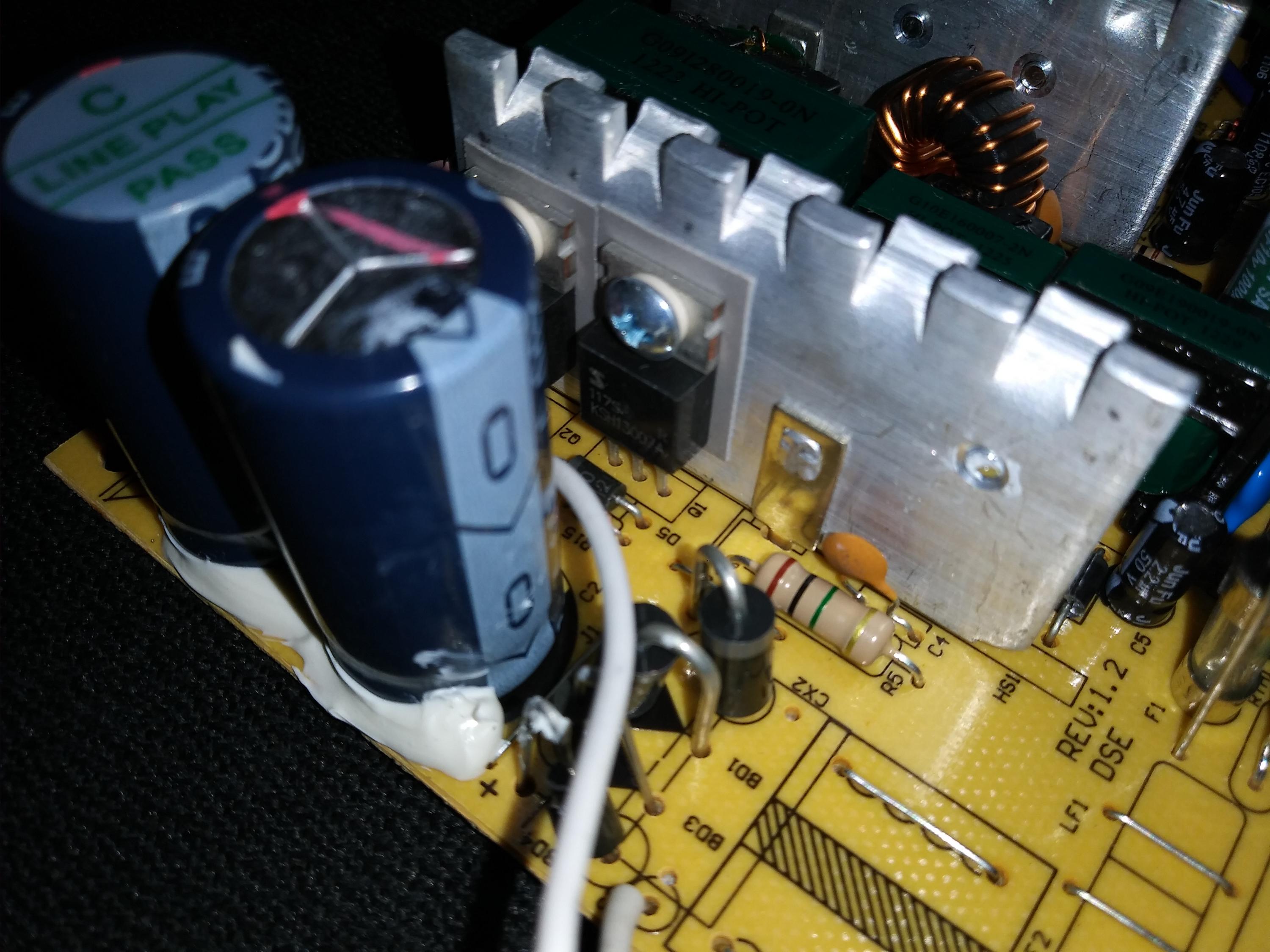

Primary Side.....................................
There are no X-Class or Y-Class capacitors.
There is no Common mode choke or PF coil.
The rectifier consists of 2 1N5406 diodes and 2 RL205 diodes.
The primary caps are 2 gun RM 330uf 200v.
The switching transistors are 2 KSH13007A's.
The 5VSB Mosfet is an SMK0260.
Secondary Side...........................................................
The 3.3v and 5v rails use 1 S16C45C while the 12v rail uses 1 STTH1002CT.
The 3.3v, 5v and 12v rails all use 1 Junfu HK 1000uf 16v capacitor with no PI coils.
The -12v rail use 1 Junfu HK 470uf 16v capacitor with no PI coil.
The 5VSB rail uses 1 Samxon GF 1000uf 10v and 1 Junfu HK 470uf 10v capacitor with a coil between them.
The 5VSB rail uses 1 SB340 diode as a rectifier.
The Fan..............................................................................................
I'm not sure if this fan is a clone/knock-off as i can't really find any info about this type and the model number is in use by another fan that looks very different from this one.
Overall, this PSU is pretty mich a peice of trash.

Oh man, this thing is frustrating to look at. The soldering and overall build in terms of how things are put together doesn't look that bad. But why such crap undersized components? Just look at that output toroid, for example - it's the tiniest I have ever seen in an "ATX-capable" power supply ever. This thing wasn't made with just cost-cutting techniques in mind. It was purposefully made to be a useless POS from day one.

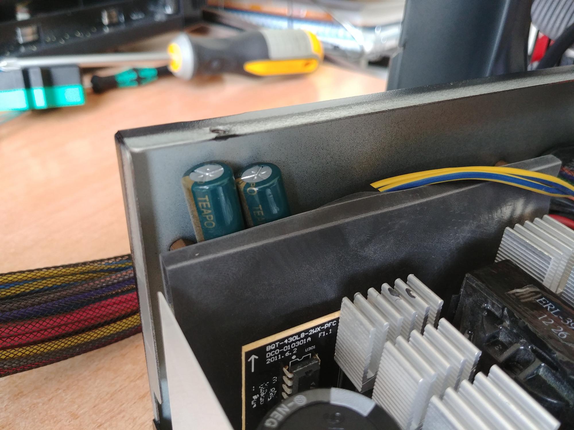

Hello, I share these photos of this PSU Be Quiet Pure Power L8-CM-530W 80Plus Bronze, which I took from a Spanish forum, the photos belongs to bmdm (he granted me permission to publish his photos), I do not say the name of the forum to avoid spamming.
The fact is that this source ERL39 burned the coil, how is this possible? I had never seen anything like it.
Its owner, began to realize that the source began making strange noises, after a while the system was turned off, and came a moment that began to give errors on the HDD, and eventually stopped working.
