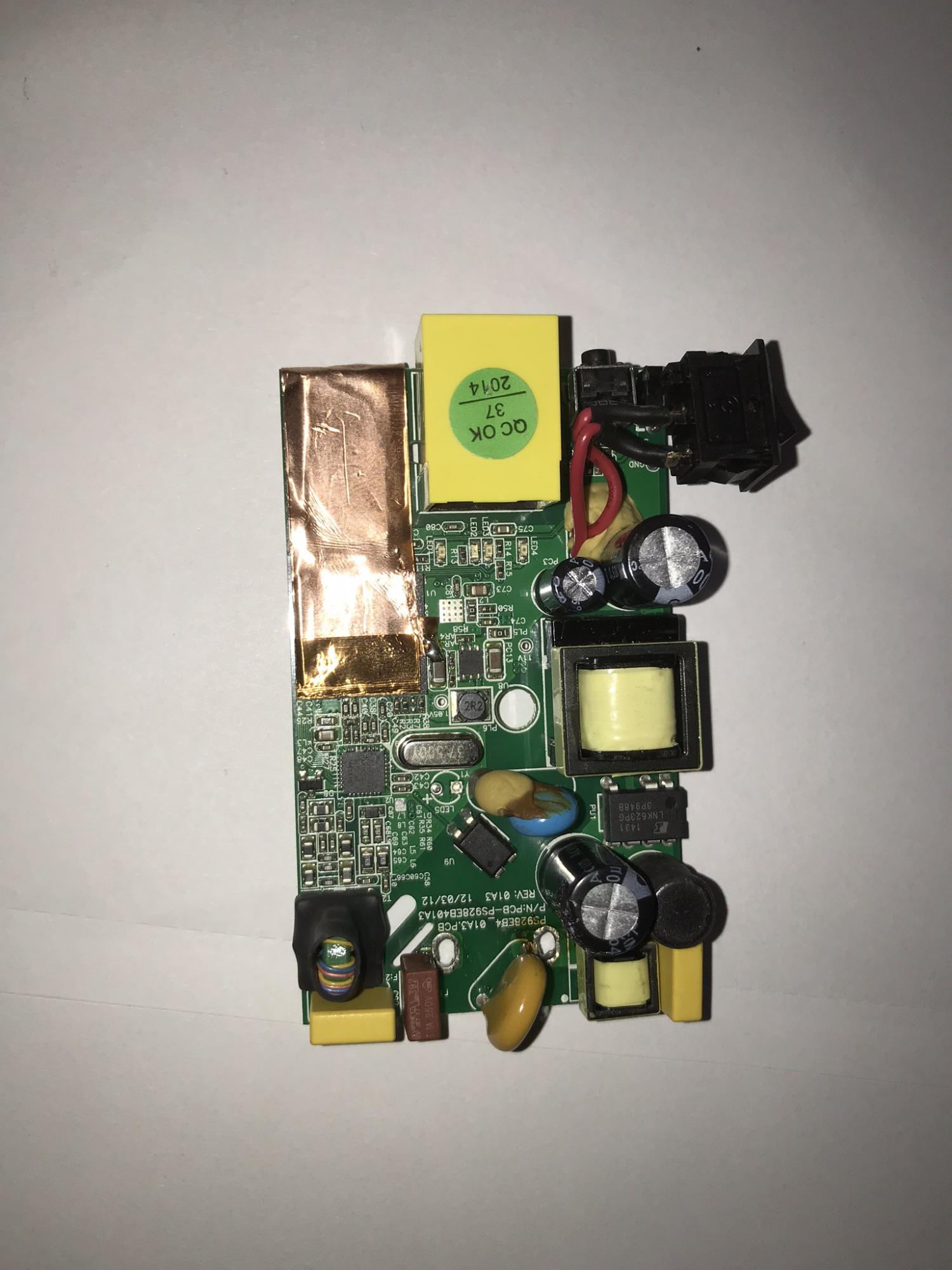

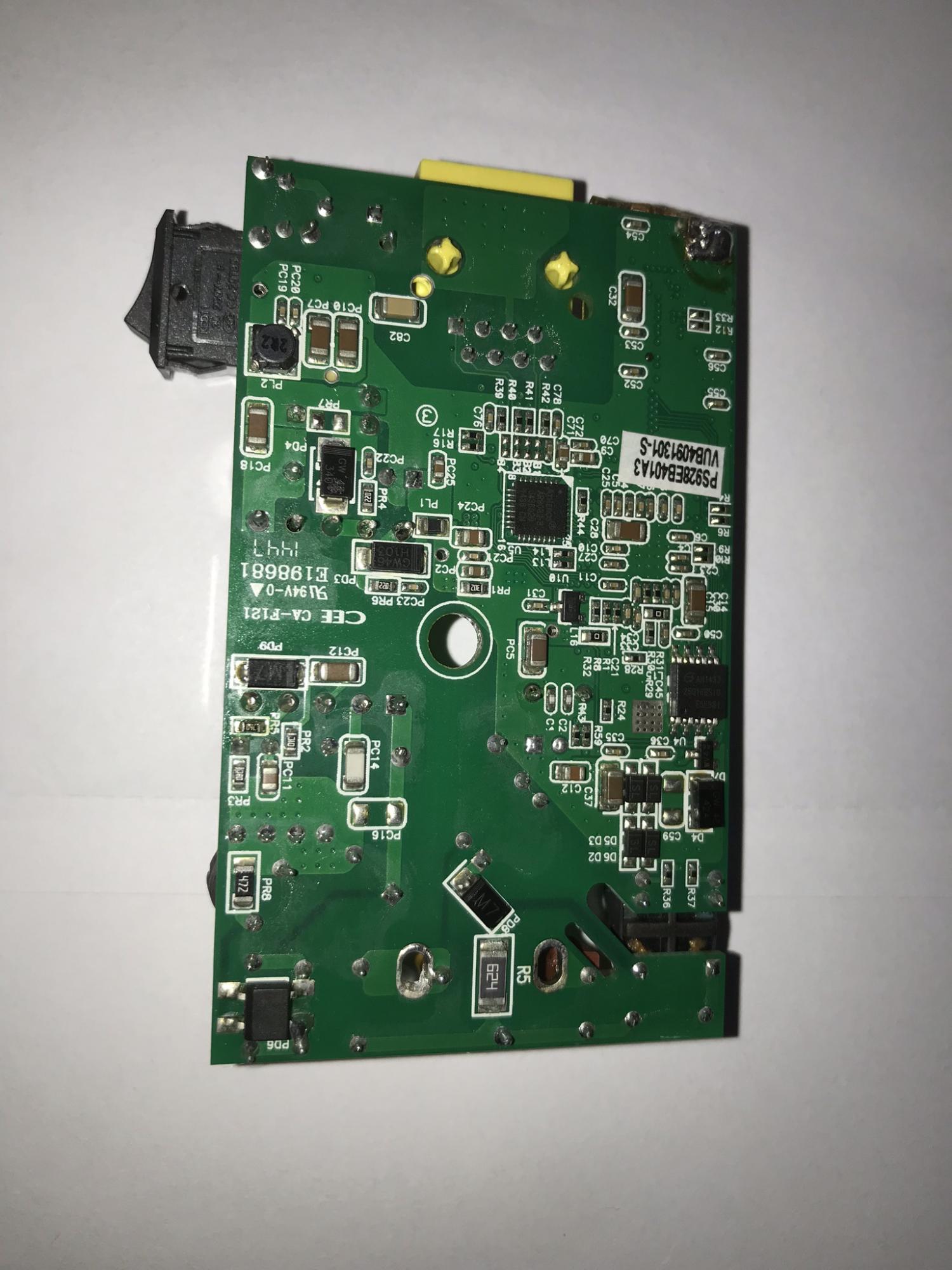

    Im trying to repair a D-Link(DHP-300AV) powerline adapter which is not powering up.
    I've only done some basic tests at the moment to confirm its getting mains in through the fuse which it is. All caps dont show any sign of buldging.
    The power supply seems to be based around a LNK623PG as can be seen in the images attached.
    Can anyone provide any trouble shooting steps to try and diganose whats causing the no power issue.

    You can look at the datasheet of the LNK623PG to get an idea.
    But with these units running as hot as they usually do they often bake the capacitors.
    So just replacing them without much other tests might be worth it.

        No it means it can perform regulation without any "real" (expensive) sense logic.
        But you do have an optocoupler on your device (U8) so might not follow the reference design.
        That said I was unable to trace where it goes so maybe it is for something else.
        In your seat I would replace the caps, Acon is a shit brand and it would not be uncommon for them to fail.
        But if you want to do some checks just see what output voltage you have on the LNK chip, and on the caps and see if it makes sense.

          Did you check resistor R5 (624) to see if its resistance has gone up?
          That resistor and the Diode PD8 look to be for Brown protection that will shutdown the LNK via OPTO.

            I've checked the resistor and it seems fine giving a reading of 619 K ohm's
