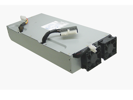

          >>PSU board is at the TV shop i used to work at right now<<
          You have the case?
          What's the Apple part number and the manufacturer's model number?
          Toast
          This one?
          [EDIT: Added Pic ]
          veritas odium parit
          • MadSkillzMan
            • Nov 2009
            • 5
            Re: Dual G5 Psu (LiteON)
            Ok guys,
            Its the LiteON 600Watt Tesla Converter
            Part No: 614-0307

                            I have a Liteon 614-0307 with a burned resistor and as other posts I need a value of that part. I'm hoping that maybe someone has one and could check R302 for a value. I would be eternally grateful.
                            • Toasty
                              • Jul 2007
                              • 4171
                              What's the "real" model number. PA-###.....
                              There's also an API # on the board. What is it?

                                Thanks for your reply! Model # Is PA-6601-1A On the board I don't find an API#. The only numbers I can find are 0509, It also says REV:A, Q77 April/23/2004.
                                • Toasty
                                  • Jul 2007
                                  • 4171
                                  Excellent. 100Ω, fusible, 3 watt
                                  You have more issues if that is fried.
                                  Search the forums using the Advanced Search for *6601* and select "Titles Only" button at bottom.
                                  Here's one to get you started: https://www.badcaps.net/forum/showthread.php?t=8925
