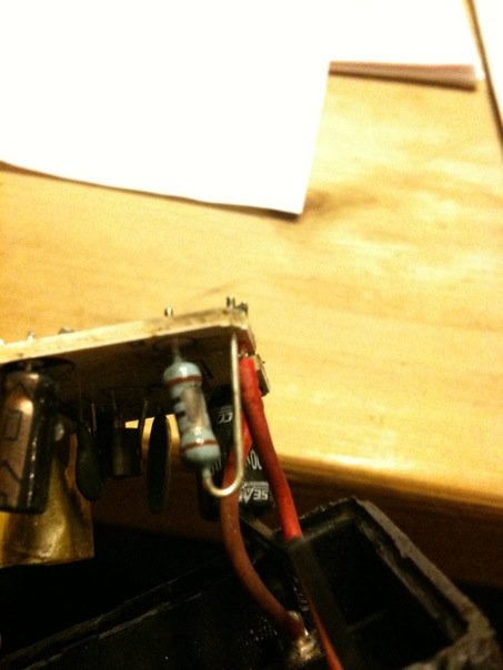

    A computer accessory I bought today came with a tiny switchmode PSU in a mini plugpack (wall wart) casing. Its labelled as YD-001, 110v-240v 50/60hz, 5v 1000ma.
    Having opened the thing up I'm concerned I even plugged this piece of junk in for the 5 minutes it took to test the device.
    I consists of:
    Low voltage cable soldered to the mains.
    A tiny white crud coated circuit board.
    A few 1/4w carbon film resistors, I love the one on the main input btw.
    2 common signal diodes and a zener.
    A sole power diode to rectify the mains to 400v dc.
    A 2.2uf 400v cap, 'MQ' brand
    A power transformer the size of the old 1k-8ohm audio transformers.
    A sole to-92 device, no idea what it is.
    suspiciously small 220uf 6.3v cap on the secondary.
    A couple of small caps around the transistor (filter and timing ?)
    Things missing:
    3/4 of the bridge rectifier, removed to save costs.
    any sort of fuse.
    any sort of high voltage rated cable, resistors, mains filter components.
    a proper diode to rectify the secondary voltage.
    If this piece of junk can put out 1 amp without failing in short order I'll eat my hat.
    Question though, would replacing the single diode on the hot side with the full 4 diodes effect the operation at all ?
    I plan to fix the hot side with a new HV cap, full diodes, inline fuse, proper HV resistor etc. A new cap and diode for the output. Then use it to power some xmas decorations or something else that doesn't care much about voltage regulation.
    To anyone else, just throw it in the bin, its not worth fixing unless your bored.

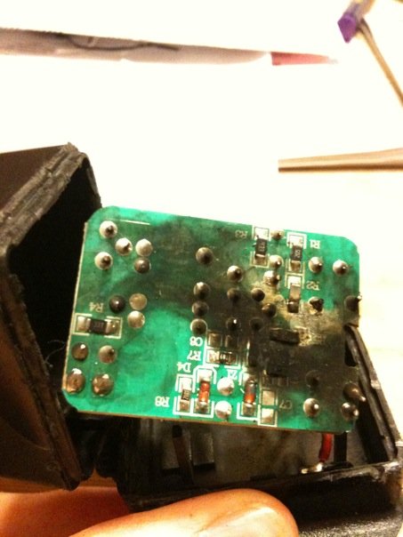

        This sounds like one I had. It was for an energy monitor. Hook the wireless receiver up round the mains cable by the breaker and it transmits to a little display (powered by the below)
        Yes, it is a potential firestarter.
        Mine failed - I cracked it open.
        Replacement Motorola phone charger works fine
        Results below:
