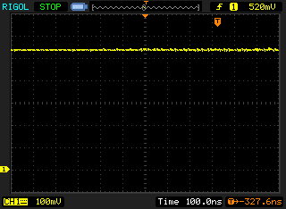

                                #55
                                Re: Delta DPS-286AP (RDENCA336WJQZ) Troubleshooting
                                R7823 is 10 OHMs and tests good. The waveform is at the CS pin 4.
                                • bznhvx
                                  • Mar 2020
                                  • 41

                                    #57
                                    So the fets are trying to operate, otherwise there would be no waveform on the CS, I guess you could try lifting R7641, that would isolate the pfc output to the main supply.
