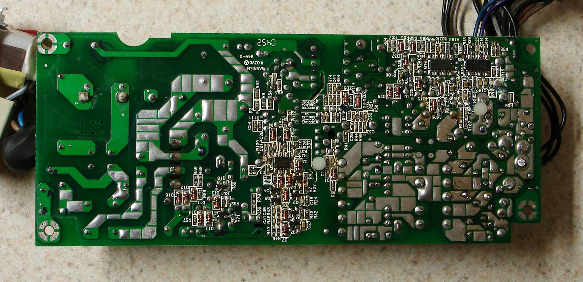

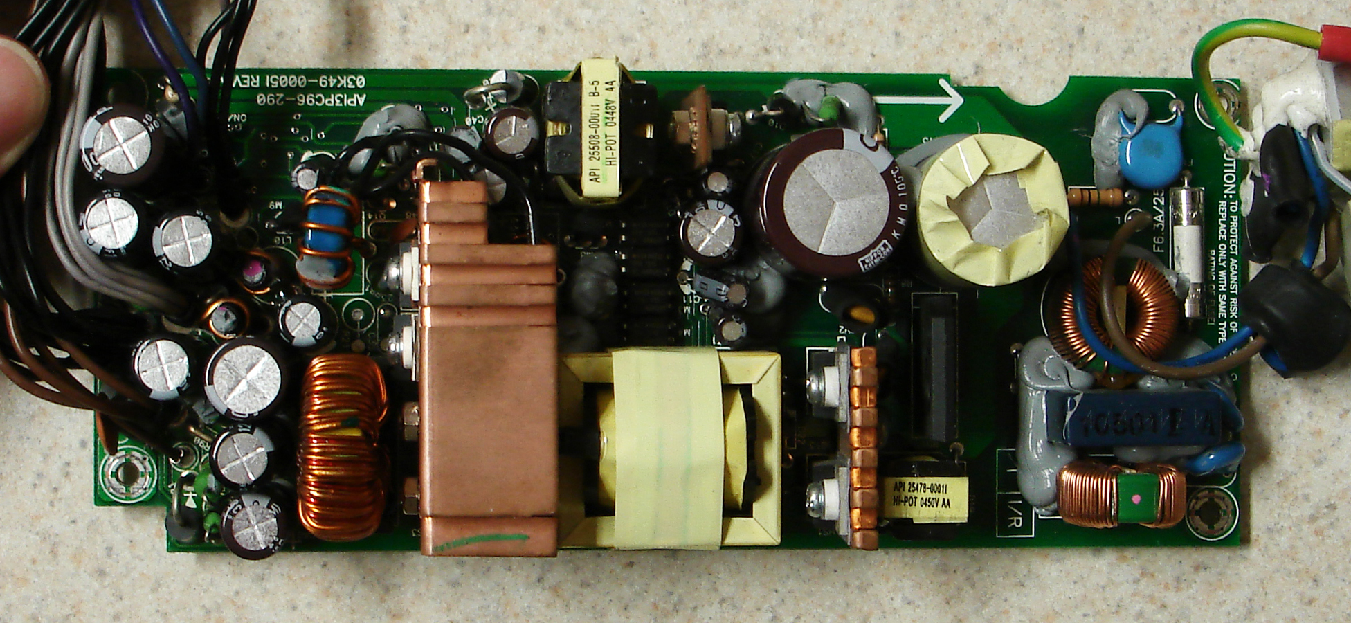

                    Re: Apple iMac G5 PSU - Recapped, now not working again
                    Sorry for the long delay - I've been sidetracked this week with some unplanned car projects (read: repairs )
                    Toasty, I did take some nice, large pictures for you. I'm attaching them to this post. I did jumper the PSU on, then unplugged it and checked with a meter to make sure all of the lines were at 0. When I plugged it back into the iMac it still does the same thing. Also, the replacement I put in has also stopped working. The part number on the replacement is 614-0296 rev A, all of the amperage ratings are identical.

                        • Toasty
                          • Jul 2007
                          • 4171
                          At least you know the over current protection is working!
                          Glad you found the problem Sometimes the damndest things....
                          Thank you for the pics! Yours matches the 661-3350 (AcBel) model I have. Now I know those two numbers are a match.
                          TC asked this question several posts back - Is the unit an AcBel or Delta?
                          Use something more substantive than electrical tape to cover that area. i.i.- A piece of a plastic container cut to fit.
                          I have had my response in partial form since your 5PM report. Did part, went away. Came back later did a bit more. Saw the pics and grabbed the matching unit from out of its "In Process" tray with a pile of notes and parts to go with it.
                          It was good I didn't see your later report earlier. Otherwise, I 'd of stopped working on my Imac PSU testing wiring harness and load center. Just tested it on a 661-3350 and it is now just so easy to hook leads to terminal blocks. From which I can now easily connect to the loads I want. A TON of alligator tipped jumper wires just went on furlough. Somebody mentioned Aruba...
