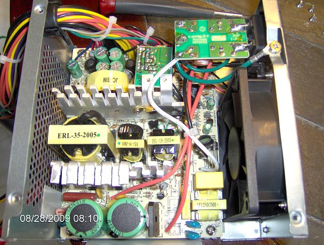

    NSpire NSP-405V2 / PSP-575S2 with 120mm fan

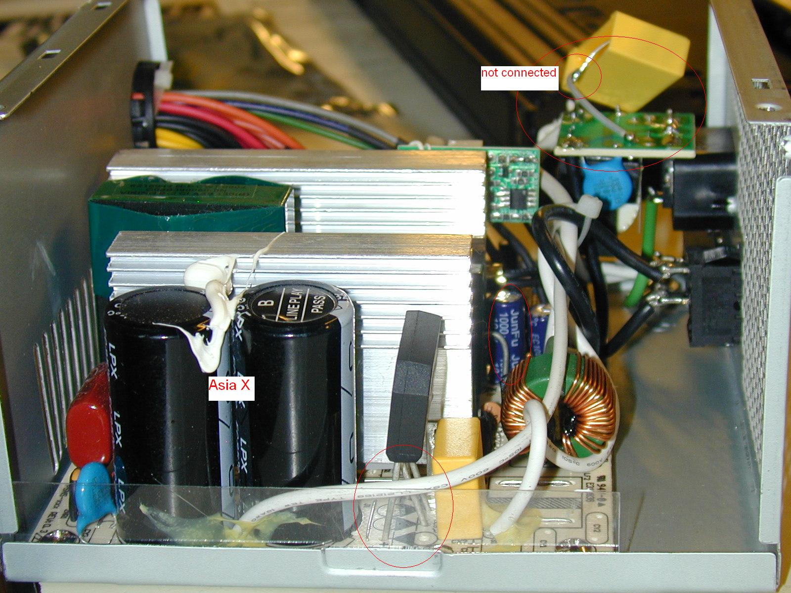

    I've used many NSpire PSs for the last couple years. They aren't the best but I've never had any problems with them. I randomly picked a new one and decided to open it up and nose around. This is what I saw... (see pics)
    JunFu (on the bad list) 0808 date code and AsiaX caps. Is it possible they have fixed their past quality problems?

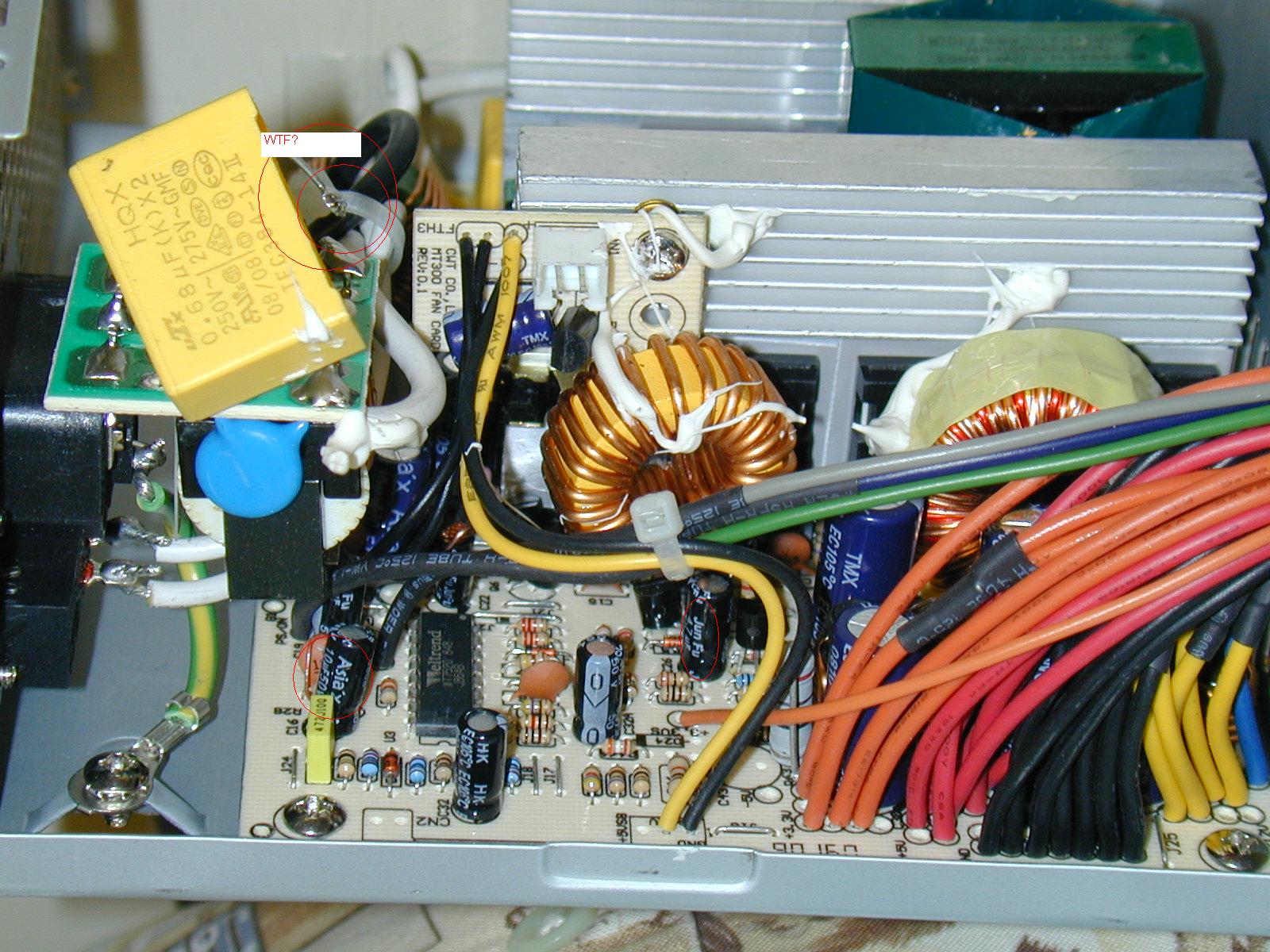

    ...and a assembly failure.
    I'm just one guy. I can't say that this one random power supply represents all Nspire ps'. Since I've had only a few (single digits) out of hundreds fail, I am still reasonably confident in them.
    What do you think?

    AsiaX (formerly known as Fujiyuu,) and JunFu are both bad. Don't count on them being any better than they were before.
    Somewhat complete input filter, bridge rectifier, ok sized heatsinks, and big transformer suggest that it is of quality just below deer/allied. Needs more heatsink and we need to know what parts are on them.

      I'm pretty sure that when I took the cover off some silicone stuck to the cover and pulled the filter cap off it's solder pad. I fixed it.
      I'll get more pics.

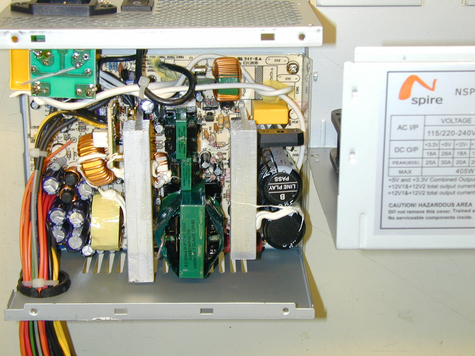

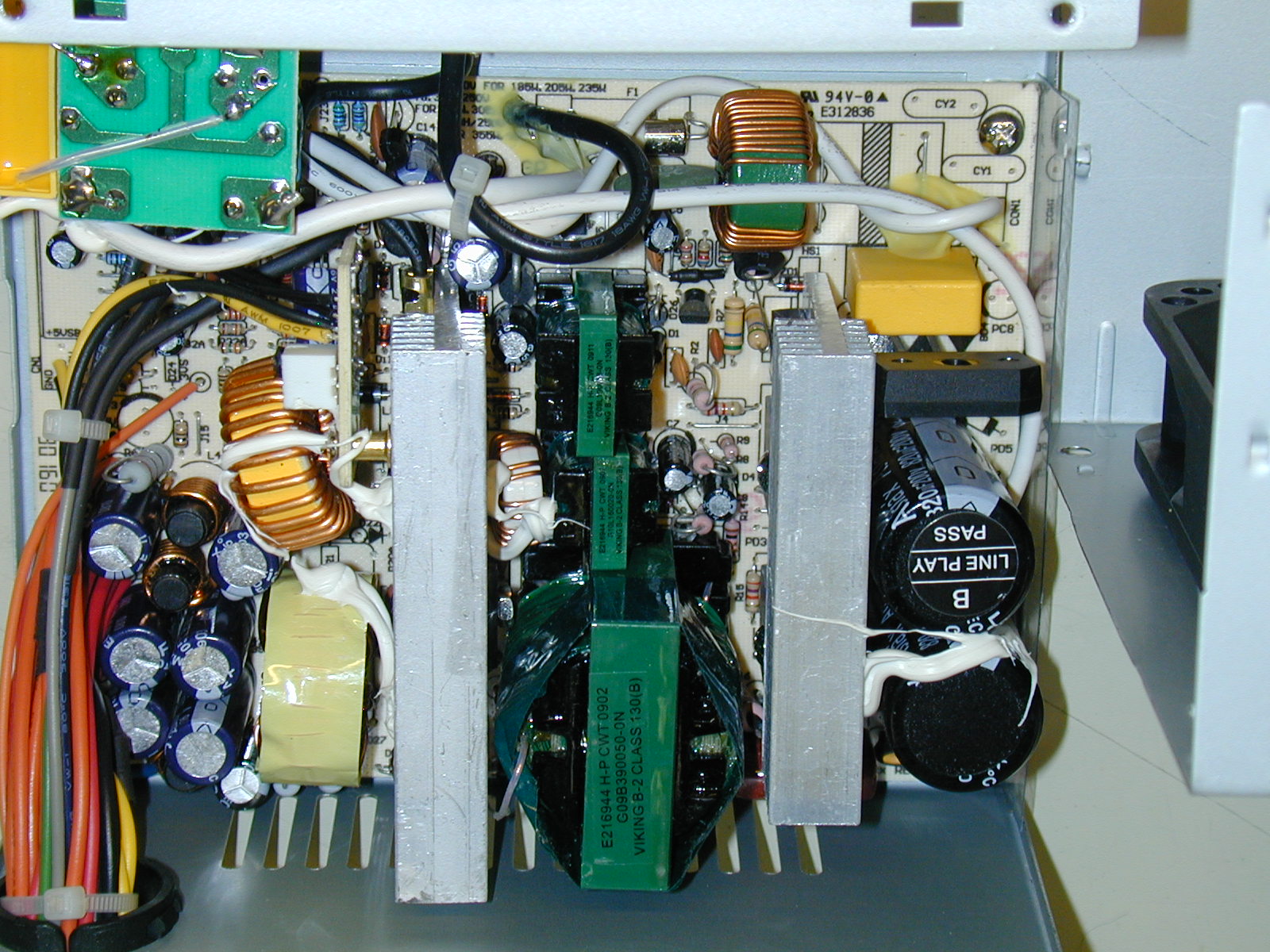

        a couple more pics...

            Its CWT. A old CWT design. Not too bad. Just replace those caps.

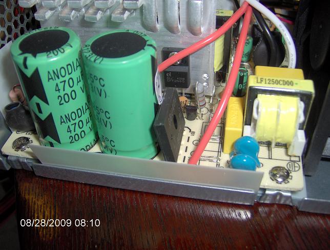

            Deer has gotten better from what they use to be (see pics)

              Re: NSpire PS design and assembly quality
              That is indeed a Chanell Well unit as indicated by the transformer. Seems they still like to use those Fuhjyyu caps (now under the name of Asia-X).
              Overall, the PSU looks alright from the pictures you posted. Definitely not CWT's best, but should be at least a notch better than cheap gutless units.

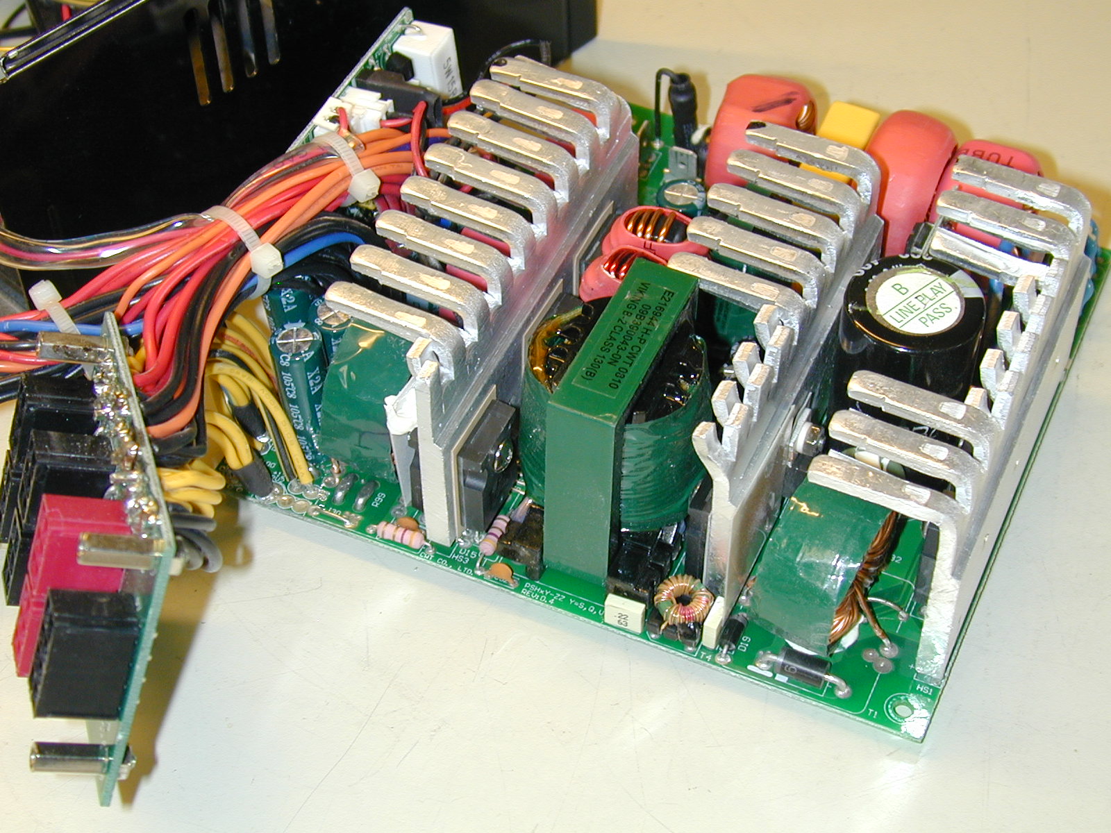

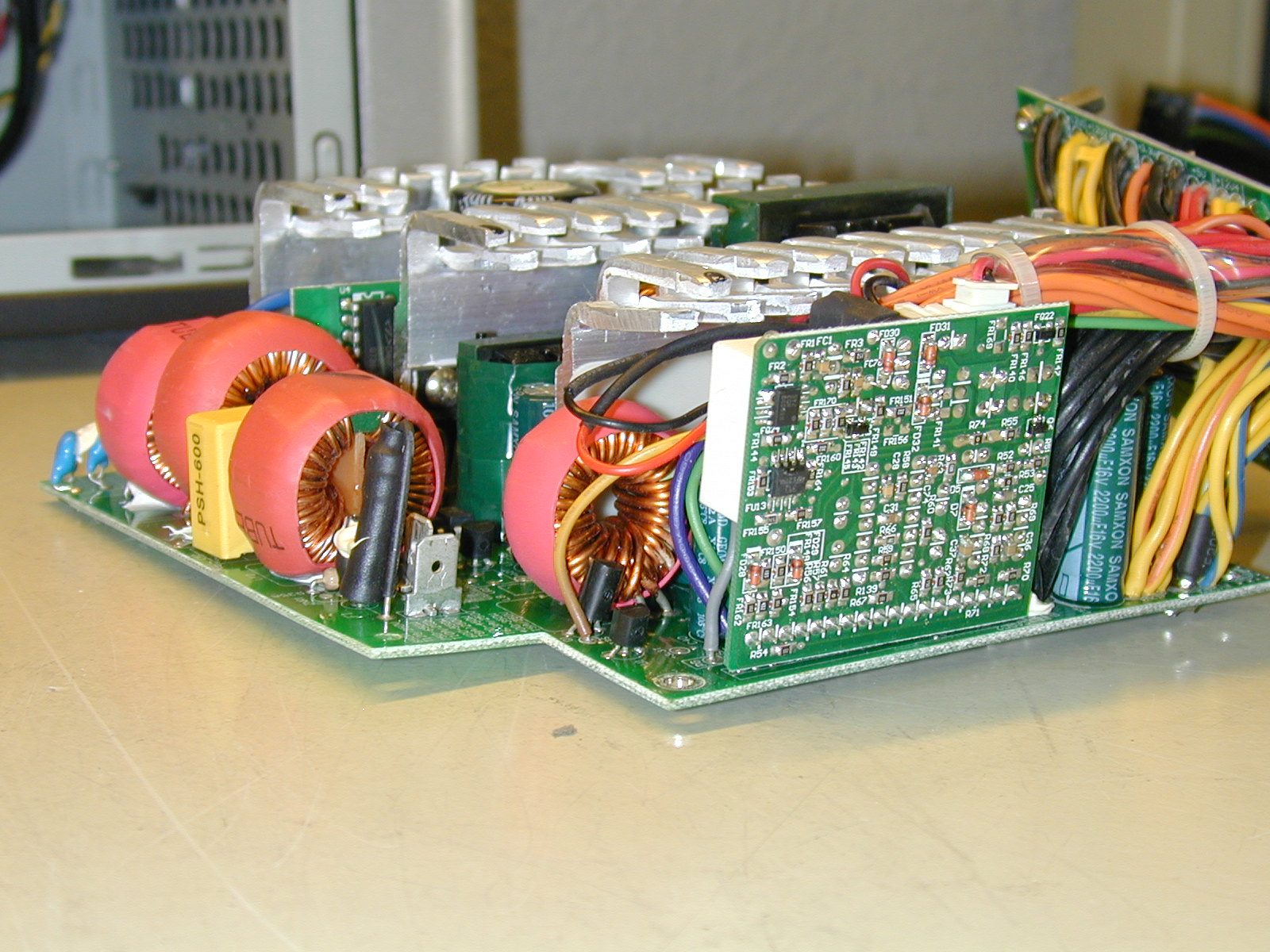

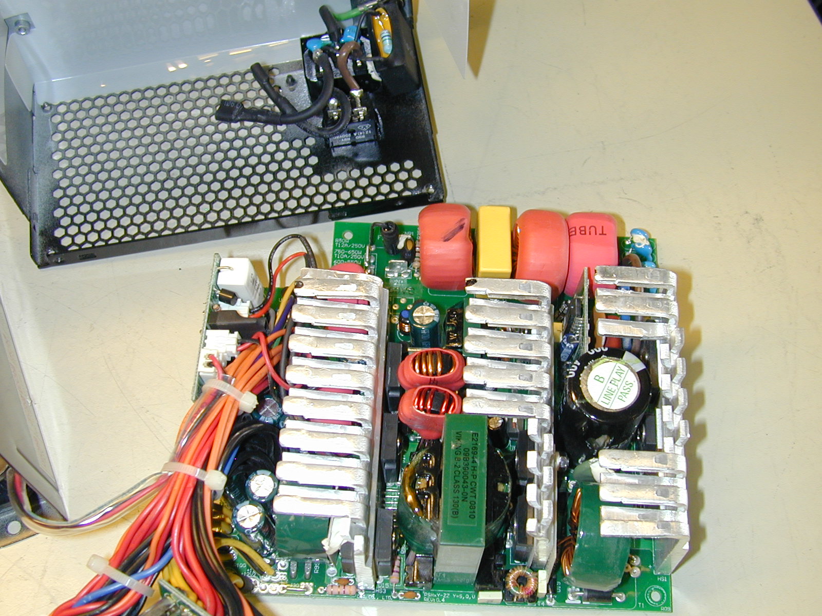

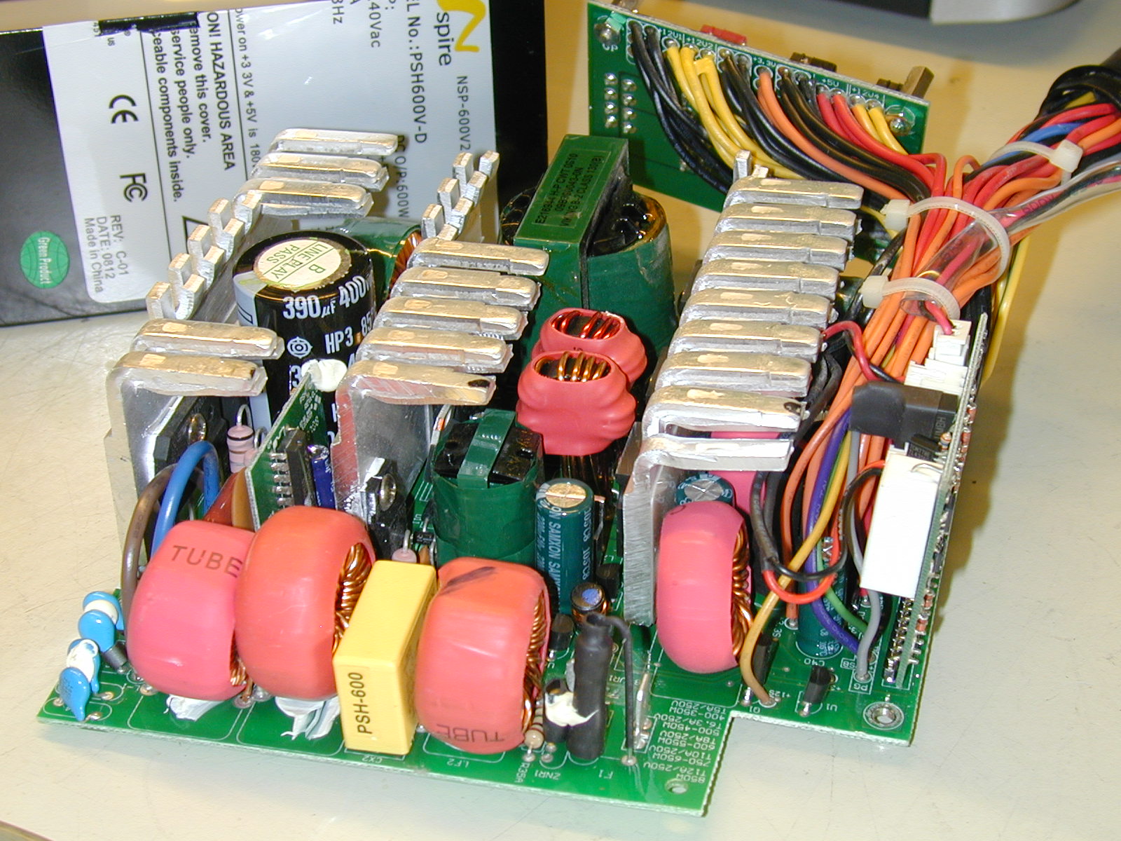

                    Here's some pics of the Nspire 600Watt bigger brother.
                    Clean, good solder. Just one big cap. SamXon small caps. I see the CWT label.
                    My 10+ year old digital camera takes very good pics in full light but can't do macro. I hold the camera about 1.5ft away and zoom in. If more pics of certain parts are wanted, let me know.
                    I've been having stability problem with the computer. I suspect the video card Asus 9600GT. I definitely wanted to pull the PS and give it a look too.
                    Thanks!

                      That primary cap is a Fuhjyyu.
                      Guess it was only a matter of looking seeing CWT manufactured it.
                      It was so promising too Samxon all good then one of those caps to screw it all up .
                      • golemmaster
                        • Jul 2009
                        • 100
                        Crud. That is disappointing. It's got that round logo and says HP3. A rotten Fuhjyyu onion by any other name..... I measured low ESR on all of them. I am a little surprised to see only one 390uF primary cap.

                          Interesting... I have the same CWT 600w model except it's branded by Xclio. IIRC Thermaltake also uses this model but I don't know what caps they use.
                          Minor differences here and there but Xclio uses a Rubycon for primary. Oddly enough, it's missing two Y caps compared to post #10.

                            APFC. Just needs a single higher voltage, lower uF cap compared to no or passive PFC.
                              Nope, that's not Fuhjyyu. The logo looks very similar, but the capacitor is actually made by Hitachi, as indicated by the "HP3" mark.
                              APFC, Samxon caps... Looks like a good power supply.
                              • golemmaster
                                • Jul 2009
                                • 100
                                Hitachi! That logo looked familiar but I couldn't place it until now.
                                Nice.
