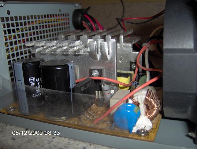

    My handy work so far:
    Replaced input YC caps with Panasonic 470uf, 200V caps. Replace red round X cap with actual X cap, put X cap in place where no X cap was. Replace tiny Y caps with larger, nicer Y caps. Install bridge rectifier (GBU606 6A @ 100C), replace smaller caps from YC to all CEC international holdings (Enermax uses these in almost all their new units), 5vsb cap 50v, 47uf to 50v 220uf Capxon (all I have right now). Have not touched the secondary caps yet. Jumpered it before with a quantum 10.2gb hard drive attached for a load.
    I also added a plastic sheet that goes under the pcb to reduce the risk of shorting on the case. This was pulled from the bestec atx-250-12Z.
    Before:
    12V: 11.69-11.89, sparatic, constantly changing.
    5v: 4.66-5.05, sparatic, constantly changing.
    3.3v: 3.03V-3.14v, sparatic, constantly changing.
    5vsb: 5.65v solid.
    After (have not touched the secondary caps yet!)
    12V: starts at 11.92, settles at 12.01
    5v: starts at 4.99, settles at 5.02
    3.3v: starts at 3.22, settles at 3.35
    5vsb: solid 4.22 (not sure how that happened, but its not frying the chipset!)
    Amazing what just a input filter will do. Now time for some secondary caps and see where those voltages will start off then.

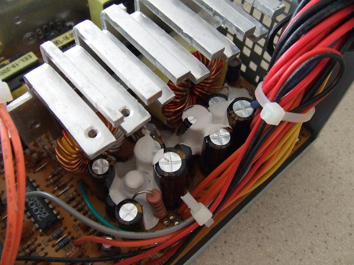

    Before pics:
    After pics:

    Re: Rebuilding Rosewill 350W
    You should have fixed the Bestec ATX-250 12Z instead as that one probably wasn't a motherboard killer.
    Also, 5.65v on 5vsb? That's out of spec by over 10%!! Good thing you caught it.
    At least the Panasonic caps stabilized the voltages. Those YC primaries probably have 0uF left .
    ... Probably the 50v, 220uF CapXon. That voltage is also more than 10% out of spec by the way. But I guess it's better than 5.65v, though.
    On the random side of things, that main transformer has a fake "35" rating. Should say 33.
    • ratdude747
      Black Sheep
      • Nov 2008
      • 17136
      i still see some ugly jumper wire that could go. look between the x cap and the bridge. i think a component could go there...
      also, do yourself a favor and replace the 115/230 switch with some insulated jumper wire. that way nobody sets it to 230v. whats worse is when it should be set to 230 but is instead set to 115... search youtube for that and you will see some spectacular burn-ups.

                                Well, I recapped it with the caps from the newton (rubycon)
                                BEWARE. YC caps have cheap-ass plastic sheath that ripped off because of the massive amounts of spooge glue covering them. I had no idea what the ratings were, so I used 16v, 2200uf CEC caps (ran out of 16v rubycon's) parts in their place. Tested it, all is fine.
                                Also, it has 2 12v rails. I do believe it actually has 2 12v rails, as that is probalby what the 3rd transformer is. (maybe?) and I believe one rail was regulated by 2 16v, 1000uf YC parts, and the second by a single 16v, 470uf part. That was replaced by a 16v, 2200uf UCC part.
                                I was concerned at first because the voltages were more unstable than with the YC caps, but then I realized the caps from that psu have not seen power for about 5 years. After about a hour of running they smoothed out to 11.99v (12.00v dead on the 4pin cpu), 5.03v, and 3.33v. They still do the dip when they first start up, at first it was terrible down to 11.79, but after a while it now starts at about 11.89. Also, the 5vsb is now dead on 4.33v. I also replaced the unknown manufacturer fan with a adda 80mm fan.
