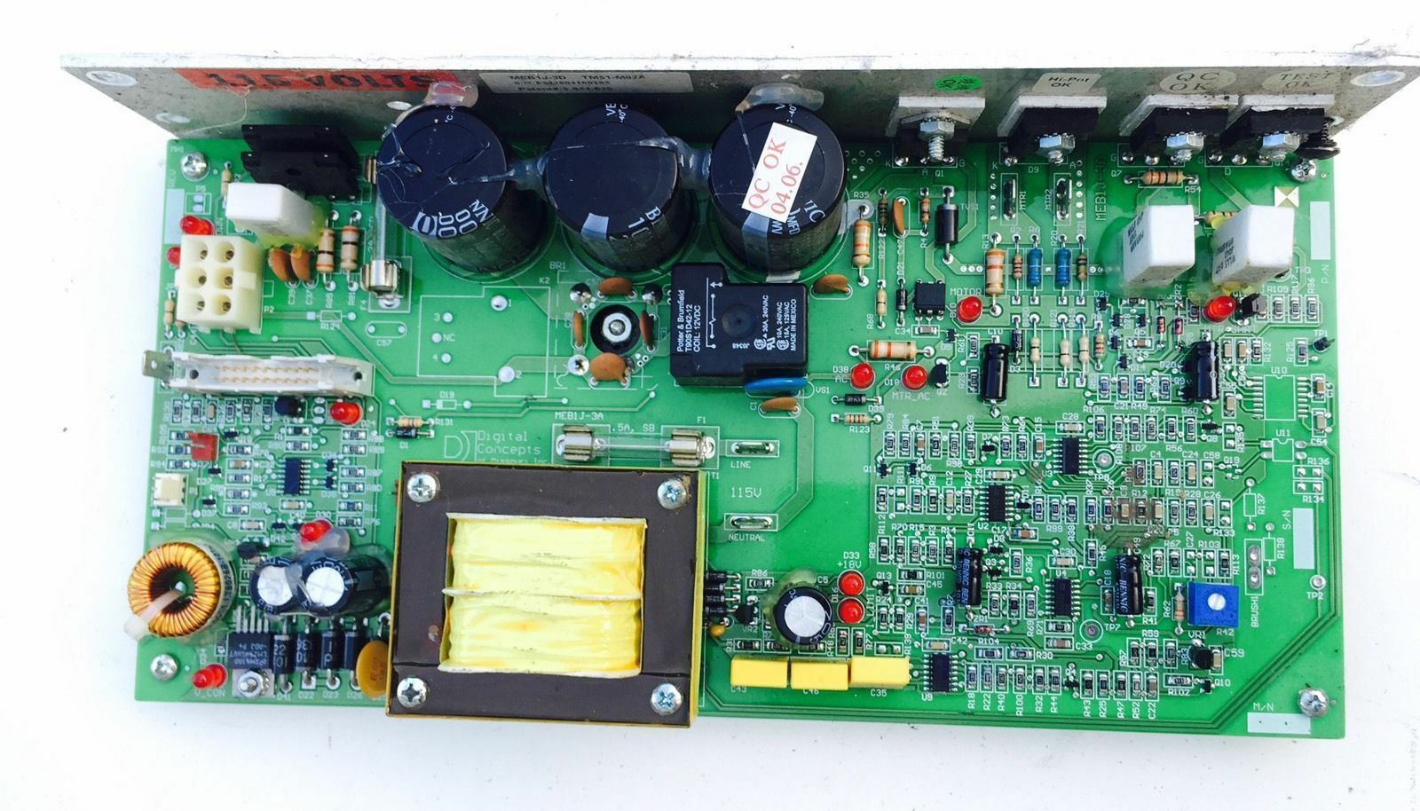

    hi
    i found a nice higher end vision fitness T9700 treadmill..i would like to attempt at repairing it
    it seems is dead..i get 0dcv to the top display panel
    the motor controller board is where the 115vac is input at and there is a circuit breaker at that location too.
    on the motor controller/power supply board there are several led status lights that are all off...according to the serv manual they should all be on to indicate that portion is ok
    the 2 fuses on the board are good
    the circuit breaker seems to be ok
    there is a power switch that lights up when plugged in
    i do have 115v throughout the motor controller board
    but the unit is dead...nothing turns on and no display panel power on at all...no sounds nothing
    any ideas what i can test?
    see photo stock photo of the motor controller board
    any help would be appreciated..its a nice treadmill would love to keep it out of landfill or not have to scrap it
    thank you

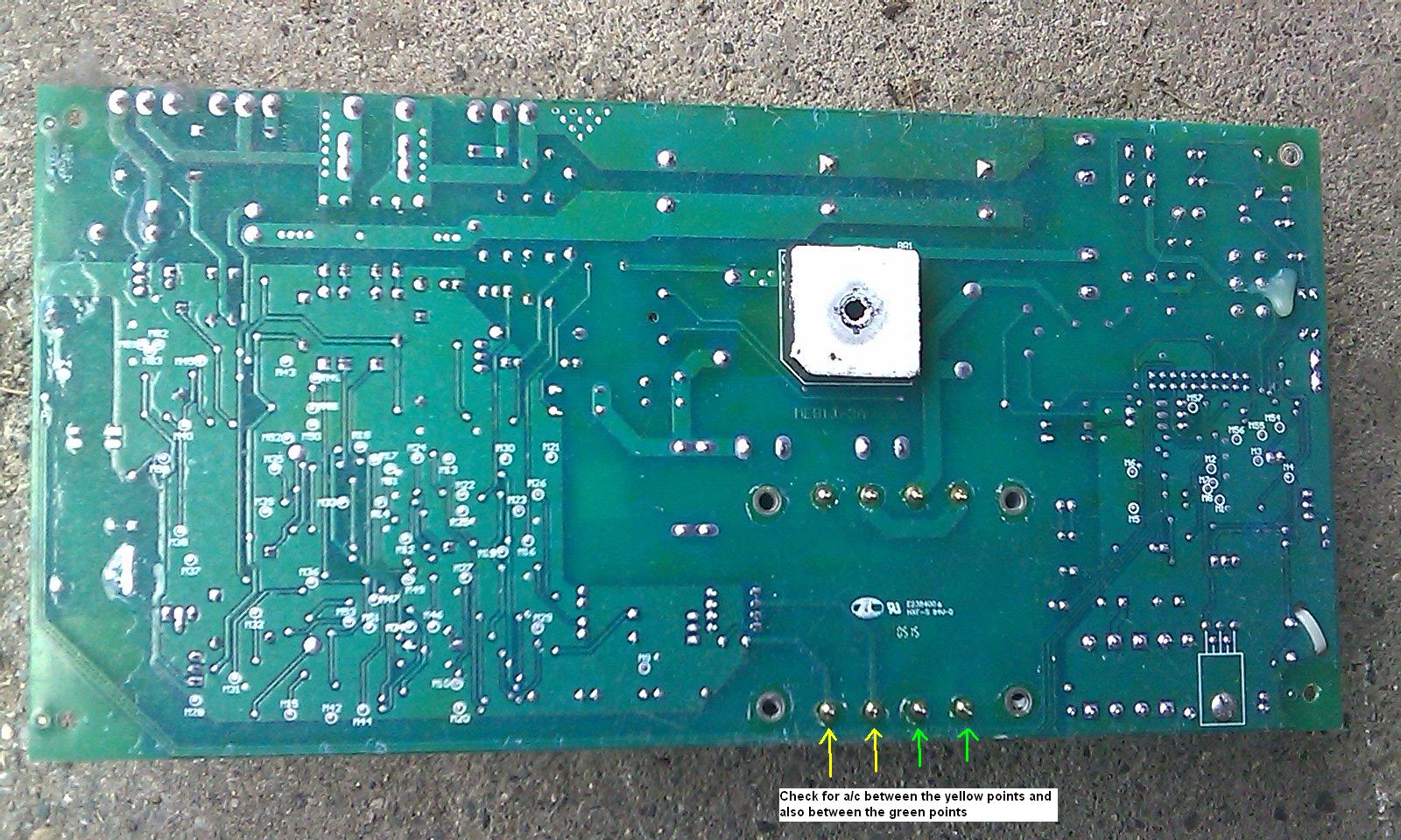

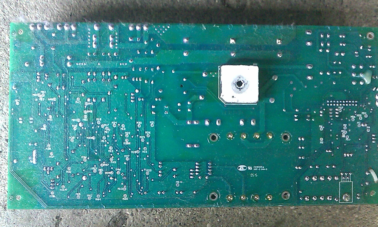

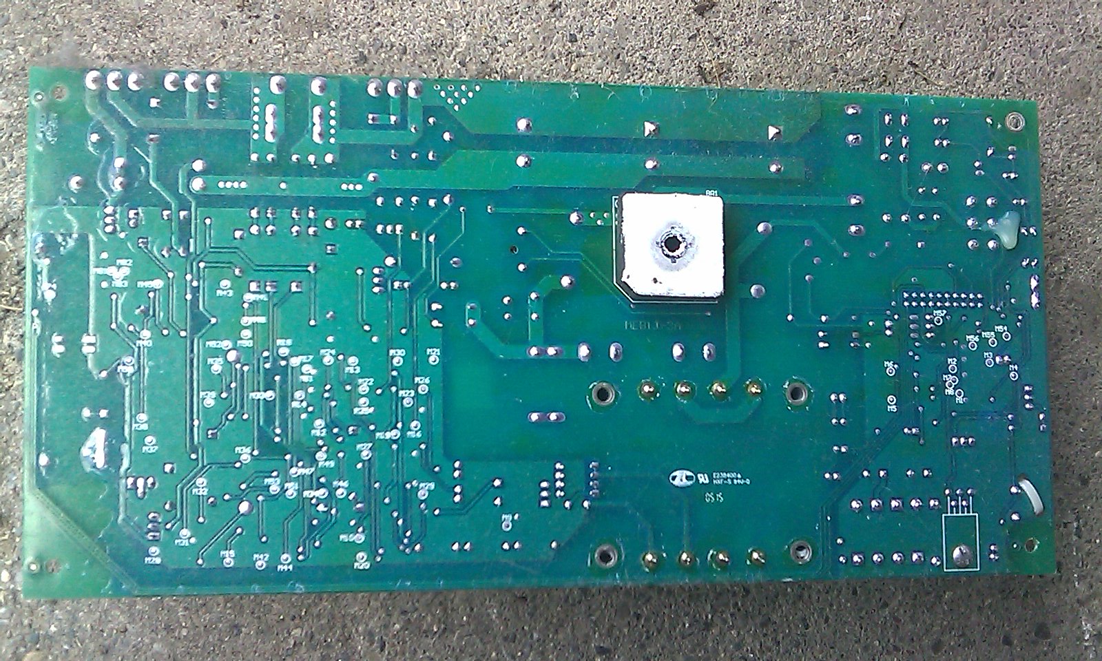

                              hi rj here is an actual photo of back of the board i have..
                              • R_J
                                • Jun 2012
                                • 9607
                                Re: Vision Fitness T9700 treadmill motor controler/power suuply dead

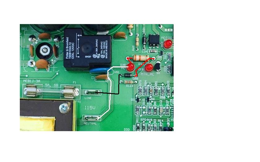

                                I suspect the A/C line connects to the two terminals labeled Line & neutral
                                Can you check if you have a/c on the two secondary windings? As for the relay, it requires 12 volts to operate the coil, that 12 volts must come from a 12 volt supply which is likely from one of the transformer secondaries. There must be a standby voltage from somewhere.
                                The picture helps, but being double sided its almost imposible to trace.
                                I am guessing, but it looks like D38 (AC) led should lite with a/c applied to Line and Neutral. It looks like line connects to D33, then to R15? and should light D38

                                      You should be able to connect 115vac to the line & neutral with the board removed, just be carefull. Then you can measure the voltages.
                                      There is a trace that connects from the neutral contact to one side of D38 (led) The line contact should connect to the anode of D39 (diode above R123) Check if this is correct.
                                      • shelby5041
                                        • Feb 2009
                                        • 1505
                                        • united states of america usa
                                        hi rj
                                        interesting...when i connect 115v to board outside of the machine i get the follwoing red leds to light up
                                        D38 115v
                                        D34 18v
                                        D33 vcon
                                        maybe i should reinstall in machine and start removing connections to see if one of the items is causing entire board to not power on???
                                        what do you think rj?..if the board shows life outside of machine and not when installed in machine that would be my guess
