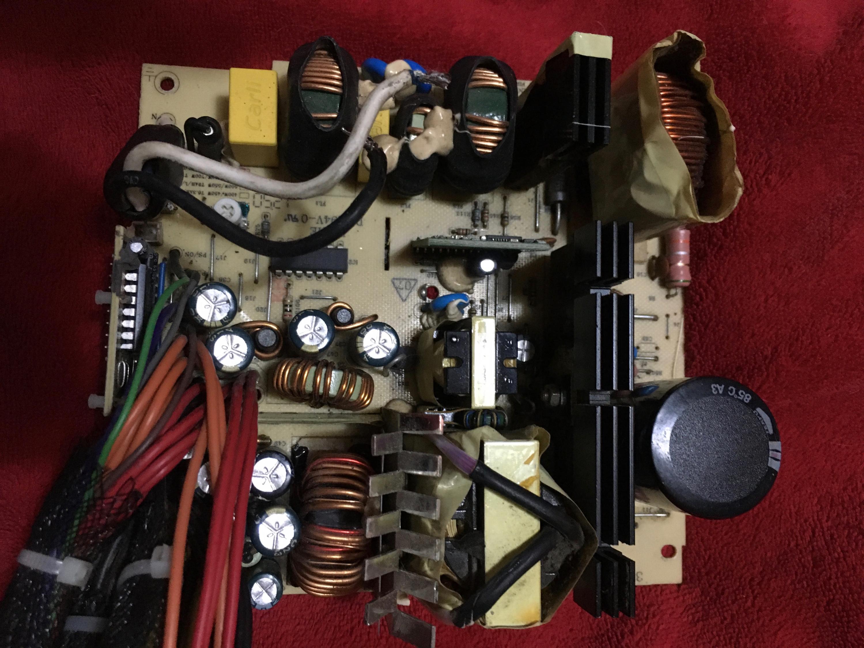

    My power supply (FSP RAIDER RA 750) suddenly died, powers on, fan spins and immediately powers off.
    The 5vsb is ok.

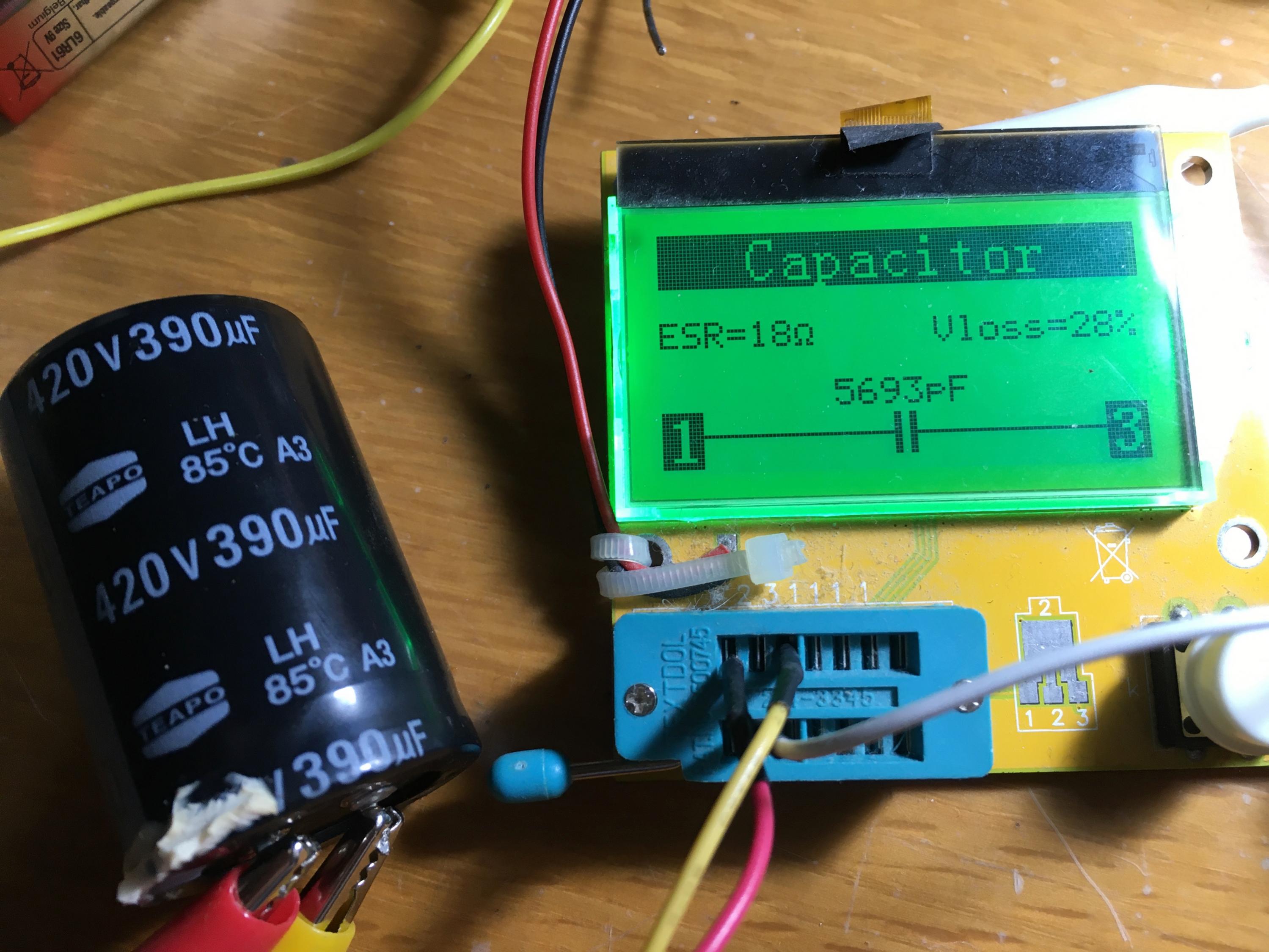

    Capacitors look good, but the first one I tested (the big one from Teapo) doesn't look so good.
    • 31304
    Re: Fsp raider ra 750
    5.6nF - that cant be right.
    try it with a multimeter - remember to discharge it with a screwdriver first.

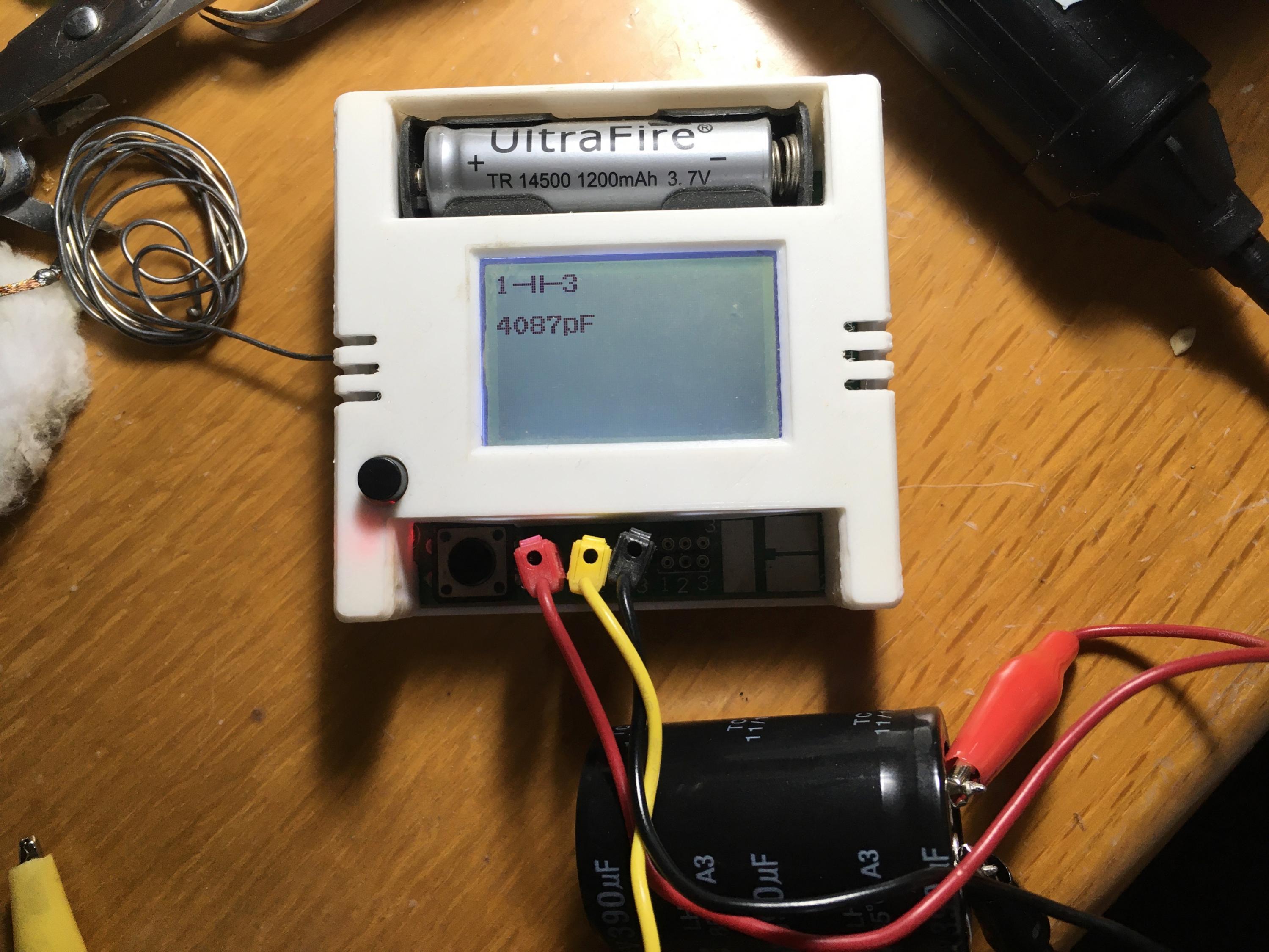

      It's discharged, I've made sure of it.
      I also tested with another tester I have and it gives the same result.
      What should be the normal ESR value for a 420v 390uF capacitor ?
      It's the first time I have issues with a big one like this, 18 Ω looks way too high. It should be below 1 Ω or something like that, right ?
      Anyway, I´ve just ordered a couple of 390uf 420v Nichicon rated 105ºC, the Teapo is rated 85º C.
      I can check capacitance and esr value when I get the new one...

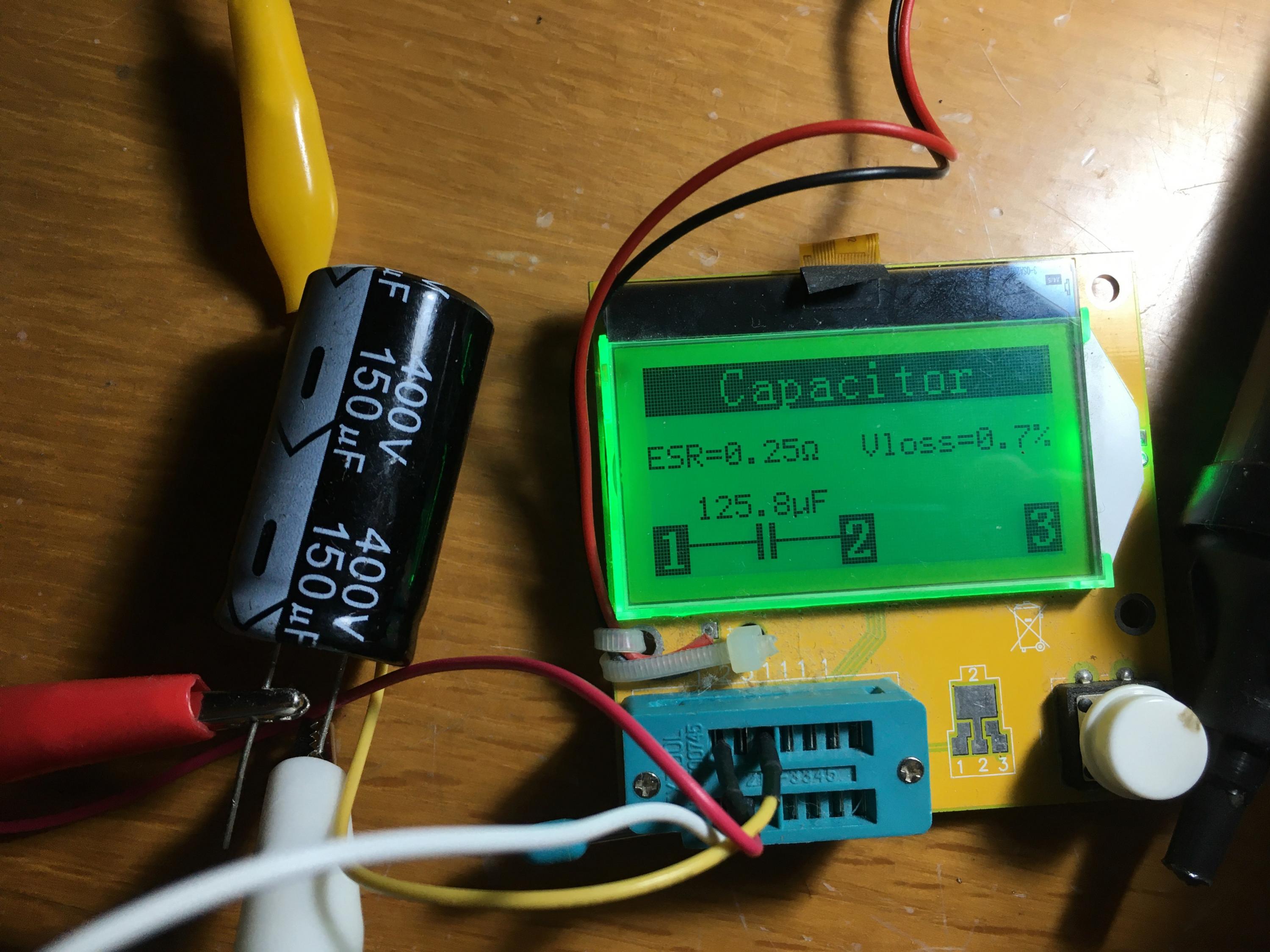

        I've tested other capacitor I have here: 400v 150uF with the same tester, looks fine. Low ESR

          Do you get any of the +12 or +5v when the main power supply turns on? If not, check the switching fets and secondary diodes for shorts, if it is a bad cap it is likely one of the small ones in the primary circuit gone open
          It is very unlikely the main cap is bad and if it was weak the power supply would likely still work unloaded
            • 31304
            well the main cap could be blown open-circuit.
            pretty rare though.

              I find many dead primary side caps when the PSU has APFC.
              As mentioned be sure to check for shorts, commonly the PFC diodes will short when the main cap goes bad like this.

                Bridge rectifier is OK, I see one isolated diode that is also OK, then I see in that dissipation plate a thing with 2 legs, that should be the PFC diode. It's also reads OK.
                Maybe the only fault is only the big capacitor.

                    Oh, it can!
                    Full thread here:
                    https://www.badcaps.net/forum/showth...hlight=enermax
                    And here is another thread of mine with a busted main cap:
                    https://www.badcaps.net/forum/showth...ht=thermaltake
                    There are more of these threads here on BCN by other people, but I'm too lazy to look them up right now. Will do if you think it'll help, though.
                    Not at all.
                    I see it more often than I'd like to on PSUs with APFC.
                    Seems to be more common with CM6800 PWM+APFC controllers, but I'm sure it's happened to PSUs with other controllers.
                    Same here.
                    APFC puts a much more considerable deal of stress than a regular PSU with line-connected caps. And when the caps are a Taiwanese or Chinese brand, that doesn't help either.
                    The easiest test is a dim bulb tester (Google it or search for it here on the forum)
                    I find that many APFC PSUs don't like the dim bulb test. Might need several 60-100 Watt bulbs in parallel to keep the APFC happy. I typically use a 450W heating element for cases like that. And I still can't put much load on the PSU before the APFC decides the line has dropped too low and it won't work.
