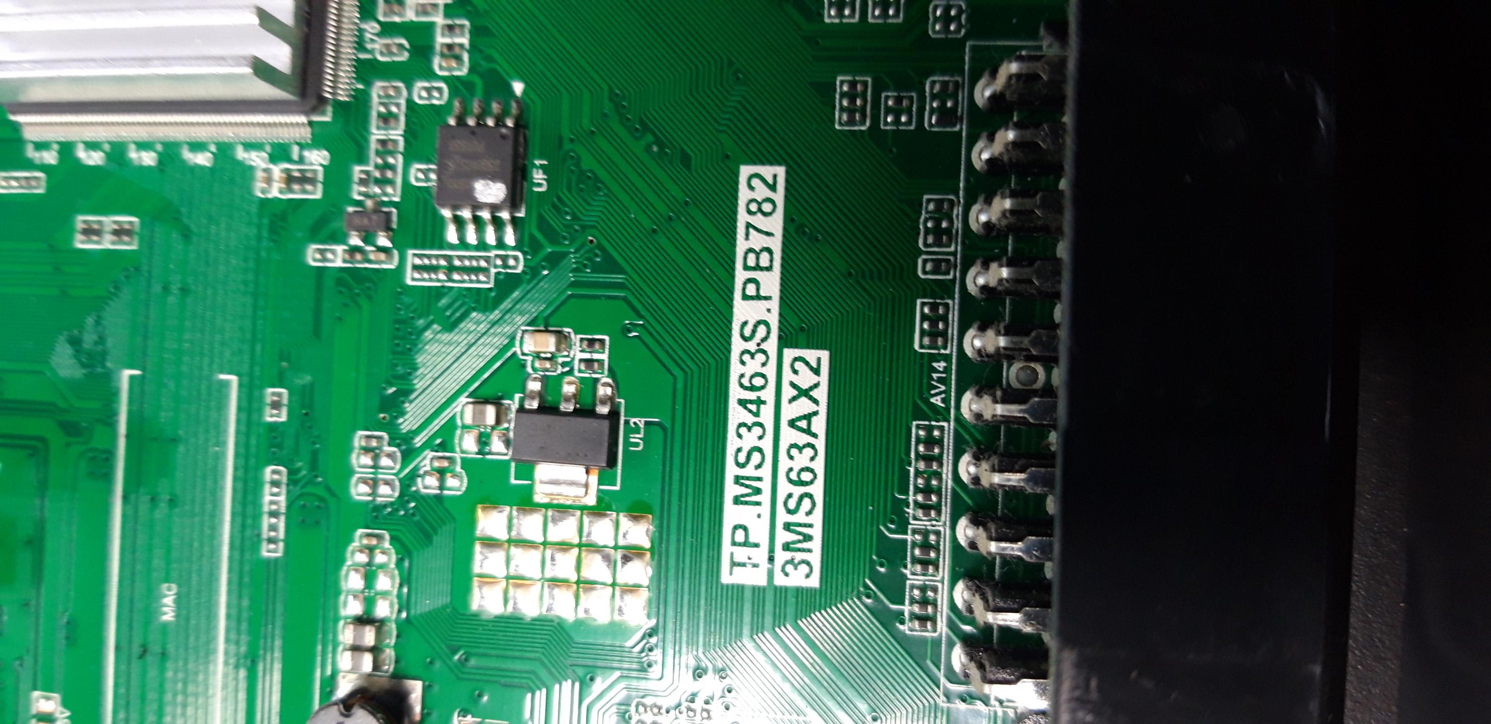

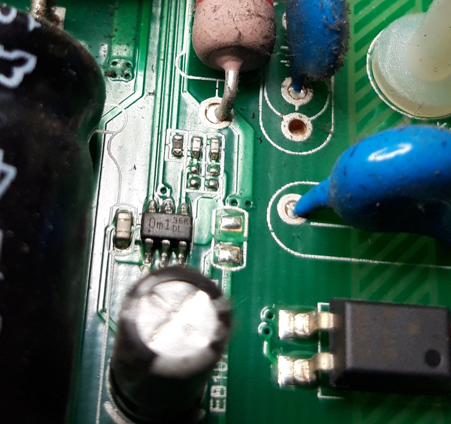

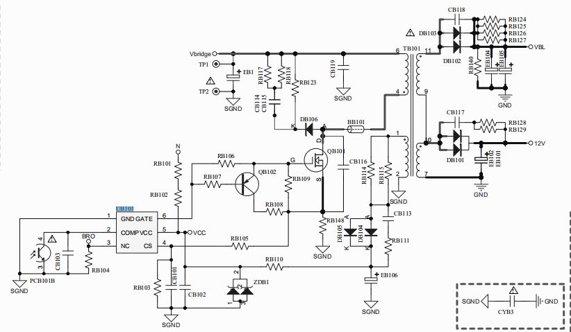

    I have trouble with this psu, l'm suspecting pwm ic is the problem, but i can not find it's datasheet, or anything. The picture is from service manual of tp.ms3463s.pb801, mine board is pb782, l'm guessing it's similar, if not exact as mine.. So what is UB101?

      It looks like a LD7536RM, I think I found the correct one.

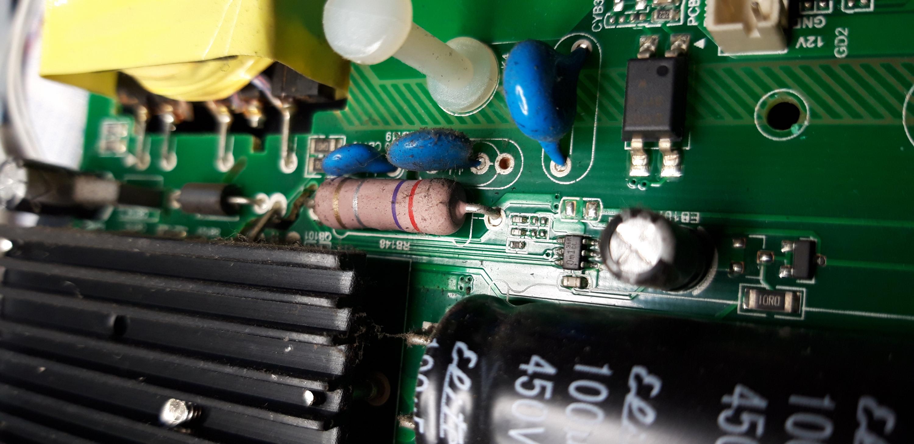

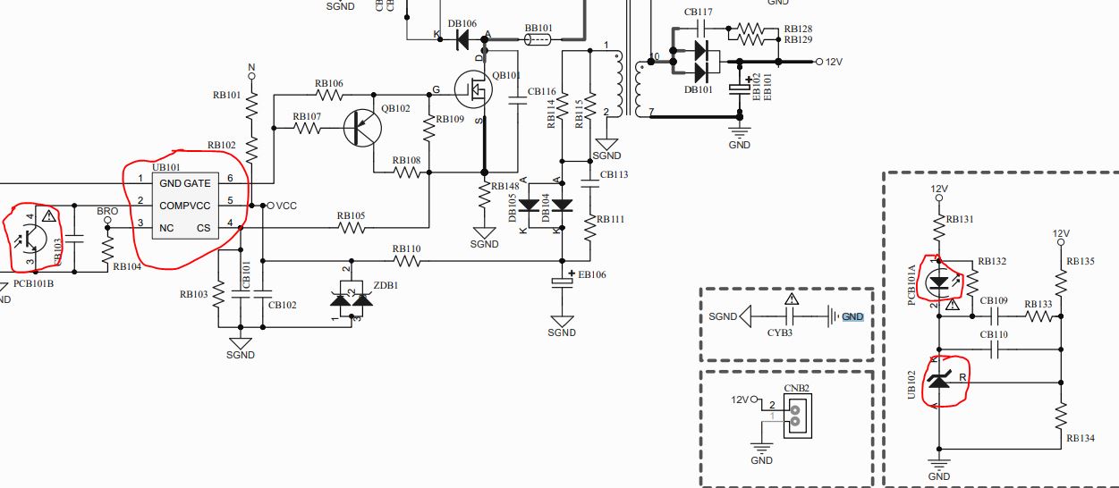

        I too do not know if it's that one, but l found simmilar 0cl 308 b4 marking, and gave it a try, of course when i removed old one that was fried, indeed, measuring on green picture.
        Replaced it, 15V was not steady, no stb power or 12V rail.. Changed optocoupler, and diode on secondary side of optocoupler, you have red cicled on pic what was changed. Anyway, it's working now, thank you for leading me to another succesfull job
