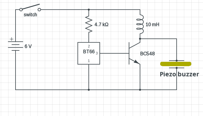

                It is common to add an inductor to make a boost converter just for the piezo buzzer. This can make is very loud. It is used in some smoke alarms and battery powered things where you want more than 3V or 5V swing going to the piezo. This is assuming you are not using a complete alarm horn or something, but just the disc element.

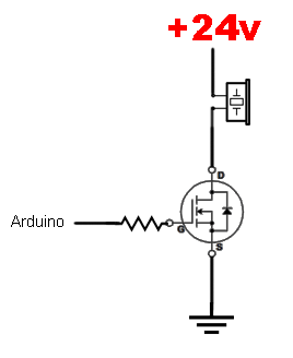

                      The buzzer consists of 24 volt rated piezo speaker, sourced through a 20N06L from the 24v power source, which is triggered from an Arduino pin using the Arduino Tone command... works well in testing but the volume difference even between 19 and 24 volts is absolutely noticeable... so i don't wanna skimp on that ...
                      heres a rough schematic of what that looks like.

                          The inductor is the same principle as a boost switch mode power supply, except we don't care about which way the current goes (so the diode isn't needed except perhaps to protect the transistor), AC is perfect for a piezo transducer element.
                          I was wondering whether the piezo transducer had its own oscillator, then that would be a piezo buzzer if it had the oscillator... was a bit confused earlier.

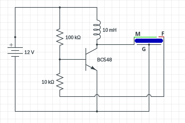

                            Your piezo drive circuit sucks, you need a resistor across it to discharge its capacitance and bring the crystal back. AC drive is best.
                            With an added inductor, you can get over 5-10X the voltage drive to the piezo element. The 60V mosfet would need a TVS to protect it because spikes will go over that. The method is a narrow pulse to charge the inductor, less than 50/50 duty cycle is used.
                            It's important the drive frequency is near the piezo mechanical resonance, so a signal generator sweep can be helpful. If your Arduino is making say 2.5kHz but the piezo might be designed for 3.5kHz, it would be much quieter than expected.

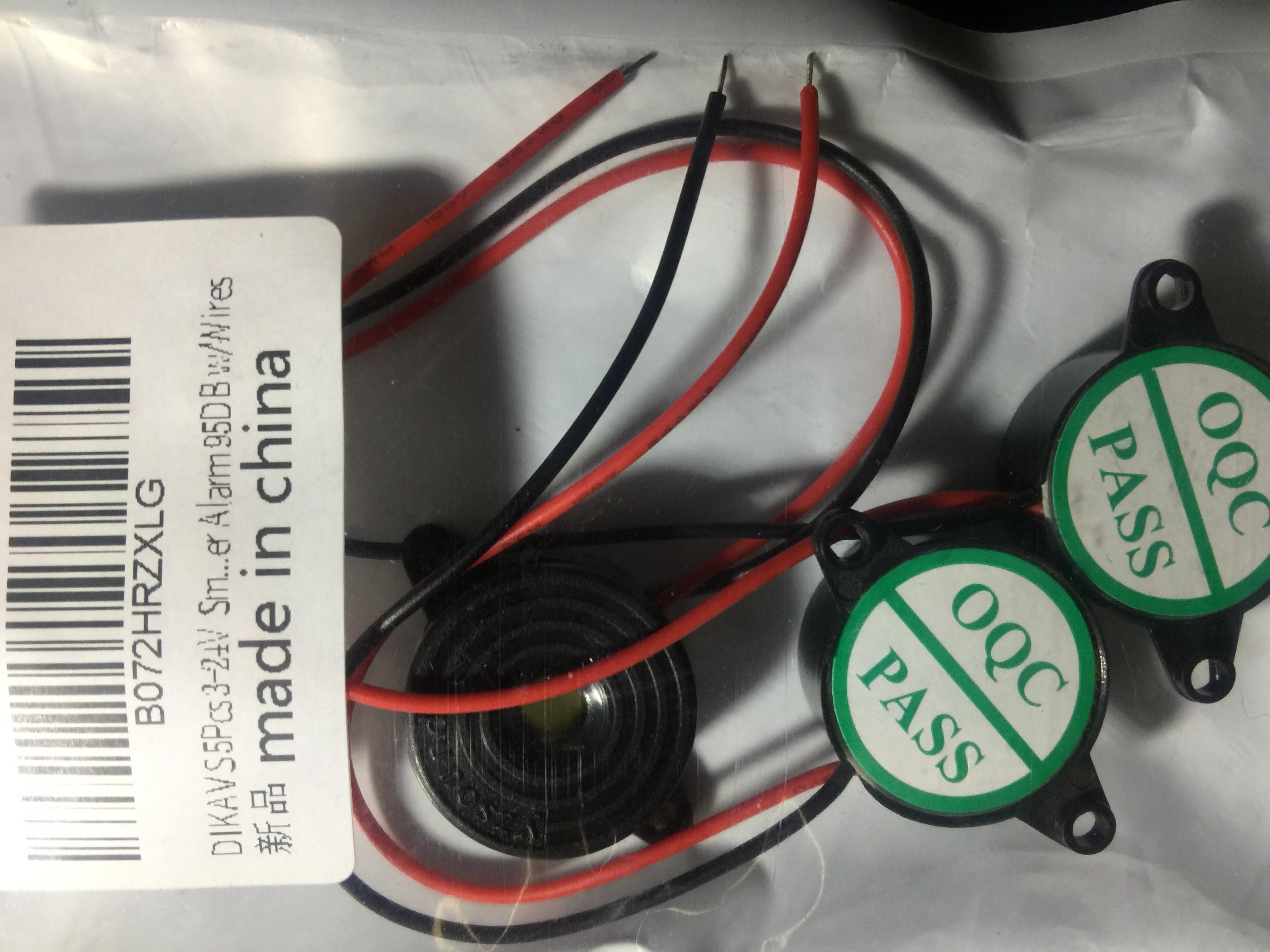

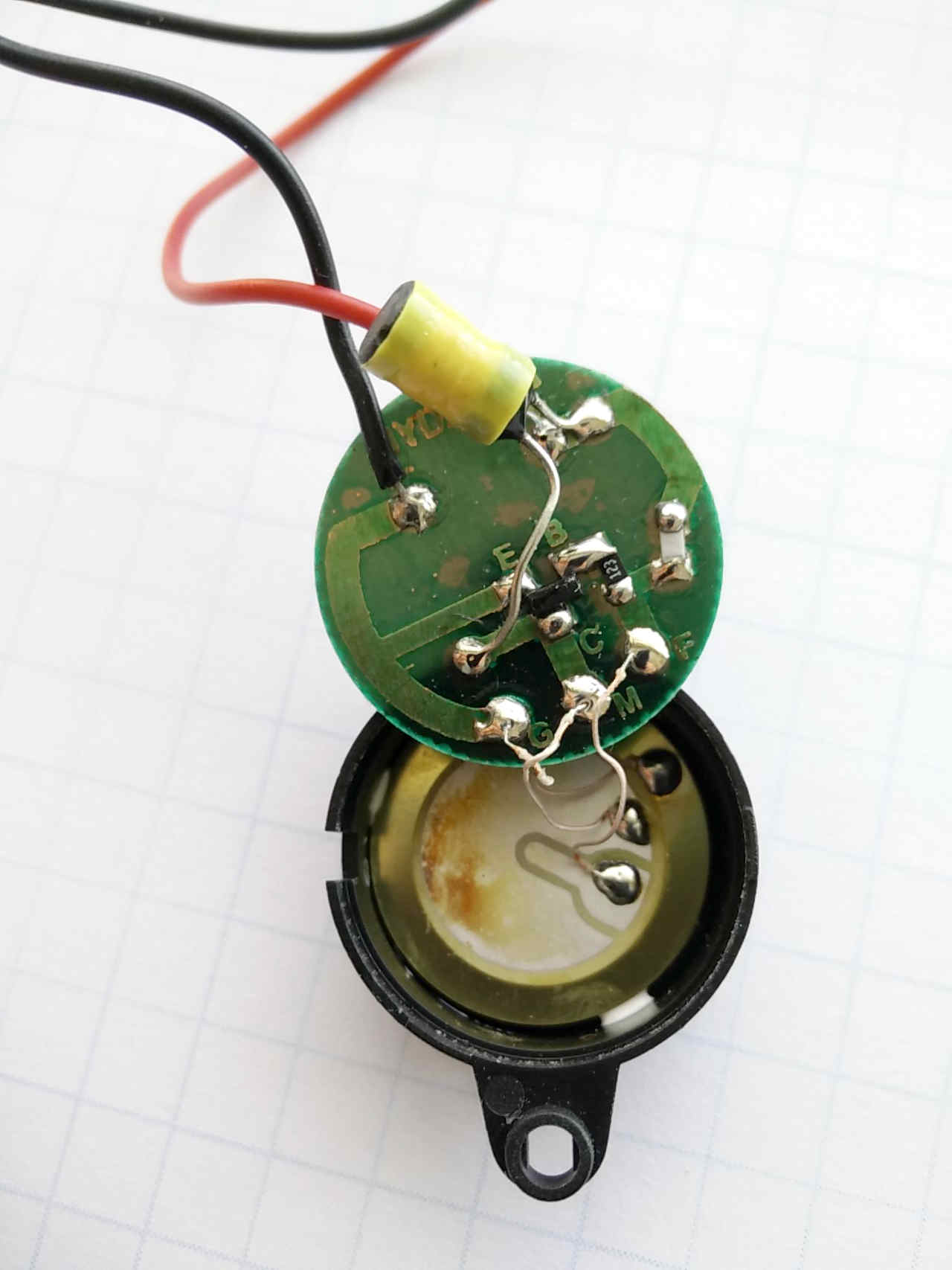

                                      OK from your picture it's an Ali/fleabay piezo buzzer/beeper, which is a piezo-disc with built-in oscillator. It already has an inductor and 2SC1623-L6 transistor, two resistors inside. Attached pic is one I took apart.
                                      *So nothing can be done to make it much louder, you have to go bigger in size.
                                      Operating Voltage: 3-24VDC, 10mA, Frequency 3,900±500Hz, 95dB
                                      Drive Method: Drive Circuit Built in
                                      B072HRZXLG TMOEC piezo buzzer HYDZ2312
                                      You can also get just the piezo disc, some with two-wires or three-wires (needed for the self-oscillating type) and drive it with pulses from the Arduino. Junk smoke detector ones are best I find, for loud alarms because they have a huge disc.

                                        Originally posted by eccerr0r
                                        Will they beep with just DC connected to them?
                                        Well now that is a great question ... lets find out ...
                                        Holy crap! It sure does ... it even does Star Trek impersonations ... I zipped it up and attached here...
