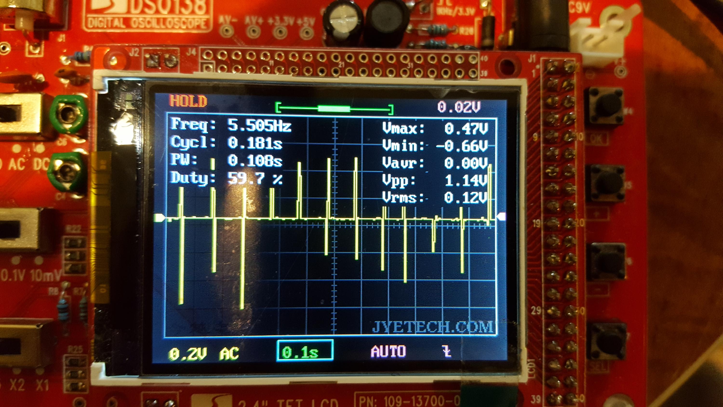

      I hooked the scope to the secondary side of the transformer and yes - something is going on ( see photo ), but still no voltage on the rails ( c707-0v, c708-0.07v, c709-0.15v )
      From the VPP on transformer pins 2 (0.22), 3(0.4) and 4(1) at least it seems that the secondary coils are fine.

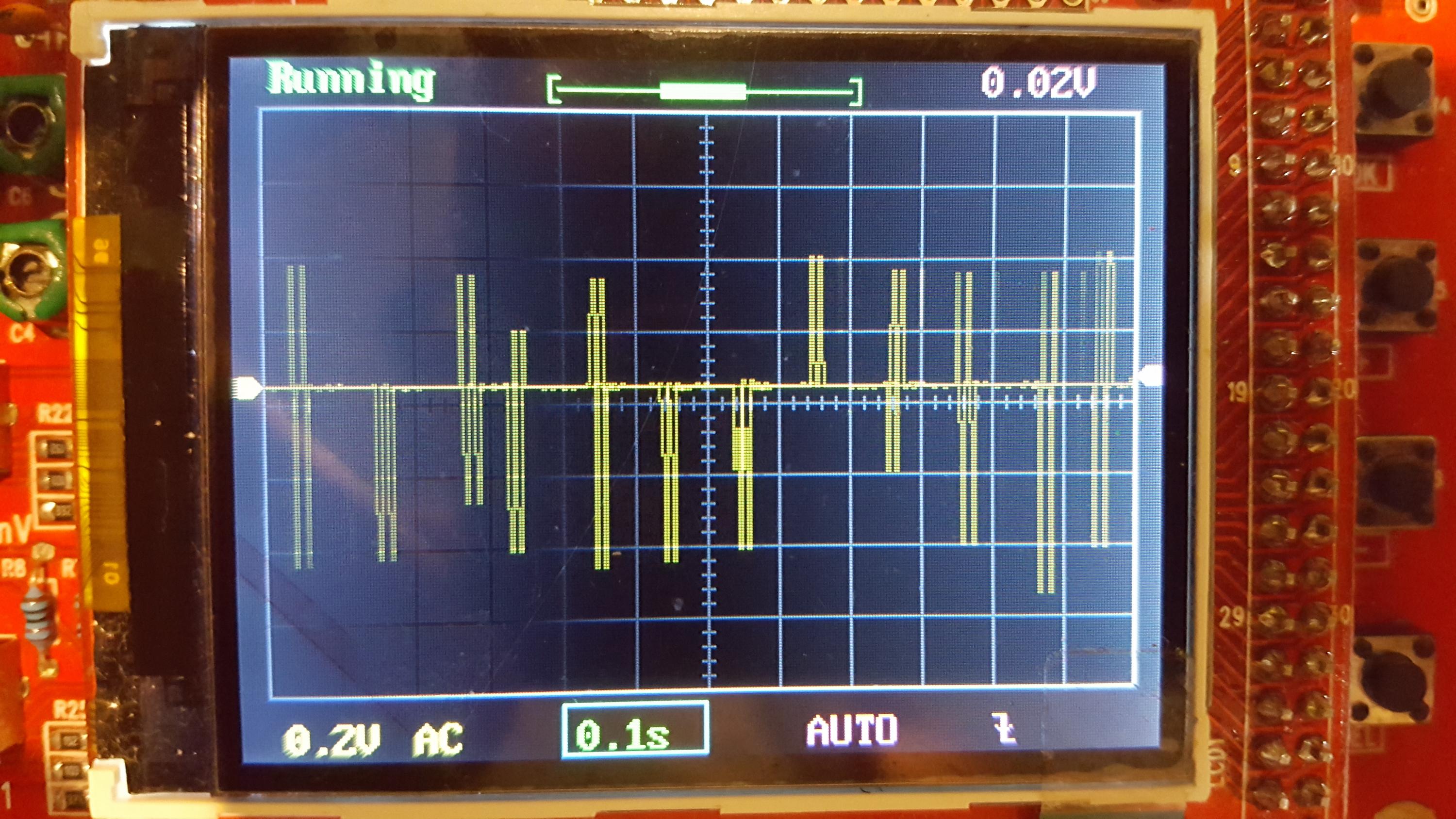

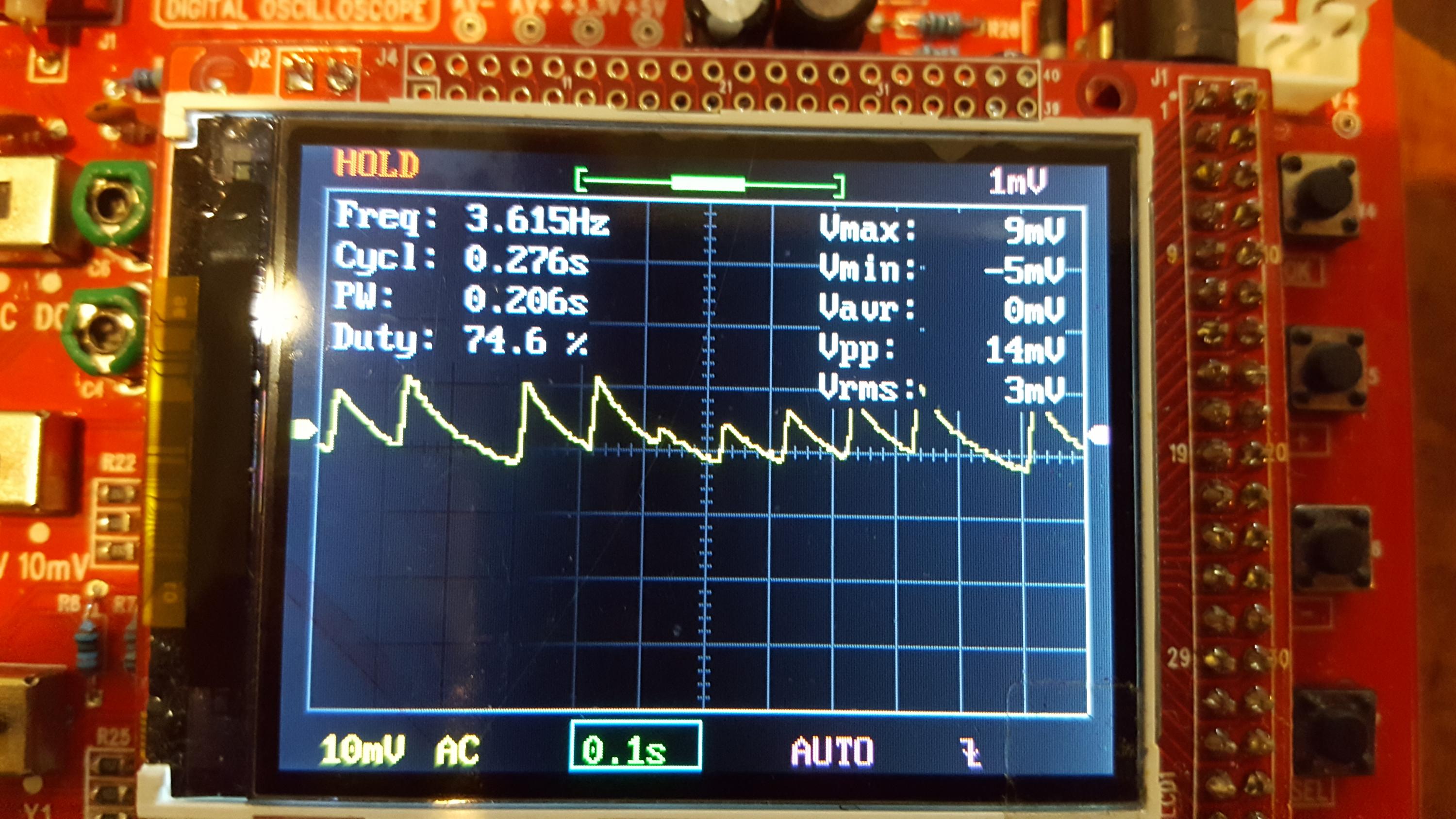

                        Here are two shots of the scope.
                        the 0.2v one is from transformer pins 9 and 10
                        the 10mv one is from c663

                          The optocoupler is there to provide regulation feedback, as the load on the 12volt or 2.5 volt lines change the voltage across the opto's led changes, this changes how the transistor conducts, varying the voltage from D662 to the ic's control pin.
                          What are you using for ground on that scope board? Like I said before I doubt it can measure 132Khz
                          The voltage on C663 will likely be around 7-10 volts when its working
                          Maybe you have a faulty to247 ic?

                              The ic will do its thing for a few cycles but needs to see the run voltage from D662 to go into proper run mode.
                              I don't know about R754 but resistors rarely go down in value, the go high/open so it could be a bad ic, this ic is used on a lot of power supplies.
                              Looking at your scope display, It seems the top ic is in Auto-Restart mode
                              I guess that scope can measure up to 200khz so it should be ok for this
