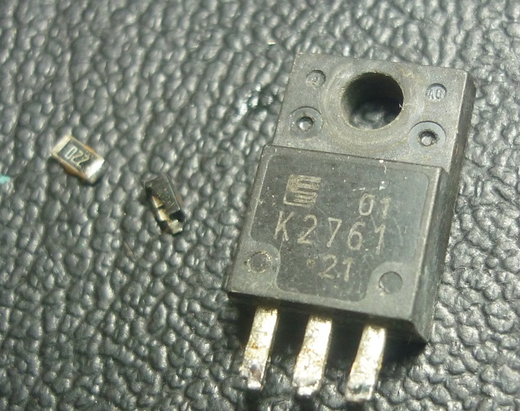

    Hello everyone, receive a warm greeting.
    I present a new case and I appeal to your help.

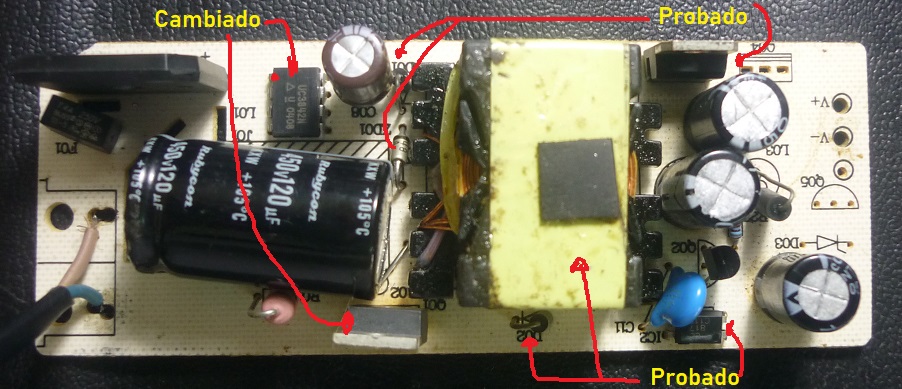

    I have this Chinese laptop adapter. Model: PA-130017. output of 20v x 4.5Amp.
    I received it unarmed and practically destroyed.
    Visually a diode in the primary stage exploded
    Mosfet in short.
    Test each component of the primary stage, the diodes are fine, zener and rectification.
    replace the Original Mosfet K2761 with a 07N60 mosfet. I am aware that it is of a lower magnitude than the original.
    replace diode D03, I extracted it from another adapter that I have for spare parts, with the inscription "A2" as it is a 1N4148.
    I measured the resistance that is parallel to that diode and is open, SMD 220, replace it with a conventional resistance of 22ohm 1 / 4w (Here in the city where I live, SMD components are not available).

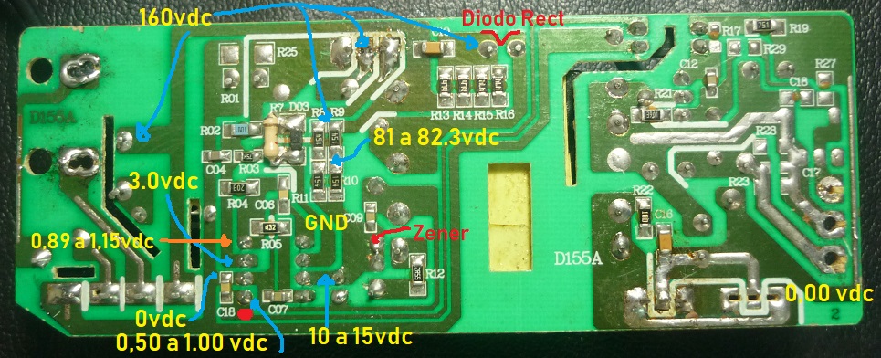

    I turned on the adapter through a series with 100W bulb and I had no output voltage or the zener diode that powers the KA3842 IC. Pin 7.
    Check the feed that reaches that pin and is 0vdc. Test the resistances and they are correct. R8 to R11.
    I removed the IC and connected the adapter and the voltage in pin 7 was set to 25 vdc.
    Probe continuity in pins 7 and 5 (VCC and GND) of the IC and had low resistance.
    I bought a new IC. UC3842N was the one I found. I installed it and connected the adapter to the electric power. I measure the voltage at Pin 7 and it ranges from 10vdc to 15vdc and it does not stay stable, replace the capacitor and it stays the same.
    The voltage on the output pin to the Pin6 mosfet. Oscillates between 0 and 0.50 vdc
    At the outlet of the adapter I do not have any tension.
    I have not plugged it directly into the electrical current without the series, for fear of damaging the IC.
    Annex images of the adapter.
    What else can I check or do?
    Thank you.

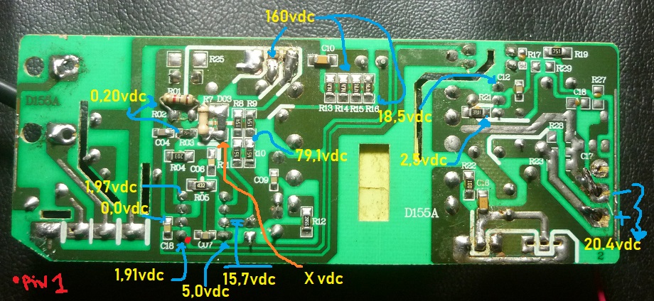

          Re: Power Adapter Chino No Working, Failed VCC IC UC3842 (Solved)
          Hi R_J.
          Thank you very much for the help, you guided me to the solution of the problem, although I had measured with the tester those resistances, it was when I took them out of the circuit and I tested them with a voltage source that I realized that they were not operating well, they passed some voltage but it was not complete.
          Example: My power source was on 4vdc and the other end of the resistor had a voltage that ranged from 2.5 to 3vdc. First time I see that behavior.
          Then when reviewing R02, it was open, replace it with an equivalent non-SMD resistor (it did not have that format).
          R03 is fine.
          After these changes, the pin7 voltage of the IC stabilized at 15.7vdc. And I got voltage on the secondary, stabilized at 20.4vdc. according to what the adapter label indicates.
          I attach photos of the tracks side with the voltages I got once the adapter started working.
