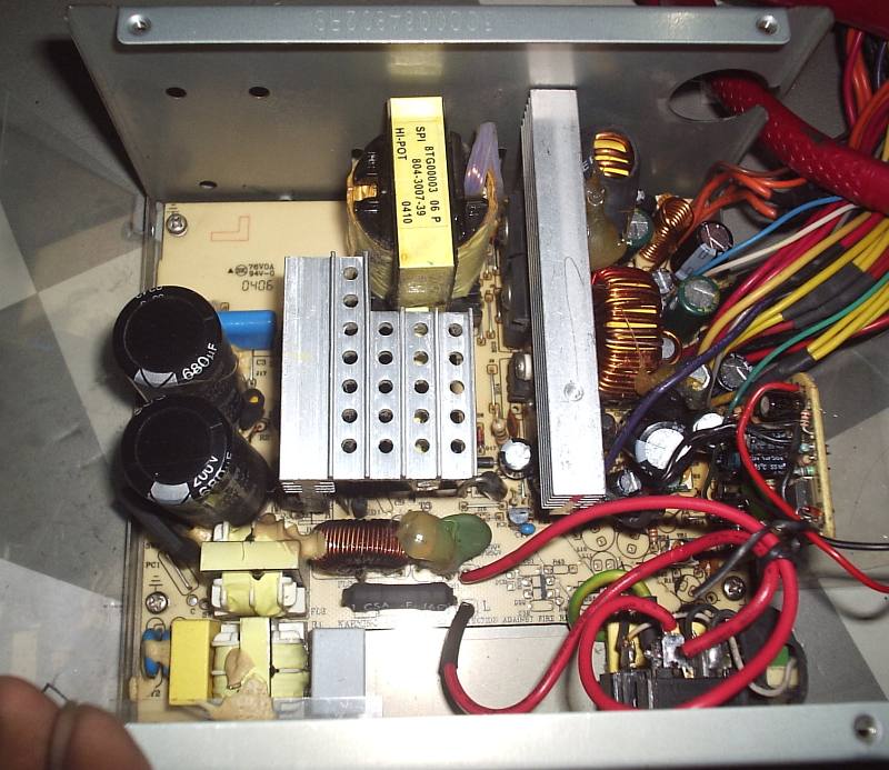

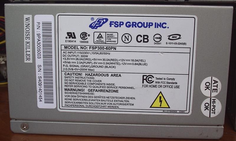

    FSP300-60PN, failed to start
    I bought the unit in need of building some PC system.. (see my thread here..)
    Well, that FSP unit didn't work when i tested it. I looked at the innard without opening the psu casing (it's easy because of the 120mm fan hole). And I saw two bulging teapos on the secondary side (one is a tall - grey colored and the other is short-light blue, i can't see what series they are).
    Let me explain what "did not work" mean :
    1. I plugged in the power cable to the PSU. I turn on the PSU switch and then sense the 5Vsb (purple) and the green wire -> my DMM showed +5V. So i connected my 25W (5V) and 10W (12V) dummy load. I jumperred the green and black wire on atx connector. Then, I hear a soft "click" from the psu, the leds on my dummy load blinking for a split second, but nothing more. The PSU is still dead. Checked the 5vsb, it was still 5v.
    2. I redo the step 1, but now without any load at all (zero load). The 120mm fan on the PSU is turning on and the psu lives! Then I attached my 0.48A 120mm San Ace fans while the PSU running. It turned on too. Then i attached my dummy load mentioned in the step 1. Everything works.. only for a mere 8-10 seconds and the PSU died again!
    3. I redo the step 2. Nothing happened, only a soft "click" sound from PSU. And as a desperate move i unplug the PSU from the main power, left it for 1 hour, and redo the step 1 and 2 for maybe a dozen times with different kind of load or no load at all. Nothing. It is still a dead PSU. I also tried loading the 3.3v but result is the same.
    I hope i dont confuse you
    So, my question is : do you think it is an easy fix or it has a deeper problem that can't be fixed by changing only the capacitors (including the small ost near pwm/5vsb regulator)?

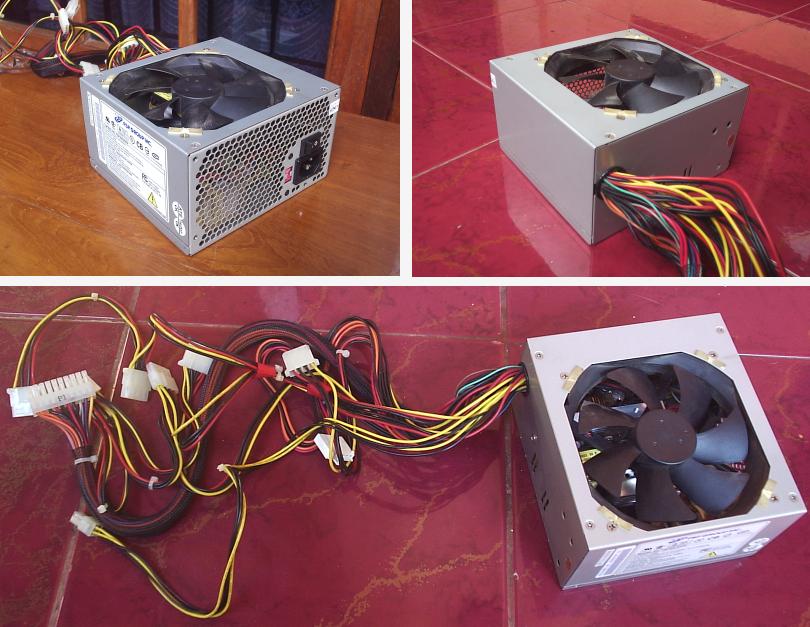

          Re: FSP300-60PN, failed to start

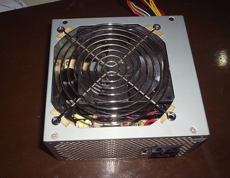

          Here the pics :
          days are so short when you actually do something..

            here you can find the specs for fsp300-60atv(pf):
            it says that the psu will shut down if the loads to +3.3v and +5v lines are not between certain limits
            hope this helps

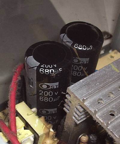

                      looks like i got three bad teapo caps there, no less...

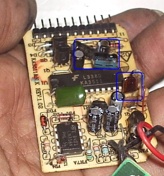

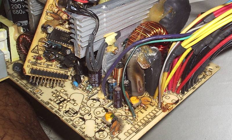

                                this is the secondary area where some caps been removed. also the 3.3v coil and some dummy resistors been removed :
                                those resistors are literally touching the caps. burnt marks is everywhere.
                                and this is the 5v and 12v area :
                                i have to unsolder the modul board (for VRM, i think). that big resistor is a 9.5 ohm, equal to stupidly 2.63W load. it's too high, too hot, to big, and too tight for it to even exist in such area. i was clapping my hand cynically for the enginer who designed this.
                                what was burnt :
                                ^ That poor teapo caps got pregnant. And that tall black thing is a 5V coil, it's transferred the heat to everywhere.
                                ^ ceramic cap was burnt and cracked easily while being removed. small electrolit caps were also damaged (such small caps can be pregnant too, if u never seen one).

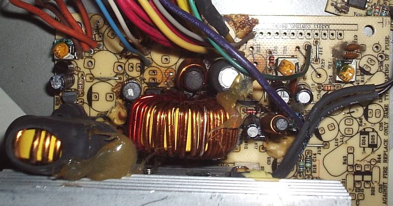

                                  the look before recapping :

                                    i did quick math : the only resistor that has below 1W load was only -5V dummy resistor. if you think such 1W - 2.6W are just small wattage, well that amount load can heat the resistor to over 60C. (i've tried touching them with bare fingers).
                                    the heat cooked the component near side and the pcb :

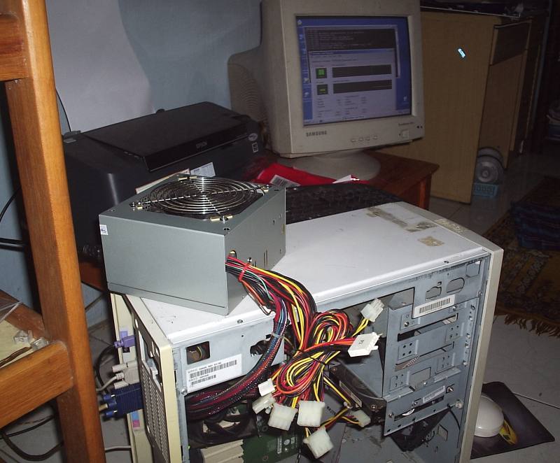

                                      After recapping :
                                      caps for 3.3v and 5v : 1500uF 10v Sanyo WX, 1500uF 10v Rubycon MBZ
                                      caps for 12 v : 1800uF 12v chemicon KZJ and 3300uF 16V Nichicon HE
                                      all the small caps (470uF to 10uF) were replaced with Rubycon YXF, chemicon KZE, KMF, and the like (don't remember the details).
                                      all the dummy resistors were dumped. never again i'll see them inside this PSU!
