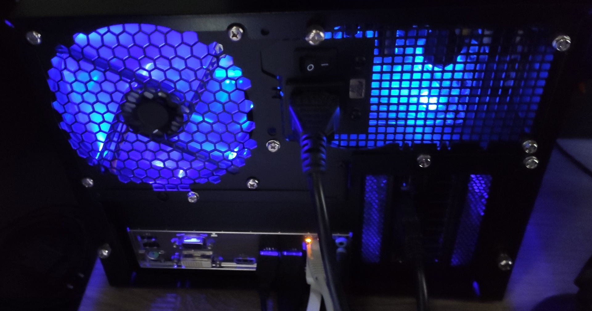

And it runs quiet, which i also didn't expect.
Clearly it should have shut down. But it kept trying.
After unplugging it and plugging it in again it works fine.
