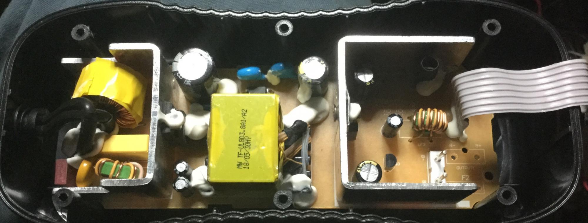

    How good is this battery charger
    Here are some pictures of it
    What do you know it has non brand name capacitors
    You know I have to recap it

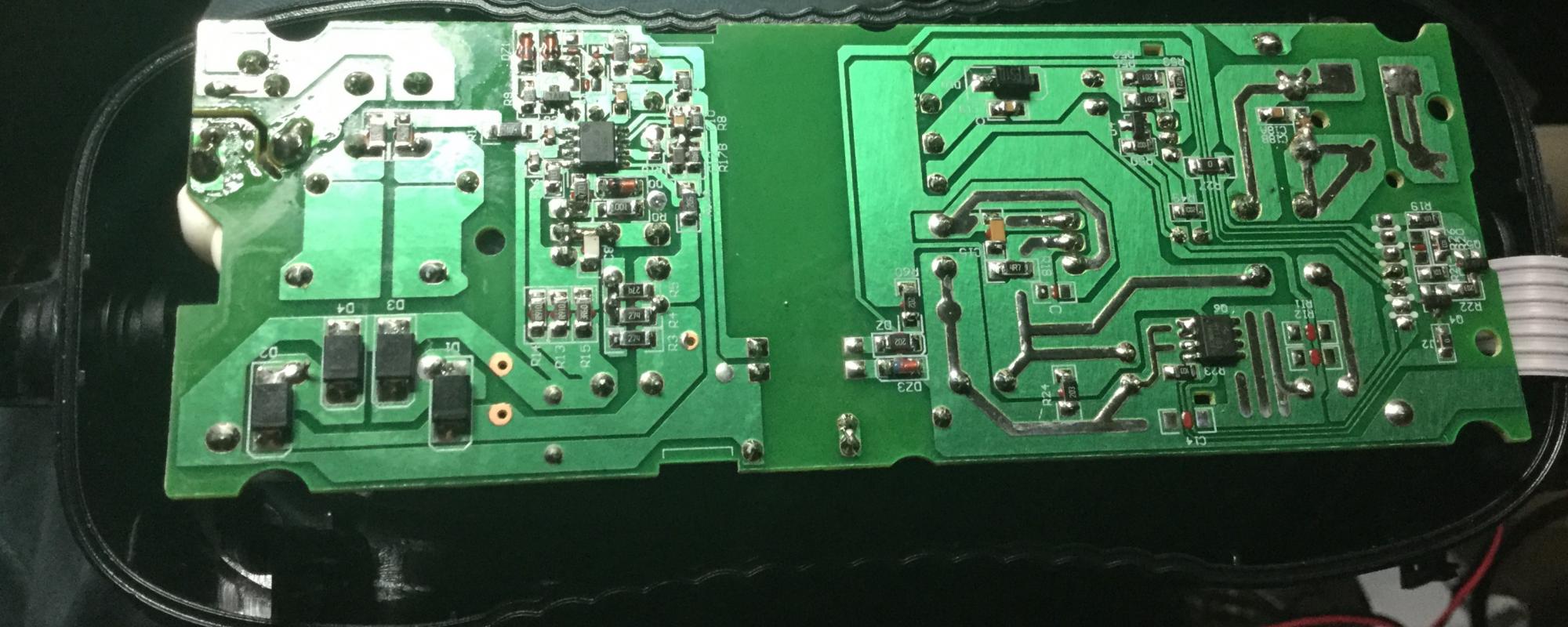

        It looks fine for something rated 50W output. I would re-cap it.
        The end-of-charge voltage 15.1V seems a bit high, or 15.5V cold.
        It needs some ventilation slots for cooling but nice heatsinking.
          I have already recap it
