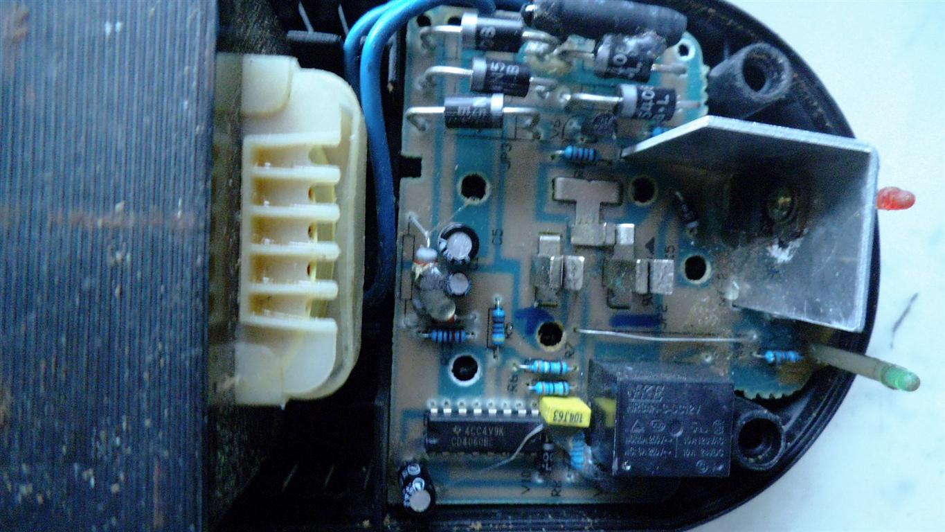

    Erbauer 18-24v battery charger
    Does anyone know how to get hold of an electrical schematic for this battery charger? I have Ryobi portable drills but the charger is missing so was wondering if I could use an Erbauer charger which I do have instead. The battery connections can be altered on the charger but the Ryobi batteries are charged through a temperature detector on the negative line. The Erbauer charger has a 3rd terminal but its positive.

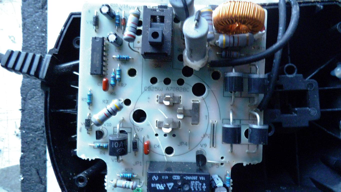

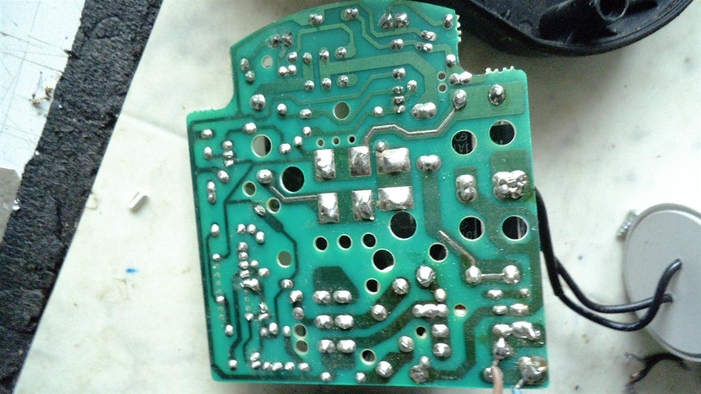

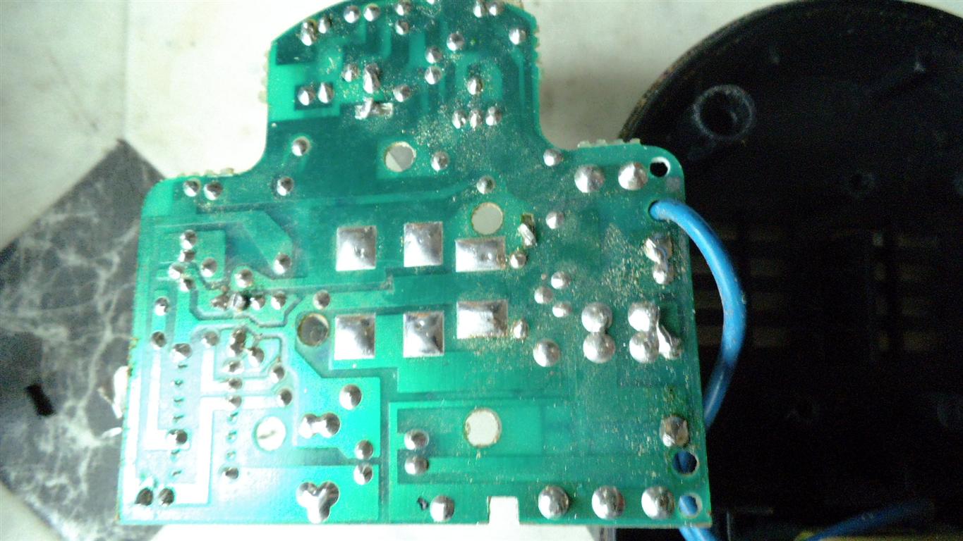

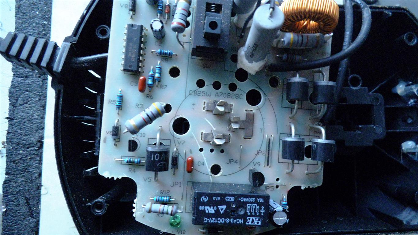

        Re: Erbauer 18-24v battery charger
        Thanks for taking the trouble to reply. They're Ni-cad batteries. I don't know how the 3rd terminal works, I thought getting hold of a schematic would help me understand. On the Ryobi charger the negative went through the 3rd terminal via a temperature fuse to the negative of the batteries.
        On the Erbauer when powered on I get 26v across + & - and 26v across the 3rd terminal and - , so I've assumed the 3rd terminal is +.
        I've got 2 Erbauer chargers, 1 has an ac transformer the other has no transformer but instead a massive capacitor 45micro farrad x 450v.
        Here's some pics of both.
            No I'm afraid I don't. I stripped the Ryobi down which is how I know that charging is thro the 3rd terminal.
            I keep searching the net in the hope I'll find a schematic. Can you reverse engineer the circuits in the photos I posted?
              Not really this why you need a battery for this charger because it can be a few different ways it can be done one way is just use a thermo switch or a resistor type sensor or “k” type or something similar
