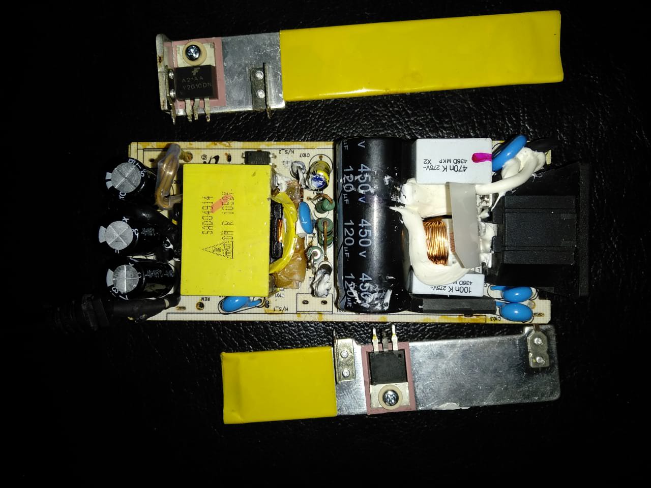

    Anyway, since the psu is external I said what the heck lets open it, and found these:

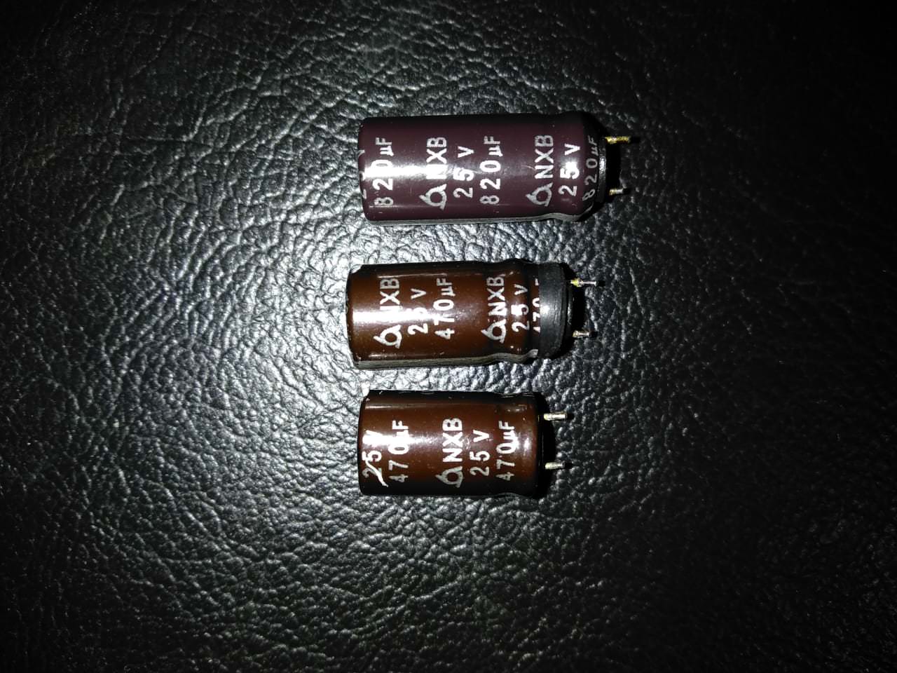

    Two were a bit swollen and had the rubber seals pushed out, the other looked fine but I replaced it anyway. I replaced a 820uf 25v with a 1000uf 36v because I couldn't find the 820uf anywhere, and since these caps have a tolerance of like +/- 20% I thougth it would be ok, and two 470uf 25v with the same, all with same temp rating.
    I thought this would fix the issue but the monitor would still occasionally turn off and back on by itself. So I opened it again and removed the two heatsinks, one with a rectifier diode (Y2010DN) and a mosfet (FQP 8N6OC), to remove some of the white adhesive and have a better look.
    I didn't find anything wrong visually so I put it back together, but before doing that, I removed the diode and mosfet from the heatsinks (for some reason I still don't know). In that process, I broke (what I now know are) the insulation pads. I thought it was just for thermal conductivity so I replaced it with some cpu grease. And when I plugged it in, a spark noise and some smelly smell came out of it. Now it's dead.

      Yeah... these insulator pads are there for a reason. same as the plastic screw insulator that's with it. Other than that, things go poof!
      Well, I guess the damage is done and no it is not going to be easy as just replacing a diode. The Fet is gone and the gate drive circuit and the gate drive IC. Maybe some more smaller stuff like some small diodes and resistors on the back side of the board as well. It's not looking too good.
      This happening occasional again thing... would have probably something to do with the backlights.
            It's also possible that the small electrolytic cap between the transformer and primary bulk cap is bad as well, given that the others are. This small e-cap is the "start-up" cap and also what maintains power to the IC/controller going for the PSU to work. So when this cap goes bad, it's possible for the monitor to not start reliably every time. Thus, you should replace that one as well.
            As far as replacements... I can't see what brand and series you used for your new caps above. Generally, we only recommend quality Japanese caps here (like Panasonic, Rubycon, Nichicon, and United Chemicon), because other brands (especially cheap caps from China/Taiwan) have proven to be very unreliable, even when new sometimes.
            That said, it is unlikely that your new caps are already bad... but it is worth noting what they are anyways - should give us give you an idea of how long your repair will last (that is, if we fix the rest of the PSU, of course).

            If you removed the insulating pads both from the MOSFET and the diode, chances are the MOSFET is likely blown now. Along with it, the fuse and possibly the MOSFET's Source resistor and controller too.
            Your best bet here is to start removing parts again and check what has gone bad. Simply putting new parts in without checking the old ones will very likely leave you disappointed with more sparks and "kabooms".
            On the positive side, this is now a good time to further develop your component testing/troubleshooting skills, if they aren't yet. On that note, you can measure some parts in circuit. But if the reading seems suspicious, it's best to take them out and measure them that way.
