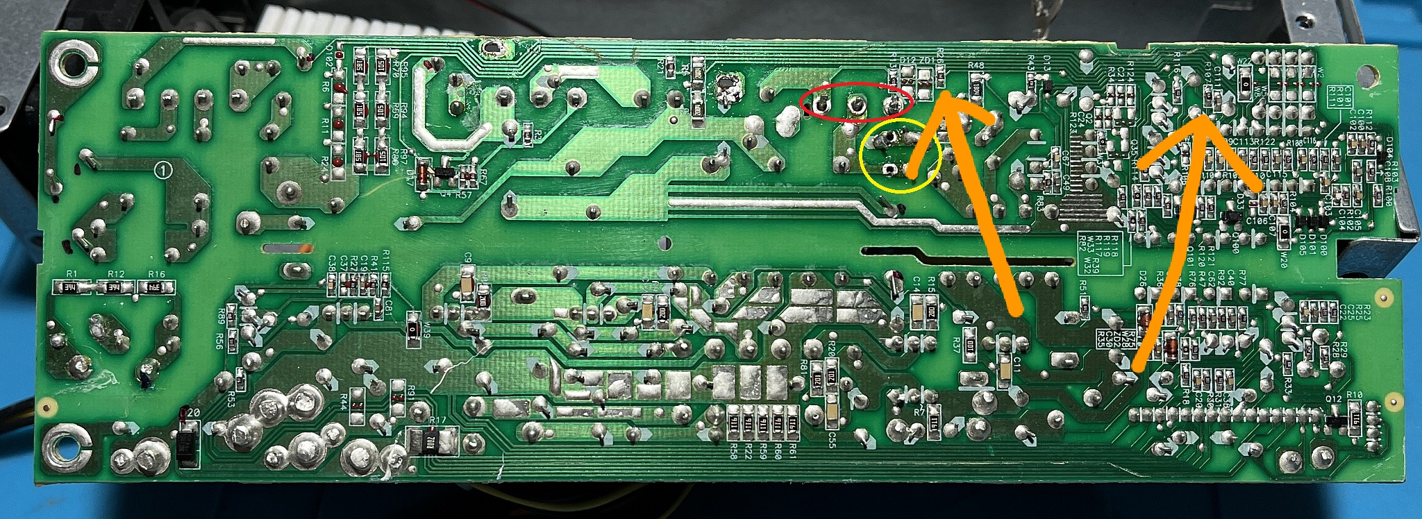

                  Hi guys. Can u tell me what value is in R107 and R26 ?
                  • kaldeis
                    • Feb 2023
                    • 2
                    • Poland
                    #69
                    Re: psu ac240as-01 dell Optiplex 7010 pc tower
                    in attachment
                    • Air-Sidney
                      • Jul 2019
                      • Россия
                      #70
                      R26 - 39 Ohm
                      R107 470 Ohm
                      R105 or w14... - 0 Ohm

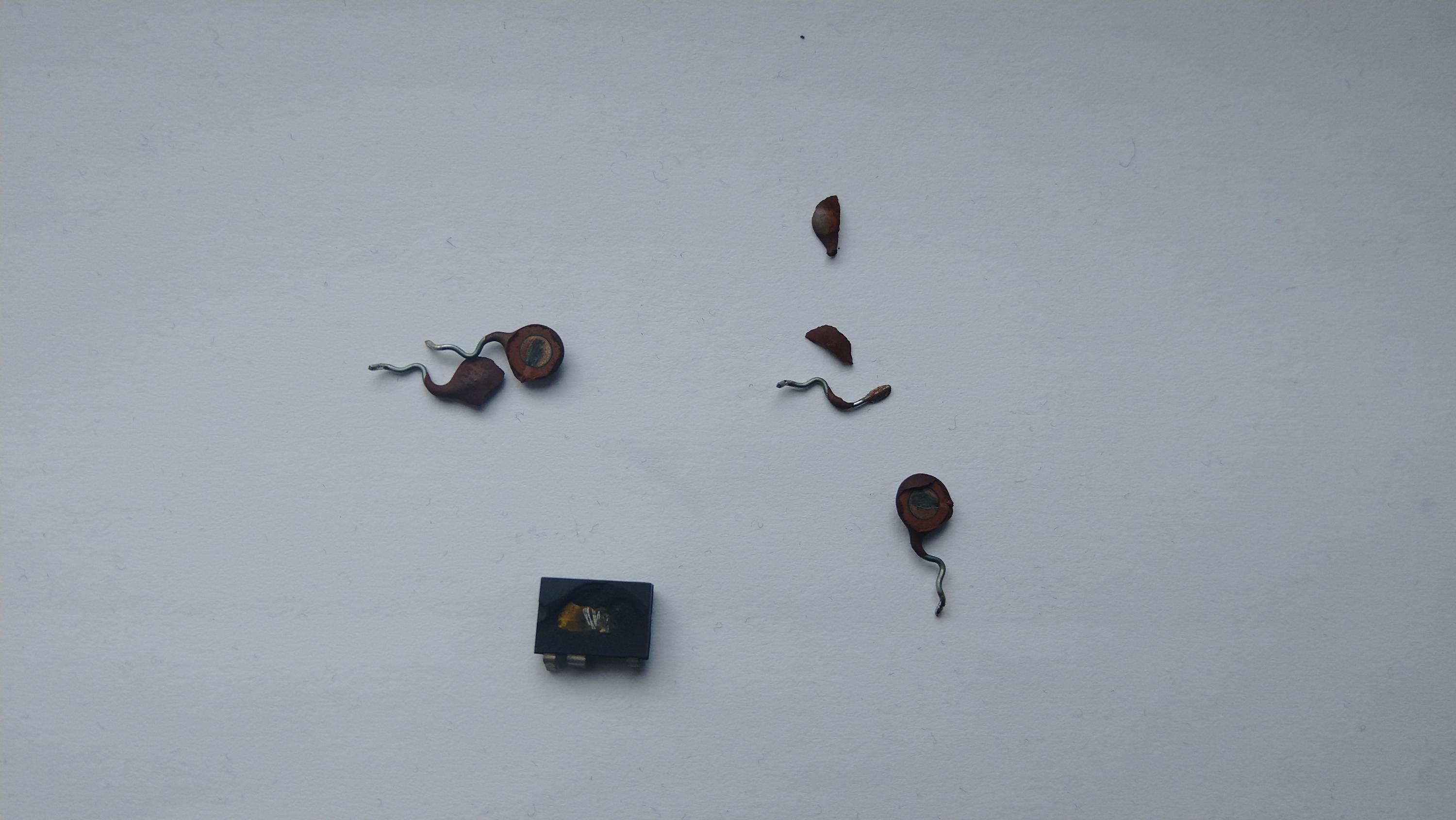

                        Today got the same PSU with exploded M5 tny280pn which may be caused by broken C6 and C10.
                        On one the piece was marking 331K 1KV
                        Waiting for parts to replace
                        seems like this caps is crap in this PSU
