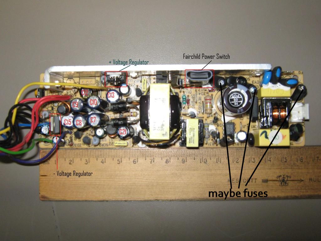

I have been repairing the power supplies in about 100 Neoware Eon 5000. I've gone through 61 of them thus far, most of them when powered up the power light blinks and you can hear a clicking sound from the power supply....those are a simple recap....anywhere between 1 and 8 caps replaced on each unit and they fire up like new.....however, I have 11 units that when powered up do nothing at all. I dug into one of these replaced all the caps that have been blowing on the other units, replace the + voltage regulator, the - voltage regulator, and the Fairchild Power Switch.....and still no power......if the power supply is swapped out with a known good unit....it works so the problem is in the power supply somewhere.....any thoughts???
Heres a photo of the unit if that helps
Thanks for any input in advance,
Paul
