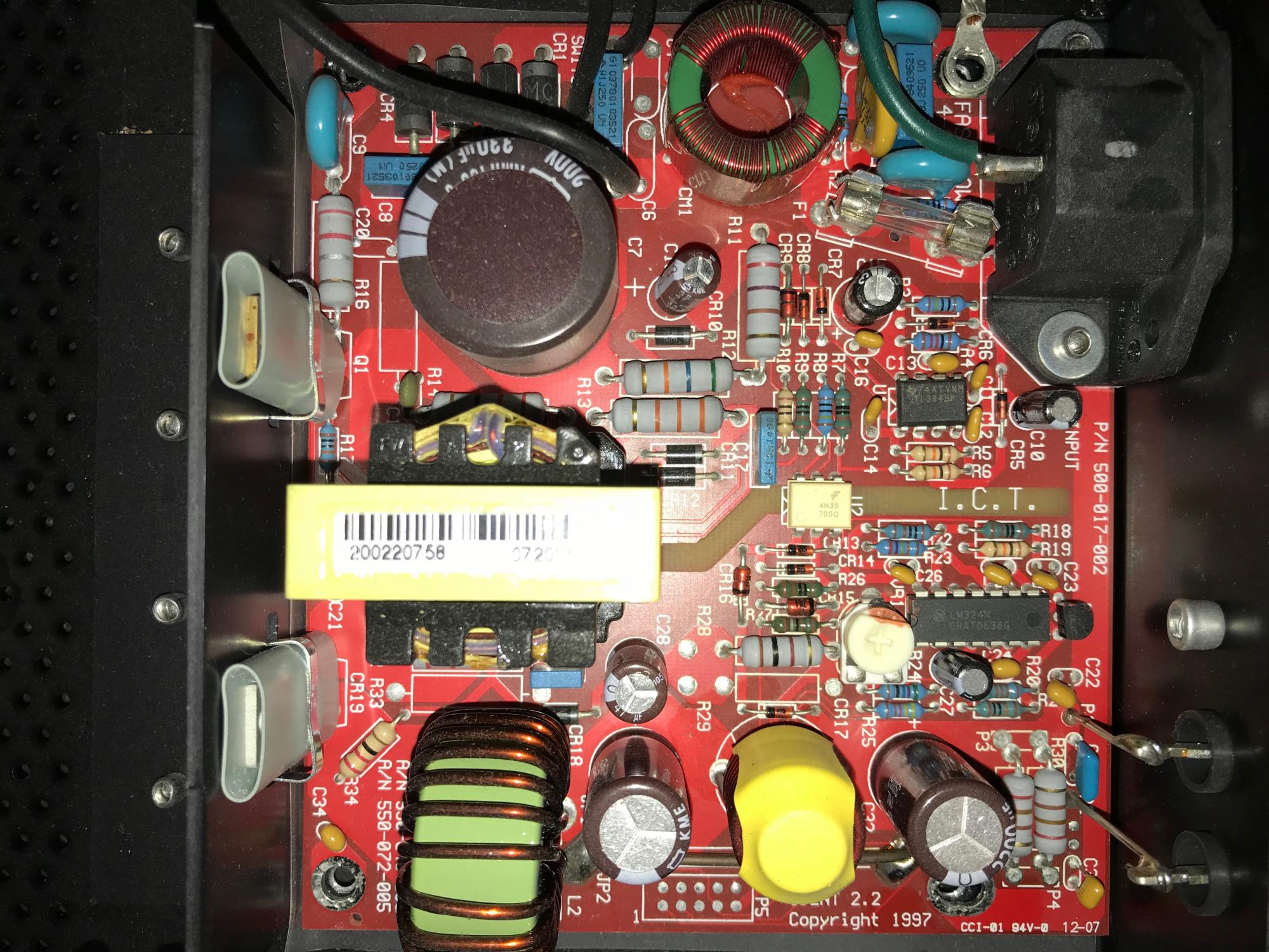

    Here is a ICT Comm Series, model ICT12012-10A power supply.
    Complaint: Folds back to 9.3V under load (40W VHF radio).
    So I open this up and see nothing visual. Took another look with my ESR meter. AND? Yeah, all caps besides the main filter cap are bad. It got a full recap, including the main filter cap.
    Replaced: C7 200V 330uF, C10 35V 22uF, C15 35V 100uF, C18 35V 47uF, C 27 35V 10uF, C28 63V 47uF, C32 and C33 16V 2200uF.
    Another PSU saved from being tossed into the bin.

        Re: ICT12012-10A Comm Series folds back under load (fixed)
        I have another exact same power supply on my bench with the exact same problem as the original one.
        I did the same thing, recapped everything. Just this one had a new "feature"! After the recap, the PSU worked just fine as long as I didn't exceed roughly 4 to 4.5A. After that she instantly dropped down to 0.5V. After a couple of educated guesses, I found out R28 to be the problem. Replaced it and all is good.
