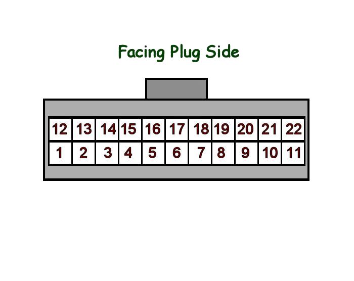

                              Can you test the PS - e.g. do you have an ATX PS tester? That would be the simplest way of checking to ensure the PS is working.
                              I know on PC ATX supplies, you can short the PS_ON with a GRND pin on the connector to turn it on (with a load on it - fans, CDROMS, etc... connected).
                              I also have a special PS tester with all the connectors, but it doesn't work with these proprietary Apple PS's so I'm not sure how you'd do it with these PS's - I got the pinout diagram, but since I couldn't put a load on it, I didn't want to turn it on that way.
                              Anyway, I'm sure the guru's here could walk you through testing the PS.
                              A question - when you plugged the PS back into the MB, did you still see the first diagnostic LED come on? (referring to those 4 white LED's on the MB)
                              If so, have you tried resetting the SMU? That did the trick for me after my repairs...

                                    See uploaded image.
                                    With unit plugged in and turned on (jumper):
                                    1 : 2 : 12 = 3.3v
                                    3 : 5 : 7 : 11 : 14 : 16 : 17 : 18 = ground/common
                                    4 : 6 : 20 : 21 = 5.1v
                                    8 = Power Good (5v)
                                    9 = 5v StandBy
                                    10 : 13 : 19 = 12v
                                    15 = Power On (short to ground/common to run)
                                    22 = 24v
                                    Toast

                                      Here's the Apple PS pinout diagram I use (see attached pic).
                                      It actually fits into my little ATX PS tester (round/square pin designations line up on the 20pin side (not 24pin) but I couldn't get it to power on so I didn't futz with it.
                                      I'm not sure if this is true with these PS's , but I was always told it was bad to run PC PS's without a load, so with an ATX, I'd always hook up a few devices before powering it on to test the rails.
                                      Would harm come to a PS with no load, such as if you were able to get this Apple PS going by shorting the on/off and GND?
                                      Also, you say there are no diagnostic LED's. Just to clarify, when you hook it up to the MB and plug it in, you don't even get the first white LED on? That would be a bad sign.......
