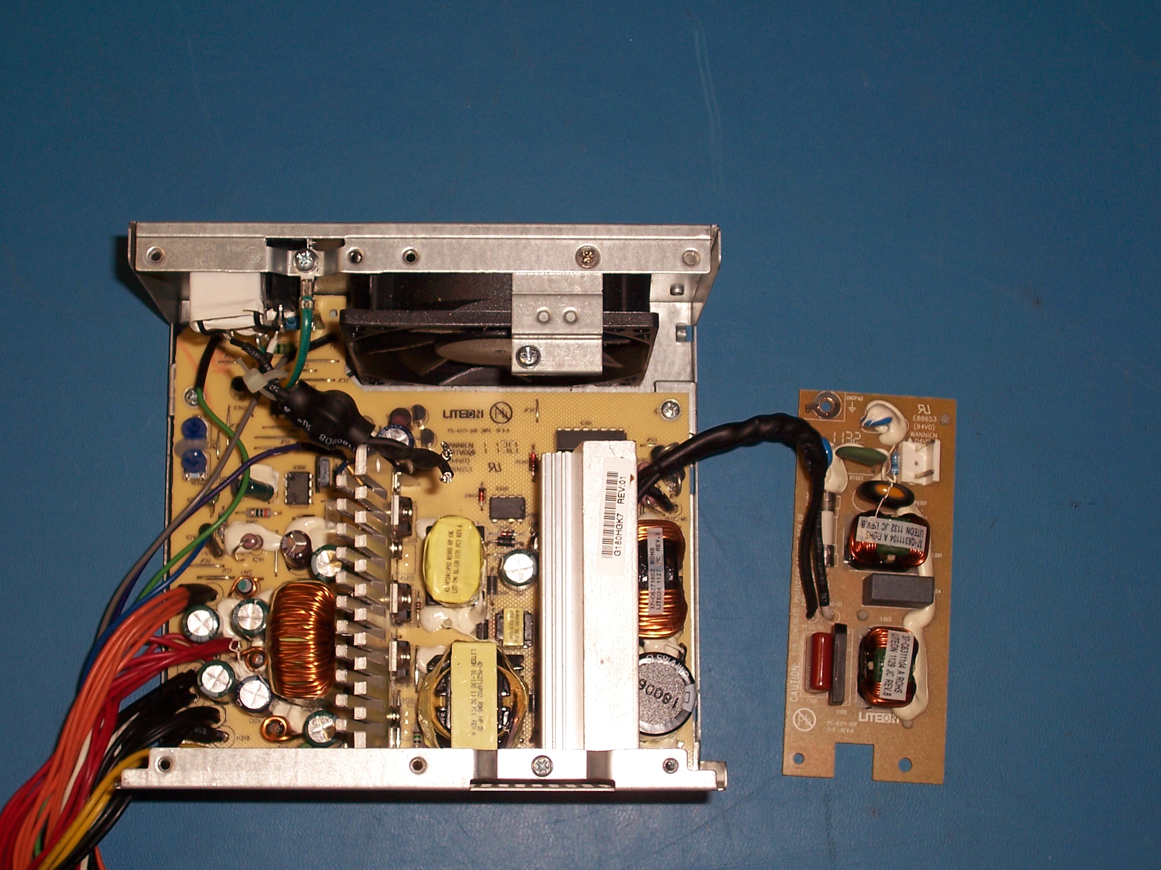

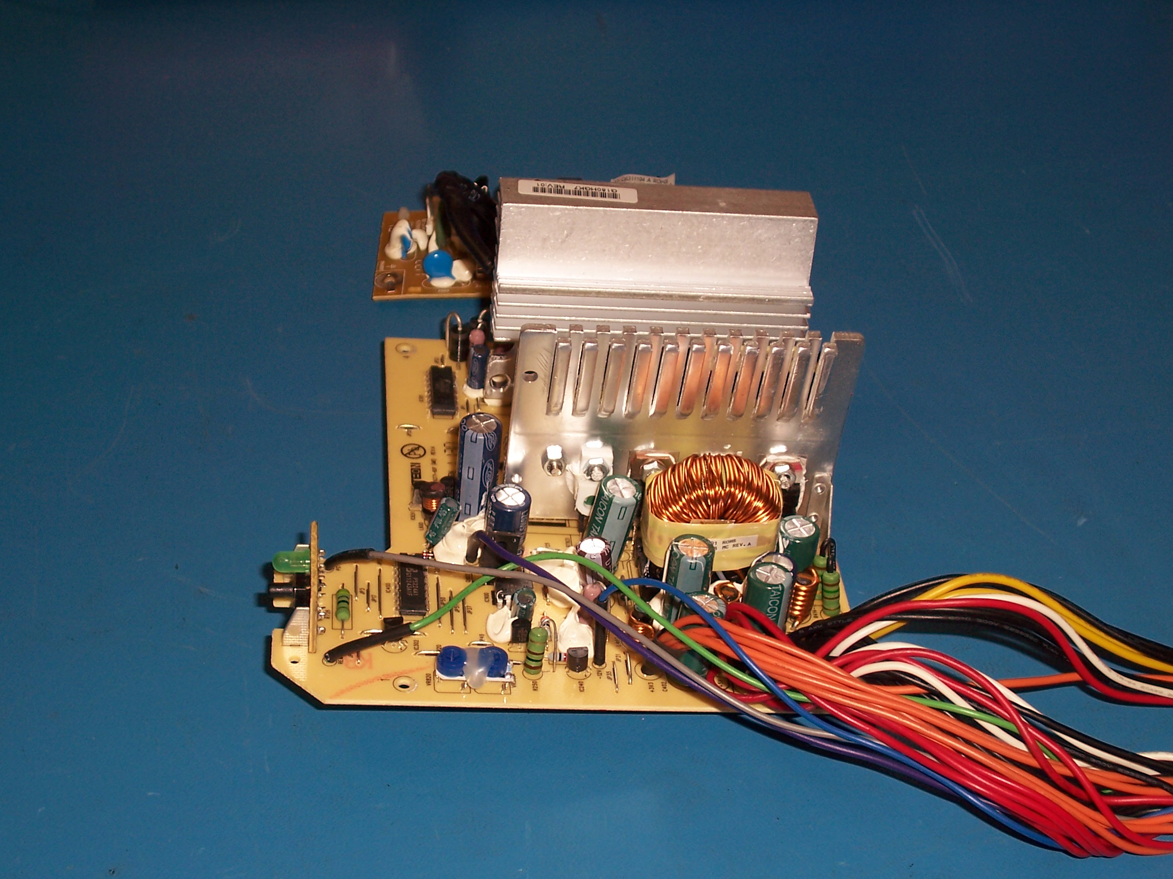

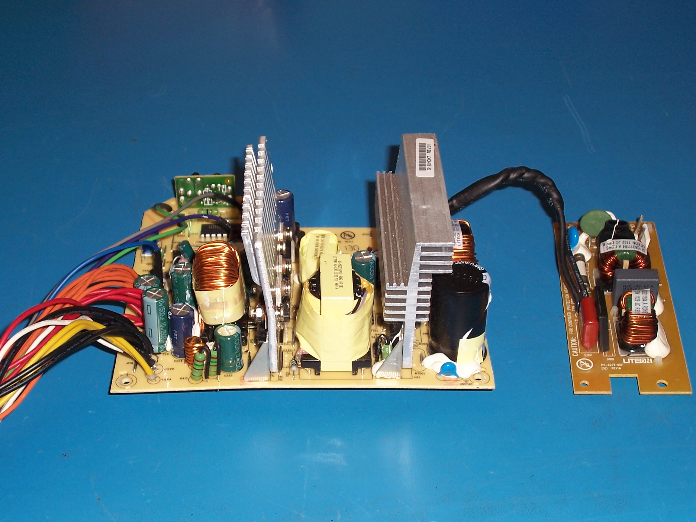

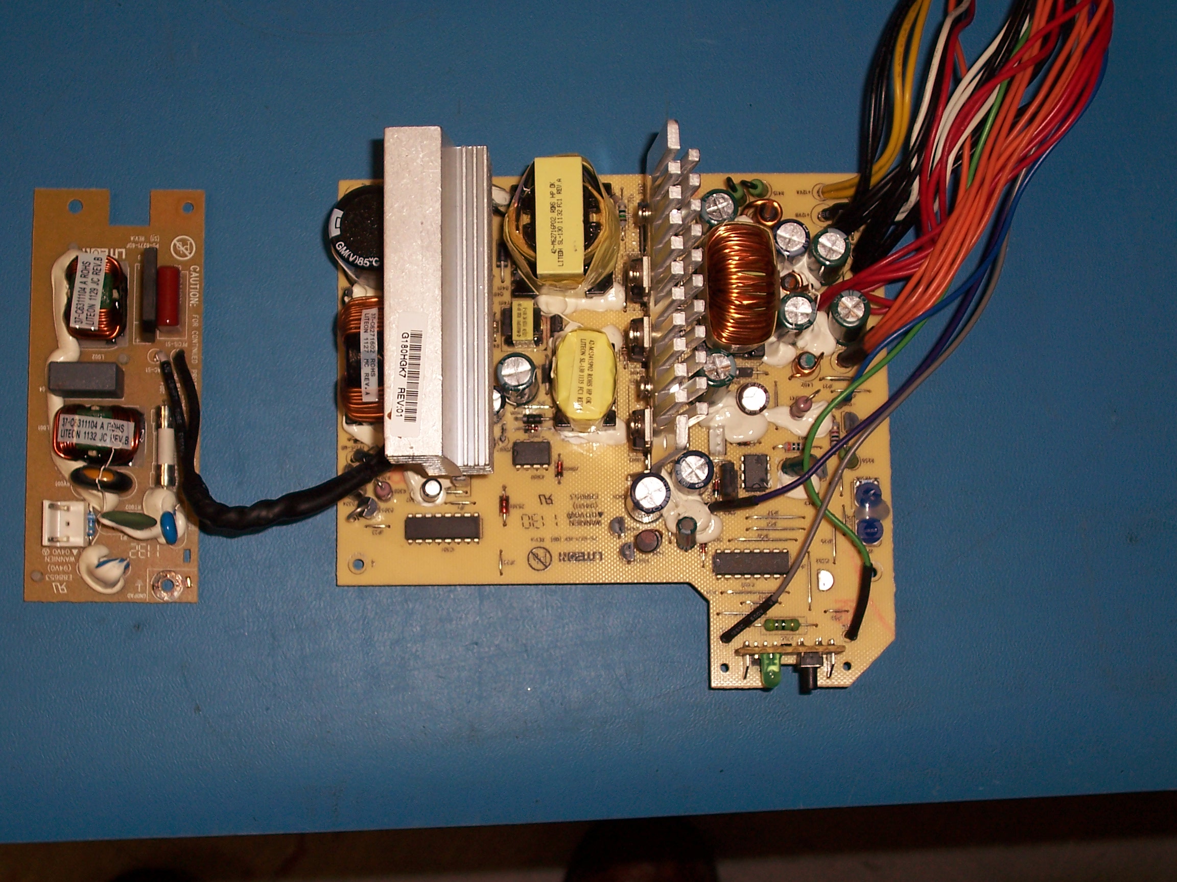

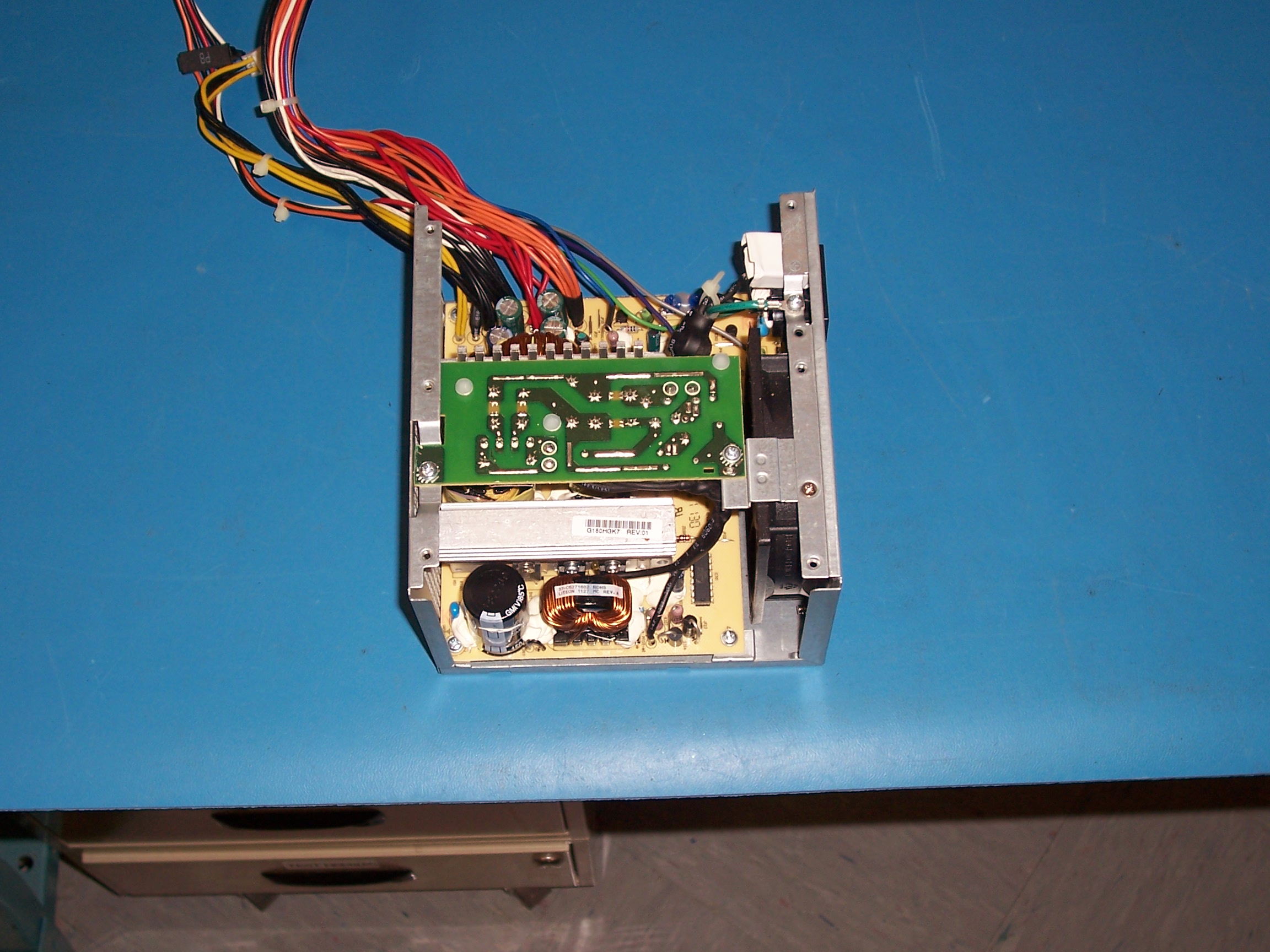

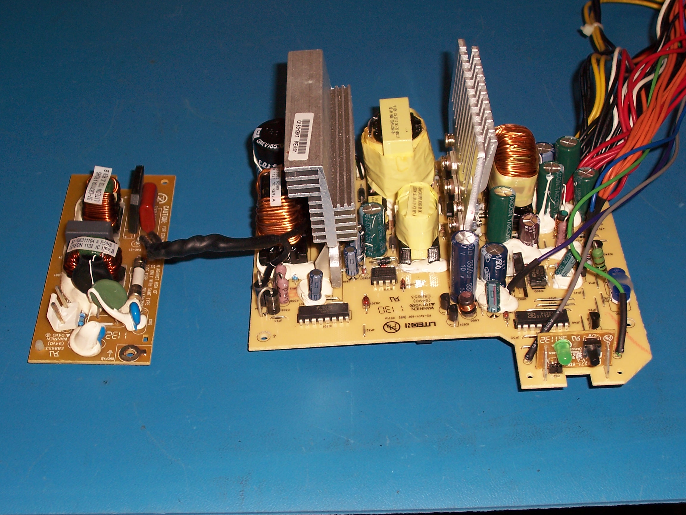

Dead Dell power supply
  • everell
    • Jan 2009
    • 1514
    Its a Dell...Dude

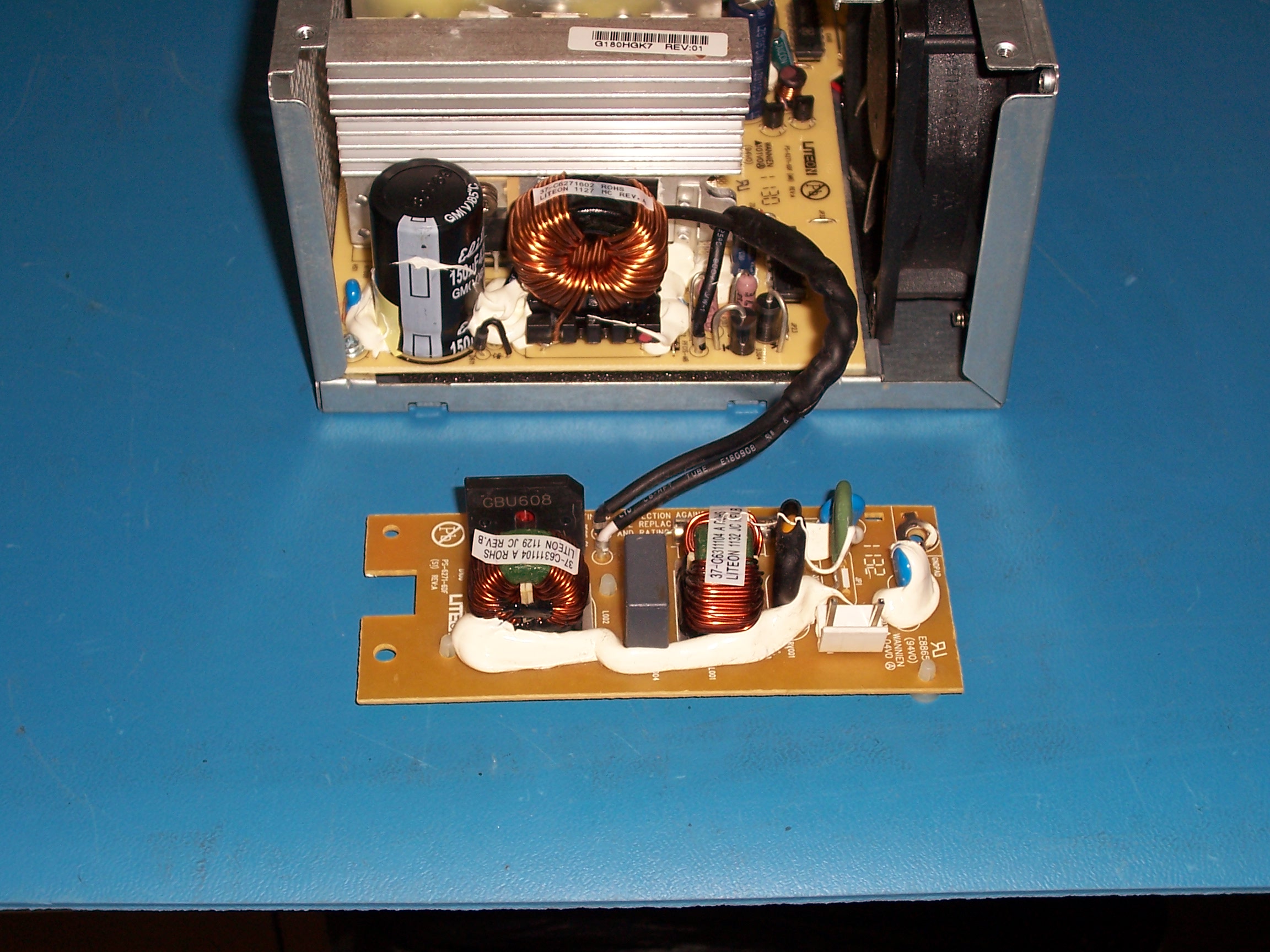

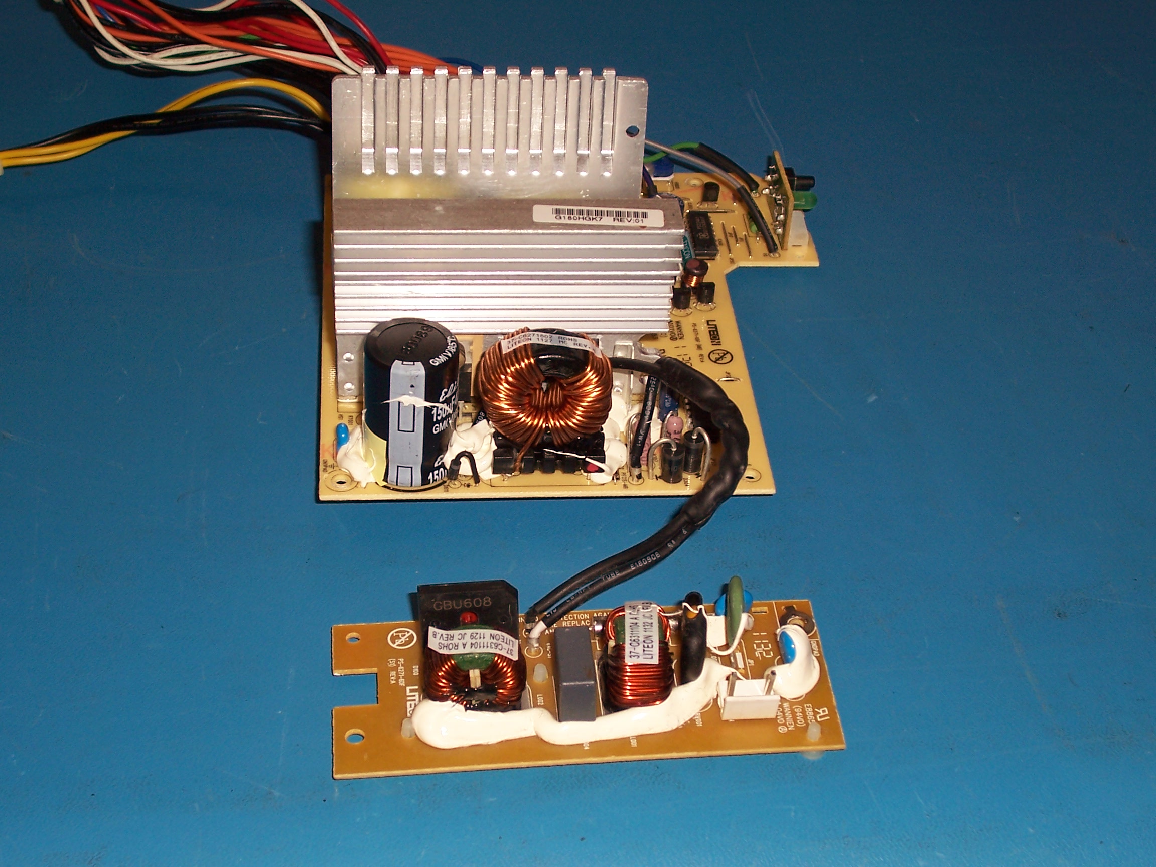

    Its a DEAD Dell power supply with a blinking green LED on the back of the case. She is a Dell 265 watt, DP/N 0053N4, OEM is LightOn. Pushing the small "reset" switch next to the green LED on the back of the case did not help any.
    Time for surgery. The LED on the back indicates status of the 5VSB circuit. The "reset" switch next to the LED is not a reset switch, but acts like a PS_on switch, or like shorting the green wire to ground to turn on the power supply. The blinking LED on the back of the power supply indicated that the 5VSB was pulsing.
    The 5VSB circuit uses an Infineon ICE 3AR2280JZ-1 chip. I traced the circuit to determine what was there. See attached drawing. Then began preliminary checks for shorts using digital voltmeter. I quickly found that diode D600 coming off the feedback winding of the 5VSB transformer was shorted. This diode is a UG1D 200 volt 1 amp switching diode. Since I didn't have one handy, I substituted a 1N4935 switching diode with similar specs. Applied power and now she works just fine.
    So here are some pictures of the power supply. And remember, it's a Dell...Dude

    Re: Dead Dell power supply
    Thank you for the pictures and the schematic. Nice you got it fixed!

      I recommend replacing the 1N4935 fairly soon with a more similar part. The 1N4935 in a 200nS fast recovery rectifier. The UG1D is a 15nS ultrafast. The 1N4935 will run hot and could fail relatively soon. Get a replacement with a reverse recovery time of 25nS or less.

        Nice save, everell!
        I also can't praise you enough for the quality of the pictures you upload - top notch, really.
        Nah, if that diode was for the primary side aux. winding (aka "feedback" winding), then it shouldn't be a problem at all.
        I had a 250 HiPro PSU with a problem like that - shorted diode from the primary side aux. winding that was feeding voltage back to the PWM/FET combo IC. I don't know if the 5VSB was ticking in mine, as the HiPro didn't have an LED indicator for the 5VSB, but the 5VSB was showing less than a volt or so on my multimeter.
        So what I did is I replaced that diode like everell and got my PSU running again. If I remember correctly, the original diode was a UF200G (200V reverse voltage, 2 Amps current, 50 ns reverse recovery), but the best I had on hand at the time that I could easily fit in there was an FR153 diode (same 200V reverse voltage, but diode only rated for 1.5 Amps and 150 ns recovery time). Despite knowing that my replacement diode wasn't as good as the equivalent, I read the switching 5VSB IC's datasheet, and it made no mention of what the rating for that diode should have been. Give the amount of current the IC needed from the aux. winding, a 2 Amp diode definitely seemed overkill. So I applied power to the PSU (with a series bulb) and the 5VSB came back working fine. After 30 minutes, I decided to do a real test and plugged the PSU in the wall directly. Then I added a 1 Amp load on the 5VSB (with a 12V halogen lamp), and it worked fine again for a good amount of time without anything overheating. After this, I tested the PSU in a computer and it worked fine too. This was back in 2010-2011 or thereabouts. Ever since then, I've used that PSU in various temporary and permanent PC builds, and it has never skipped a beat. I still have that PSU and still use it for testing unknown hardware all the time. Soon (as in within the next year or so), I may find a computer to put it in again for permanent use. If it hasn't failed until now, I doubt it will fail soon.
        ... well, maybe not if the output Teapo and Asiacon caps fail (but I may actually recap it).
        On that note... those blue Ltec caps in everell's PSU should be recapped on sight. I recently got a big batch of mostly 5-8 year old Dells and HPs, and a lot of them had bad Delta, HiPro, and LiteON PSUs - mostly bad caps looking through the vents, and quite a few of them were these blue Ltecs. So when I see them now, they are "recap on sight".
