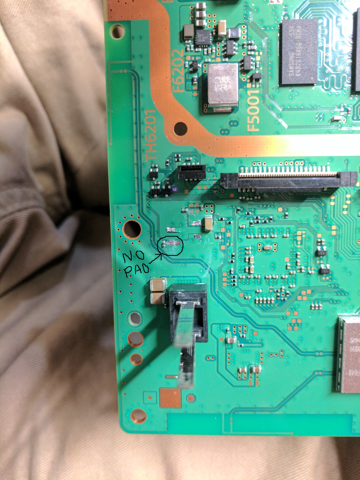

    anyone have a pinout for the ps4 sac-001 power supply 4 pin port?
    ps4 dropped off with a powersupply 4 pin port ripped off the board. 3 of the pads are still there one is not. looking to solder a wire to a via or something to get this going again.
    any pinout diagrams for this board around

    it's in your foto, it goes to the ceramic cap & track to it's left.
