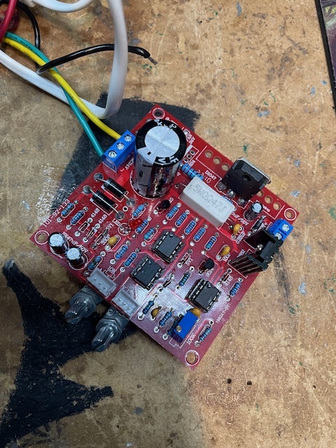

    Hey guys! i build a 30V 3A powersupply. My friend blown it... He connected cables to the wrong connectors. I changed the op amps, shorted zener diode and a 9014. Now the powersupply works again but only to 6V. When i measured the caps they looked in spec. But after i connected 2200uF cap on the main power rail parallel to the C1 - 3300uf one - output voltage is now regulatable to 8v. Any idea where to look ? or what to do ? R1 and R2 are getting hot. The input of the transformer is 40V after rectifiers. Its a 24V transformer on 230V mains voltage.

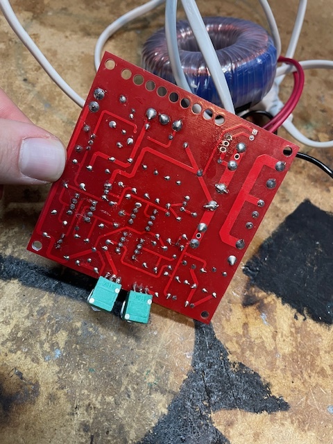

      Post the full PSU model number,PCB model number and pictures of both sides of the PCB

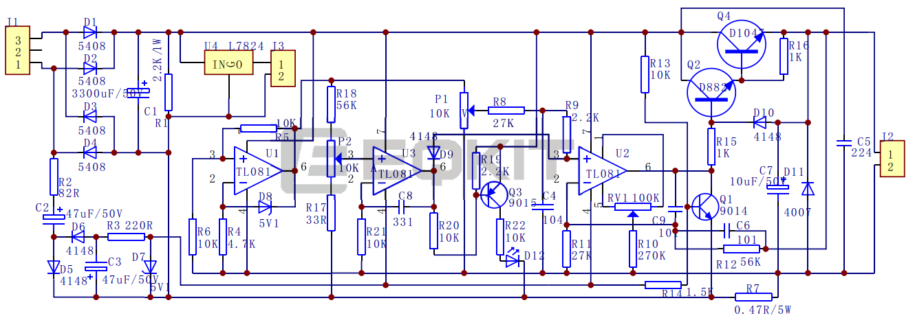

          I recognize the schematic as the infamous "0-30V 2mA-3A" power supply kit board. It's a chinese copy of the Practical Electronics Nov. 1978 design but not using 741's.
          OP if you take voltage measurements on all the IC's pins and post them here, can figure what is wrong. Use the output(-) as multimeter(-) common, and careful not to short stuff out with the (+) probe.
          Make sure the -5.1V rail is working zener D7 should have 5.1V across it. If that rail is not working U2 will get very hot.

                I replaced all of the OP amps for "LM741CN" - because of the high input voltage. Its still 1V over the max but i think it should work for a little while
                Yes thats exactly right (That it is the chinese powersupply kit). i am sorry for not posting photos of the board. Idk why i didnt.
                Both of the zener diodes have 5.1V across them.
