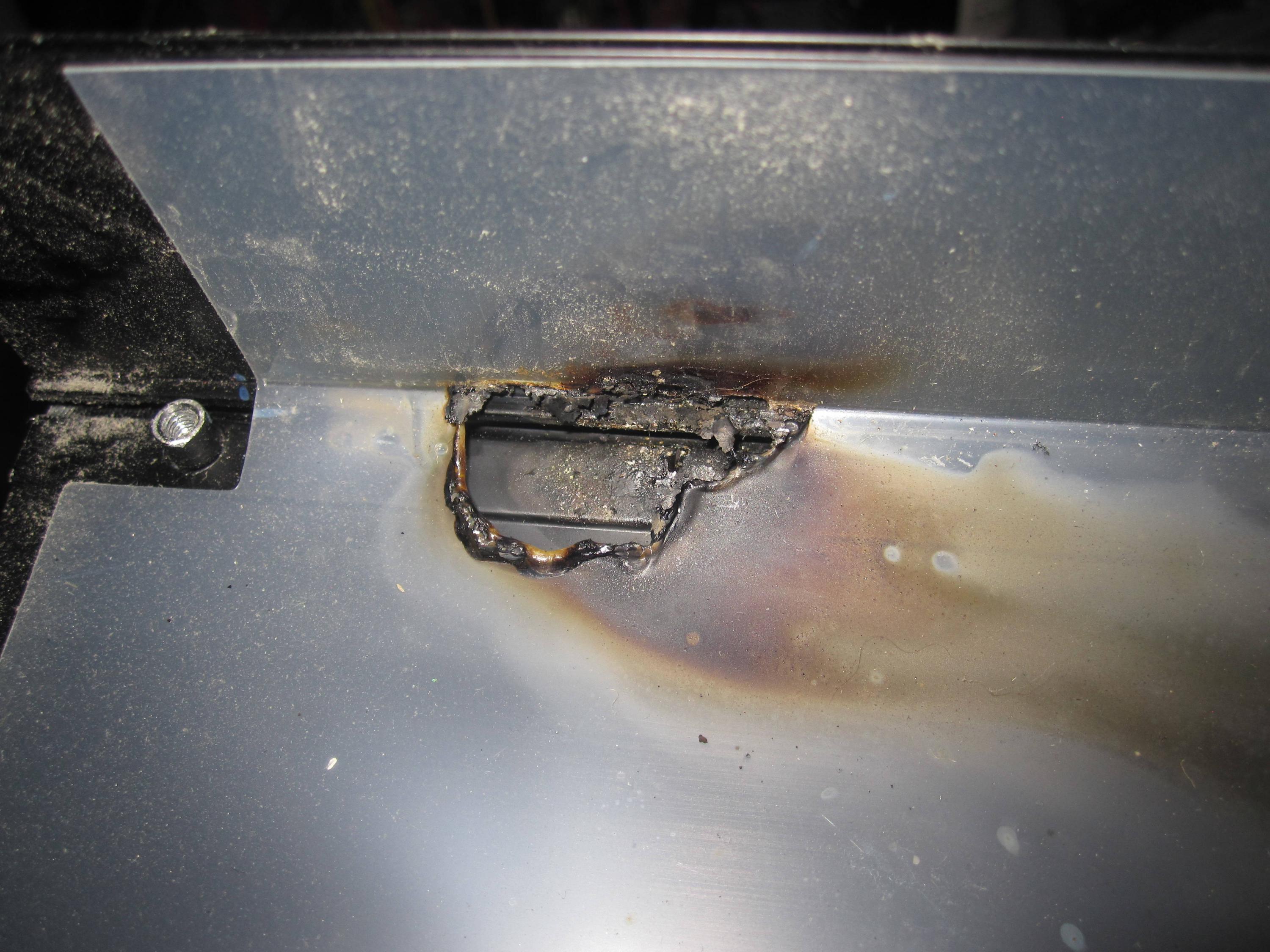

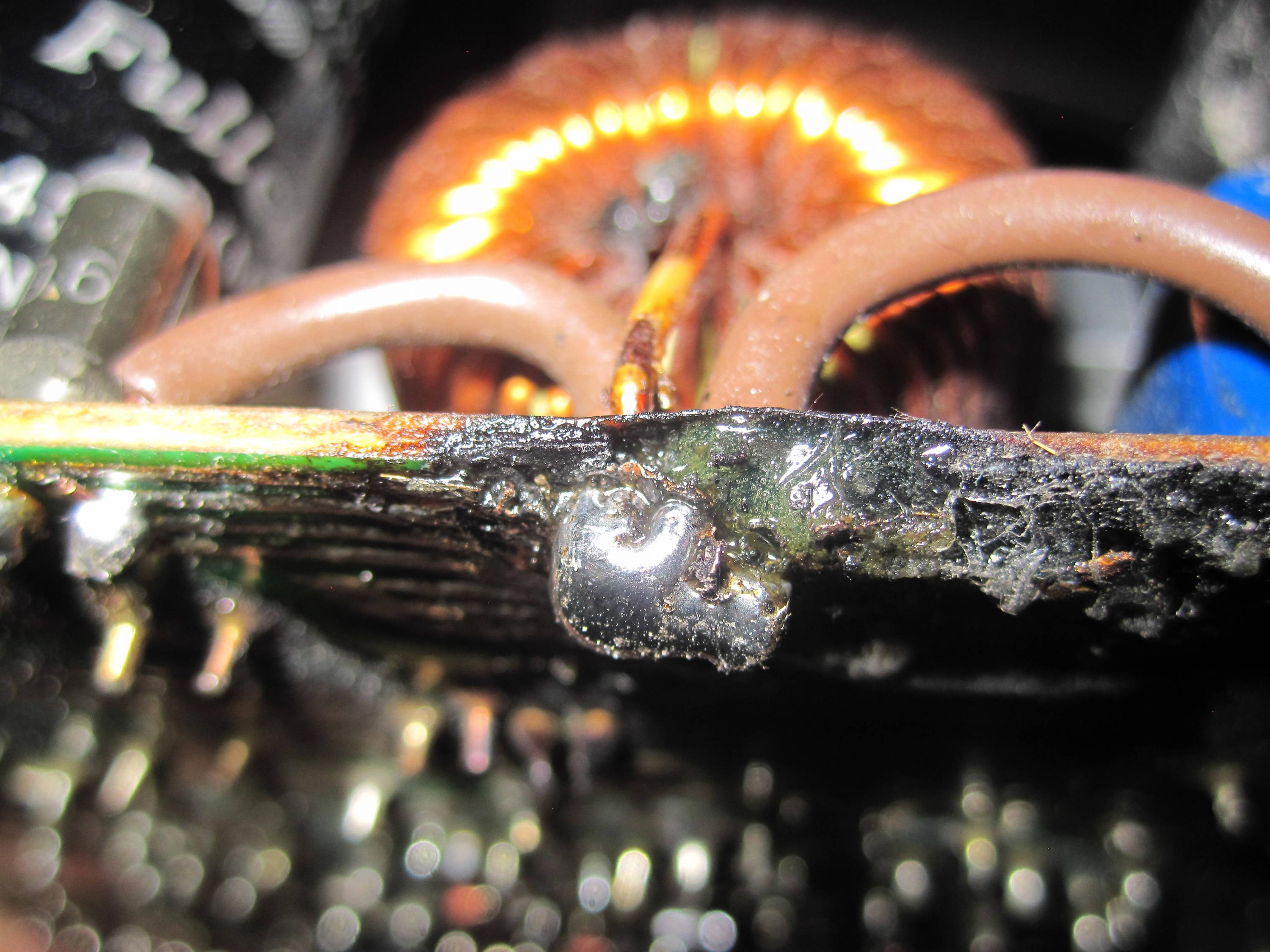

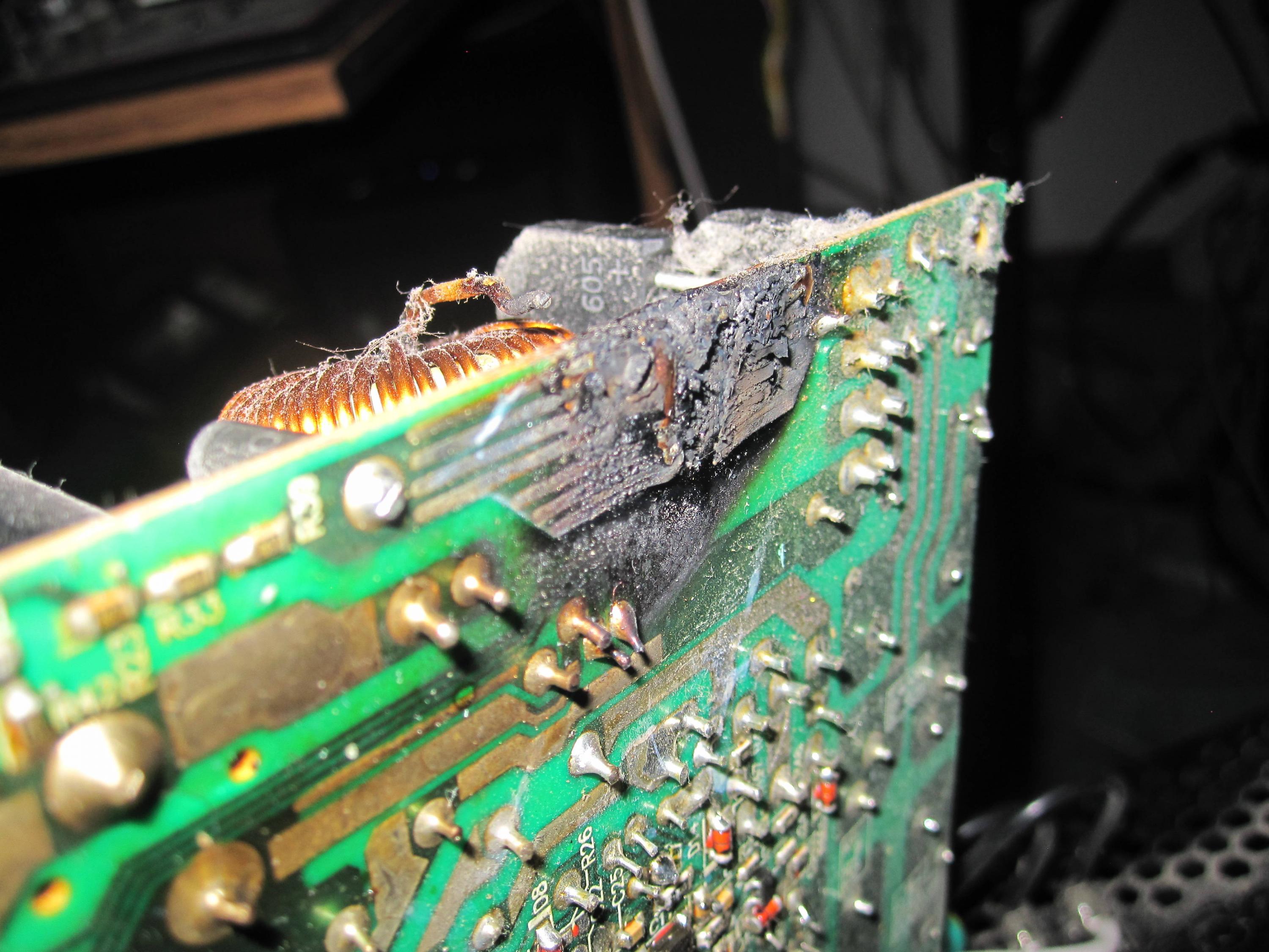

    Okay. Need to see where I can tap off the board. So I pulled the board and see this:
    Wow... Reconnect maybe? Okay, now the bottom:
    Holy crap, now what happened to the insulation?
    Thank goodness for three wire grounding and thank goodness for FR-boards.
    Now... is this fixable?
    Actually I think this is worth a shot jury rigging a fix...
    BTW: Yes, the FR4 track protected the input fuse... (Fuse is still intact). Will need to see if the input circuitry is still good or not, like the bridge - then again there are two bridge rectifiers in parallel so that's pretty beefy...
    And dim bulb will definitely be employed trying to repair this thing...

      You could probably kludge (for UK folk, "bodge") a repair of that PCB, but how available is that insulating plastic sheet material, which also must be fire retardant.
      That is the second nastiest example of, "This is what happens when you have a bad connection in a high current circuit," that I've seen in the past couple of weeks. The worse example involved an edge connector, damage due excessive insertion force, and 7 years of operating at 40A-60A. Fried FR-4 and melty-fried 94 V0 plastic connector shell.

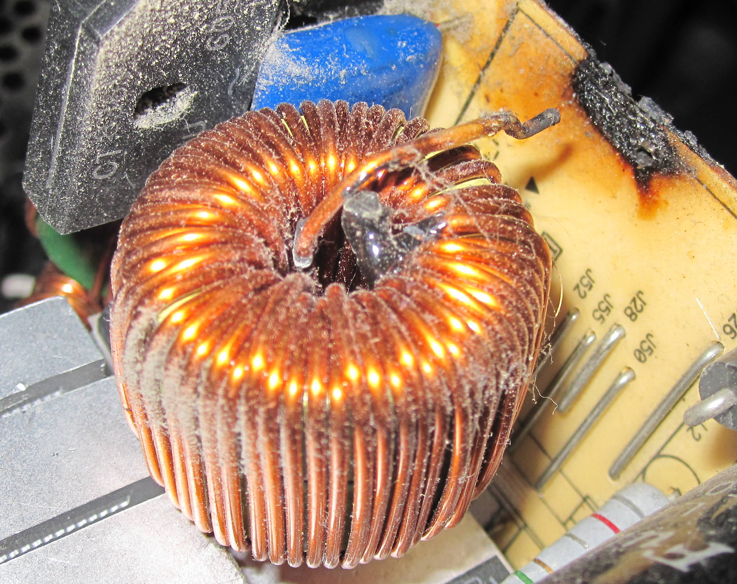

          was the coil glued, or just floating?
          trying to work out the cause here!

            The coil was just floating when I pulled the board!
            Yeah, that plastic insulator needs to be flame retardant as well, and that probably will be the toughest thing to find a good fix for. Need to make it as thick as possible:
            I can't believe the designer put that track so close to the edge of the board!!! This PSU looks so nice, the case is made of extruded aluminum, but this APFC coil basically is up against the edge of the board. I wonder if this would have failed a lot sooner if it were run in a 220VAC environment, as that node should be at 340VDC peak (it's unfiltered rectified mains). The unburned end of the APFC coil is the boosted voltage, so at least that is far away from the edge of the board.
            I thought I've only seen FR4 and FR2 boards, the tell tale glass fibers shows FR4. I suppose FR3 should be more prevalent than I think but I haven't heard much talk about it. Upon another closer look at the board, perhaps this really is FR3 as I can't see fibers as I thought I saw last night after using a magnifier...
            FR2 is very soft and mostly I see this with small, low voltage boards.
            I have an idea for the plastic sheet: I suppose the plastic sheet from another dead PSU gets to be used once more! (and probably will reuse the old sheet, patched with Kapton tape, as a second layer.) And this time ensure there are no sharp edges that can puncture the sheets or the tape.

                  That the inductor was loose - I didn't see any glue, and those wires underneath it scare the @#$% out of me. I'd put a layer or two of Kapton tape over them and then RTV the inductor in place. I'd even guess the inductor being loose plus shock/vibration may have compromised the original solder joint or wire.
                  Patching the burned/melted insulator with insulation from a scrapped/parted-out PSU sounds like a good solution. Just make the "new" patch a good deal larger than the hole, and maybe tack it in place with cyanoacrylate glue ("Super Glue", "Eastman 910", etc.).

                    Yeah I think I will need to RTV the APFC inductor, good point. Or at least somehow steady it.

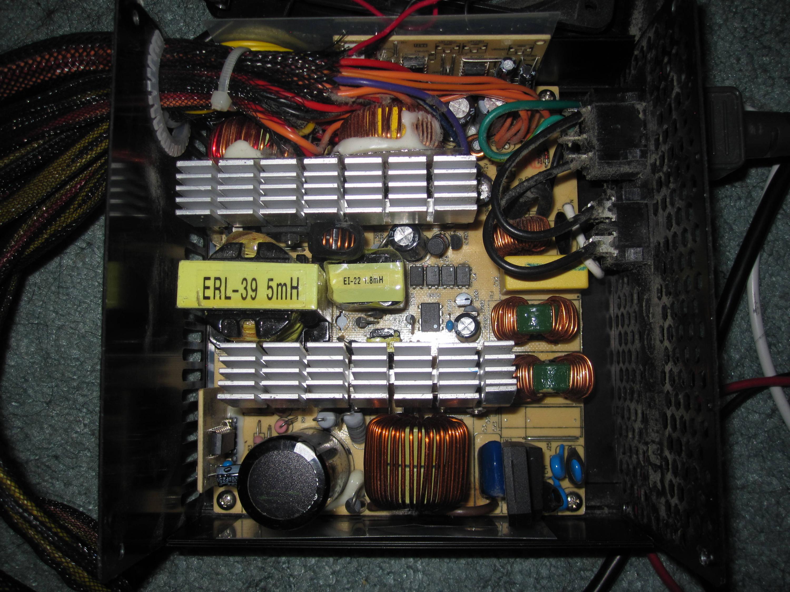

                      Picture of the PSU and the kludge/bodge/jury rig/whatever you want to call it
                      I put some regular epoxy into the burned area to fill out the missing material due to the burn in hopes it would strengthen that area a bit.
                      I still need to support that APFC inductor, ideally away from the burn scar, so this is still a WIP... but comments about the original design of this PSU are open.
                      My initial thoughts -
                      - CRAP HV TOO CLOSE TO SIDE OF BOARD
                      - Riser for the APFC controller not insulated, just RTV'ed to the main filter capacitor, and the RTV broke.
                      - I would think the heatsinks and the main transformer would be larger for 850W.
                      - and as noted, the APFC inductor is not glued down properly.
                      - Crap cap brands "Micon" (most secondary caps) and "Fullcap" (primary cap)

                          As for what I think of the PSU in this thread:
                          Not bad. I'm not a fan of the APFC circuit when the primary cap brand is crap. If not too hard, I would definitely try to disable the APFC and just put a voltage doubler in there (if in the US or where there is 120V AC) or just leave the crap cap in there for countries with 220/230/240V AC line.
                          Also, looks like the 3.3V rail has an output inductor rated for lower frequency, so it may not be the most efficient. The output inductor for the other rails looks a bit small, but at least it is light green (meaning higher-frequency rated).
                          Overall, I don't think the PSU will make it up to 850 Watts. Not because of the heatsink sizes, but because it just doesn't look like a PSU capable of it. For 850 Watts, I would expect synchronous rectifier on the output... otherwise you can expect quite a bit of losses and heat.
