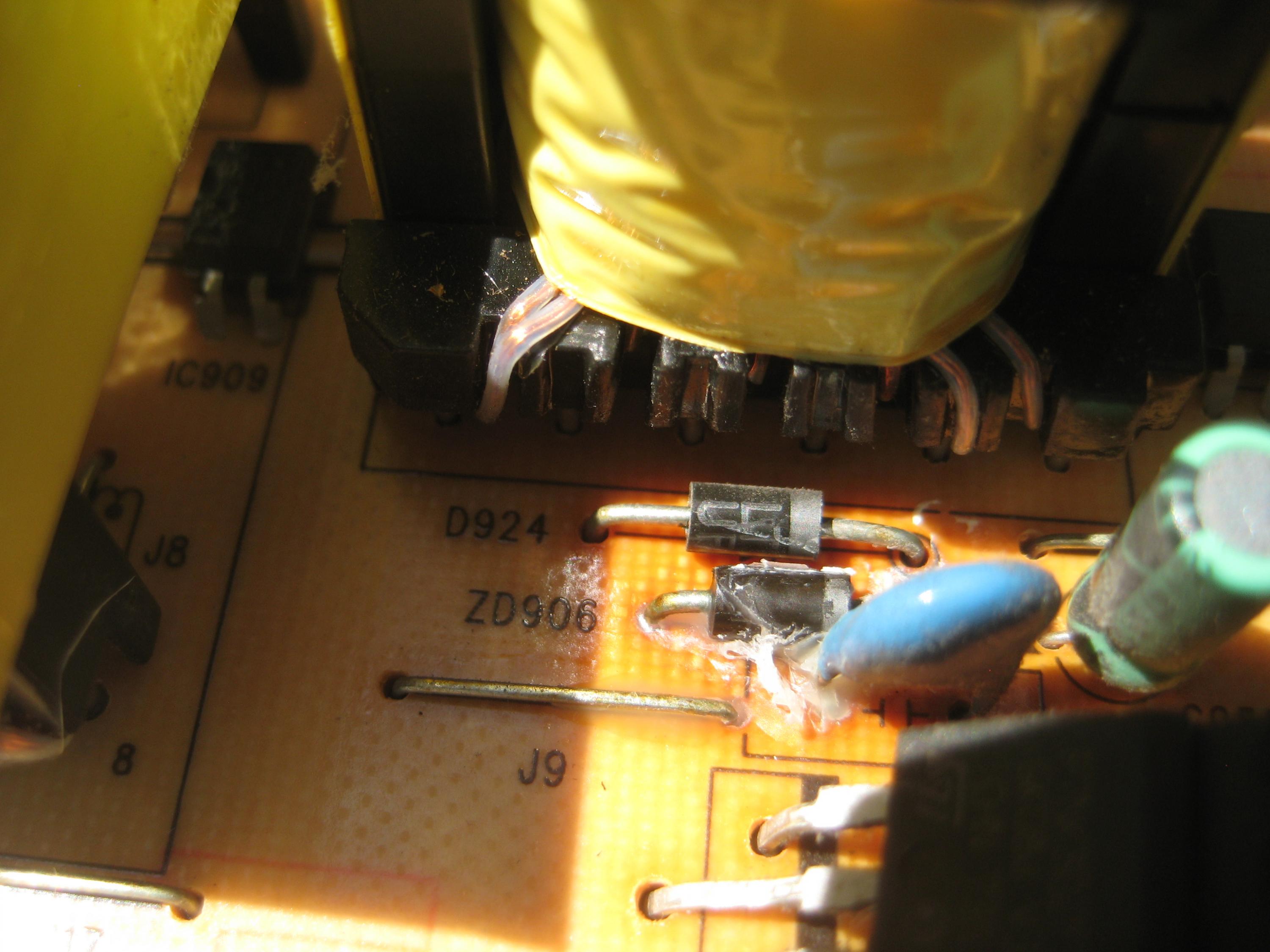

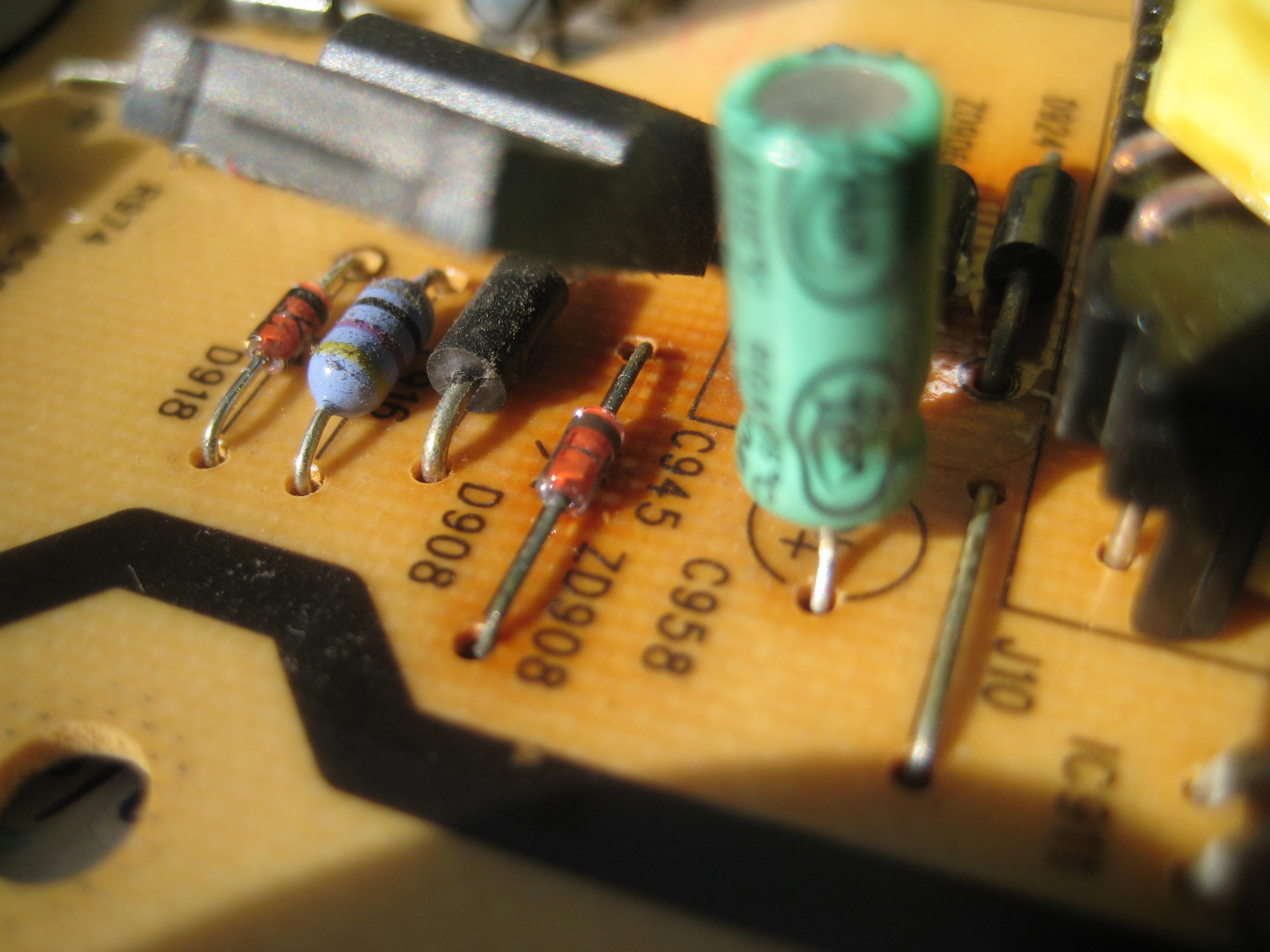

    Below is a close-up of ZD908 showing the heat discoloration mentioned in the OP.
    The discoloration from ZD906 is even worse, but the picture doesn't show it very well. There was a blob of white glue on top of ZD906 and its neighbor D924. I'm hoping for some enlightenment regarding the purpose of that glue. And I wonder whether D924 may have suffered damage by being next to ZD906 when it was hot. I'm also worried about damage to the blue disk capacitor next to ZD906.

          The two pictures show the same single light-green cap (C958). But C934 is elsewhere on the board and is the same as C958. They are 5mm x 12mm Lelon RGA 105 degC 25V 47uF without vents---just plain flat tops. I assumed that they are their original color, but IDK. They are the only electrolytics on the board other than the nine CapXons. I guess I might as well replace the Lelons too, or at least order some backups for them.
          I've removed the four popped caps but haven't ordered replacements yet. I'll be using Panasonic FM for those, same voltages as the originals. I'm trying overall to use high quality replacements (Panasonic, Nichicon, Chemi-con, etc.) with the best specs.
          I'll test the diodes as well as I can after I remove them. I have digital and analog multimeters. I also have an old Heathkit transistor tester that I don't know how to use. I'm inclined to replace the most-likely-bad components summarily, without much testing.

              ZD906:
              Observations: It was covered with a blob of white opaque glue. After pulling the blob away with long-nose pliers, there remains something like a more translucent white stringy glue or grease between the cap and the board. The surrounding area of the circuit board is noticeably discolored (about a half-inch each side).
              Remark: I'm concerned about the possibly of heat damage to nearby C945, a blue disk capacitor.
              Remark: The board layout diagram in the service manual reverses the positions
              of ZD906 and D924 relative to my board.
              Schematic: P4KE250A-E3.
              Spare parts list: absent.
              Replacement: Vishay Semiconductor Diodes Division, P4KE250A-E3/54, TVS DIODE 214VWM 344VC AXIAL
              ZD908:
              Observations: The surrounding area of the circuit board is noticeably
              discolored (about a quarter-inch each side).
              Schematic:BZX79-B18.
              Spare Parts List: absent, but BZX79-B18 A is used for a different model.
              Replacement: Nexperia USA Inc., Manufacturer Part Number:BZX79-B18,133, DIODE ZENER 18V 400MW ±2% Through Hole ALF2

              D924:
              Remark: This is next to ZD906, so it may have gotten pretty hot.
              Schematic: UF1007
              Replacement: Diodes Inc. UF1007-T
