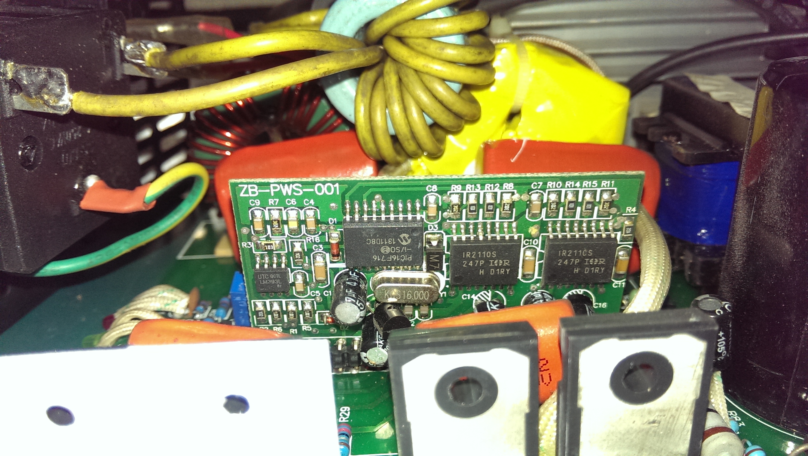

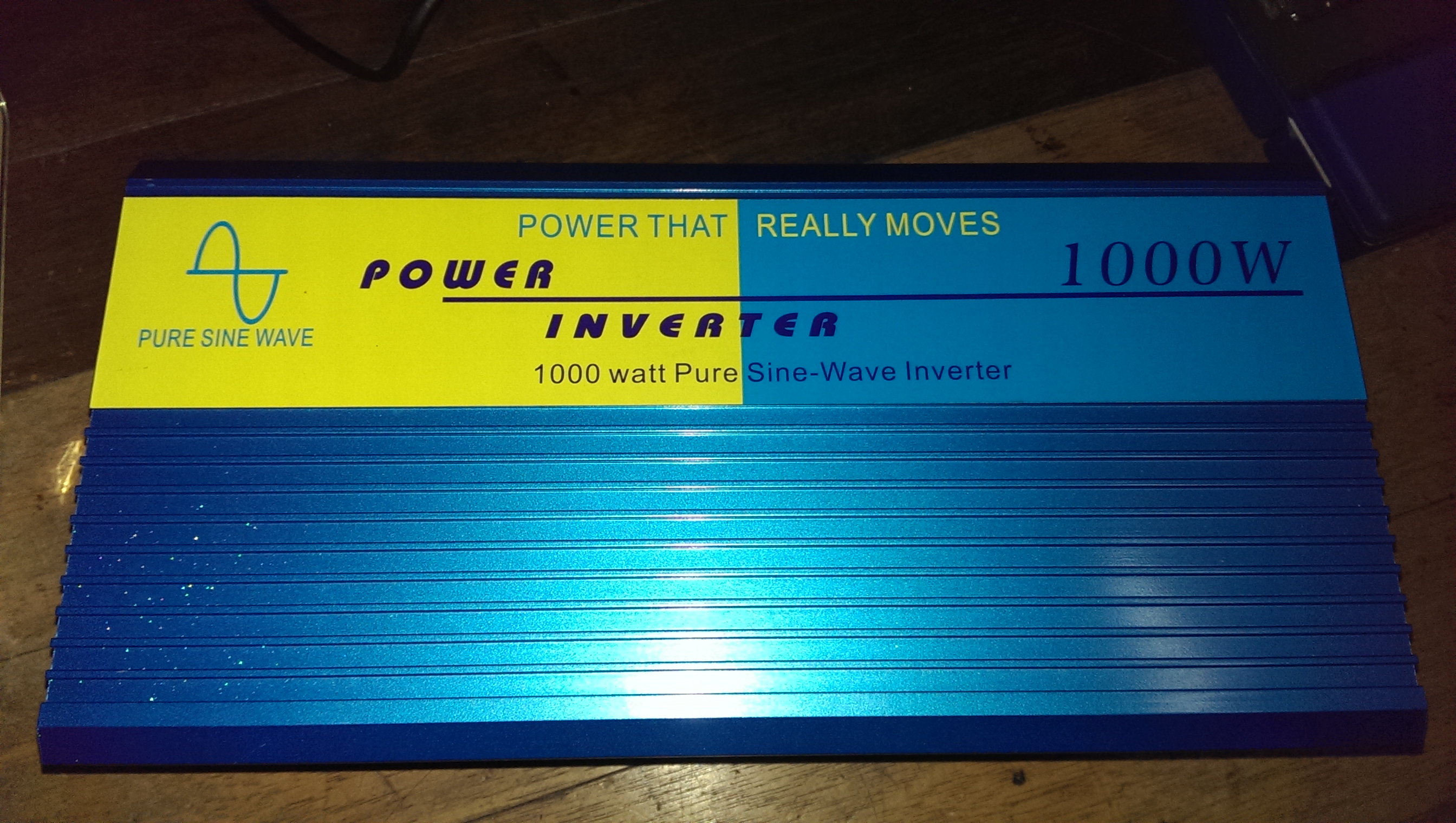

I have a 12dv to 220vac inverter with pure sine wave output but it's 50hz. My question is can it be modified to make it 60hz? The PWM board pix is attached.
Pure sine wave would imply that all other frequencies are block out. Most sign waves have multiple even harmonics in them. I am sure it can be done just might not be worth it.
Thanks guys for the reply and for providing the manual. Unfortunately, there are no switches or jumpers in the main board that says 50hz or 60hz. Outside the main chassis, there is a sticker that says, the input, output, frequency, and whether it is modified or pure sine wave. And there are ticks on 12VDC, 220VAC, 50Hz, and pure respectively.
Hope someone will come up to say that this can be modified to 60Hz.

Yep, just call them and tell them that their spec sheet does shows 50/60Hz.
It will take reverse engineering to figure out the circuits to modify the unit.
Actually I called them today and asked for their tech suppport and I was right. I was told that because I did not purchase the unit from them, they can not be of any assistance. They don't sell service manuals either. About the 50/60hz as advertised, I was told that either I have to buy the 50 or the 60hz unit. There are no switches inside the unit to change that.
Perhaps I just have to buy another inverter with 60Hz pure sine wave. I am willing to reverse engineer it if someone can tell me how.
"I am willing to reverse engineer it if someone can tell me how." Telling you How? Well, how much do you know about the electronics down the schematic and component level. Can you draw schematic?. It will require you to block out each section of board to find out what their function are (for example, it will have power supply section, and in that power supply section it may have some switching supplies, regulator. Another section may have some kind of Oscillator, the drive circuit, the output circuits, etc.). From the look of the unit, this inverter may be using PWM inverter topology. You will have to completely remove the boards from the chassis and look up the spec sheet of the ICs to find out what they are, that is the start.

You may want to get a small circuit board that you know what it is and what it is used for then you can trace out the board and draw the circuit and see how much work that will be.

Can you show back side of this PWM controller board?

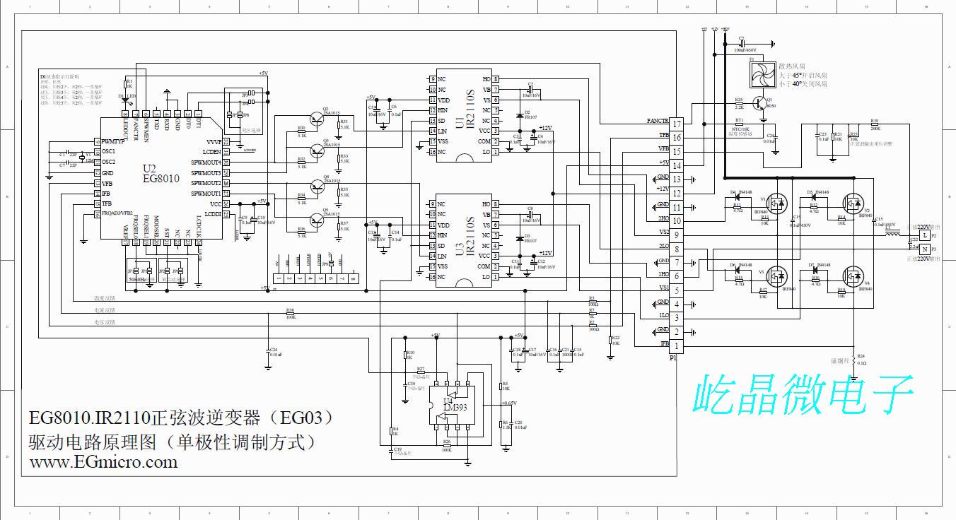

Your board has similar to the board EGS002 that is used a lot in DC-AC inverter. If you search for EGS002 you will see lots of info.
Your board may have a jumper to set 50/60Hz.
