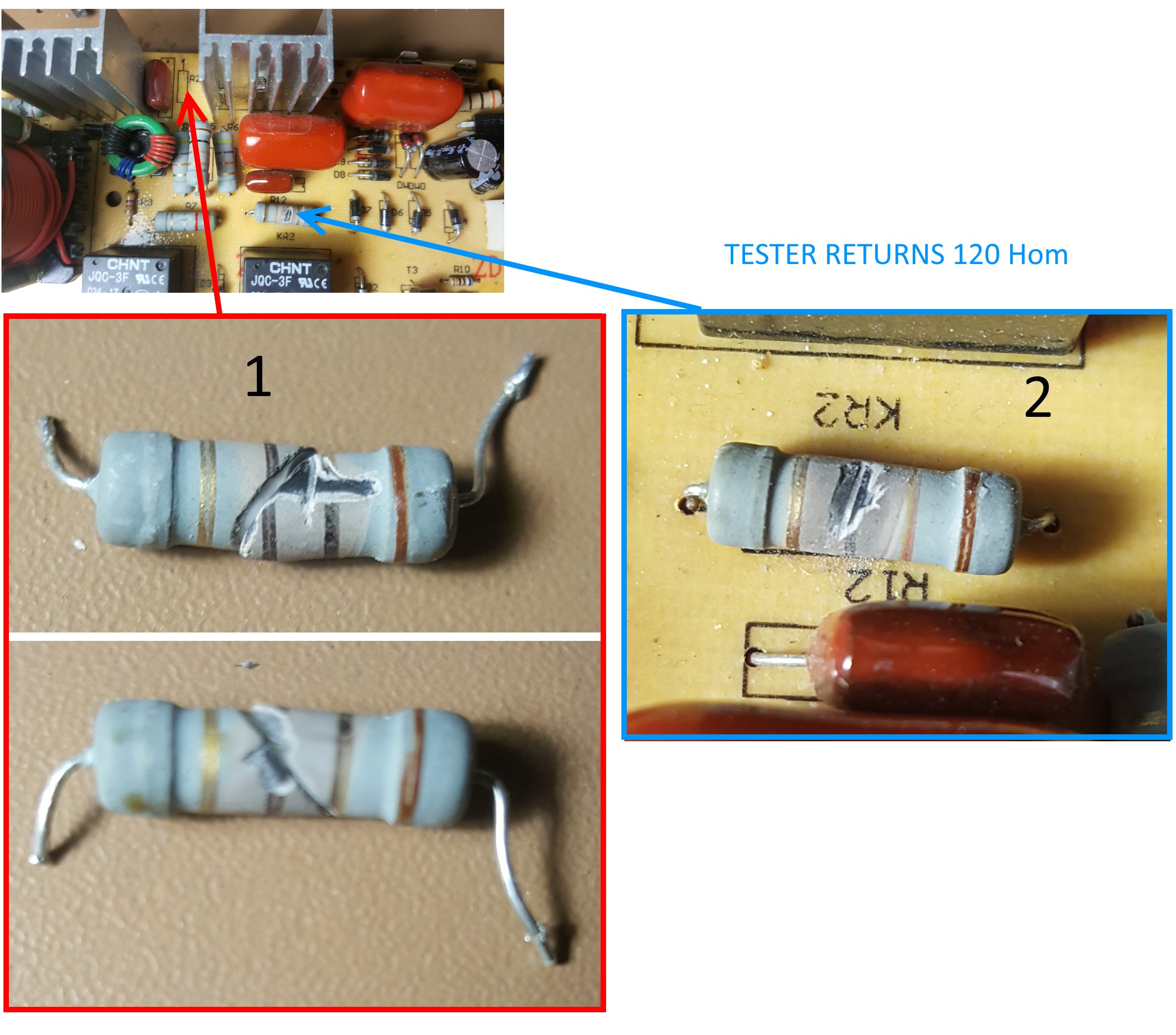

    Hi , this is a ultrasonic washing machine circuit, one or two resistors
    are damaged, I can not identify the color of the resistances to replace them,
    someone can help me ?

    brown black black gold 10 ohms and 5 % tolerance

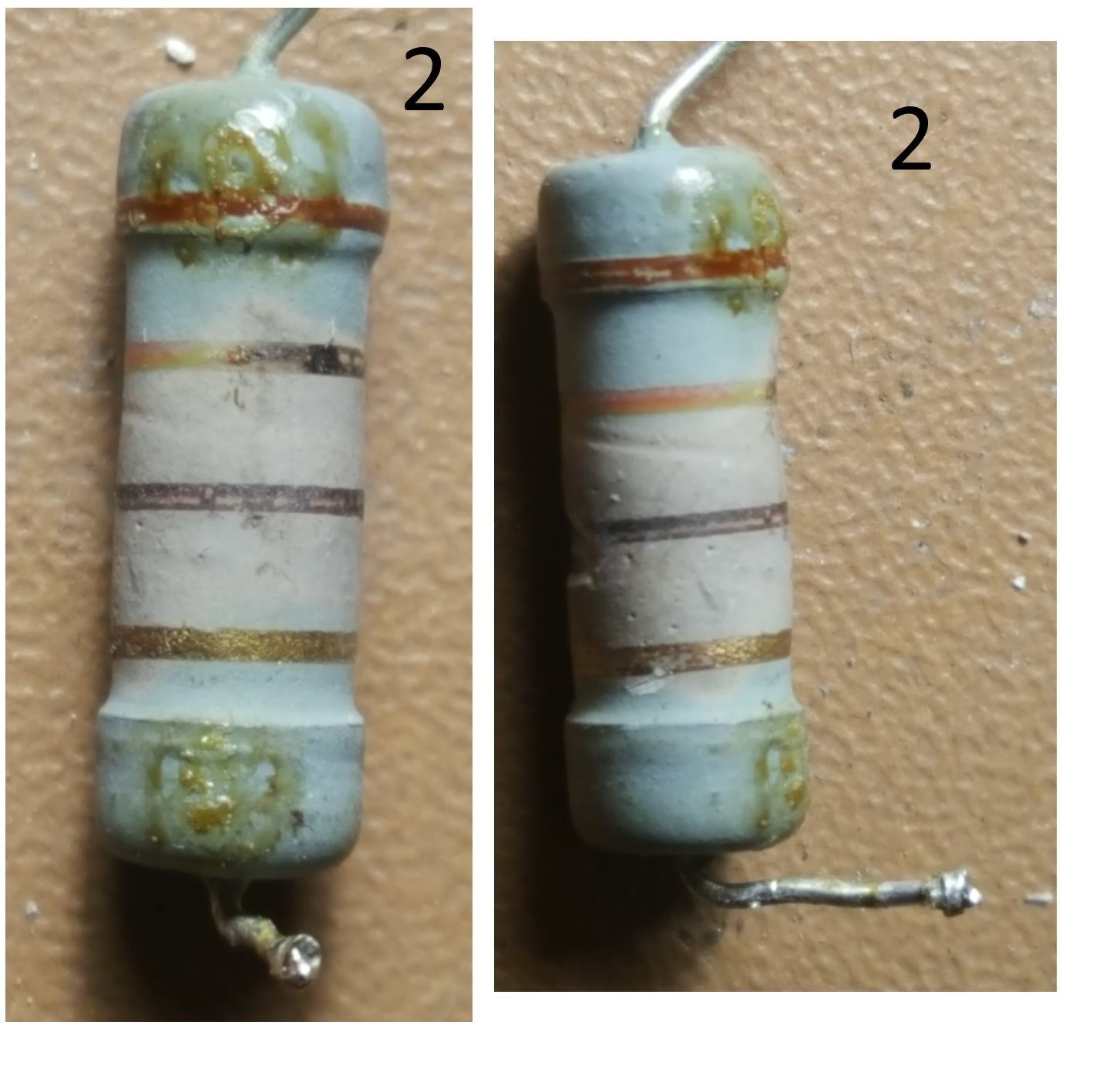

      Ok, resistor n 2, that I have unsolder now, seems to be : brown black black gold, but
      the 120 ohm reading from tester , indicates it's damaged.
      I thought, that the heat changed colors.

        brown red brown is 120 ohms . do you not have the schematic ?

            looking again the heat may have changed the colours to black . so it could well be 120 ohms .

              I warmed up the resistor, and actually brown (and, unfortunately, other colors) becomes black. If I take as an accurate meter reading, are two 120 ohm resistors.
