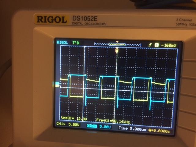

                      Ok, Longbow, picture of the primary site of T2 dual trace.
                      Is this helpful
                      • Longbow
                        • Jun 2011
                        • 623
                        #31
                        Re: Manson hcs 3202
                        Thank you. This confirms my suspicion. The output waveforms on pin 8 and pin 11 are the same (well, nearly). Thus...no net current is flowing in T2 primary. I think there are 2 possibilities. Either U5 is faulty, or one of the pins on U5 has the incorrect voltage. Do you agree with that theory?

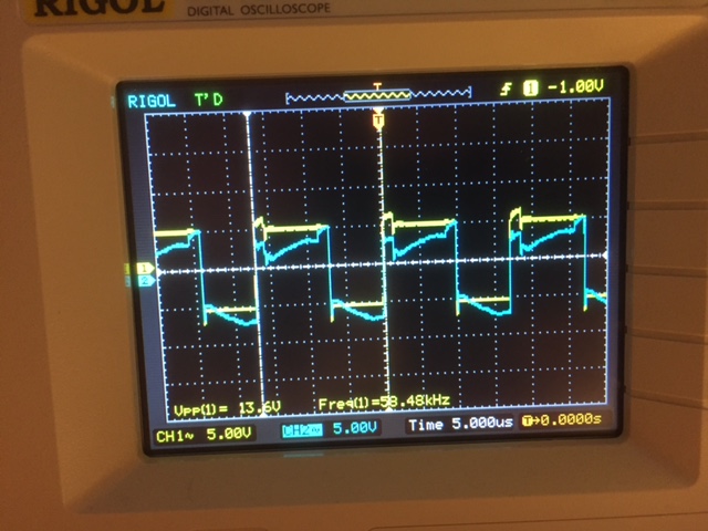

                            And enclosed a pic of U 5 pin 8 and 11.
                            • Longbow
                              • Jun 2011
                              • 623
                              #34
                              Re: Manson hcs 3202
                              Thanks. The d.c. all looks fine. Your new thumbnail shows the expected push-pull output of about 10v p-p (if I read your scope correctly). So U5 is doing its job. The earlier scope thumbnail shows something different. You see in post #30 showing an in-phase condition that would result in zero drive at TR2 primary. Am I confused today? Yes. U5 can produce either type of output, controlled by U5 pin 13. (+5 on pin 13 = push-pull operation).

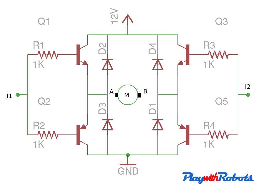

                              Which transistors in post #30 make the BLUE trace? Is one of the traces in post #30 inverted...maybe? Q3, Q4, Q5, Q6. Is one of these shorted? I can't see how U5 outputs pin 8 and pin 11 can be push pull, and at the same time the drive across TR2 primary is net zero.
                              I think I might have to change professions.

                                Hi, Don't change professions, what else you wanna do? Growing bonsai? In any case the blue screen belongs to emitter Q3/Q4. I'm gonna exchange those transistors anyway, cause of the weird square wave, just to be sure.

                                  Let's just take one transistor pair, Q3/Q4. This is not my favorite design, but in operation I would call these current amplifiers. It is easy to see how Q3 is biased "on" by R47. Q3 in the "on" state puts about +10 volts on the upper primary winding of TR2.
                                  U5 pin 10 is connected as active LOW, so during pin 10 = Low, Q4 base changes to about .2 volt (the saturation voltage of the internal transistor). That circuit is very clever, but how does Q4 survive? Q4 emitter (above) is sitting at +10 volts, then all of a sudden Q4 base goes from 12v to .2 volts, putting a forward bias of around (10-.2)=9.8 volts forward bias on Q4. In my book, a transistor will not survive 9.8 volts forward bias.
                                  Ideally, U5 would have to use split supplies +/-12 in order for this current amplifier to work. But - I didn't design it so I suppose we will never know. I will say, however, that it is a general practice for circuit manufacturers to eliminate "unnecessary" components. Many odd problems come up then. The circuit here is almost identical to below, except we are driving the TR2 primary instead of a motor:
                                  Well, all of this level switching happens rather quickly. Maybe I have to review my quantum physics again to see how Q4 keeps working.
