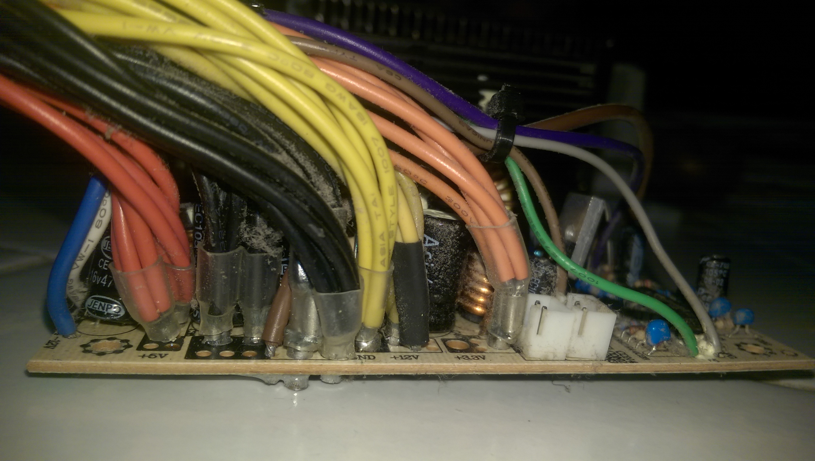

    The first thing I noticed about this PSU (Besides the awful caps) is that it completely cuts off the AC Live/Neutral at the switch. I wish more PSUs did this. It's got a decent input filter with two varistors and 470uF Jenpo caps.

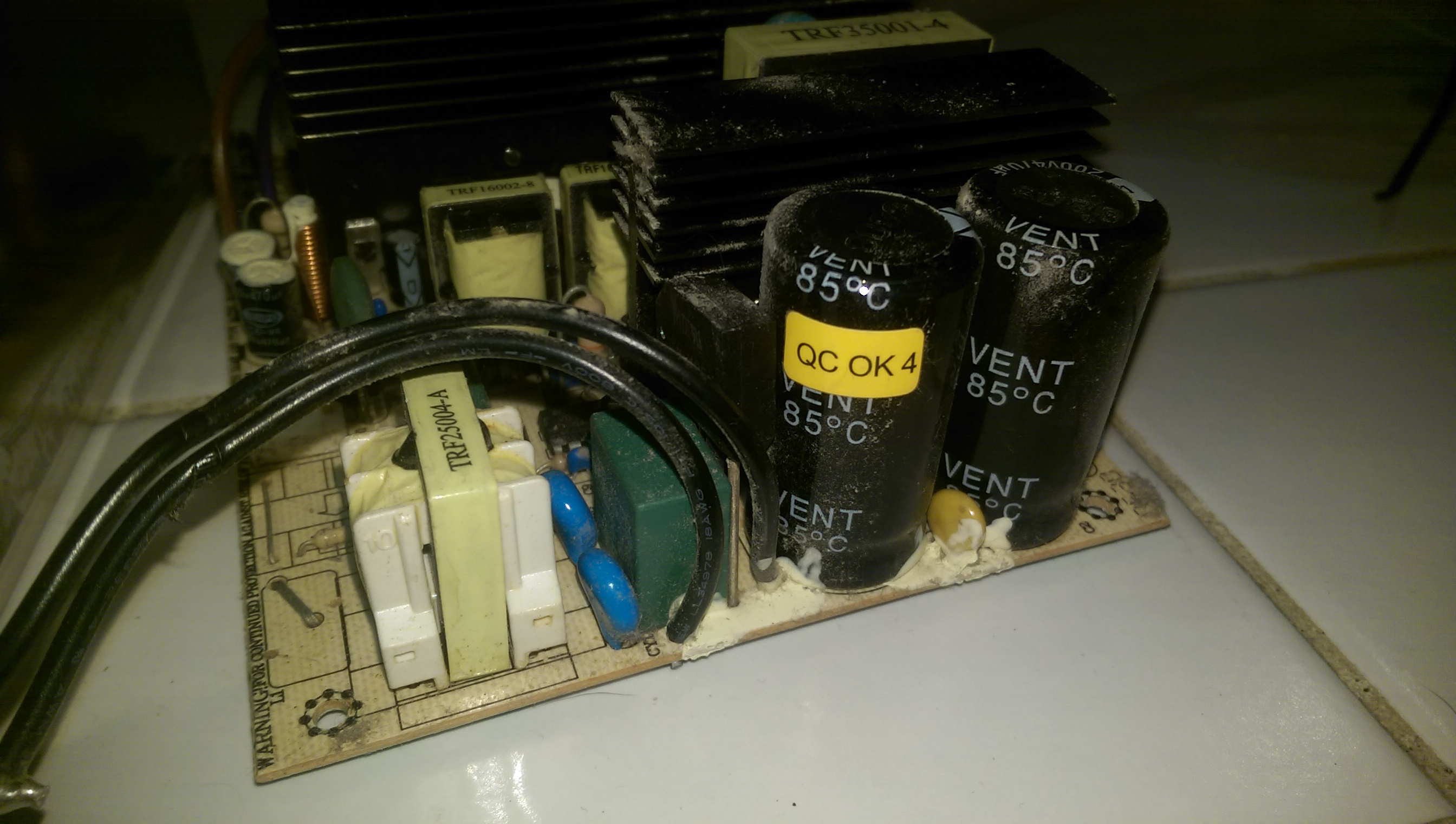

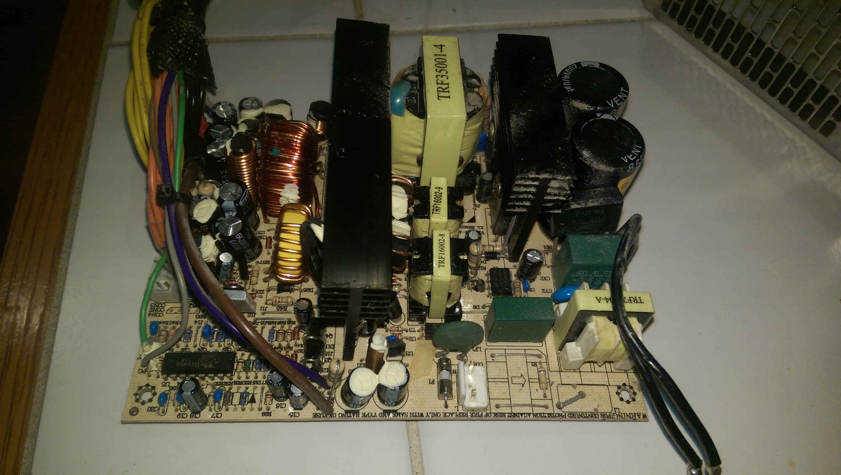

    The switchers are 2SC2625. So good for probably 300W since spec wise they're in between 13007 and 13009.
    5VSB uses a Viper22A! Cool!
    This thing uses a 30A schottky for 5V, 30A schottky for 12V, and 20A schottky for 3.3V. It does not have two 12V rails like the label claims. Either way, I was very surprised to see a 30A TO-247 part in spot of the 12V rail.

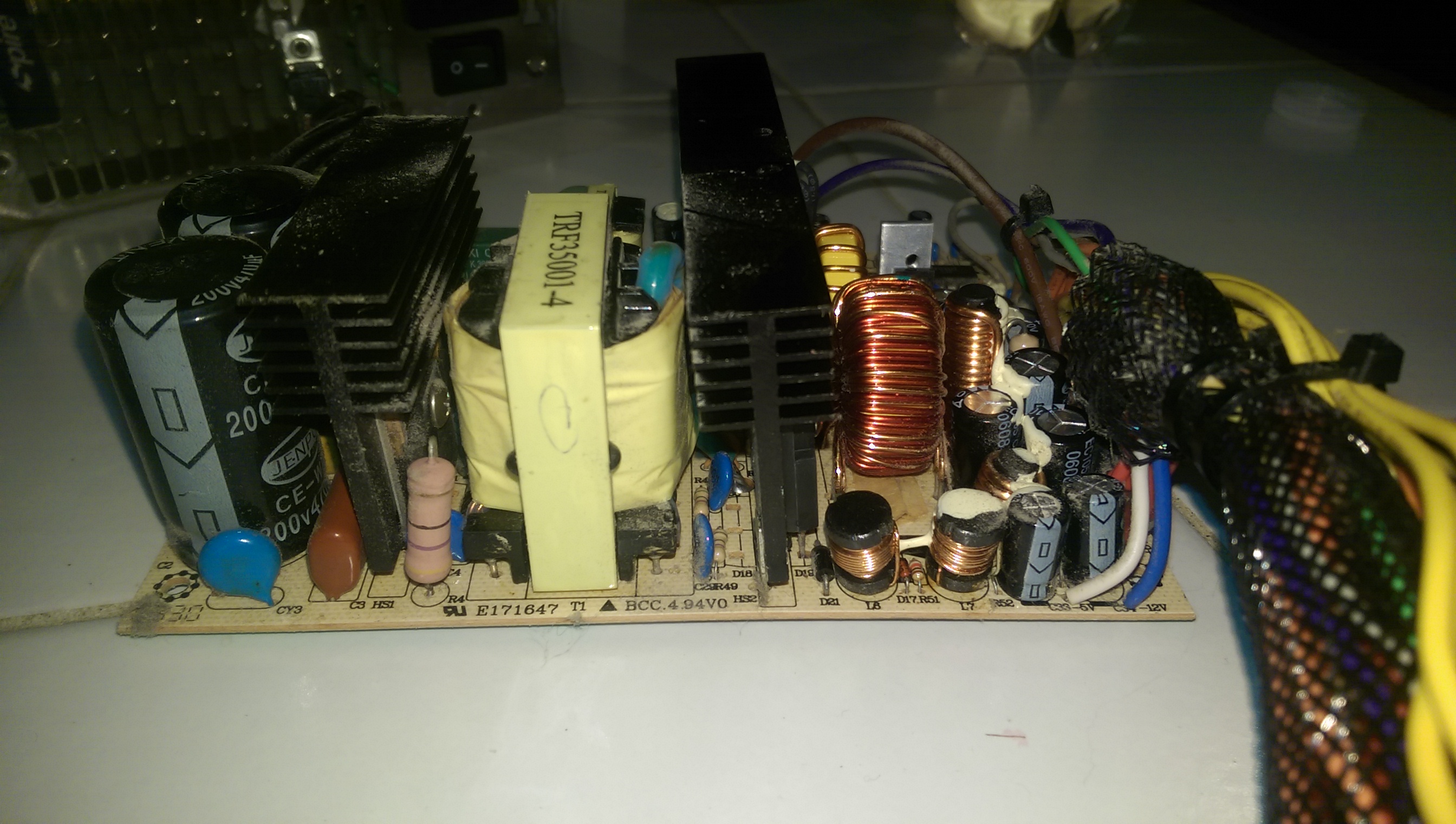

    All of the caps are junk They are all Jenpo or Asia'X. None of them looked bulged, but I'll check to see if they are bad. I think this thing is worthy of a recap. I just ordered some more caps for my stash I'm weird in that I like keeping things alive from defunct companies, just because they become more unique over time. None of the filtering caps are over 1000uF which is worrisome, but the PI coils are good sized at least.
    The Globe Fan spins really well, but I will put some oil in there when I reassemble it. The fan curve is pretty aggressive.
    The soldering absolutely SUCKS! Come on, Topower. There are tons of blobs, flux, glue everywhere. Truly ugly, the pictures don't show it all. All of the wiring is 18AWG. What do you guys think?

      That silicone on the SB caps is to prevent them from bulging or what? So they go when the pressure rises enough?

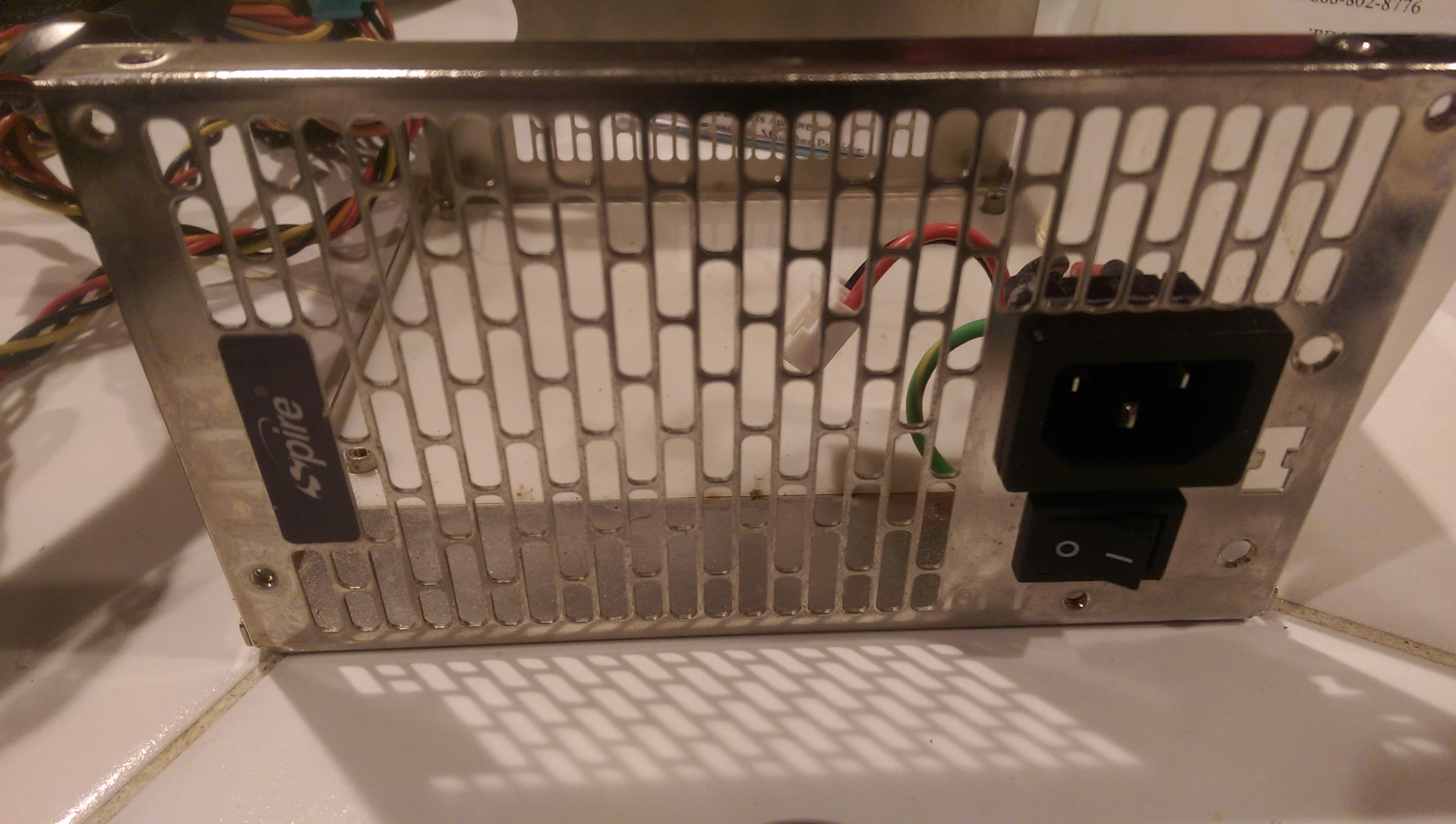

        The UL number suggests it's a PSU made by Forepoint (AKA Focus AKA Fortrex)... who are in fact owned by Superflower. But the transformer markings do look akin to Topower, and Topower was the OEM for Spire PSUs IIRC. Maybe Forepoint only supplied the PCB. The silicone glue atop those capacitors would make it harder for them to properly vent so maybe they'd outgas by way of the elastomer (rubber) seal or... ... all depending on how fast the electrolyte vaporizes (too fast for the pressure relief vent to operate, so slowly that no visible deformity can be observed, or all be it, somewhere in between). Most of the hydrogen gas does escape through the bottom seal.
        So that's a 430W PSU? Those 470uF input capacitors and 2SC2625 switchers (possibly comparable to TO-220 13009s in that TO-3P package) may limit it to a more reasonable 250W at anything above 25ºC ambient, but with those output rectifiers and the aggressive fan curve, 300W may be possible above that temperature range. Personally, I enjoy keeping old electronics (even from defunct companies) alive as well, because today's consumer electronics just aren't built to last...

          As far as I heard,it was Sun Pro that was used for Spire PSUs. I might be wrong though.

            Topower-spire-superflower-topower-forepoint-spire-Maddog OK... Now my head hearts

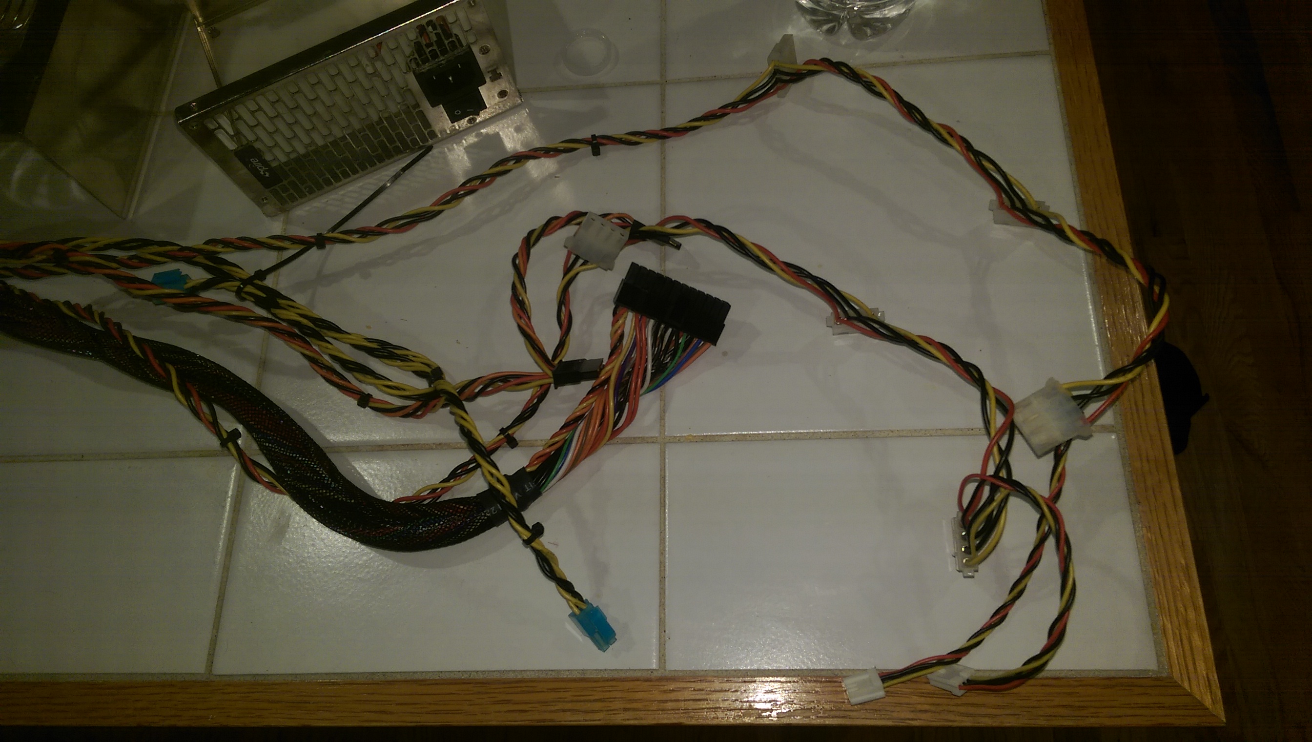

            Jokes aside, for a low power PC it may do the job after a proper recapp, 18awg OK for that power level, 35 transformer, decent line filtering, it's not 430w but it would do 250w/275w I think.

              35 transformer might actually manage 300-350w.

                Or 1.5 kW too. It all depends on the topology and efficiency.

                  I said that because it looks like it's half bridge, and I know they don't have the best efficiency, I don't know as much as you guys it's just that I don't like to push thing past 80% of what they can do

                        The heatsinks look a bit light for 300W, though the TO-3P and TO-247 packages are a plus. Noticed the Y-caps are genuine. The thing is a little short of 11 years old, so even good lytics would be getting long in the tooth.
