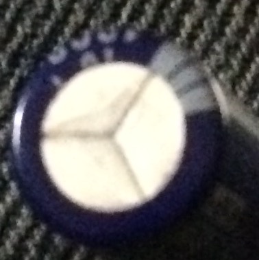

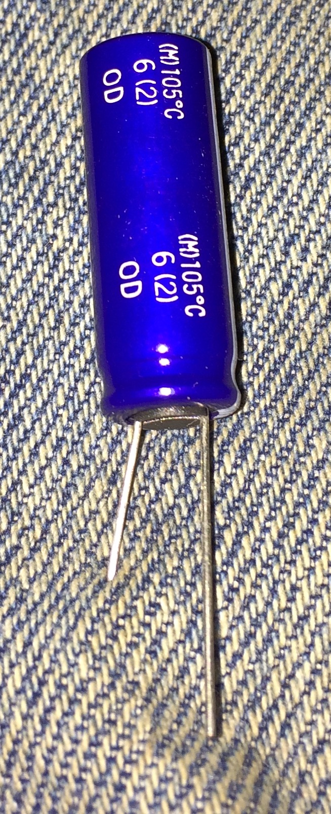

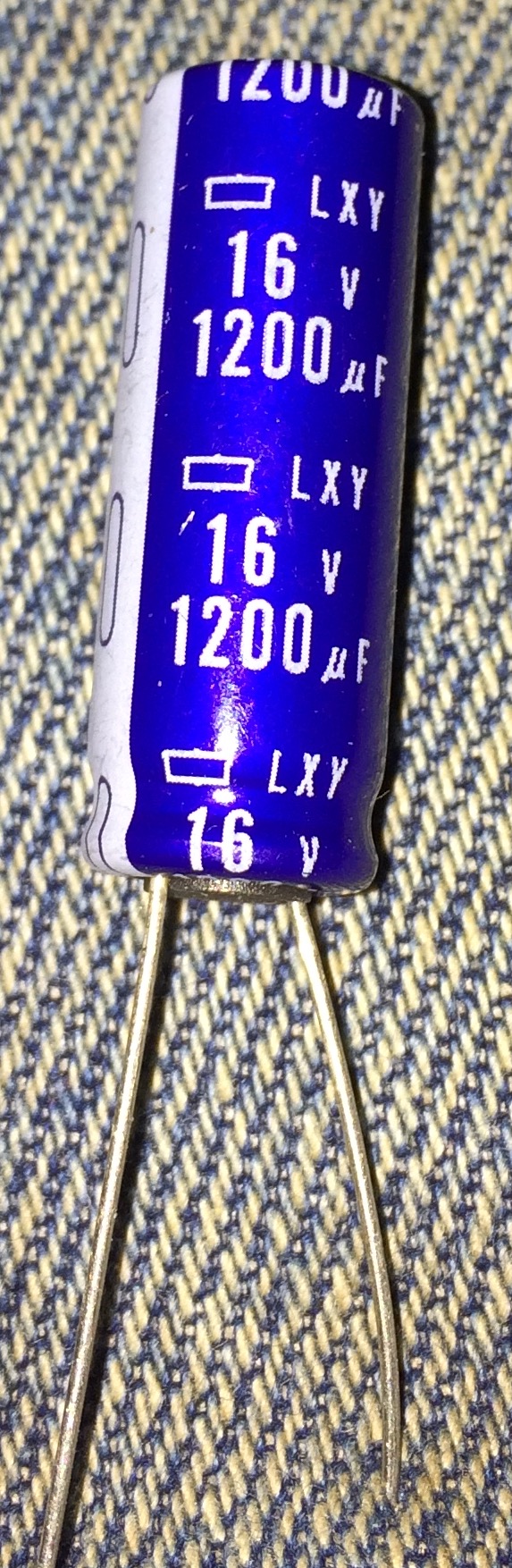

Are these caps real or are fake LXY 1200uf@16volts
    • Jul 2011
    • 6069
    I bought these caps from a surplus supplier I would like to know if theses are real or fakes
    If they are real I will share where I got them from
    A bag of ( 100 ) for ( $10.00)
  • Khron
    • Sep 2006
    • 1350
    • Finland
    Re: Are these caps real or are fake LXY 1200uf@16volts
    They look pretty legit to me. The sleeve looks nicely centered around the body, and the vent stamp is thin & clean.
    According to the datasheet and its proportions, i guess that's the 10x30mm can version.
    https://cdn.badcaps-static.com/pdfs/...ee3c51807e.pdf
    According to that, the one in the photo would seem to be from the 4th of october 2006(?)

                Doing a Google image search for that capacitor I see there appear to exist some really well made fakes of it.
                But I do agree that yours looks genuine.

                  Yeah look real enough. Its obsolete series but for old electronics its OK. Besides having poor capacity per volume ratio, they have reasonable life and ESR/current ratings.
