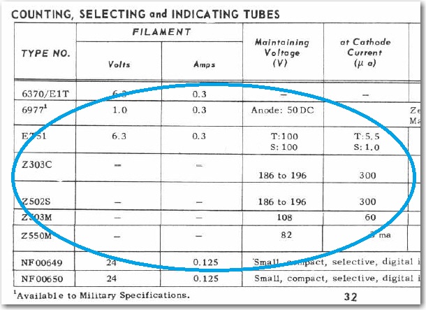

            The best(?) way to go might be to first know / find out what Nixie tubes you're planning on using, THEN finding the datasheet for them, and THEN crunching the numbers.
            What's the use in using the data from another tube, which could be wildly different?
            PS: That "voltage distribution" thing is for the photomultiplier tubes, which are a very different beast (and for totally other uses) than Nixie tubes.
            In the PDF you linked, you need to look at the BOTTOM of pages 32-33.
            See the "Type no." colums at the left edge on the bottom of page 32, and the right edge on the bottom of page 33? Quite the coincidence, wouldn't you say?
            From what i can tell, for example in the case of the Z303C and Z502s, they draw a current of 300uA / 0.3mA per digit (and you'll only have one lit at any one time, per tube), so there you go.
            But all that's irrelevant, if you end up using another model of Nixie tube...

                Ok, thanks for the info....that's small ammount of current but already some power on 220V ...0.066VA
                So dummy load is equal to 733K ohm R = V / I , I put V =220 V and I = 0.3 mA

                  Re: Equal RL value for nixie tube ?
                  that's the one you're talking about ?
                  I'm not sure I have 733K on my box...probably 680K plus 47K will do the job..
