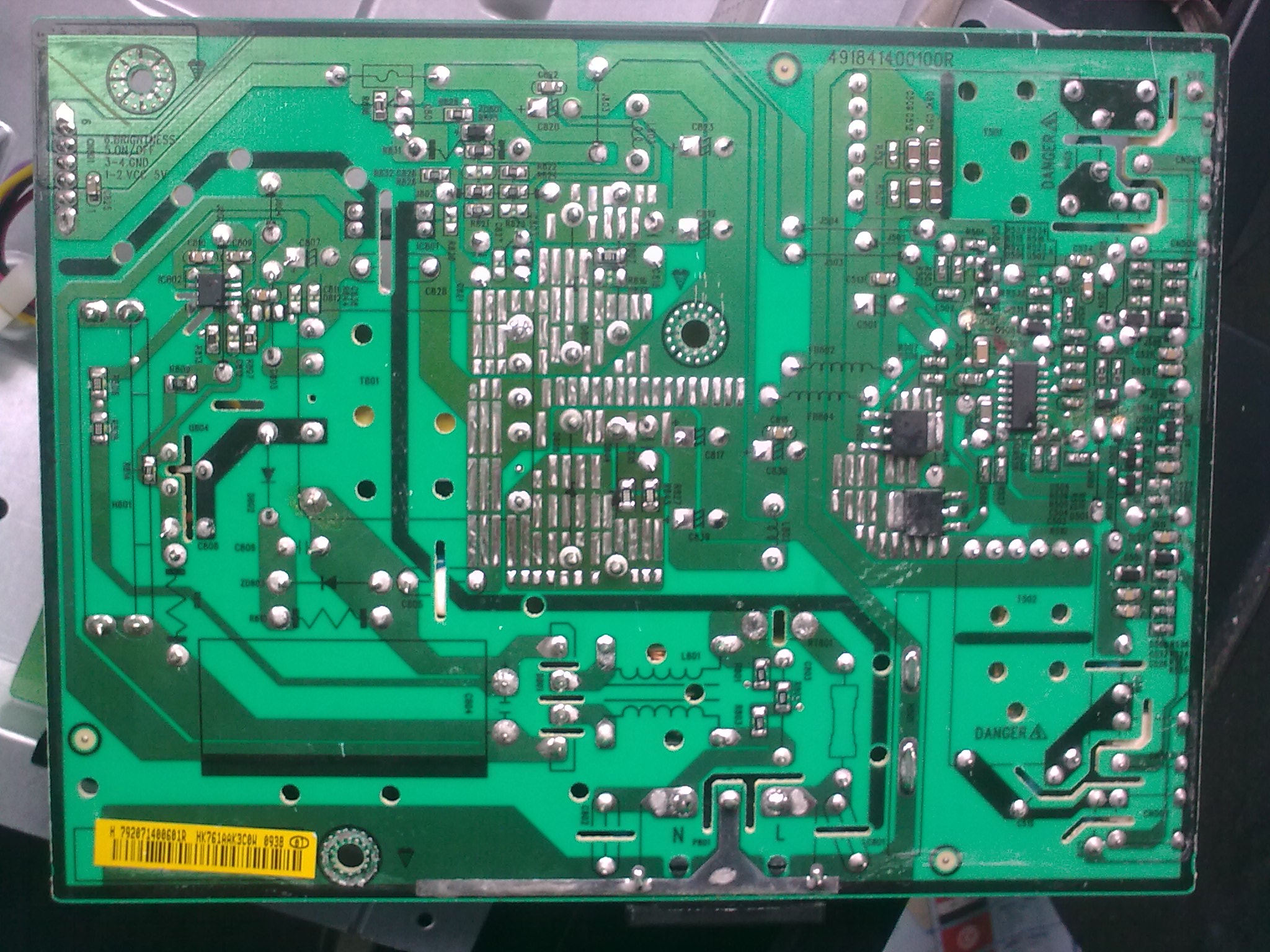

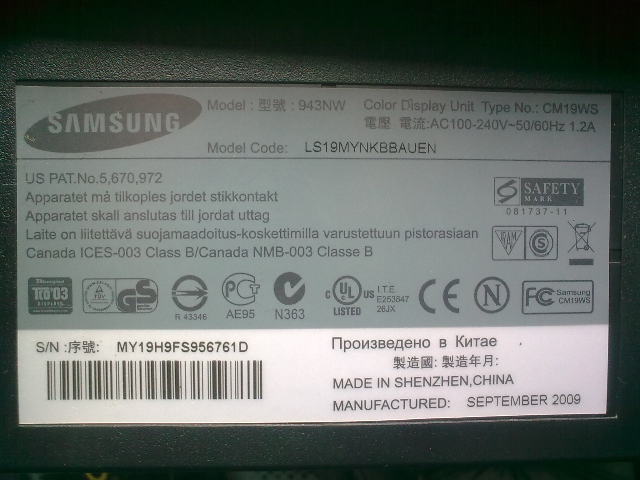

    Hi, I got burned some parts on ILPI-178, I tried to find schematic and values for that components on the board.
    Can anyone help me?
    Thanks!

    Re: Burned Components on LCD Monitor Power Supply ILPI-178 ILPI 178 (Samsung 943NW)
    Is this the same model?
    https://cdn.badcaps-static.com/pdfs/...eea2c8ca67.pdf

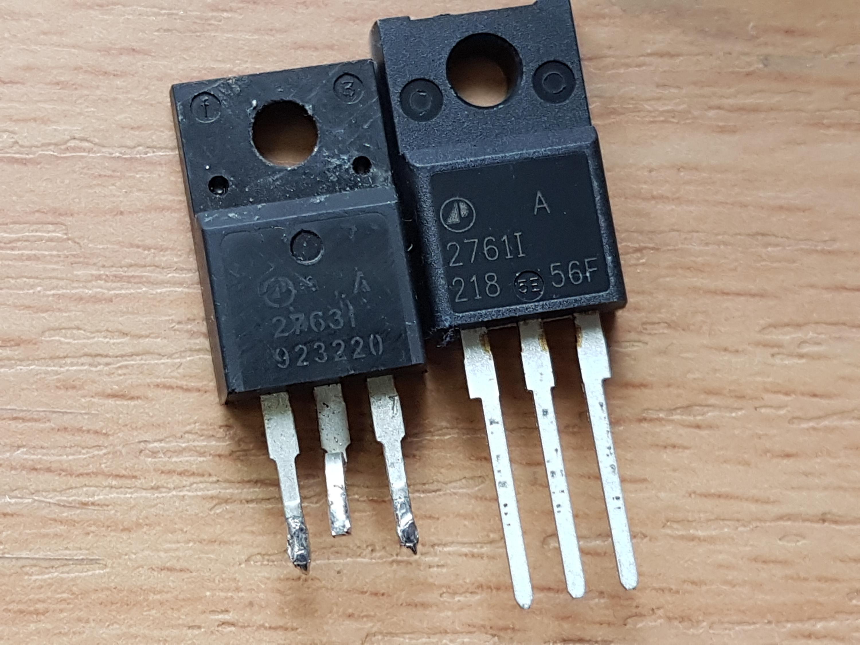

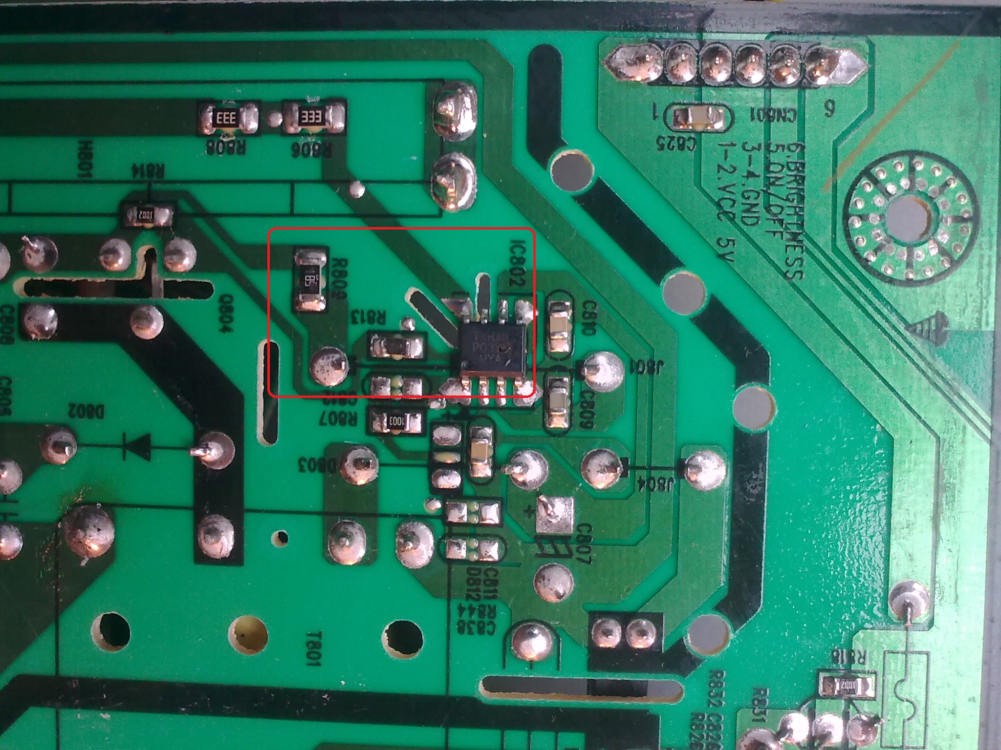

            It took some time, but all the parts arrived!
            LD7575
            R813 = 20Ohm
            Q804 = AP2761i (I got installed 2763I, but in the schematic was also 2761, so I installed that)
            R809 = 680Ohm
            R815 = 0.47Ohm/2W
            IC801 = PC817B
            I checked all this part and they all were blown - they are all red on service schematic
            Thanks for help!

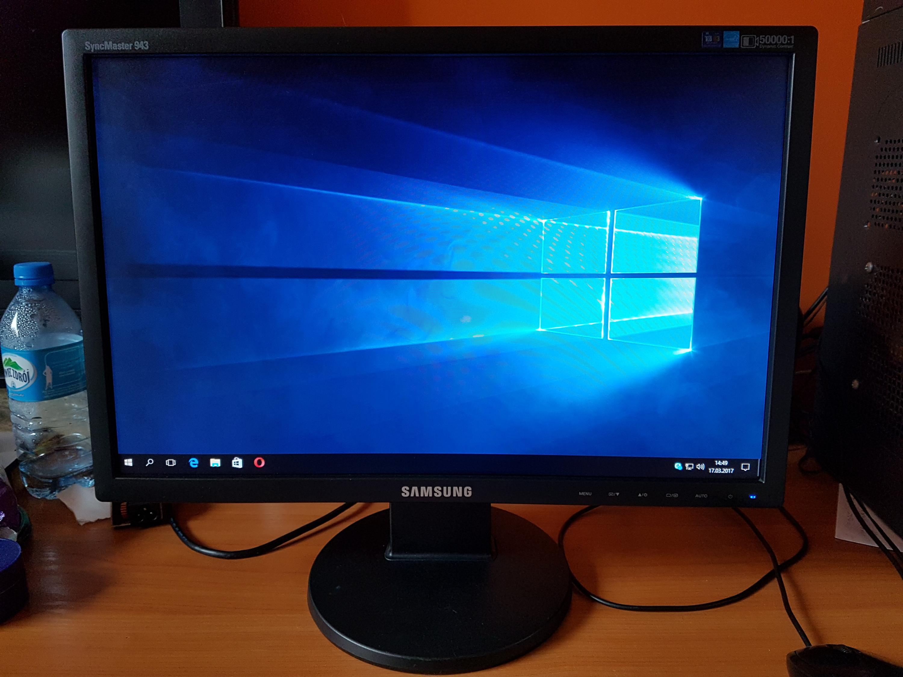

                Yes it is - i made picture to show that this is working again
                Thanks!
