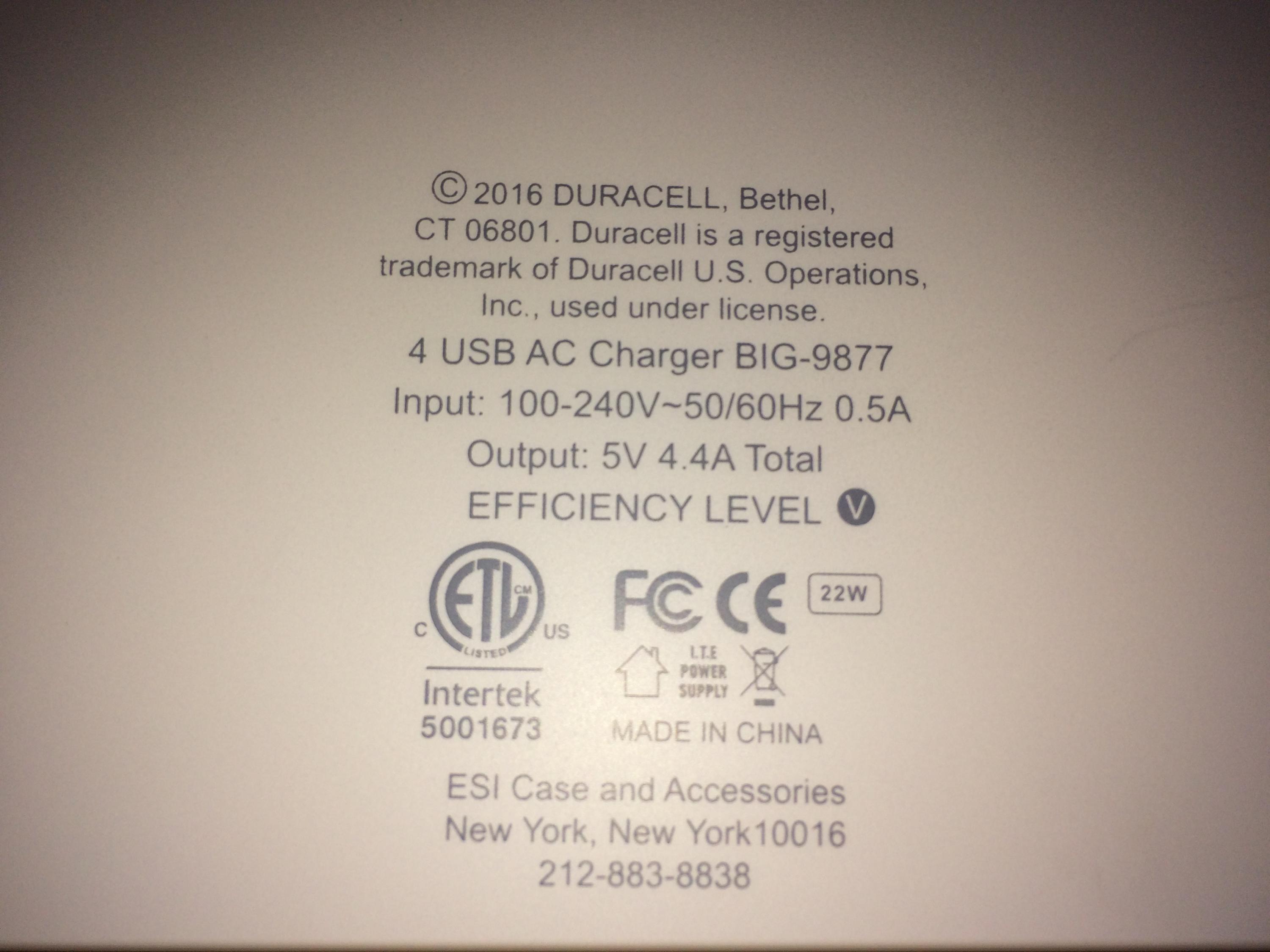

Duracell 2016 4 port USB charger 5v @ 4 amps
    • Jul 2011
    • 6040

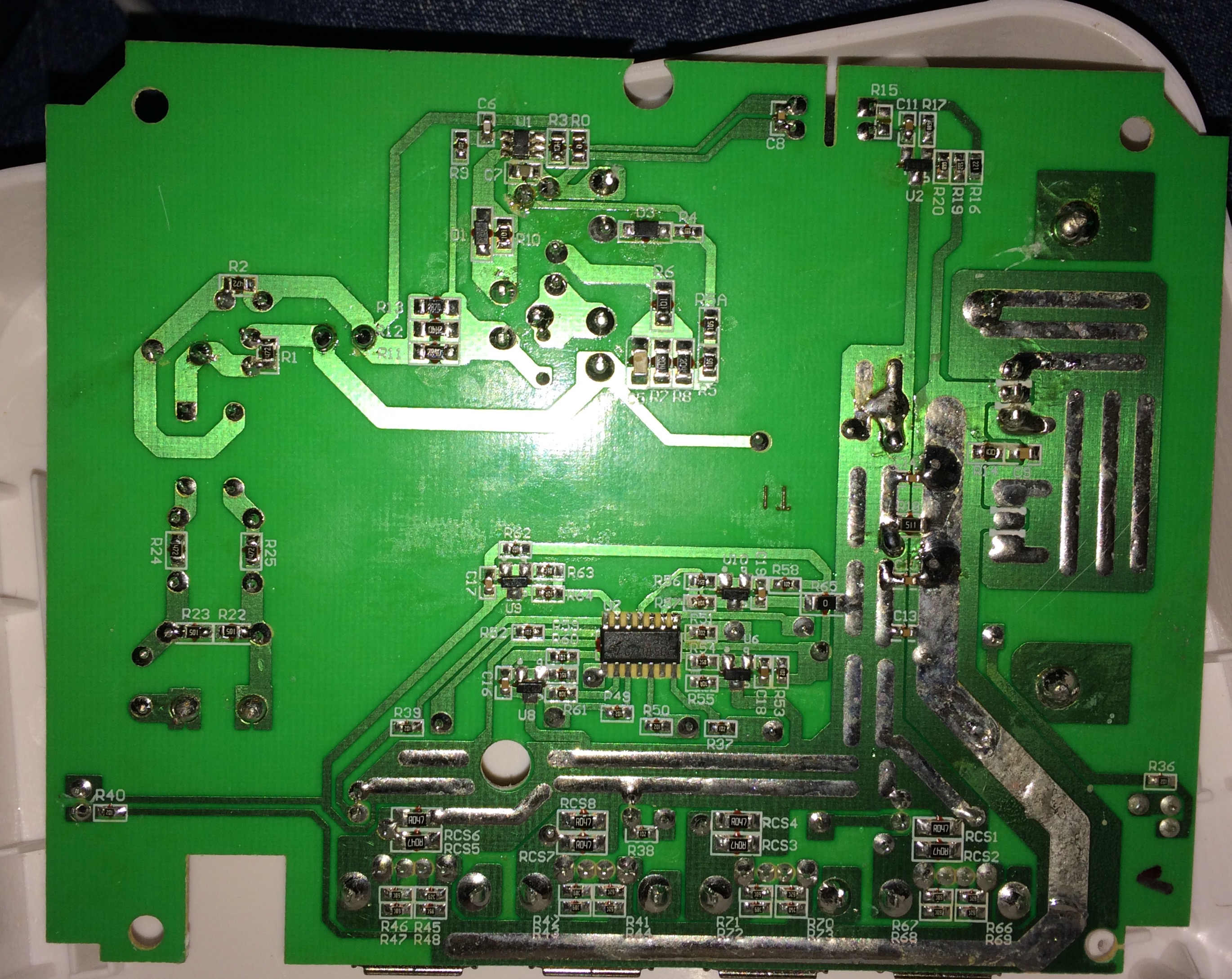

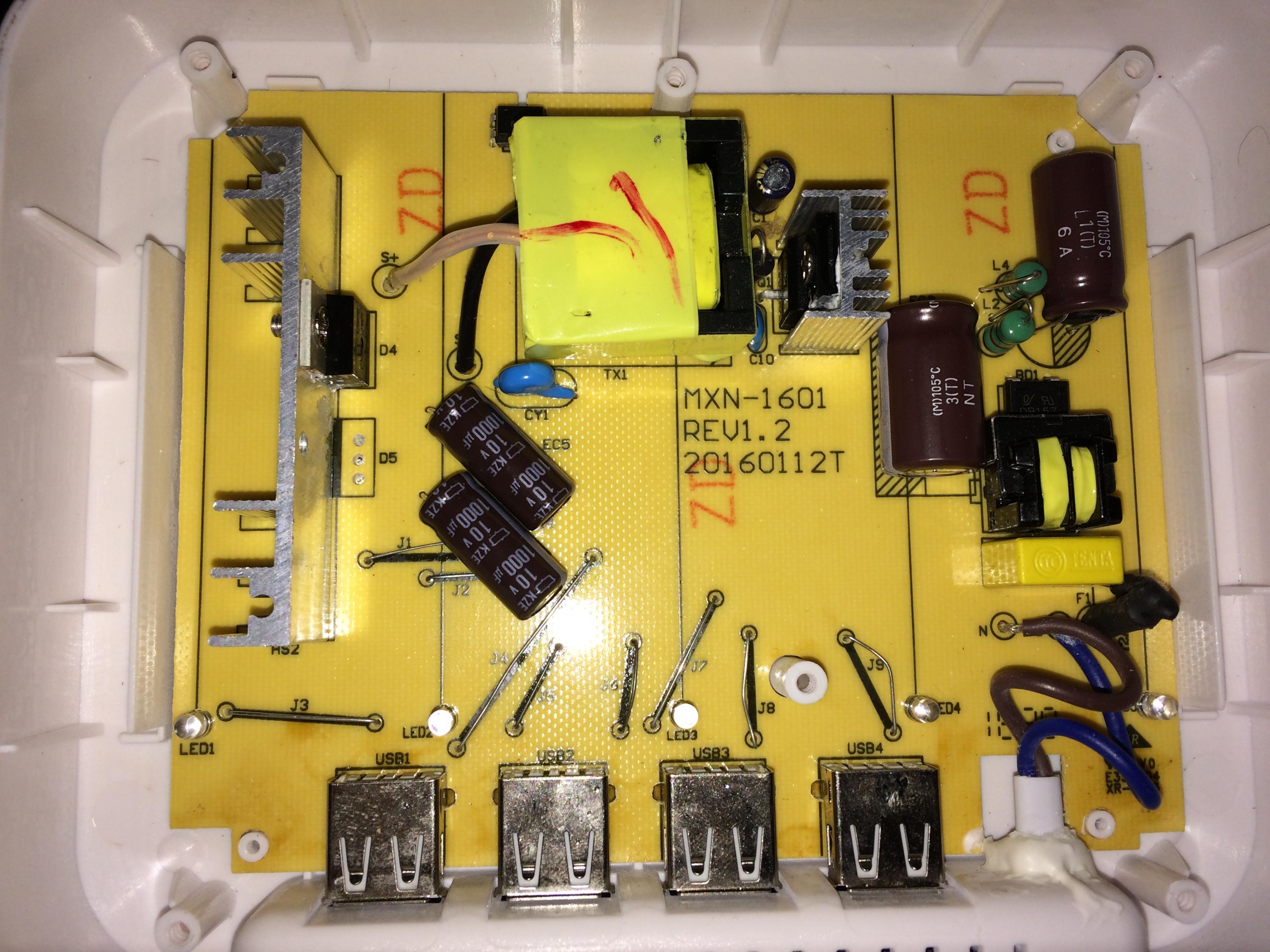

    What do you think about this power supply
    I just recaped this power supply it had no name brand caps in it
    If I do not recognize brand name I replace them
    • 31058
    Re: Duracell 2016 4 port USB charger 5v @ 4 amps
    looks pretty good to me.
      Same here.
      Had a 16 bay AA/AAA Titanium Innovations MD 1600-L from batteryjunction. Before using it, I opened and recapped it. Noname craps- two were leakers and another had either a loose lead or corrosion. I think I used Panasonic FRs or FMs in that.
      Recapped the SMPS wallwart too- that's a CWT and was full of cheapo-teapos and a crapxon. Used CS for the bulk filter, FRs for the secondary caps, and PWs for all others.
      This is my unit and it's been fine for 3-4 years.
