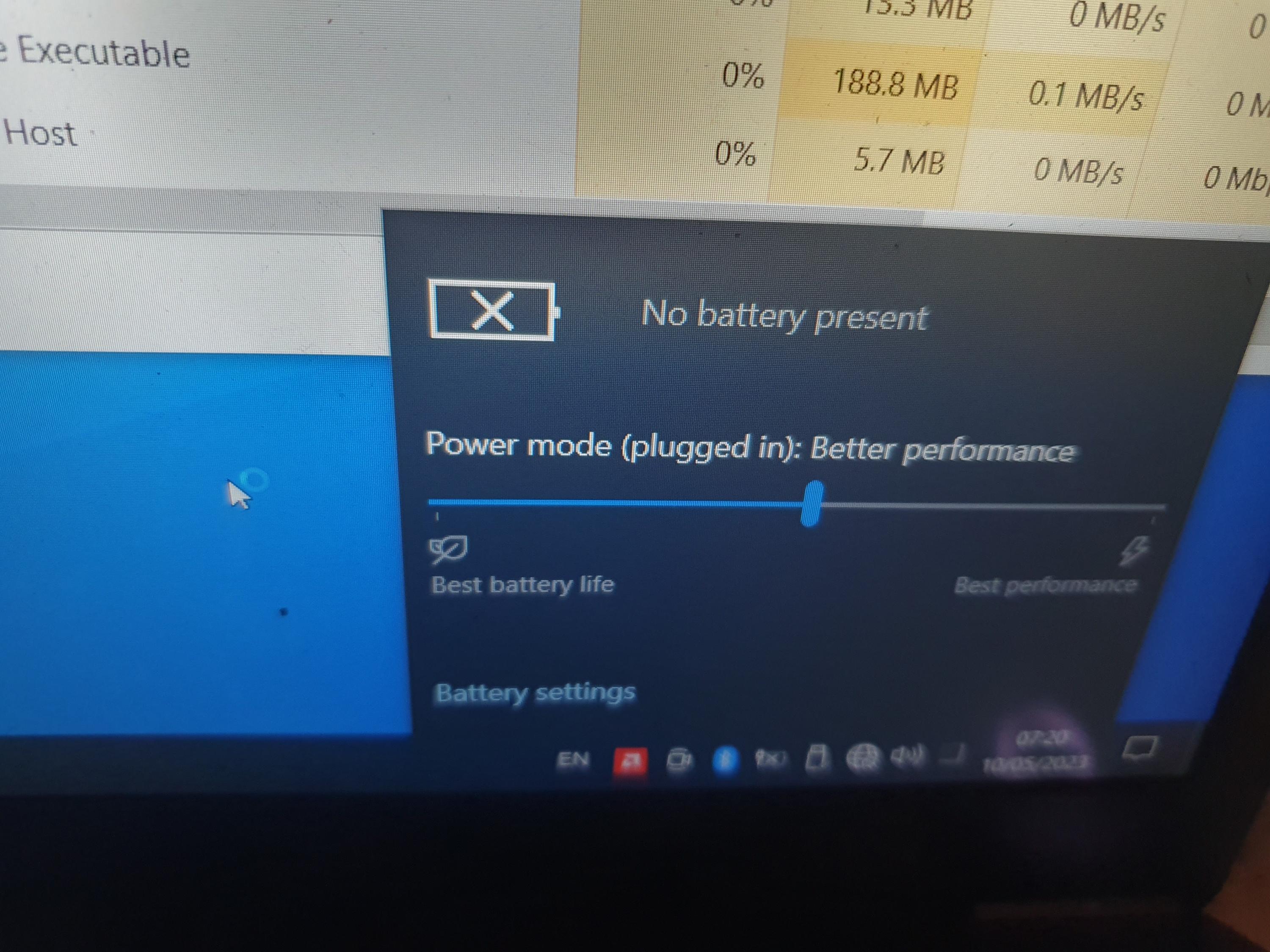

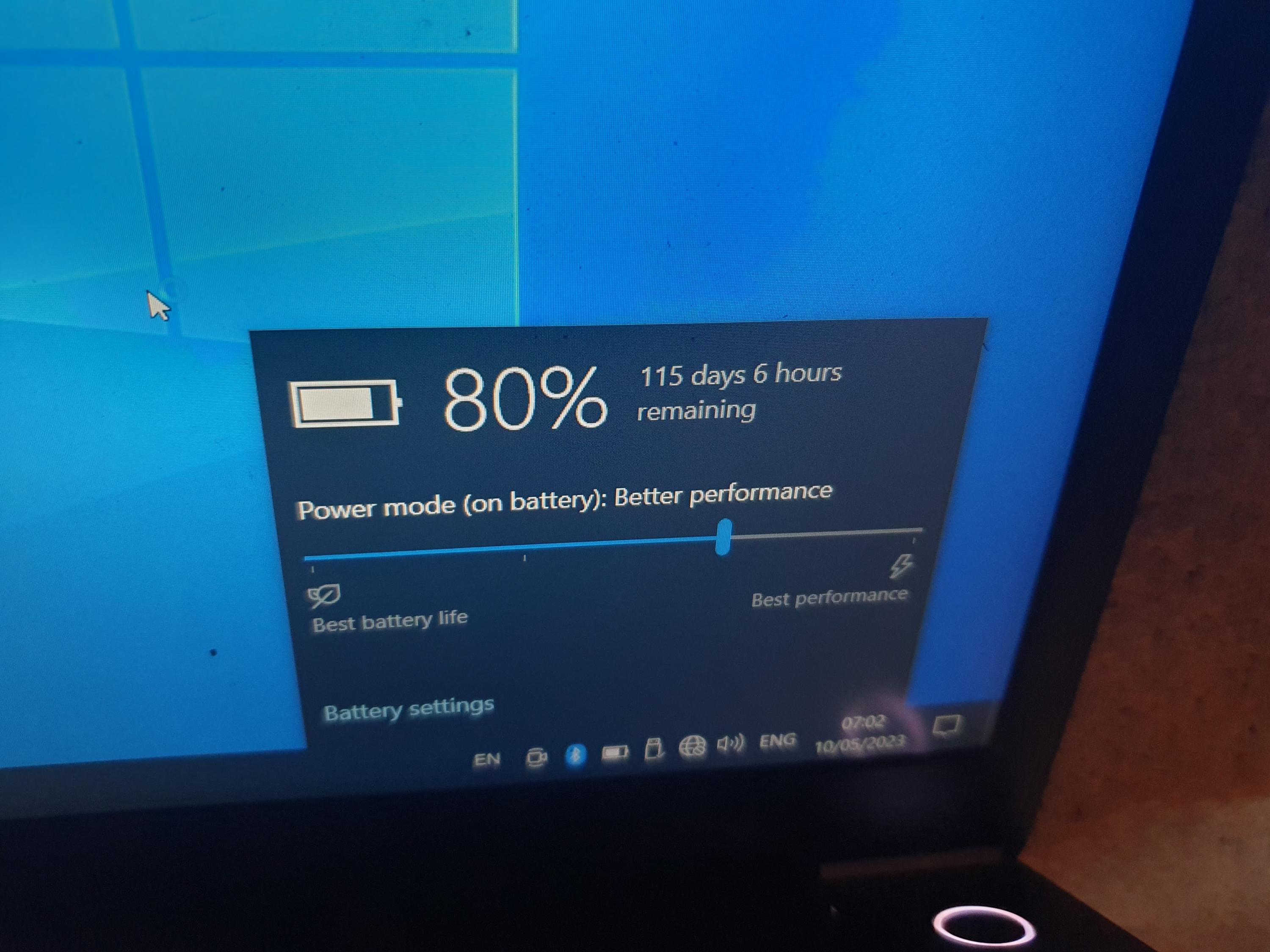

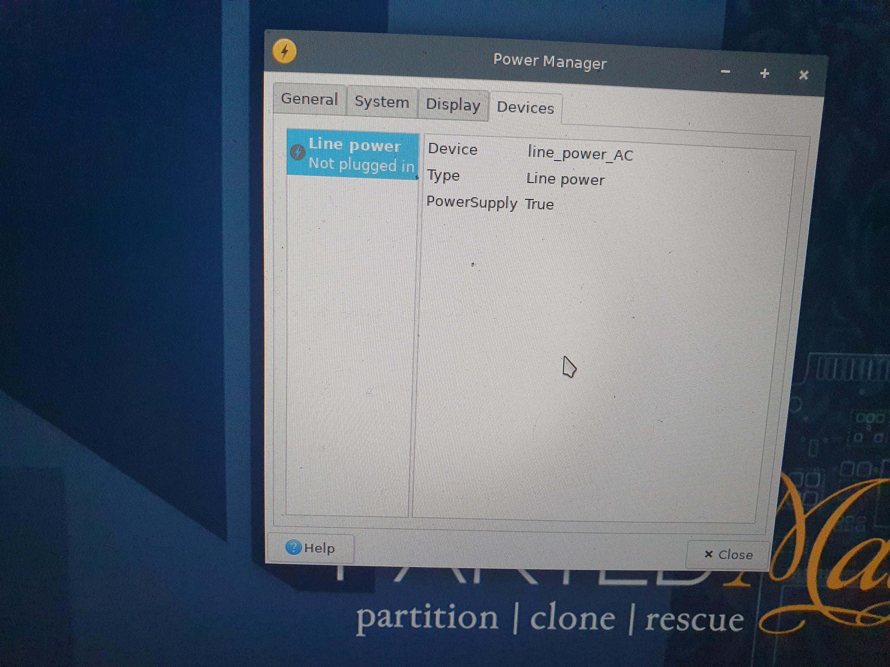

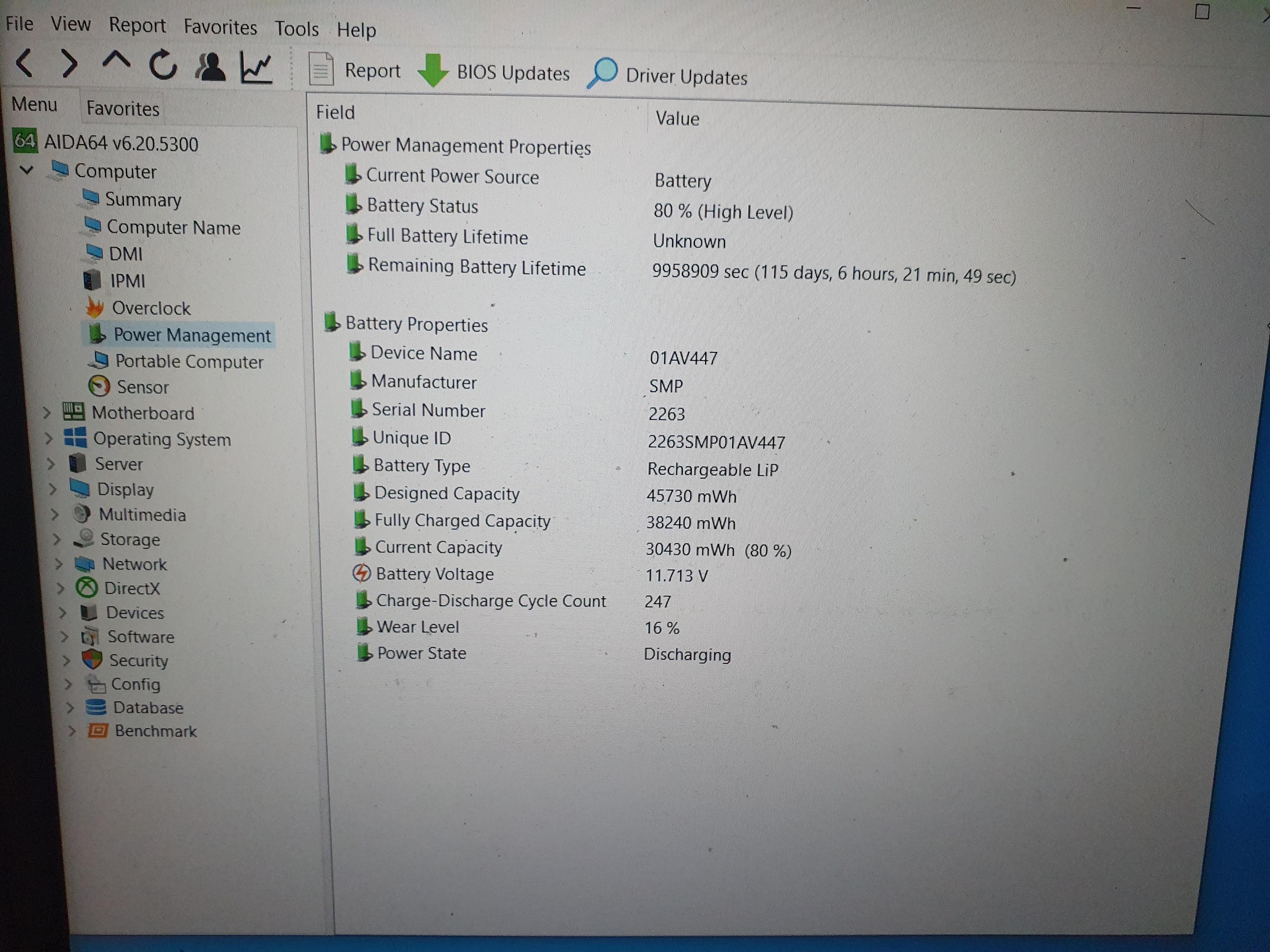

          you are right, sorry I was being a bit lazy and vague in my previous messages and that might've caused confusion
          I charged the battery to 80% using bench PSU, laptop will boot and run from it, it reads the percentage correctly as well as the BMS data (voltage, wear level, number of cycles etc) which you can see in the photo attached. I think it's safe to say the battery is good.
          When I plug in the usb-c charger I can see 20V and current being drawn 0.6-0.9A depending on load, but the laptop still shows as running on battery and not plugged in. However when the charger is plugged in, the machine draws next to no power from the battery resulting in some ridiculous time estimates as seen in photo.
          If I boot the machine with charger only and no battery connected, windows will then show it as plugged in with no battery detected, but under linux it still shows as "not plugged in". The charger LED stays off at all times, but I think it should come on based on my experience with previous usb-c thinkpads. In either case, if I then connect the battery while the machine is running, it immediately switches to showing as running off battery, with no charger connected, same as before
