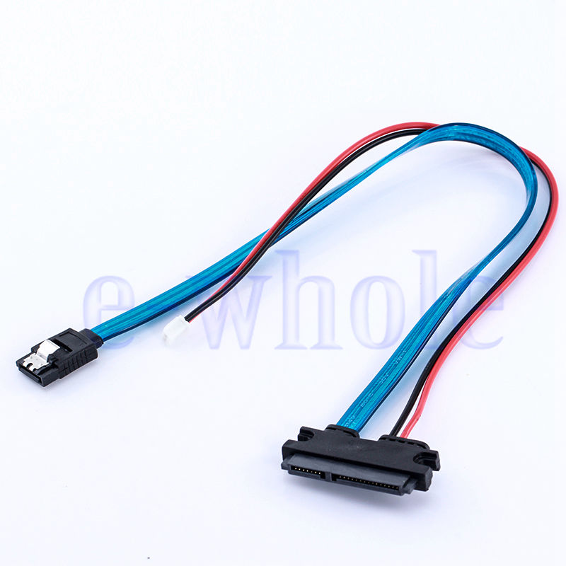

    Pi SATA Cable HDD Connectors With Power Supply Port Hard Disk Cable
    Hell all.,
    How to make this cable.
    Where is power voltage pin. thx.

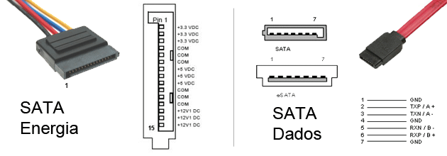

    Re: Pi SATA Cable HDD Connectors With Power Supply Port Hard Disk Cable
    this?
    • torla
      • 76
      nice, thx.
