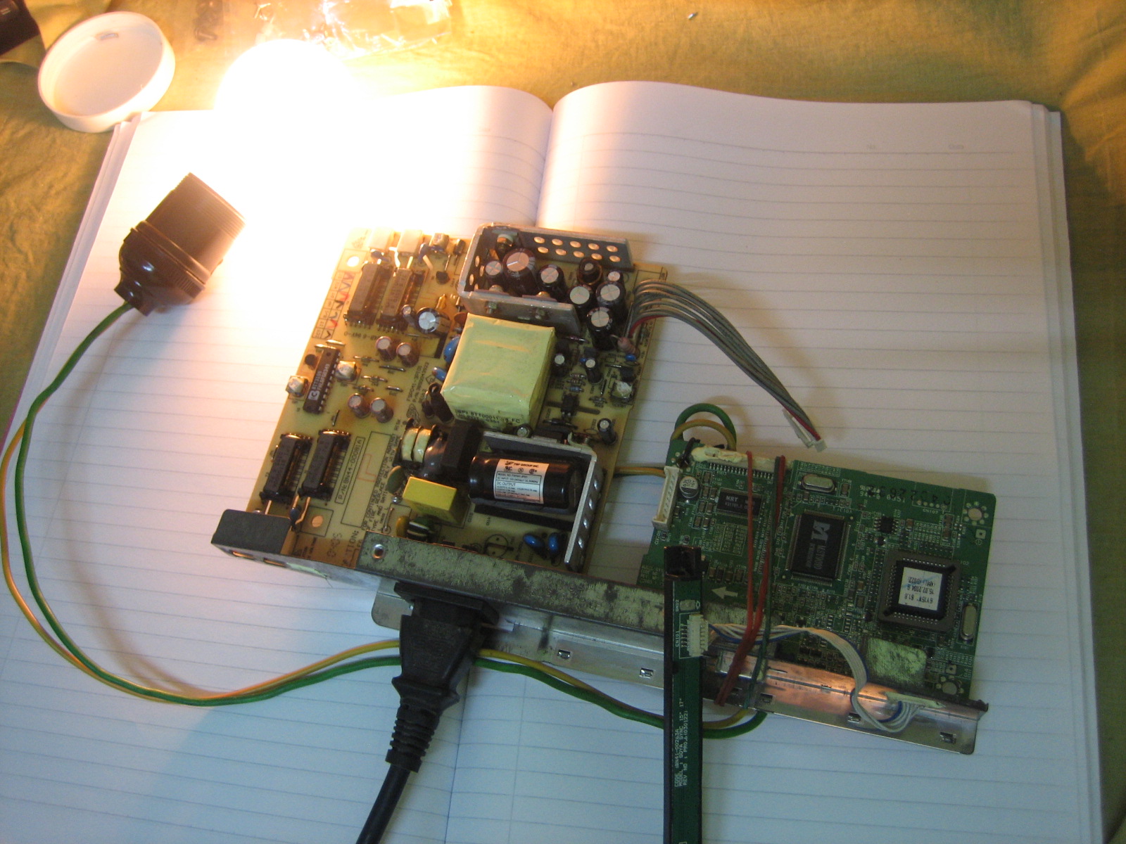

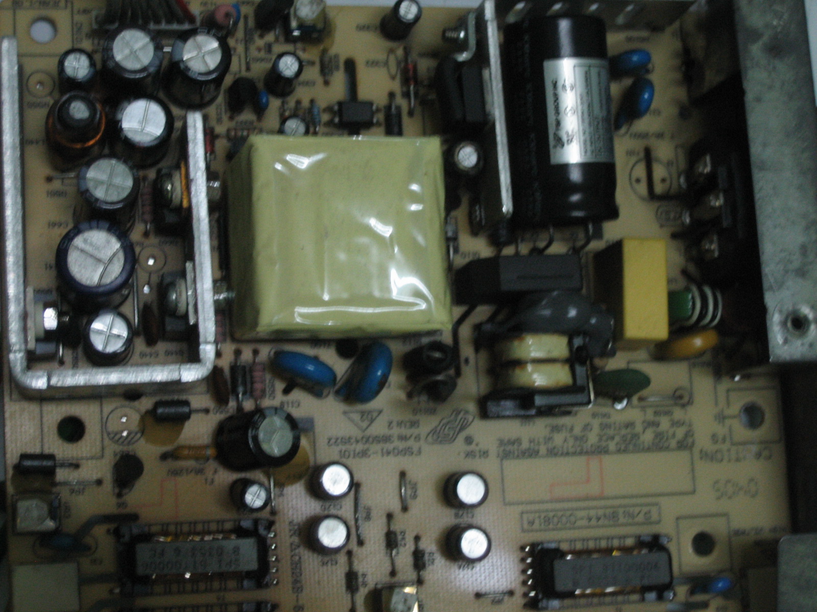

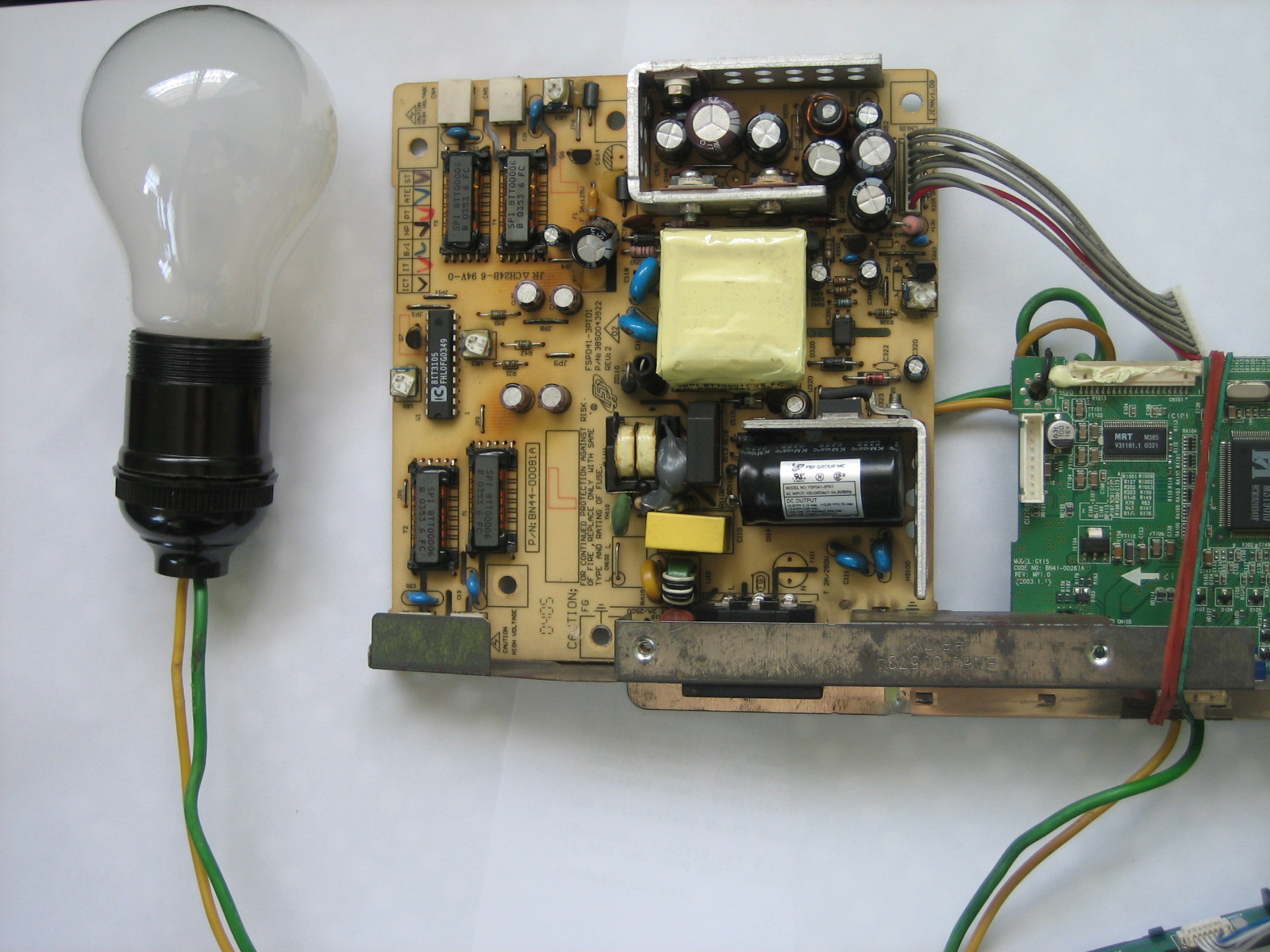

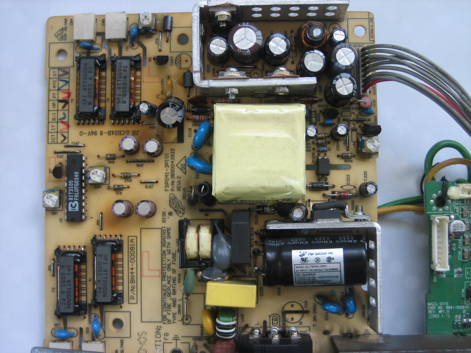

    A friend sent me this old Samsung Syncmaster 153V LCD monitor to repair. The problem is power board no power, completely dead no light whatsoever. the power switch led no light during testing or after switched on main.
    I had some basic skills in repairing dead monitor with a soldering iron,solder pump,a digital multimeter (DMM), and a digital capacitor meter. After opening up the case, I see no bulging caps or burnt marks on the power supply board and try search online for a service manual/schematic but none found.
    I ghetto work a 60W Light bulb tester(series current limiter) as per image 1644,I resolder the transformer (image 1629), and some 3 pieces 470uF25V caps at position C665,C662 &C661, also remove a 330uf25V cap at C17 and the 4 small caps (each is 47uF25V). Tested using my capacitor meter & Replaced those 470uF that reads less than 10% off scale (like 425uF)..... surprisingly the 4 small caps (47uF25V) in the center
    still reads within range, so i didn't replaced them.
    Tested continuity of transformer with an analogue multimeter, it shows continuity; so i put it back.
    Switched on 220AC main without connecting to LCD panel or vga board, the light bulb light on a second then lights off, followed by flickering(oscillating siren like) light bulb. This indicate somewhere there is still a fault. Also I noticed some buzzing/hissing noise near the yellow transformer area.I desolder the rectifier diode STPR10, off circuit tested ok, but anyway I replaced with STPR1020CT. Also i replaced new 470UF 25V & 1000UF 25V caps at C661&C441 just in front of the new diode.
    Did some volt test on primary bridge rectifier=232vAC, main cap=317vDC
    There is power from primary output.
    On secondary side,voltage test by red DMM probe to diode cathode & black probe to chassis on diode near yellow trans(transformer)=0vDC, same probe testing on diode D320=-101vDC (why negative? strange) On diode D440 on heatsink(SBL1040CT)middle pins=0 vDC(zero volt)
    Is the result clearly mean secondary side no power output ? somewhere along the line there is a fault.

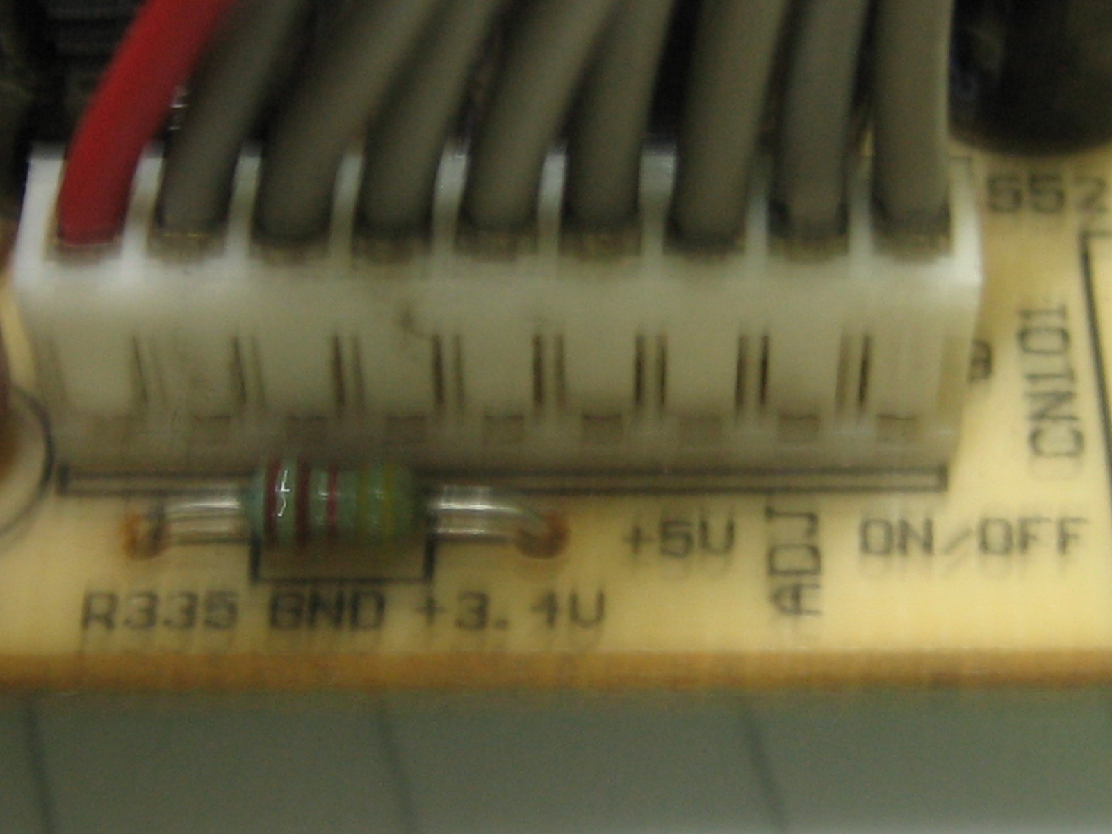

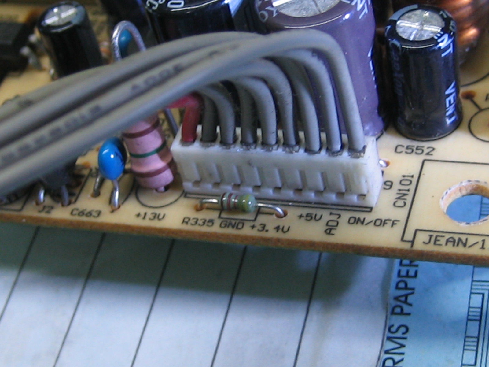

    How do I check output DC voltage on the white connector(image 1685) ? Do i put positive probe to third wire from right side marked +5v? then negative probe to chassis ?
    The light bulb in series still lit brightly flickering.
    Something else is shorted.
    Anyone pls help diagnose/solve this no power from secondary output or list down voltage test point.

    Was the fuse blown when you got it?

      Sounds like you have no STBY voltage to begin with. Check if you get STBY voltage on the secondary.

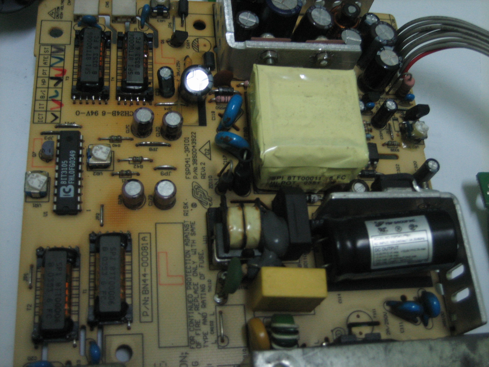

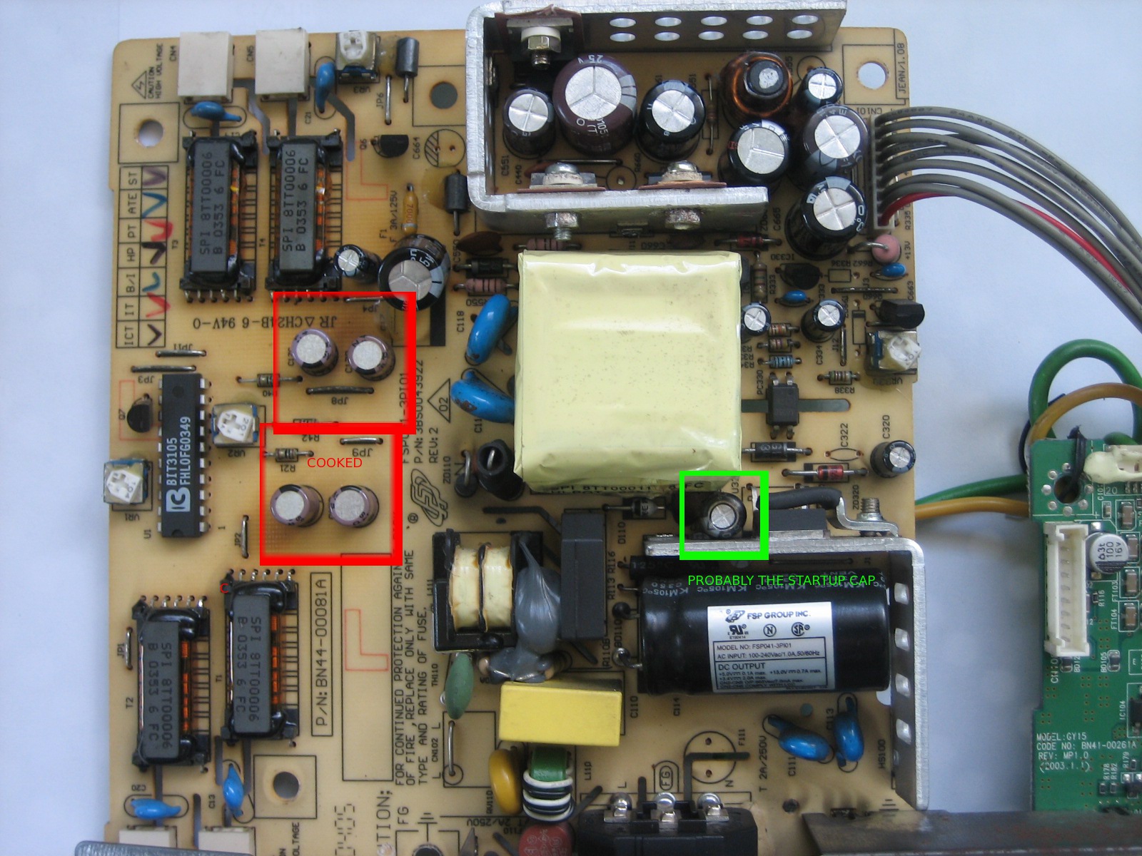

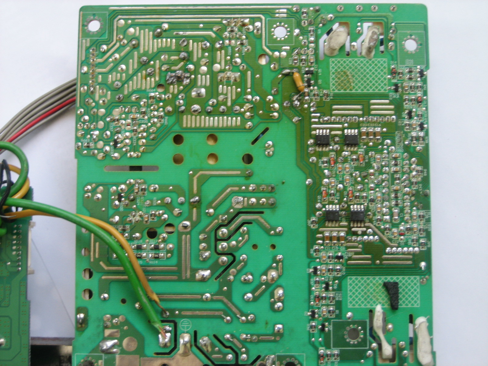

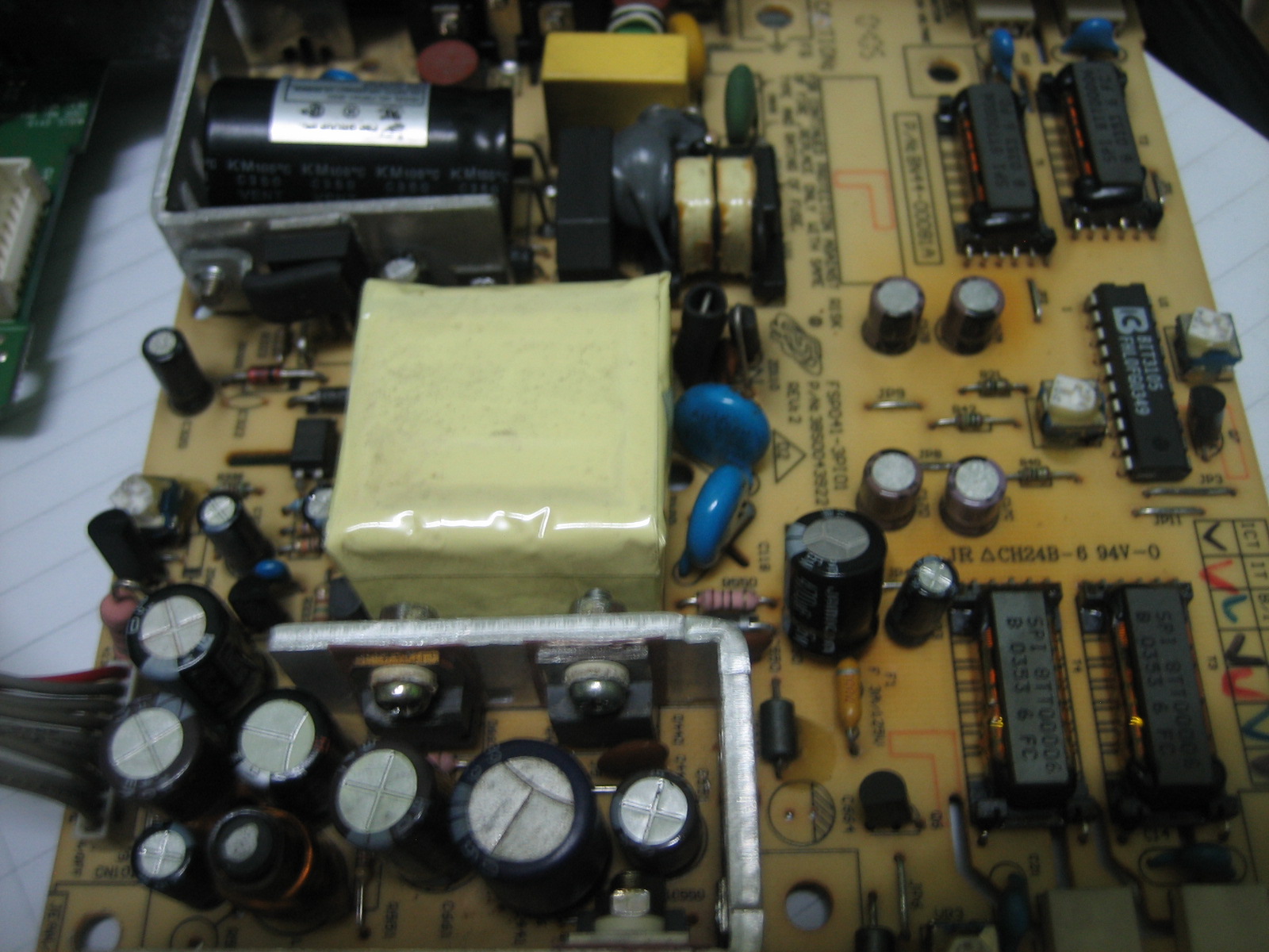

        firstly, you need to replace *all* the caps other than the mains filter.
        i dont care what your cap meter says.
        the pink looking ones are cooked, they are supposed to be light-blue and have changed colour from the heat!
        also the 4 small ones center right,
        one is the startup-cap and the sleeving has shrunk from the heat.
        probably because the stupid-fuck designer put it between a heatsink and transformer!
        i see you fitted a panasonic in there,
        it looks like silver on black.
        if that's an NHG series then it wont work in a psu - you need FR,FC,FM or FK series.
        NHG is not low-esr

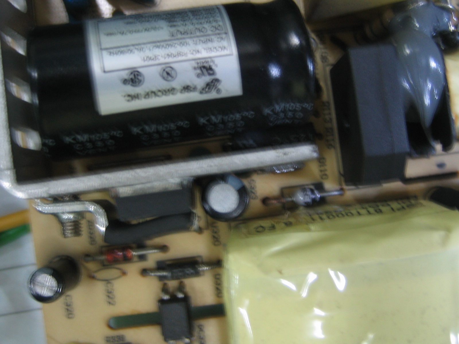

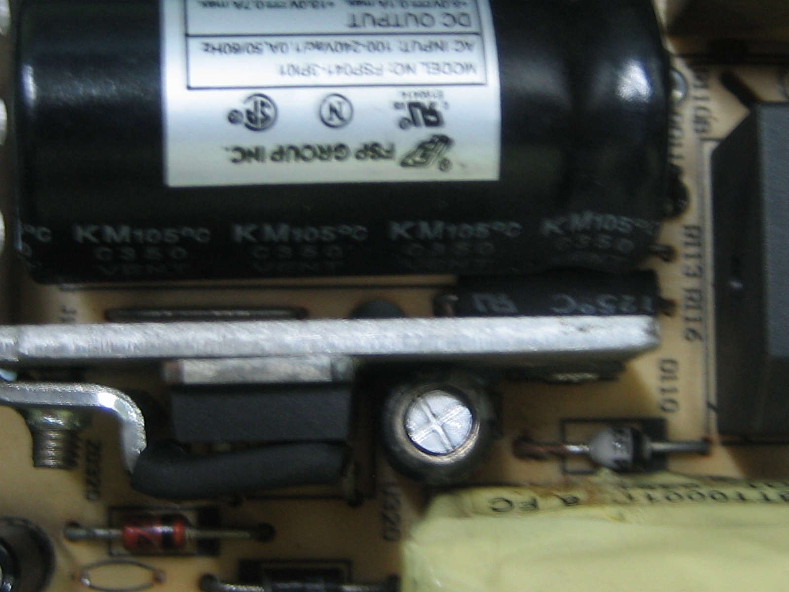

          whats the brown lump top of first pic on the diode to the left is it brown glue ?
          that may be an issue as it goes conductive

            The fuse is not blown, on continuity it tested ok(dial swing) with an analog meter. Now,I
            had soldered in a light bulb series as current limiter (img 1727) in place of the fuse.

            How /where do I check if I have STBY voltage on the secondary ? Is that the cap near position U320 on img1629 (the small cap with brown glue like lump on diode which is between heatsink & transformer)?
            stj,
            Are you referring the startup cap which position U320 on img1629 (the small cap with brown glue like lump on diode which is between heatsink & transformer)? If possible, maybe can you mark the startupcap in red.
            I will try to source at local shop for the 4 small caps center right; and the Panasonic silver on black NHG series to either FR,FC,FM or FK series.
            comptek,
            I had scrapped off the brown lump glue like substance just in case it is conductive.

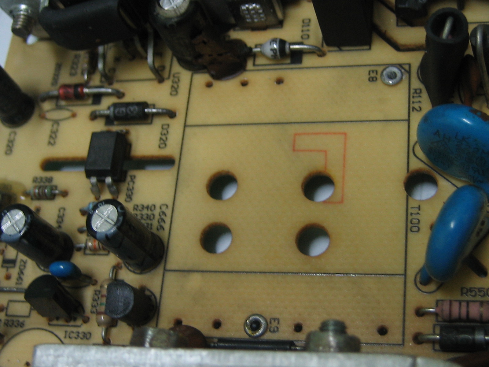

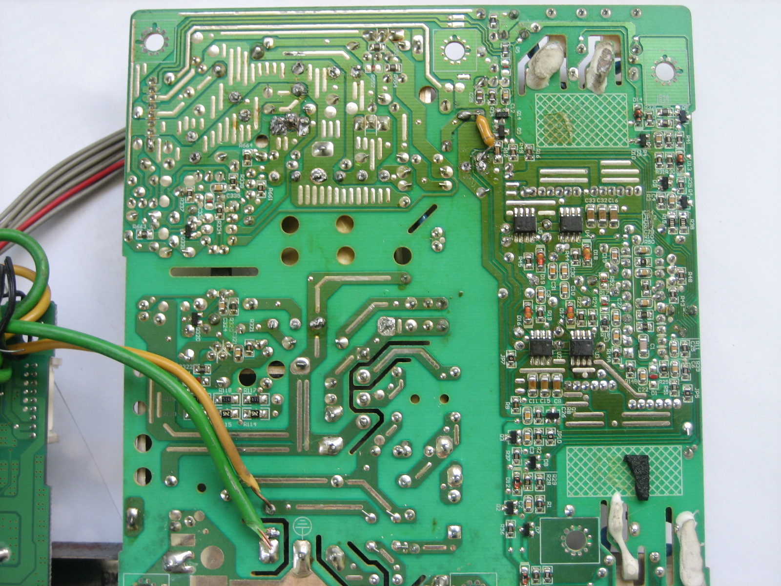

              Measure all voltages on your picture #7 and post them with the pin out name.
                • 31246
                Re: Need help on Samsung Syncmaster 153V
                see pic

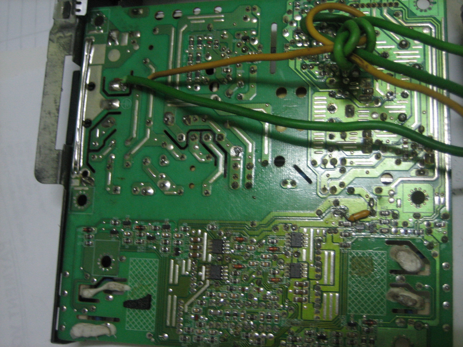

                  Hi Capleaker,
                  In earlier post,I had scrapped off the brown lump from the possibly startup
                  cap at C323. I switched on AC mains,the light bulb in series lit a second
                  then dims off; this time no flickering or hissing noise.Then I set DMM to DC,
                  black proe touching on metal chassis and red probe to each of the 9 pins on
                  img 1737,but sadly all pins read zero.(also no blue LED on power switch)

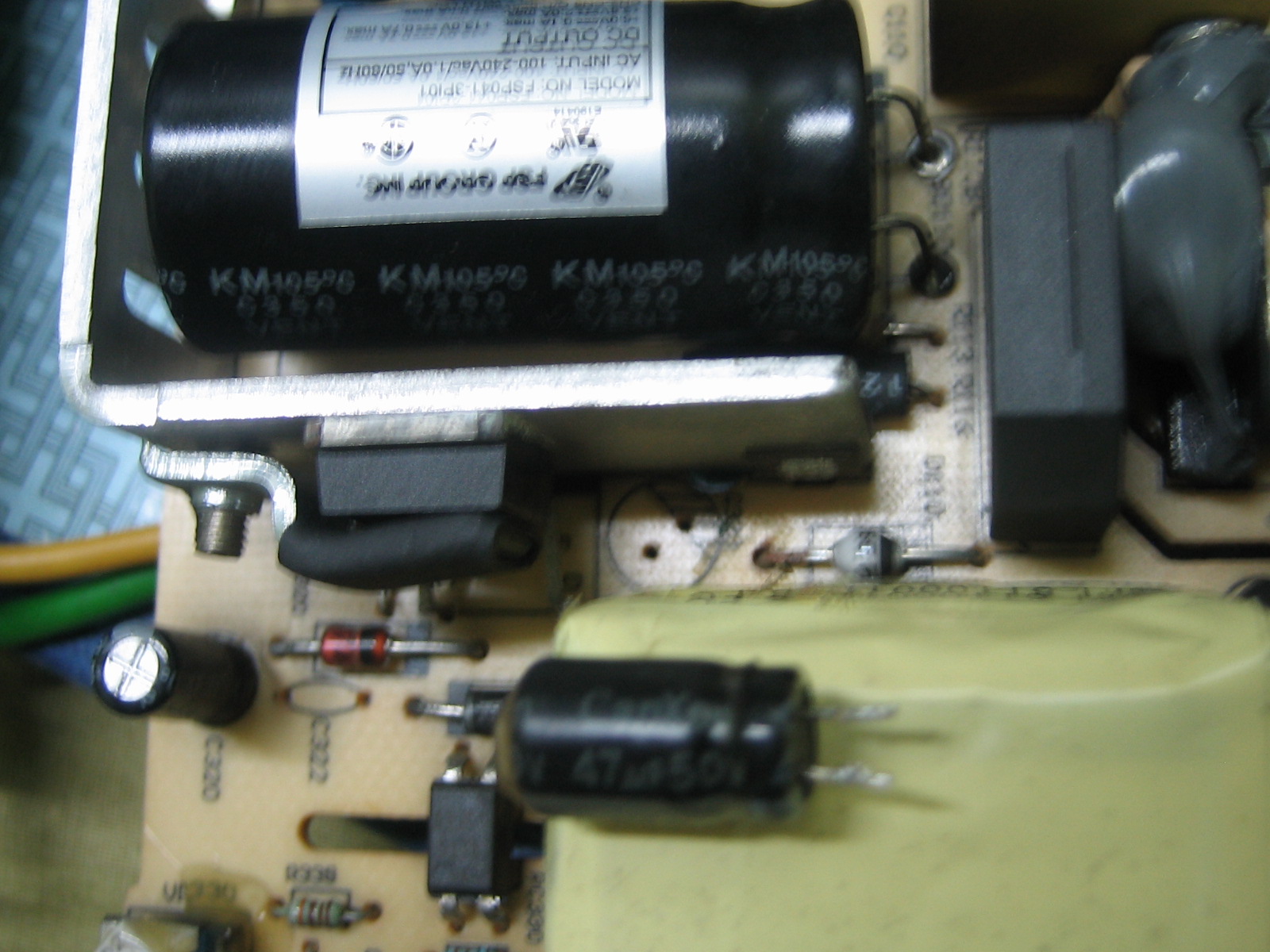

                  Out of curiousity, I replaced the old startup cap (Capxon 47UF50V) with a new
                  Maxcap 47UF50V) with same zero voltage reading on DC scale.
                  Where do we go from here? Hoping for your generous help to solve no power
                  issue and to have a learning experience.

                    the 4 pink ones are for the backlight invertor, but the small ones on the right really need to be o.k. for standby to work

                      Hi stj,
                      Will find time to get the 4 pink small caps, they are Capxon 47UF25V.
                      Last night, I replaced the old startup cap (Capxon 47UF25V) with a new
                      Maxcap 47UF25V), scrapped off the black lump, then on DC voltage test the output still reads with same zero voltage reading on DC scale.(my test is on 9 pins pinout on img 1737 post #9.
                      Is this the only startup cap for the standby to work? Hoping for your kind advice.
                      Thank you.
                        • 31246
                        no, the small ones are all related to starting and running.
                        wtf is maxcap? that's probably worse than capxon.
                        cant you find any rubycons like YXF,YXG or YXJ, or some panasonic FC or FR?
