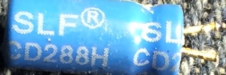

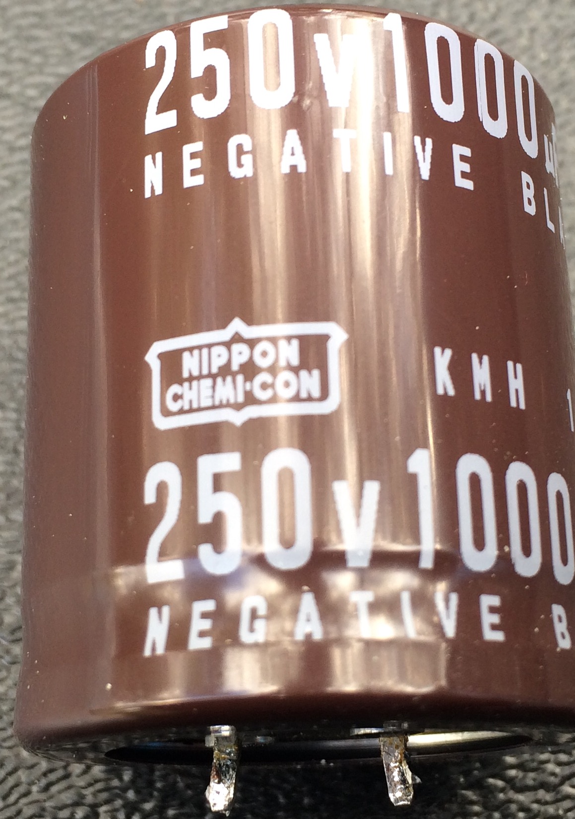

    This unit has a switching power supply which did not have low ESR caps in it
    Which I was surprise to see
    I recapped with low ESR caps I used (LXY) 47uf@50 volts (12) of them
    One 100uf@35 volts (LXY)
    Two 1000uf@250 volts
    And one more I do not remember the value
    I ran it at full speed and seem to like the caps that I put in it

    What were the brands/markings on the original units?

      Here are the 47uf @25 volt caps that were in it

        Here is some of the caps that were in it
