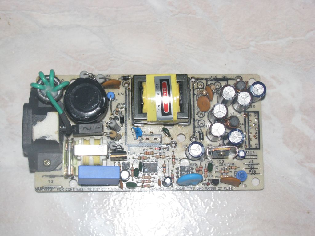

    Hello
    Some time ago I bought a power supply model ITE UP30432 +5V/-5V/+12V 3A/0.3A/2A Power Supply 5 Pin just like the one in this link: http://www.ebay.co.uk/itm/ITE-UP3043...8AAOSw-7RVELkT
    Since I bought it, there was a problem with it... it did not power up
    The previous owner replaced the 12v shotky diodes with two regular rectifier diodes and I replaced a fuse and two small caps in the high voltage part of the circuit
    Right now the power supply powers up intermitently (ticking sound and small voltage variations (12,11v...12,38v and 5.08v...5.19v) and I can't tell what component could cause this
    Since I suspect that the previous owner replaced some resistors too, I would like to get the diagram/schematic of the power source to check wether that is the case
    Thank you

    Re: Help finding schematic for ITE UP30432

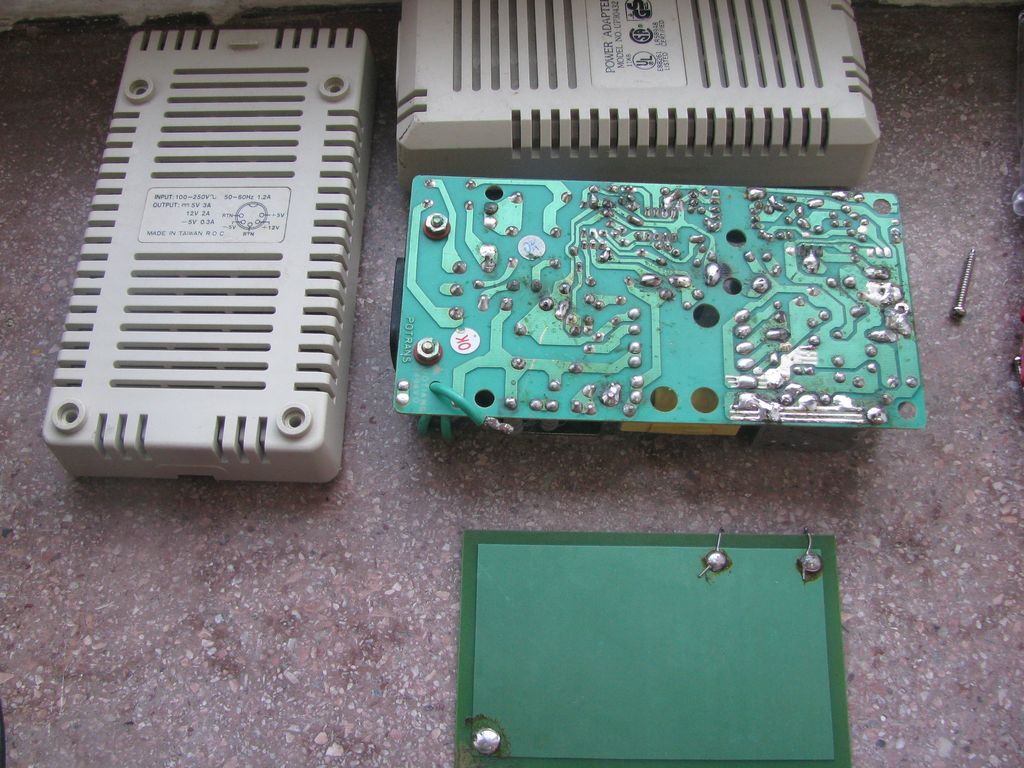

    post pcb foto
    • badrianiulian
      • Apr 2012
      • 43
      • Romania

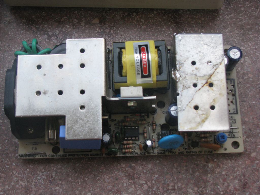

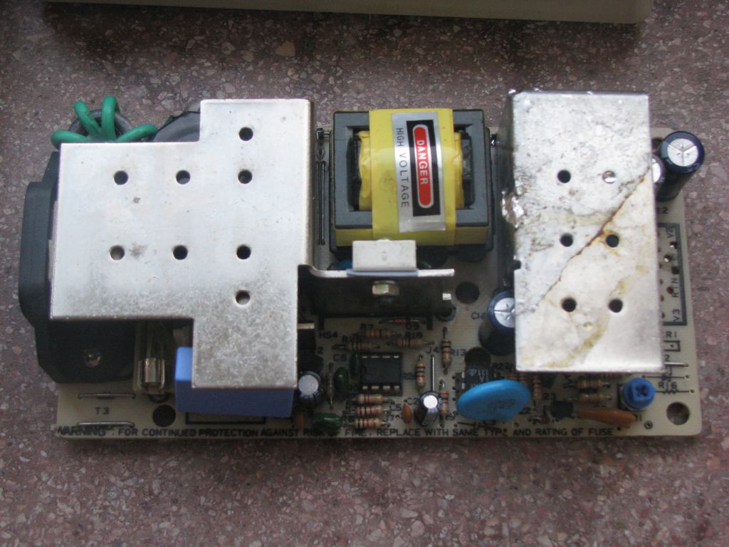

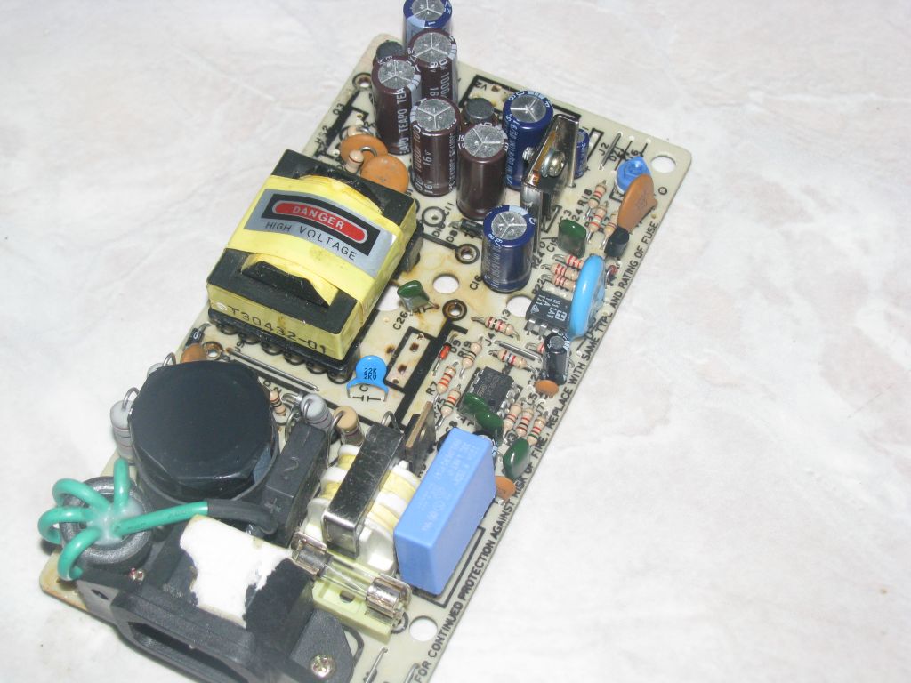

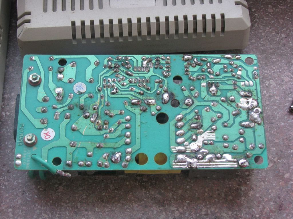

      Here are the pictures... these are the best I can do
        • 31087
        replace the 2 small caps in the center area.

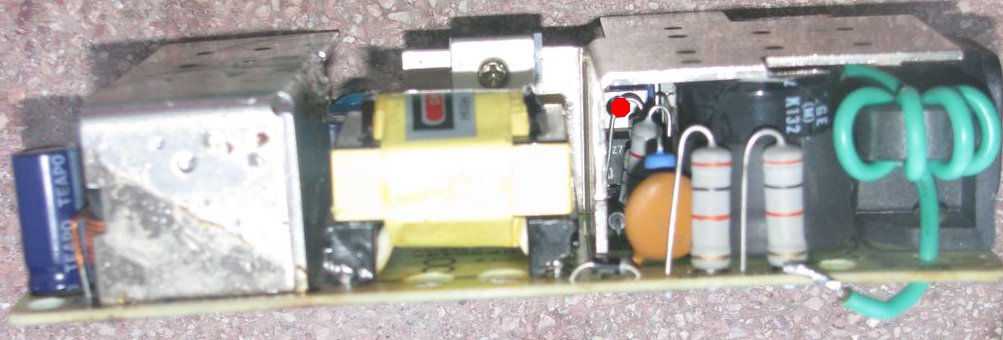

            you have parts not bolted to the heatsink - any reason?
            • badrianiulian
              • Apr 2012
              • 43
              • Romania
              What do you mean... there is the first heatsink that has the mos-fet
              There is another TO220 transistor witch did not have a heatsink in the first place in the hight voltage area.
              On the second heatsink there are the shotky rectifier diodes.. two for 5V and two for 12V... the -5V has only one small diode on the board and a 7905 regulator
                    The capacitor to the right of the chopper and partly obscured by the output heatsink appears bloated.

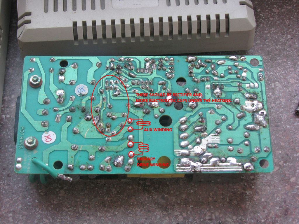

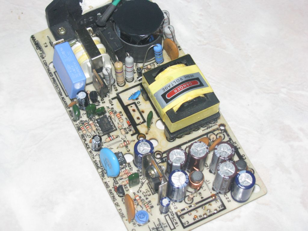

                                I expect more lytics caps in the prrmary side than just those two, may be under the heatsink?
                                Hard for me to trace the circuits due to the heatsink is in the way.

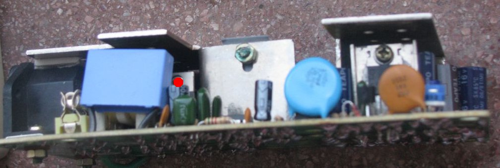

                                  • 31087
                                  i expect you to bolt things to the heatsink.
                                  red dot = missing bolt
                                  dont forget to use an insulating kit.

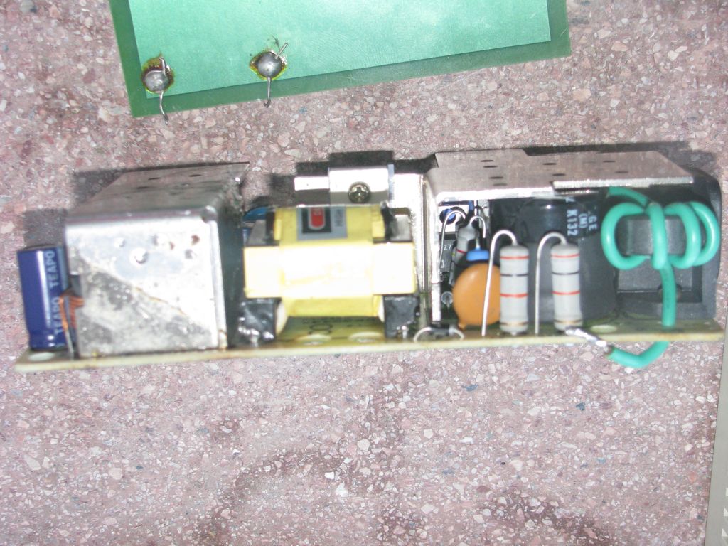

                                    That one without the heatsink looks to be fed by the AUX Voltage from the AUX winding. Vreg IC?

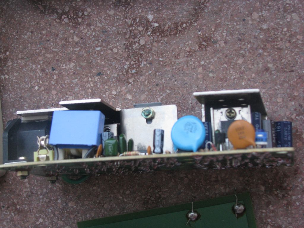

                                      Here are more pictures:
                                      • badrianiulian
                                        • Apr 2012
                                        • 43
                                        • Romania
                                        The one without a heatsink is a BUZ71A 13A/ 50V/ N-Channel Power MOSFET ... it is fed by the AUX winding
                                        Vrev is variable from 0,3V to 1,4V
