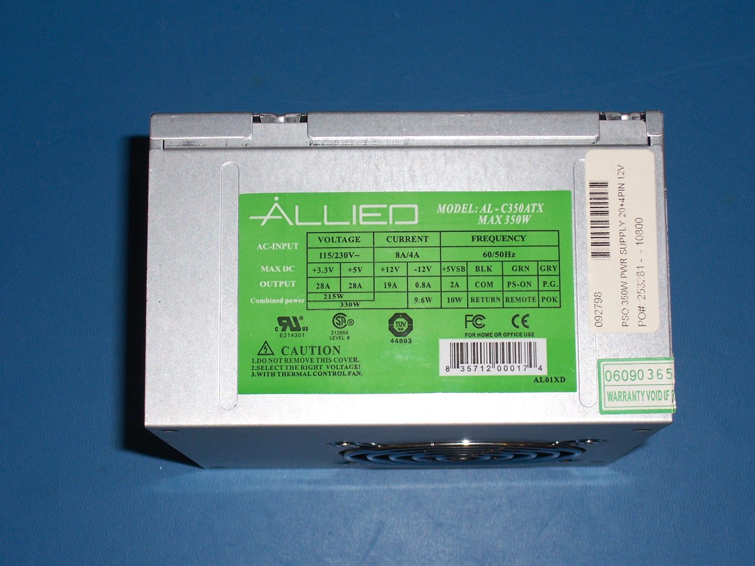

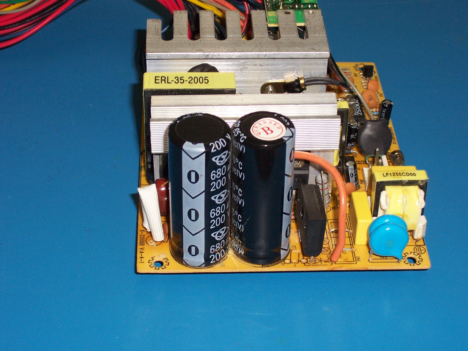

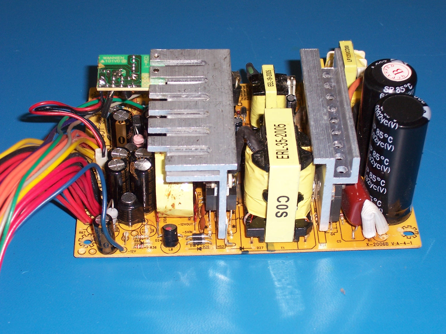

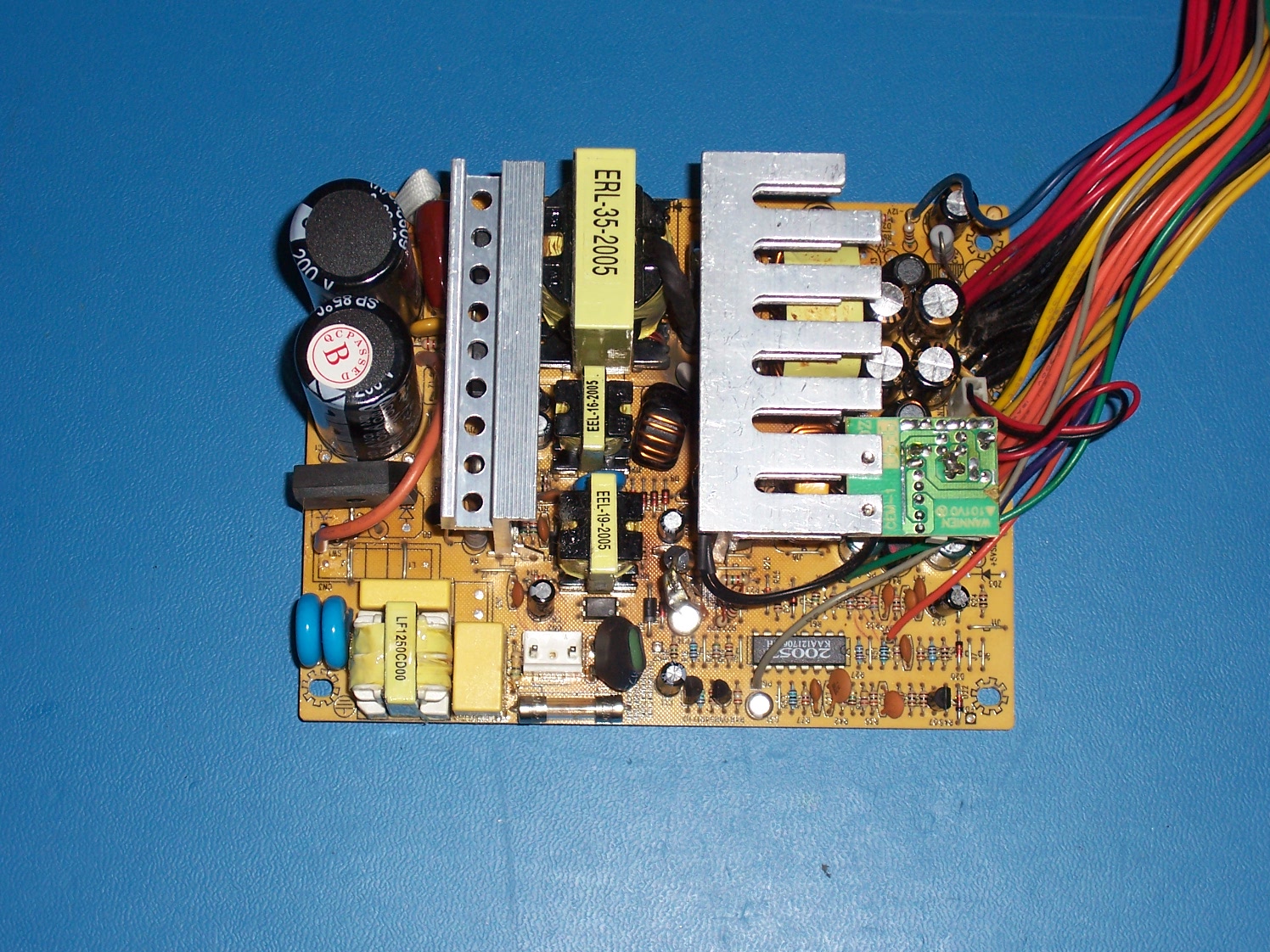

    My latest project, a L&C Allied AL-C350ATX, completely dead. No 5VSB, and a two transistor 5vsb circuit. Also a couple of bulging Saturn capacitors in the output. So I have started by removing the pc board from the case. Here are some pictures.

    I would try to repair that. Looks capable of 350W.

      The 'saturn' caps on that PSU are Yang Chun. It definitely seems to have a bit of beef to it. It looks similar to this - http://www.hardwareinsights.com/wp/t...TM-420-PSAR-I3. I pulled 350W from it, but blew it up at 400W. I wouldn't trust it for any higher than 300W for a long period of time, though.

        I replaced the output pi filter capacitors on the 12 volt, 5 volt, and 3.3 volt rails with Nichicon PW series capacitors. Two were bulging and had high esr. The remaining four measured ok for esr. I decided to replace them all since I don't trust Saturn capacitors.
        The two mains capacitors are also Saturn. I am wondering if I should trust them or change them. So what do you think?

          Measure their capacitance and if it is in specs leave them alone.

            With power applied, no 5vsb. With the pc board out of the case I can now troubleshoot it. First, the fuse was blown. No wonder it has no 5vsb! I started checking silicon devices. Switching transistors OK, output diodes OK, then found that one of the diodes in the input bridge diode was shorted. Replaced bridge diode and fuse. Now it is up and running. I wonder what blew one of the diodes in the bridge diode??
