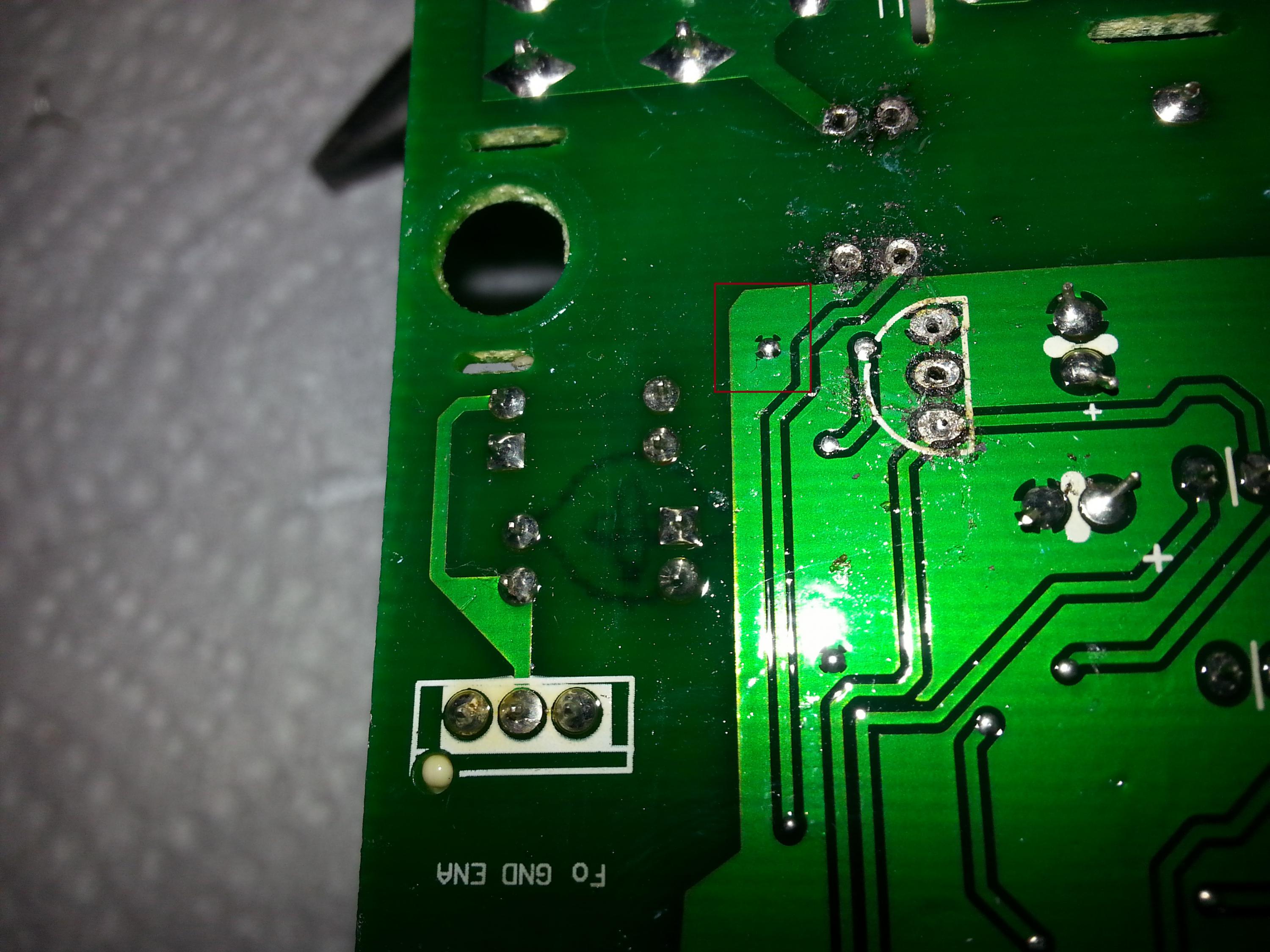

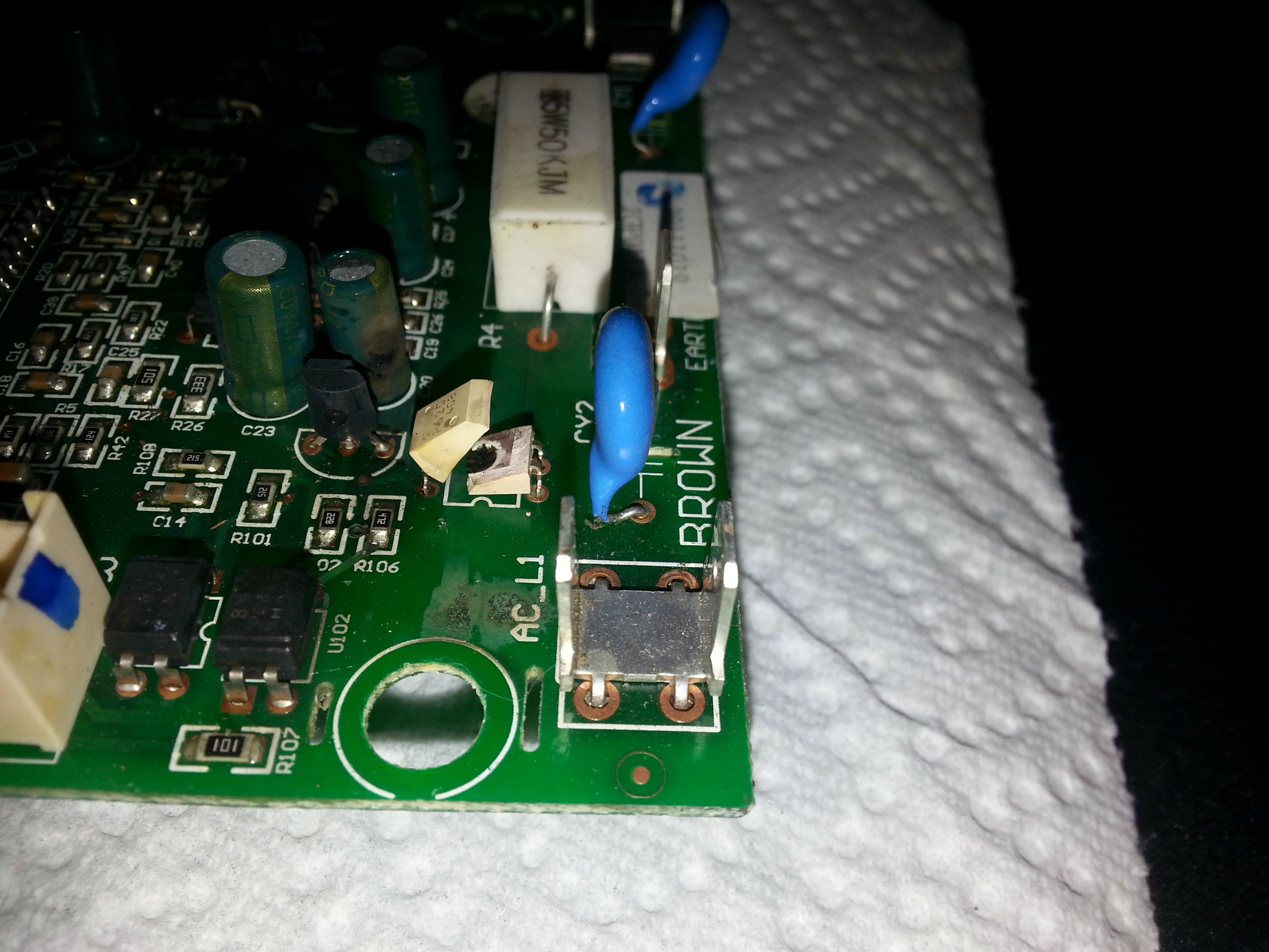

    Hello! I just acquired a new project! It is a Grunair mini split(off brand junk)
    I was hoping that i can get the board repaired.
    So far i have taken photos of and identified two burned parts.
    They are as follows
    https://www.digikey.com/product-deta...23-5-ND/865299
    http://www.digikey.com/product-detai...F%29-ND/871322
    My plan is too replace these two parts as well as test the three large caps on the board. I was wondering if anyone had any advice on whether i should replace anything else? (or how to test them.)
    No burn marks or anything obvious on the other board.
    Here is the manual
    Here are the photos.
    http://imgur.com/yUVnOEx,BY7Powa,TN03yEO,UhN23OB
    there are four images in this link, you can cycle through them at the top.
    Thanks,
    Milkman

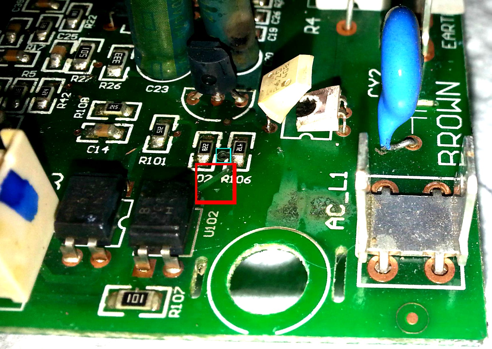

    on photo 1 there is another burnt component to the left of the white square part is a black cylinder with 3 prongs. It is burnt up. Cant identify it.
      Re: Mini split PFC baord repair assistance.
      That 3-leg device can be either Transistor or more likely to Programmable shunt regulator IC such as xx431.
      There should be printing on the flat side of the body.
        i found out it was a transistor(first in circuit Q1)
        I attempted to de-solder it. ended up breaking it!! The face reads br9013 h r07t
          ive got the other components out and the transistors legs without damaging the board. Im going to wait a bit for more input until i make the purchase on new components.
          Im still not sure what transistor to buy, any help is greatly appreciated!!

                    • 31246
                    in that first foto, the track on the smd resistor R106 is missing!!!
                      here is a picture of the rear of that track.
                        • 31246
                        not the blue bit, the red bit!
                          Ah! i see that, perhaps this board is for more than one unit. This model has units that can run 1 2 3 or 4 heads. Perhaps the boards were roughly the same minus some small stuff like that? or bad QA?
                            • 31246
                            looks removed to me!
                              how do i go about repairing it? Would a small electrical fire/explosion tear it off? Thats what happened on the top of the board and by the transistor i removed.

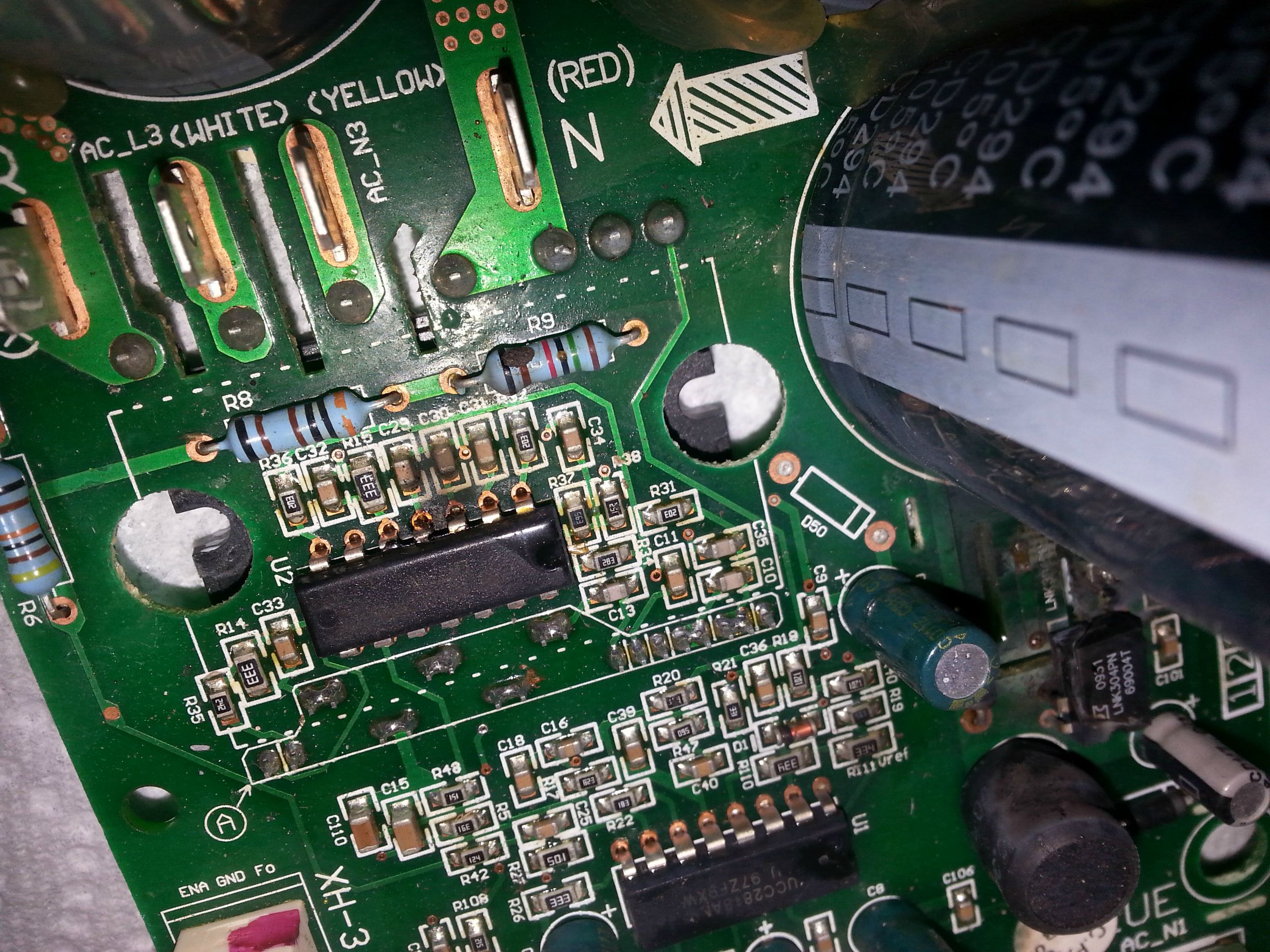

                                • sententia
                                  • Oct 2013
                                  • 269
                                  • Greece
                                  If you check the 2nd photo in badcaps, resistors R20 and R40 look like there is a bit missing on top. Check those as well for correct resistance.
                                  Also above R20 and on R21 label is there a cut on the track or just dirt?
                                    the material on the resistors came off revealing the numbers beneath.
                                    Attempted checking resistance, failed. I assume i have to remove from circuit.
                                    Thank you for your input!!
                                      If you cannot measure any resistance on circuit, then they are definitely open. Usually material breaks due to temperature when they burn..
                                        I haven't removed them yet.
                                        Although, there was a laminate type material over the resister pads. I scrapped them up a little and now can get a in circuit reading on each of them
