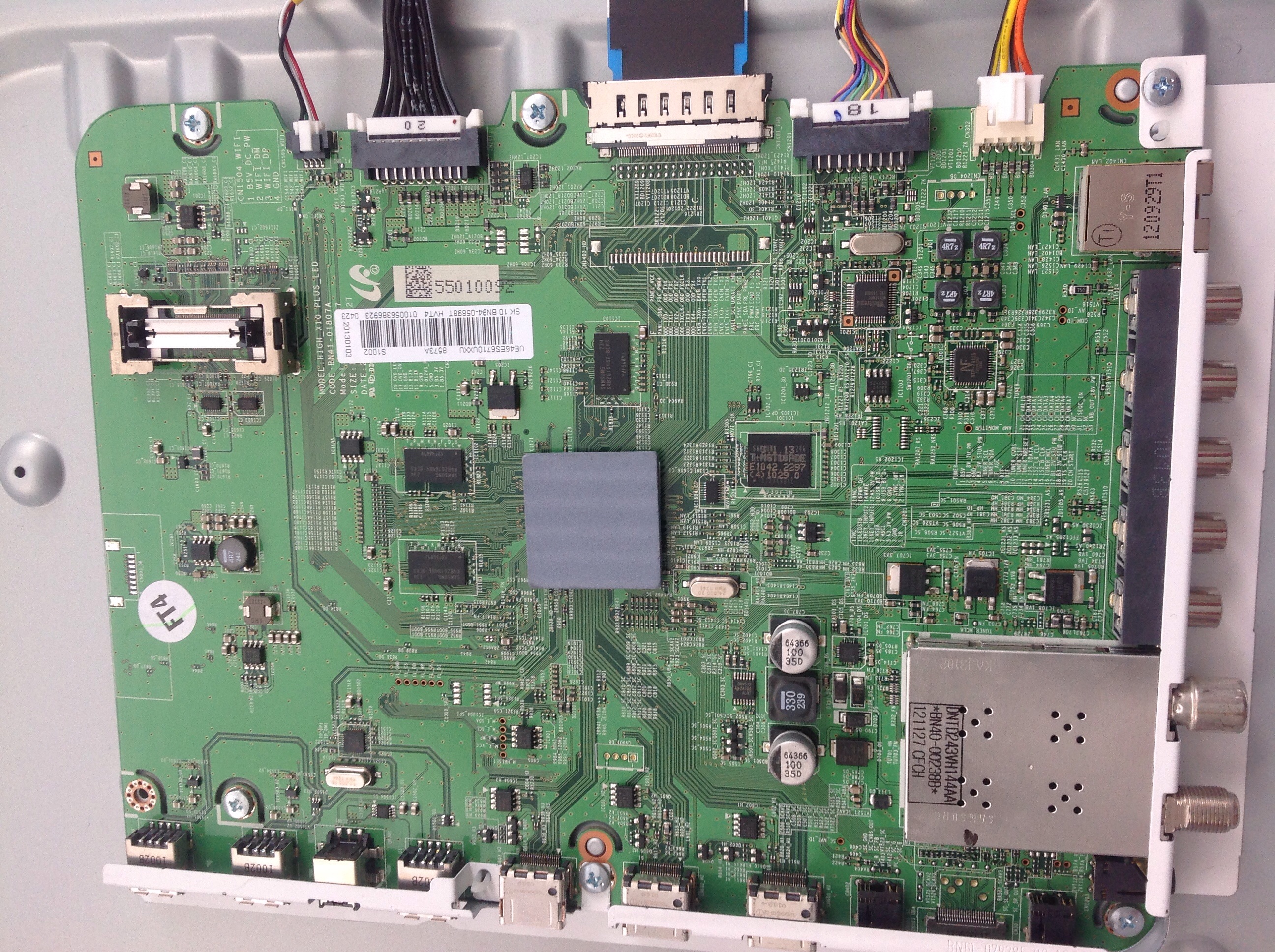

    Added some pics of what I have

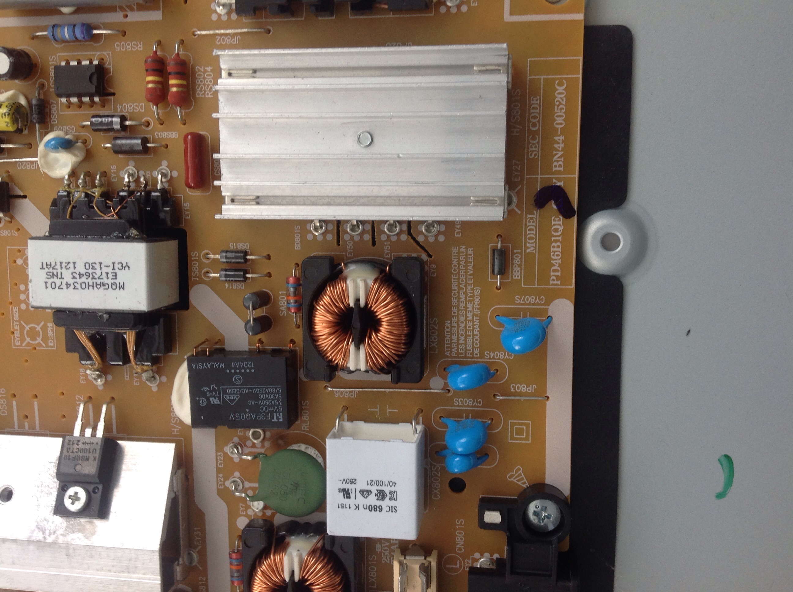

      Re: Samsung lcd 46" pd46b1qe_cdy blowing fuse
      And another

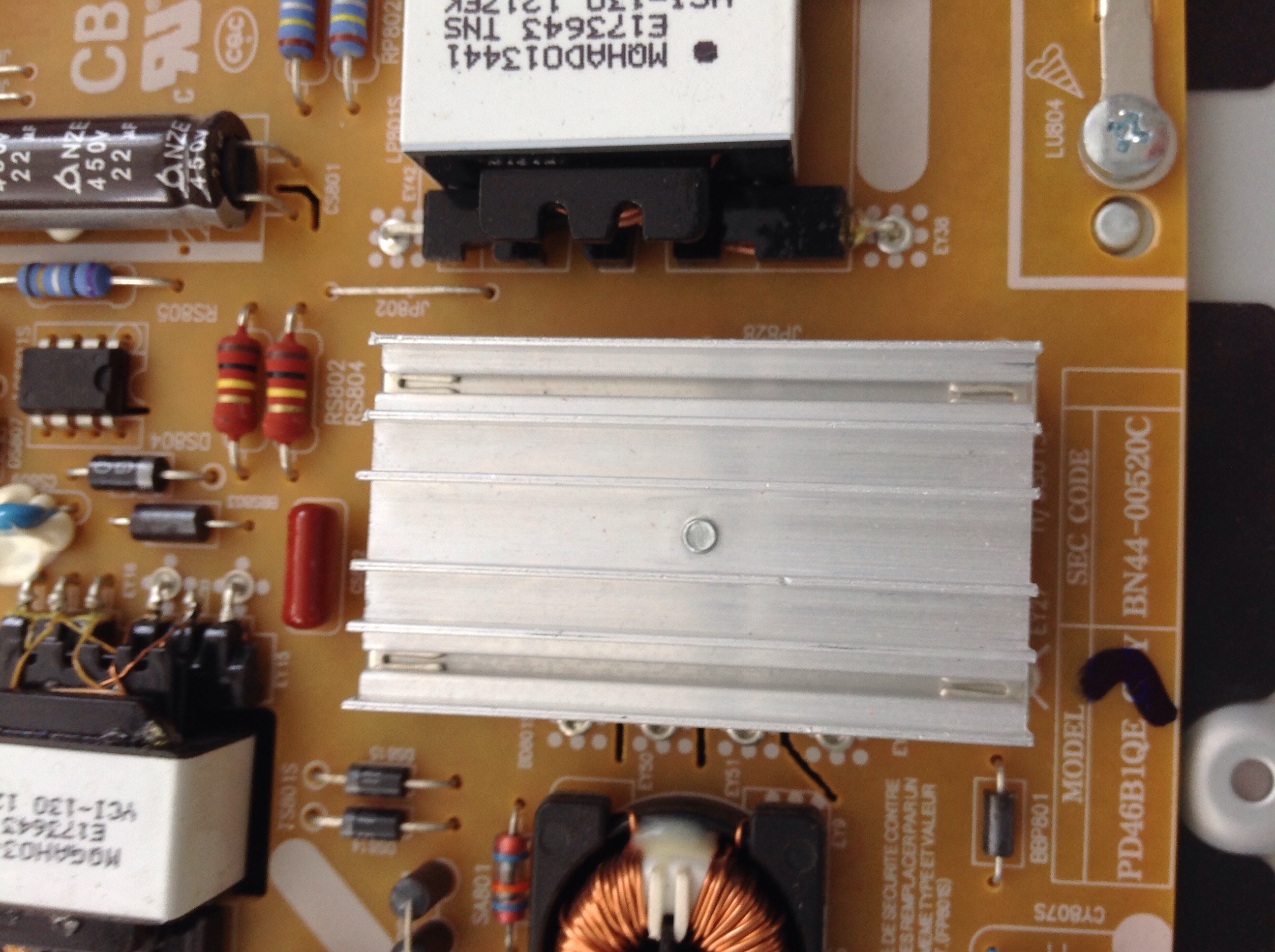

        your "new" board was faulty to begin with.
        the rectifier under the heatsink is probably shorted.
        check for shorts between any of those 4 wires you can see in the foto sticking out from under the heatsink.
        your old board was probably bad startup capacitors.
            Is this the heat sink you mention?
