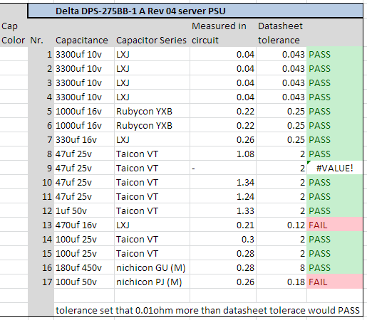

    Hello, I got this nice old server with Delta DPS-275BB-1 A Rev 04 server PSU.
    The PSU was pulled from working Pentium II 350Mhz computer.
    Started to test caps as to keep the PSU for other tasks like mini-itx etc.
    I have the ESR70+ meter. But I'm just new to measuring caps so I'm not sure how to interpret the measurements here.
    Manuals of Atlas ESR70 meter and then Anatek BlueESR, two most respectable (and expensive) meters, you will see that their recommended capacitor ESR values are very different.
    (blue esr 1.6ohms) and (atlas 16ohms) seems like a typo in the manual doesn't it?
    (blue esr 0.6uhms) and (atlas 2ohms) more than 2x difference.
    So what chart is better? Caps are caps and there should be agreement what is considered low enough ESR for a cap to work properly.
    These tables both seems like nonsense then, one of them is wrong.
    If there is no baseline what caps are low enough ESR then what are we measuring again?

    Re: Delta DPS-275BB-1 A Rev 04 server PSU
    the tables on the testers are bullshit.
    caps are very wide ranging depending on series.
    you need to look at the datasheet for the cap your testing.
    http://www.paullinebarger.net/DS/

      Thank you for the link!
      I cant find Rubycon YXB series there, any other links I should know about?
        Datasheet for YXB attached.

          Thank you very much, I will post a list of what I measure shortly.
          The measurements will be in-circuit, I wonder if thats correct way to do it as I read various things, and some caps really change ESR value (increase) if measured unsoldered. I do keep them for 5 minutes to cool down after I remove them.
          Like I said I would like to hear you ideas about this
            Here is my cap test results:
            Will unsolder caps 9,13,17 to re-check them later.
            Your knowledge are they bad is welcome.
              they must be room temperature, the temp directly effects the esr readings.
              also, you cant always get an acurate reading on the board because of other parts connected to the cap.
              specially in a psu where you will have several caps in parallel.
                Thank you for reply.
                Yes the cap in the table above is measured in room temperature.
                I will re-measure suspect caps when I unsolder them.
