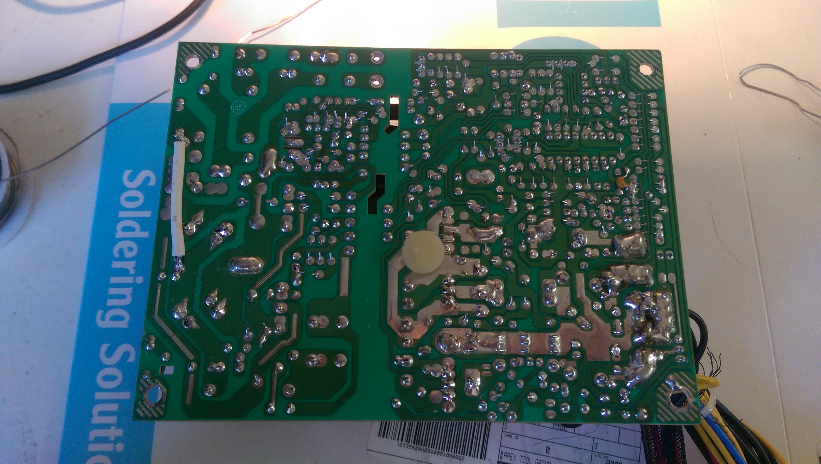

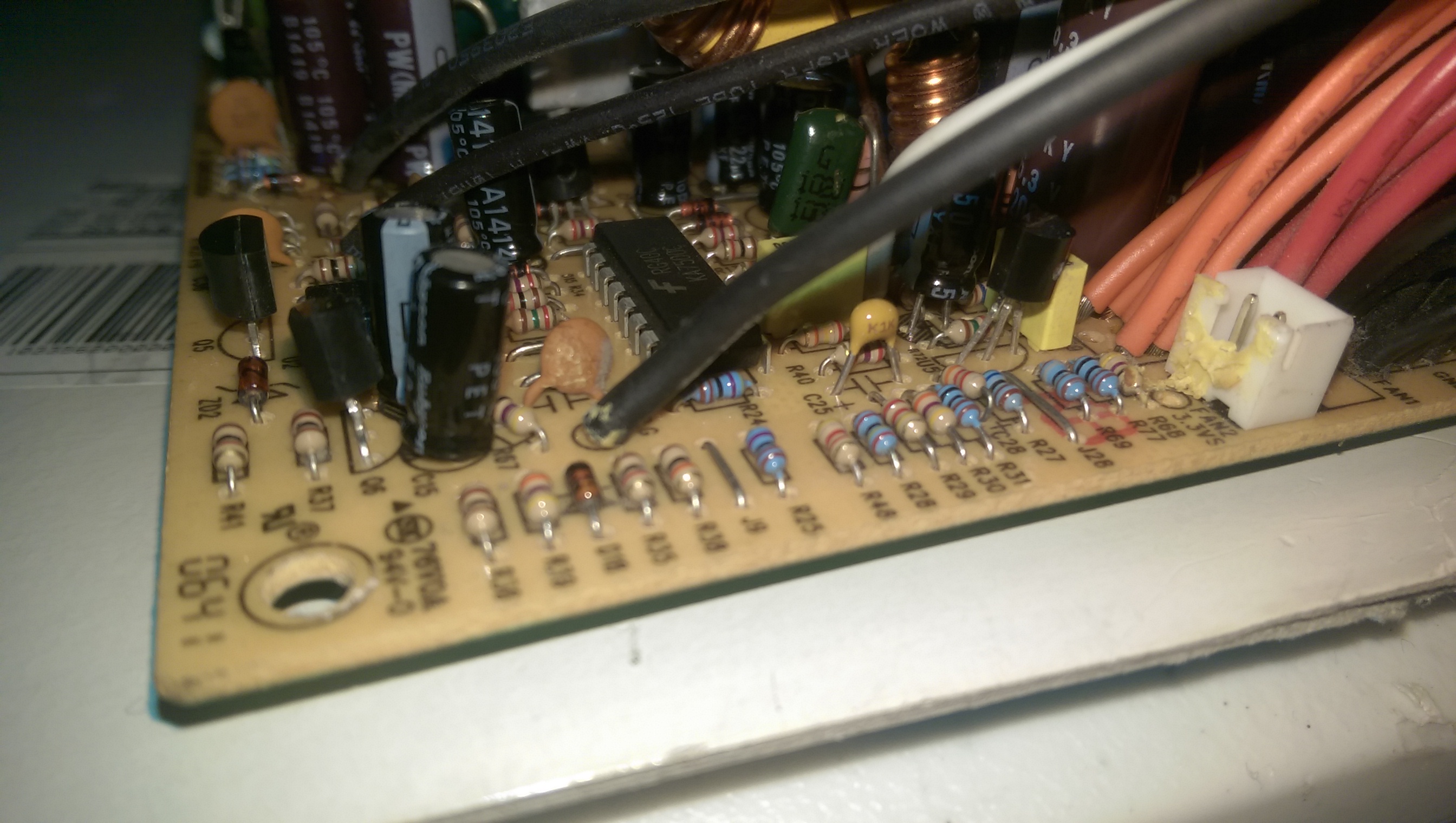

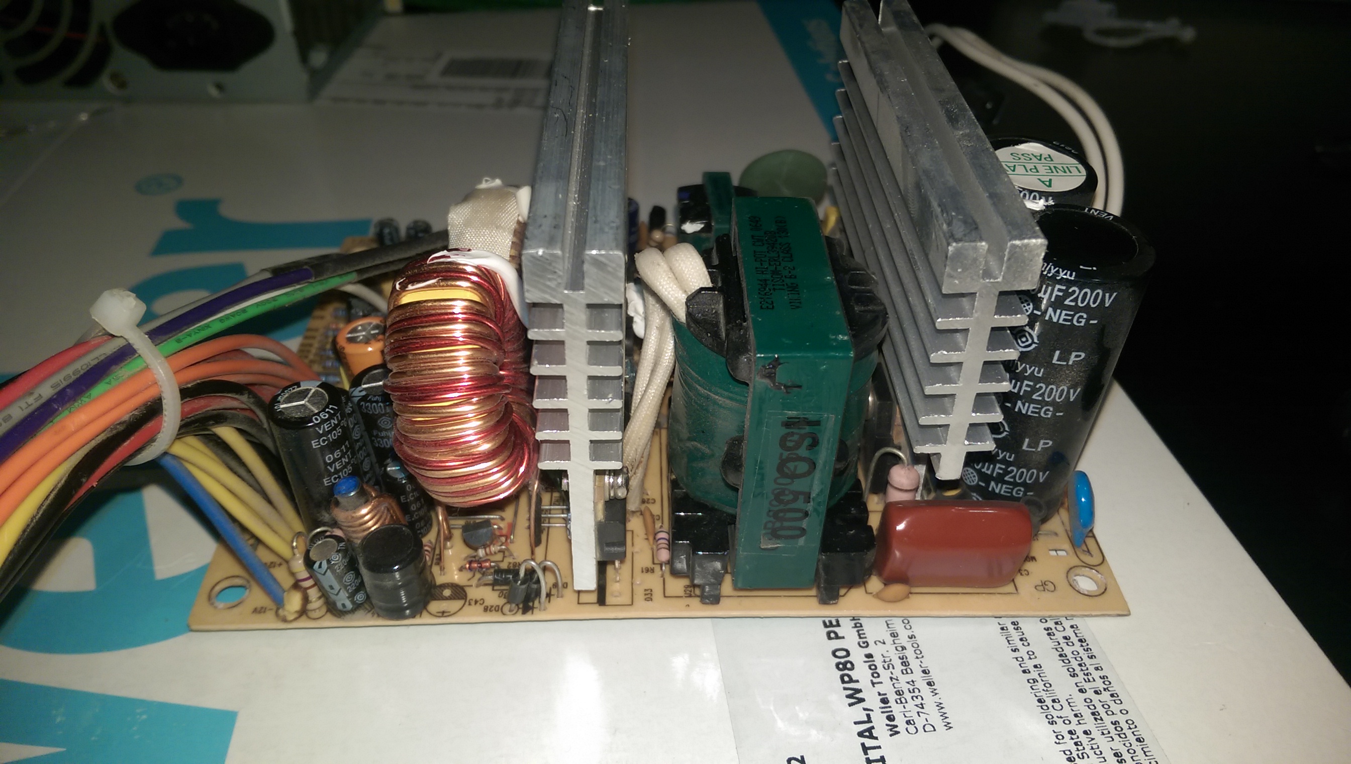

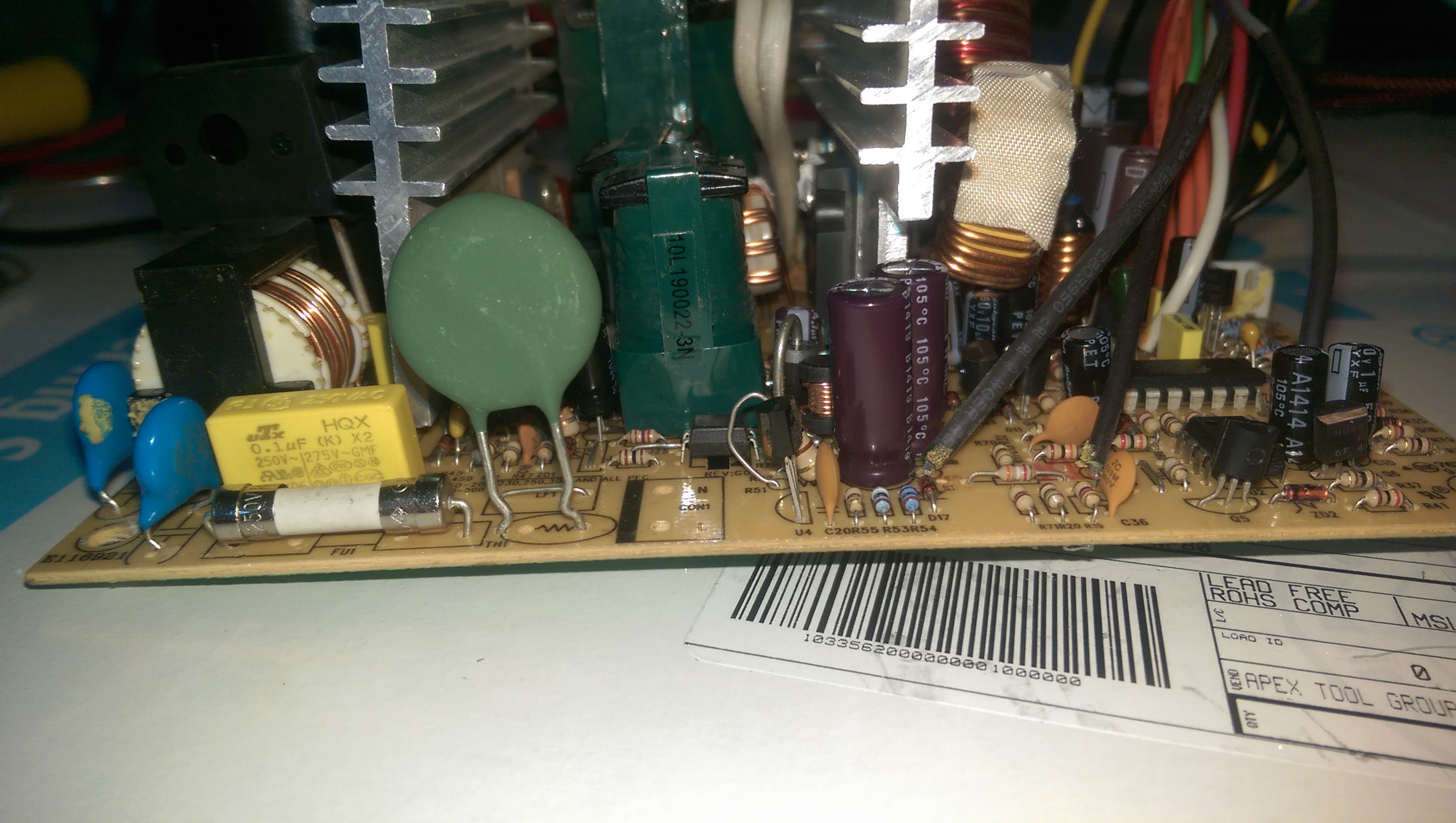

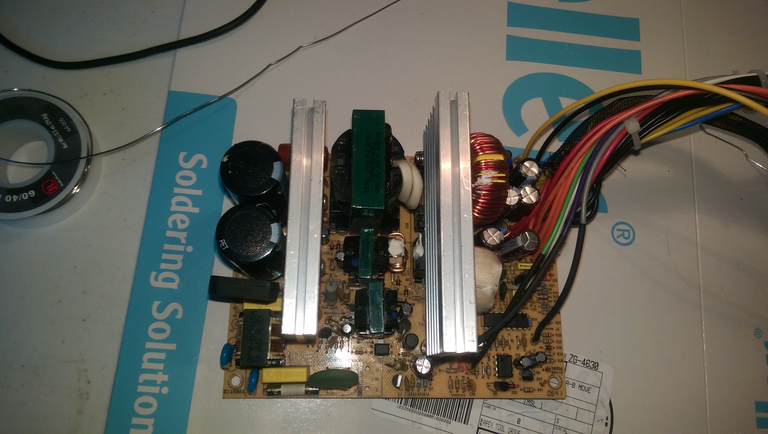

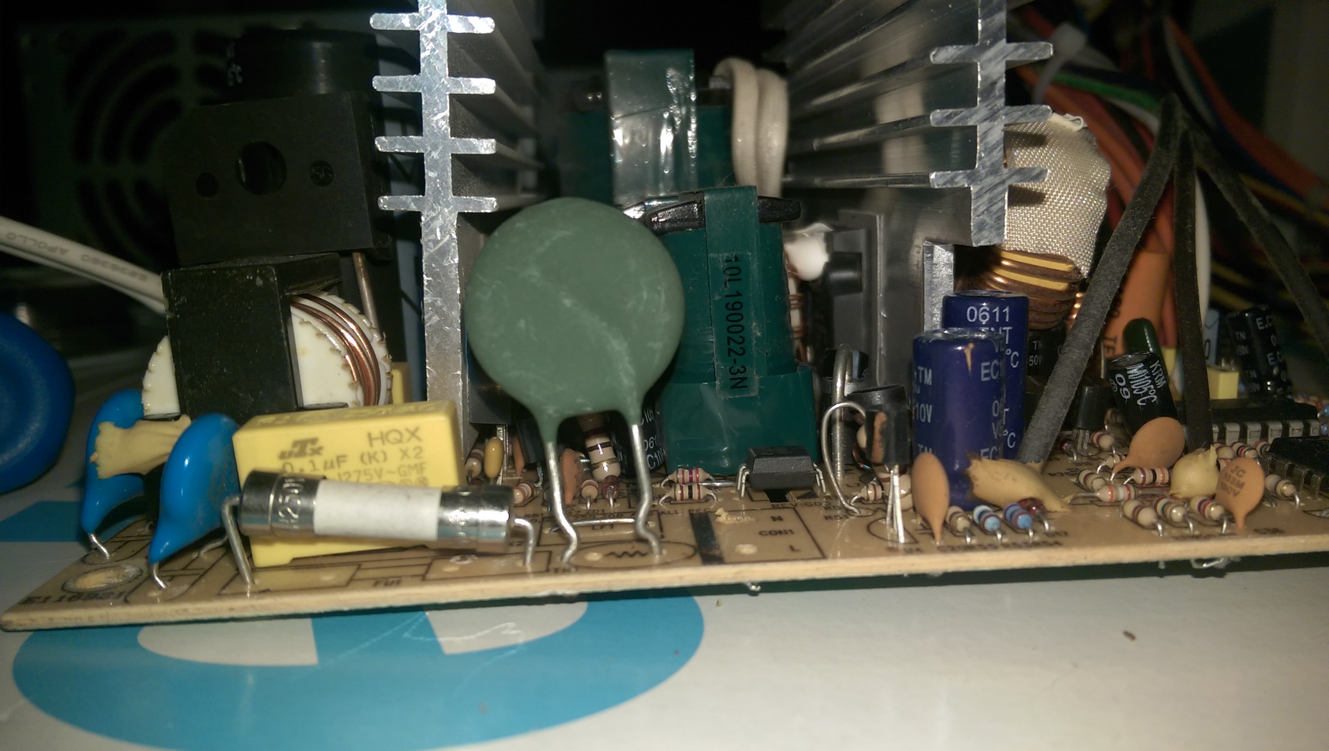

    Classic CWT ISO series. Manufactured December, 2006. This one is pretty nice. I figured it was worth upgrading since it has a 39 transformer and decent heatsinks. And it's actually got a thermistor for the fan. Most just run at full speed all the time.
    All the caps consist of Fuhjyyu, Koshin, and two Teapo SEK. The only caps that tested bad were the Fuhjjyu TM on the 5VSB, and a 1uF 50V Koshin cap

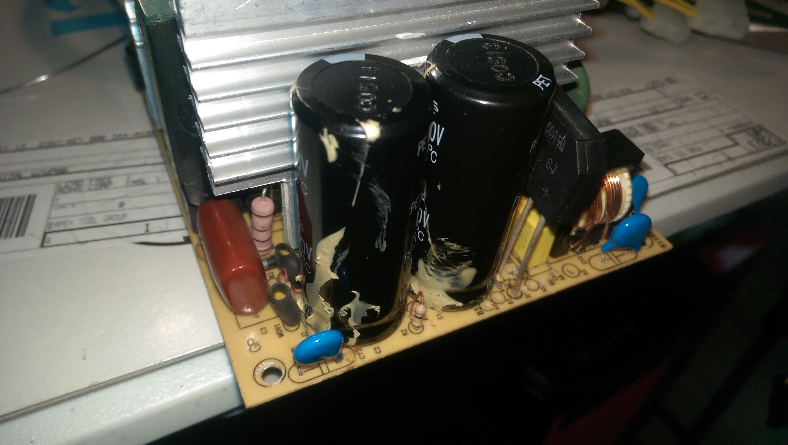

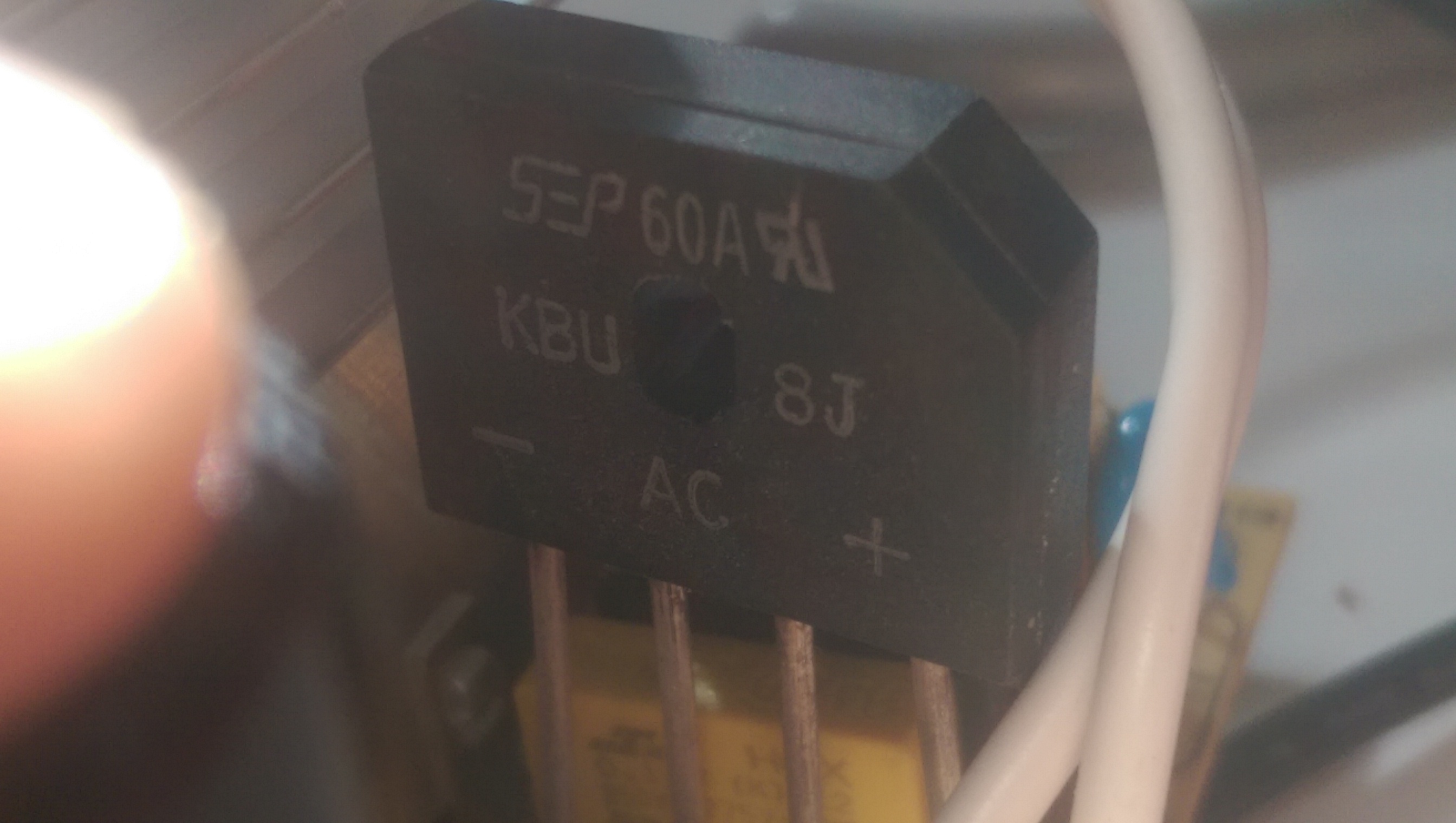

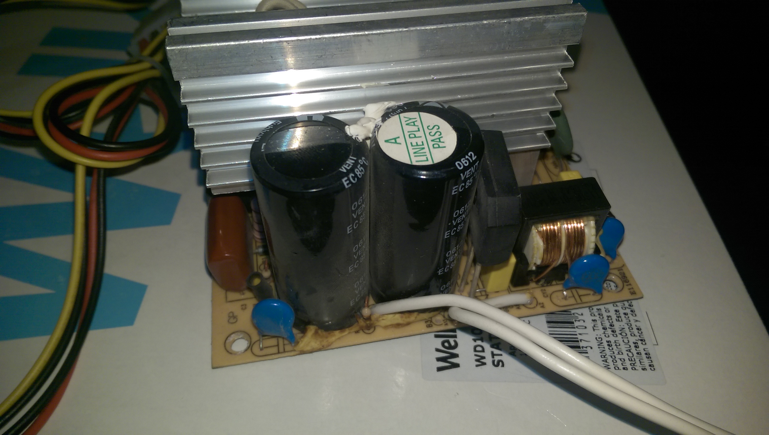

    Original input caps were 820uF Fuhjyyu. The bridge rectifier was physically touching one of them! Oddly, the one being touched read 822uF, and the other one read 727uF. Nice that they installed MOVs. Switchers are 2SC2625 rated at 15A. Nice. NTC is SCK-058.

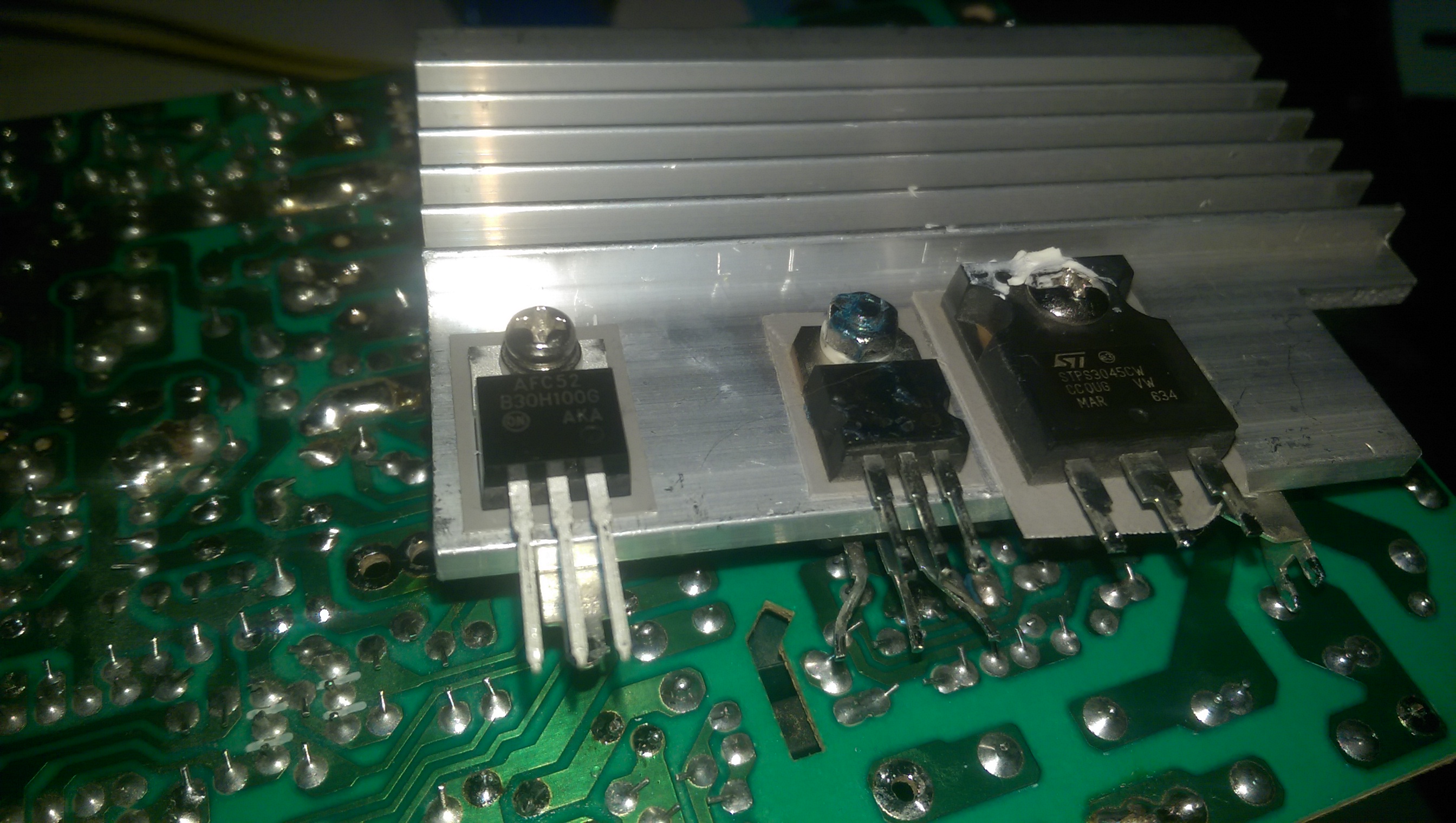

    For the rectifiers, it used a 30A schottky for 3.3V, two 20A schottkys in parallel for the 5V (I prefer this over a single 30A) and a 16A ultra fast on the 12V.

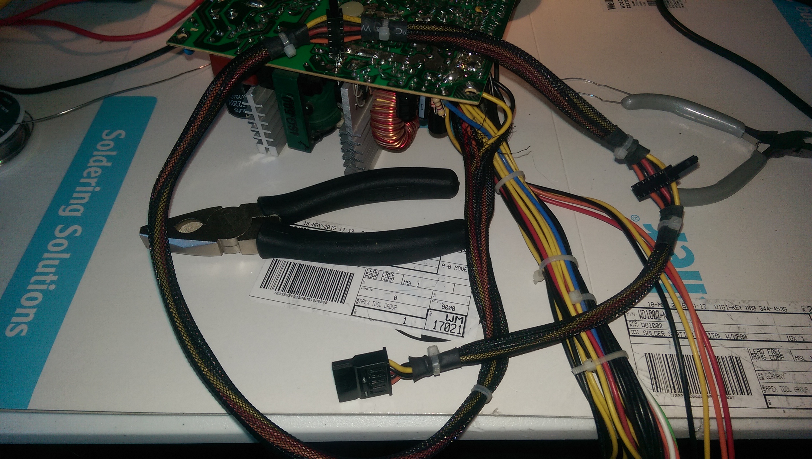

    The worst thing about it was the cables. 20 pin motherboard, 4 pin CPU, 6 molex, 2 berg.

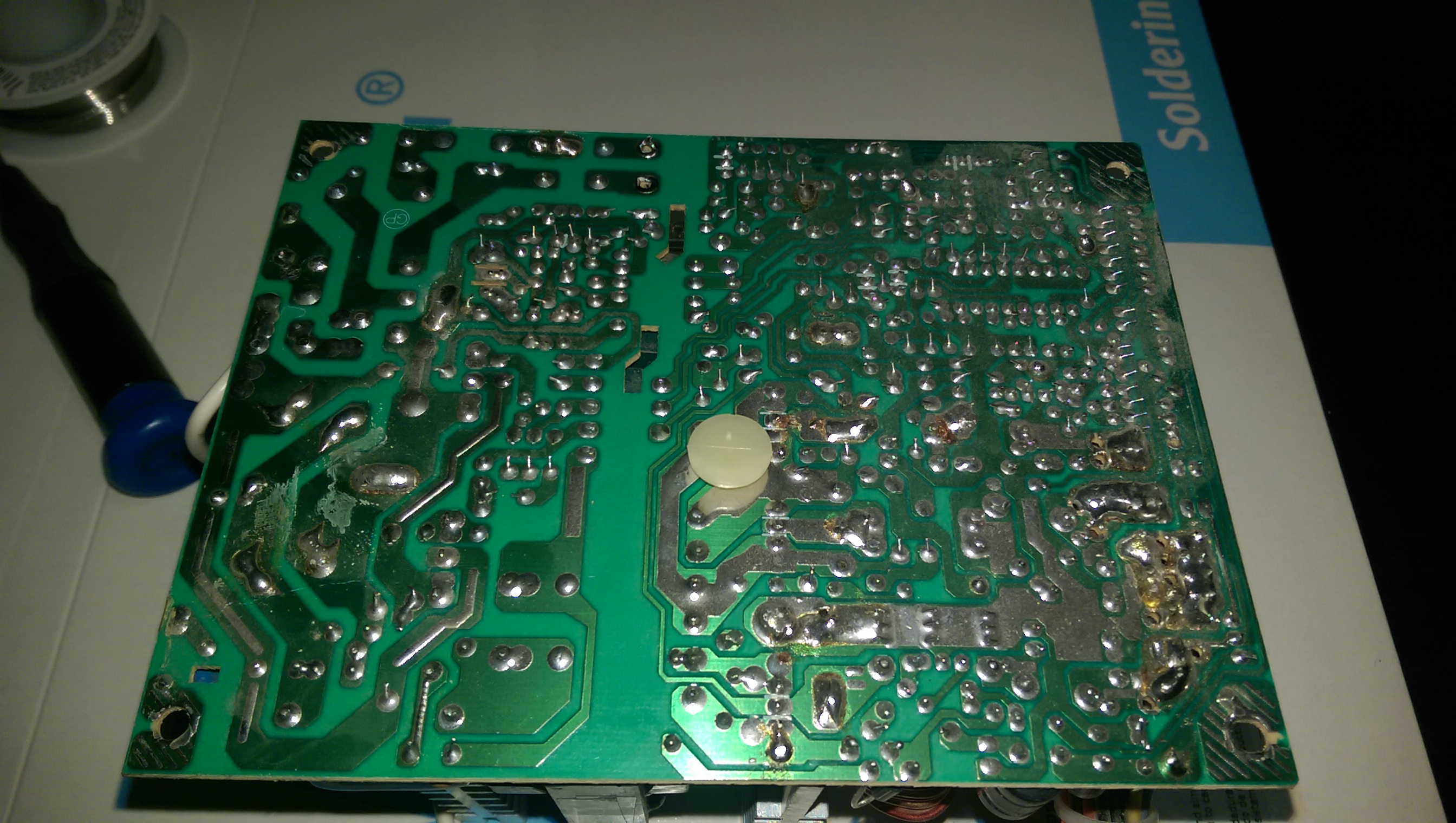

    This is how it looked before I got my hands on it.

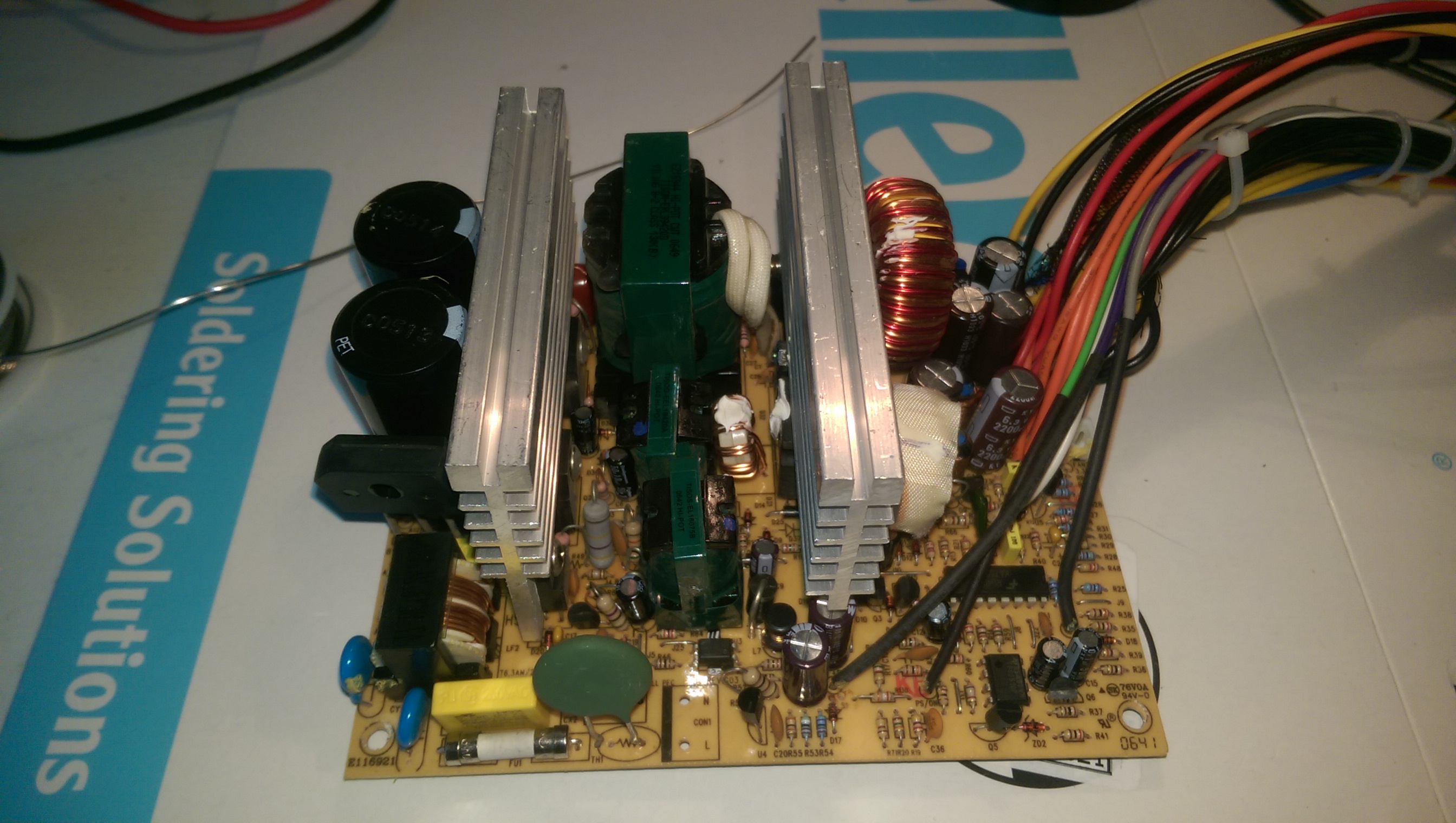

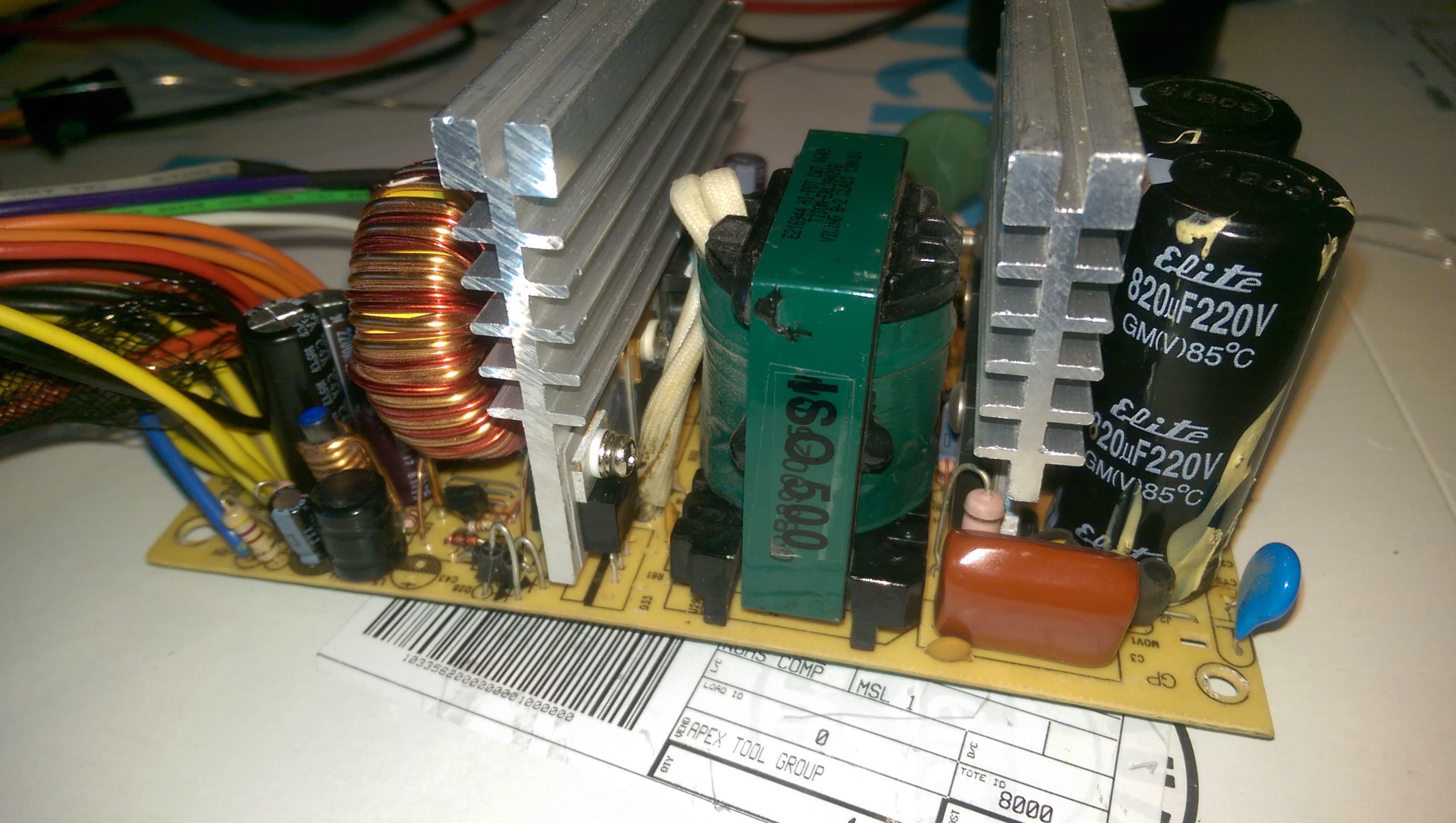

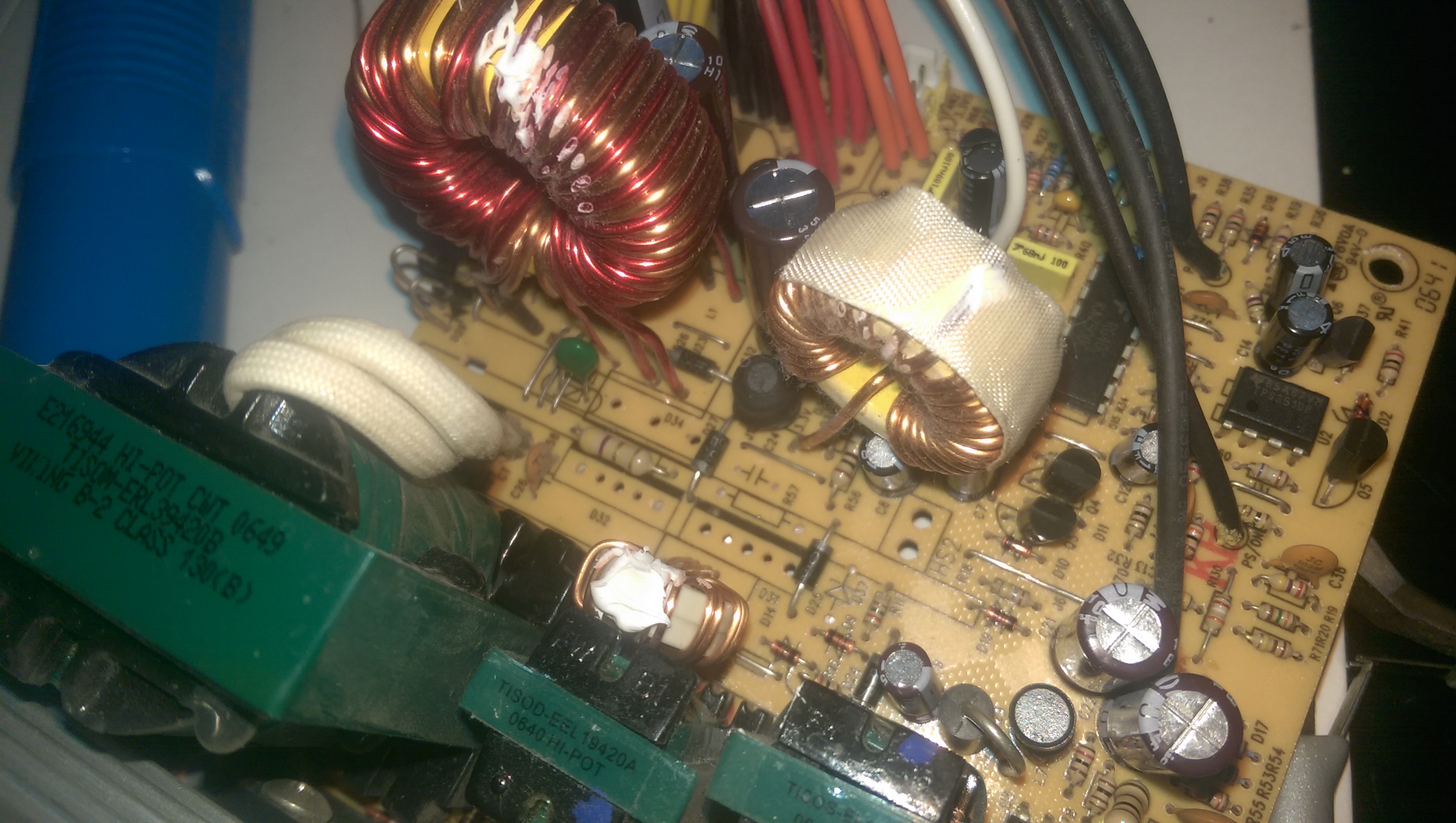

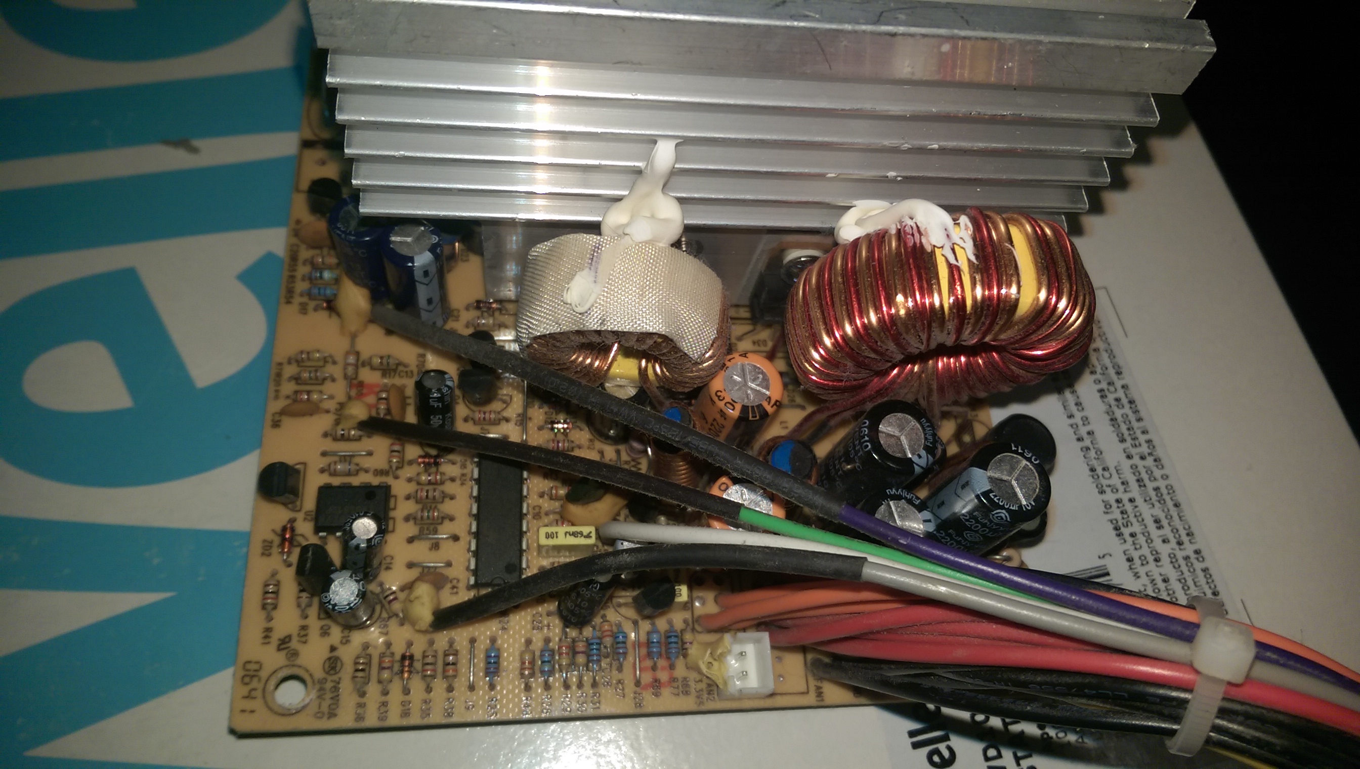

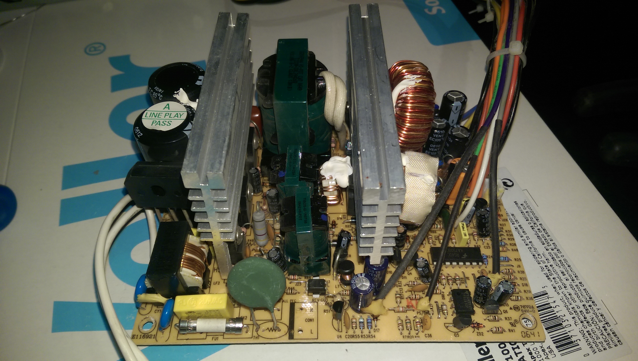

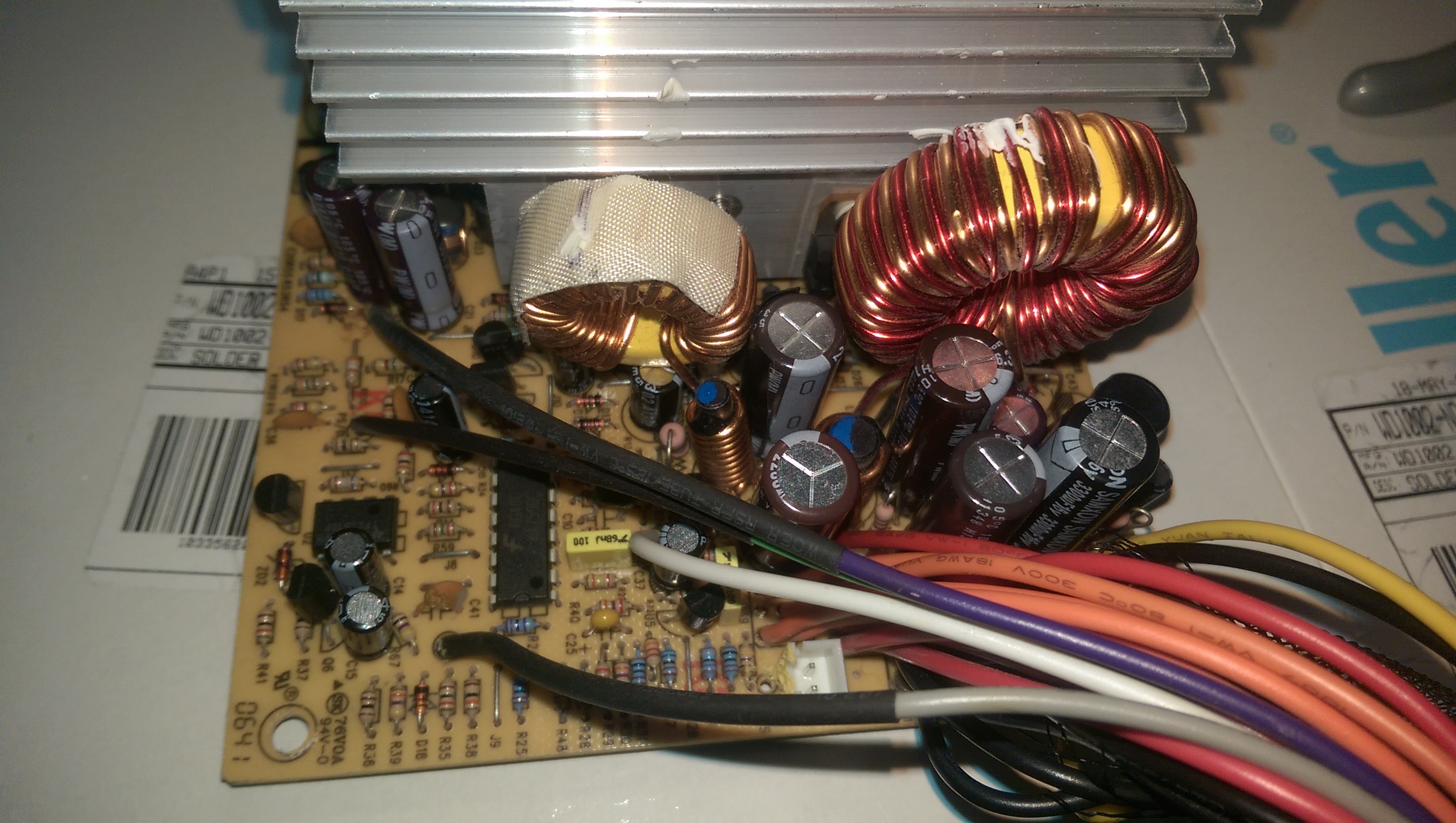

    And now for the mods! First of all, I removed a lot of the glue. It had mostly that nasty tan stuff. I did a pretty good job removing just about all of it. I bent the bridge rectifier away from the input caps. Replaced the original input caps with 820uF 220V Elite caps pulled from a LiteON. They read 822uF and 818uF. Pretty impressive for 7 year old caps. As you can see I made it permanently 120V. The voltage selector switch was short so it was putting stress on some input components. I used that wire then on the bottom since it was 18AWG and well insulated.

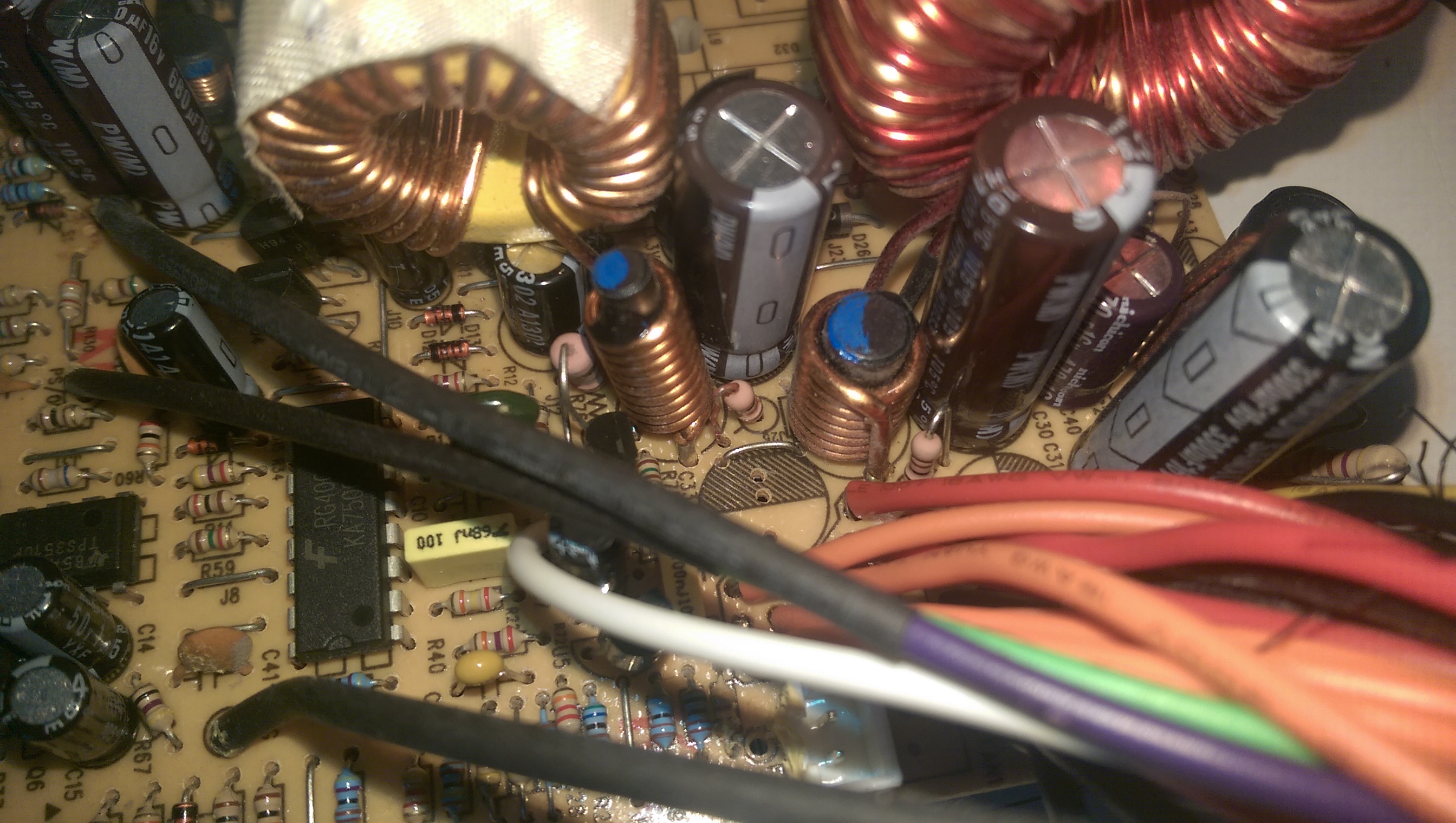

    Naturally, I replaced all the electrolytic caps. I did something a little different for one though. C25 on the secondary was a 0.22uF 50V Fuhjyyu TN cap. The board was originally silkscreened for a ceramic cap there. I don't have 0.22uF 50V caps so I put a 0.1uF 100V ceramic cap on the top of the board, and then one on the solder side, since they both wouldn't fit through the top. This makes me feel better, since I never want any Fuhjyyu in my equipment.
    All of the rails have a PI coil, including the -5V and -12V.

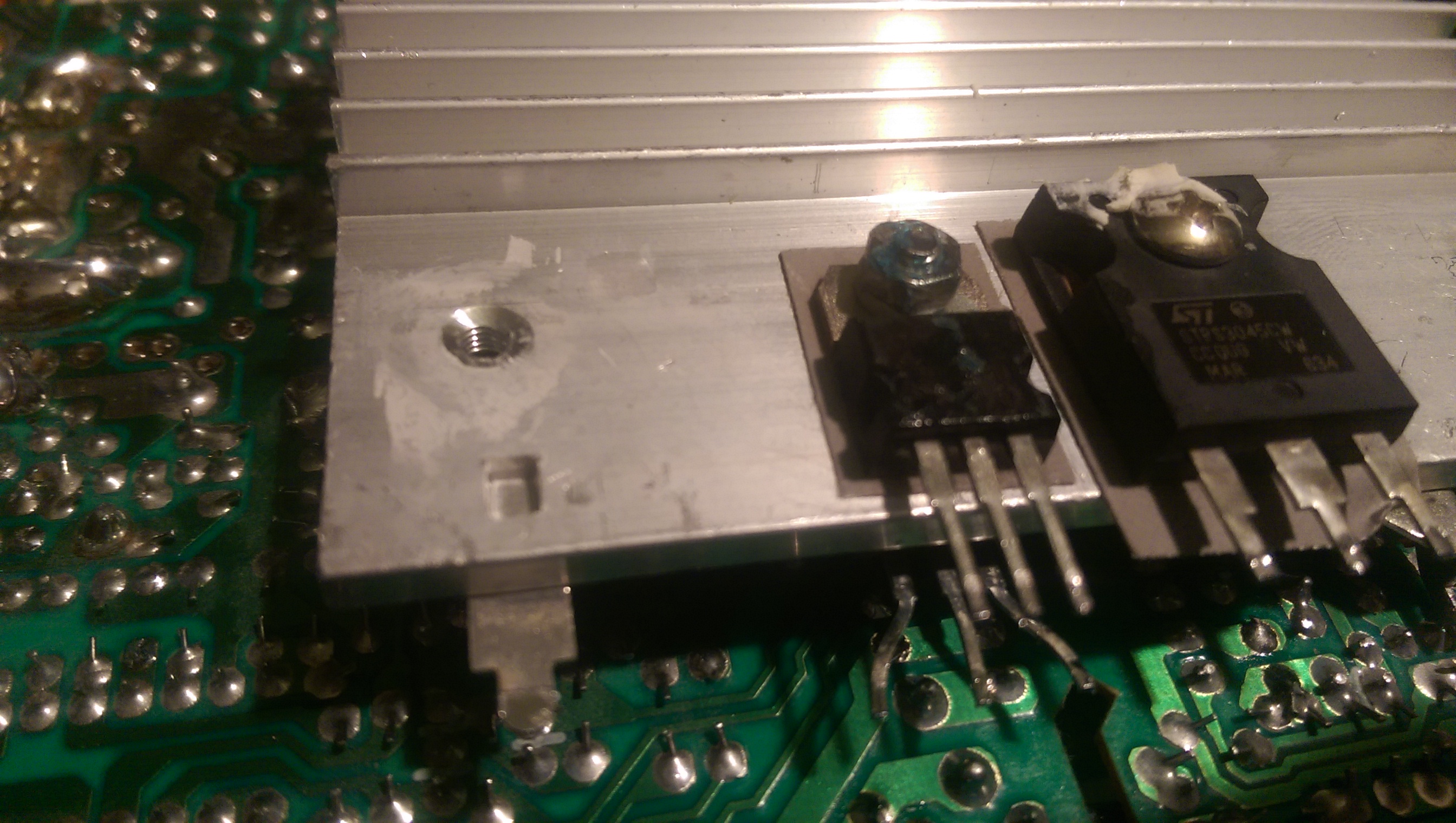

    I then replace the 16A ultra fast on the 12V with a 30A schottky. I didn't like that there was that dent in the heatsink right where the rectifier goes, but it should make enough contact with the heatsink. If there was a second slot for a 12V rectifier I would have added another one in parallel. 30A should be enough though. The 12V had a 250Ω minimum load resistor, I decided to leave it alone. The 5VSB had 100Ω, 3.3V had 15Ω, and 5V had 50Ω. I didn't have as good of a selection as I thought, so I ended up leaving the 5VSB one alone, and put 100Ω on both the 3.3V and 5V. Better than they were at least.

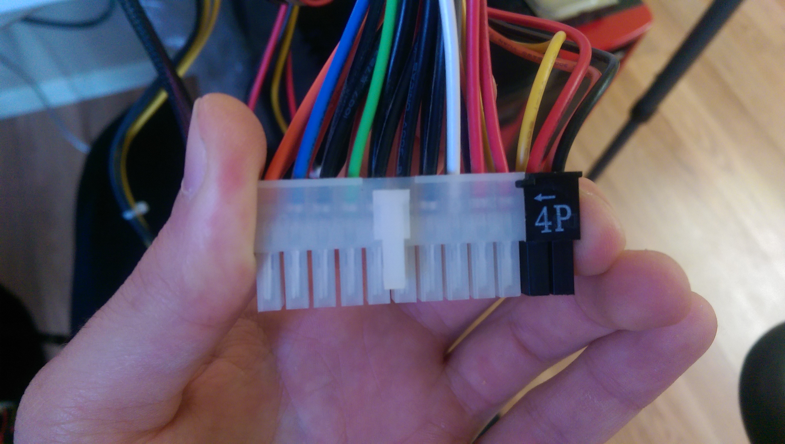

    Since there was plenty of room, I added a salvaged 4 pin from another PSU to make this ones motherboard connector a detachable 20 + 4 pin connector. I also added a sleeved 3 SATA port power cable.
    I also did some basic things such as making the fuse flush to the board, fixing some of the poorly done solder joints, and removing flux. I'm also going to cut out the punch grille and add a wired one + oil the Top Motor fan. It looks pretty good now, and ready for many years of service.

        Re: ISO-500 Rebuild
        Me too... I have worked on 2 Thermaltake TR2-420 psus and now I am on the third that is blown. Than glue is a pain to remove...
        Nice!!
        I do those things too!
        I also add a second -12V cap since there is an empty spot on pcb.
        There are also 2 spots for 12V filtering caps, 1x3300uF and 1x100uF(!).
        I replace the 100uF with 1000uF 16V entry level esr withjout any oscillation problems.
        Congrats! This psu is perfect now! Please put it in a 12V demanding PC and tell us how it does with voltage regulation.

          Works great in this PSU. Original Fuhjyyu cap only had ~950mA ripple current capability, that's way too low! I bought 130 from you, and I think I have about 10 left. If I keep up this pace I will be buying some of those Chemi-Con caps from you.
          Yeah, it's such a pain! I recently saw one killed by glue as well, it was worst on the secondary by the supervisory IC resistors/zeners.

          Yeah, it makes the PSU so much better adding modern cables to them! I left the -12V alone on mine since it has a coil and a 220uF cap. The original second filtering cap for the 12V was Fuhjyyu 330uF 16V TN. I replaced it with a 8x15mm 470uF 16V. It has about 3 times the ripple current capability. I will load it up with a Pentium 4 machine and tell you how it does
            I doubt the bridge rectifier ran that hot to matter. And even if it did, I'd still take them over crappy MK that read HALF (!) of their 330 uF capacitance
            ... two 20A schottkys in parallel for the 5V (I prefer this over a single 30A)
            Why is that?
            I guess yours is the "delux" version, so you get 2 extra molex connectors over my TurboLink. Everything else is the same, though .
            SATA connector? Who needs THOSE?
              But still, I don't like the idea of a Fuhjyyu cap being used as a "heatsink"

              Why is that?
              Even at low loads, wouldn't splitting the load between the two 20A schottky packs create higher efficiency than a single 30A schottky?
                    Not always. It depends on the device and manufacturer. Probably best to look at the datasheet and see the Forward Voltage vs. Forward Current graphs and compare them for a certain Current value that interests you.
                    Let's say the 12V rail is to handle 20A nominal. So you have the choice of either two 20A schottky diodes or a single 30A diode. If you choose the first option, then there will be (theoretically) 10A going through each rectifier. If you choose 30A rectifier, the 20A will be going all through it. So you go in the datasheets for these rectifiers and you look up the voltage drops at their respective currents (i.e. 10A for the 20A rectifier and 20A for the 30A rectifier.).
                    Let's say the 20A rectifier has 0.5V Vf at 10A and the 30A rectifier has 0.6V Vf/ Then the two 20A rectifiers will be dissipating 0.5V x 10A x two = 10W. And the 30A rectifier will be dissipating 0.6V x 20A x one = 12W. In that case, the 30A part will make the PSU less efficient.
                    But that is assuming the load is equally split between the two 20A rectifiers. And to have that, you need to have very good thermal coupling between the two rectifiers. Any small difference in temperature between the two will make the hotter rectifier Vf drop more, thus making it conduct more current... which in turn will heat it up more and make it conduct even more current.
