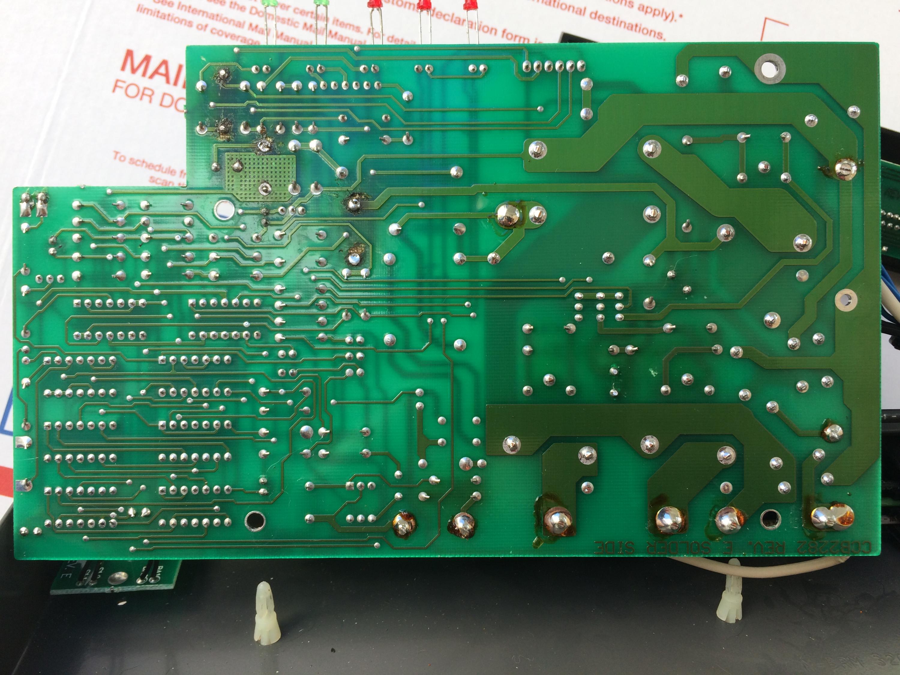

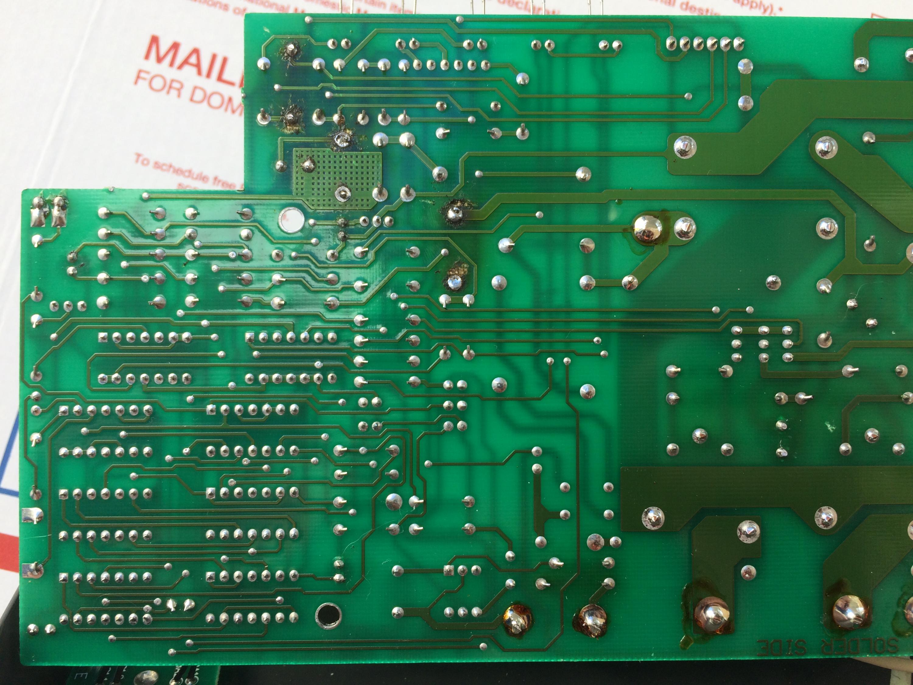

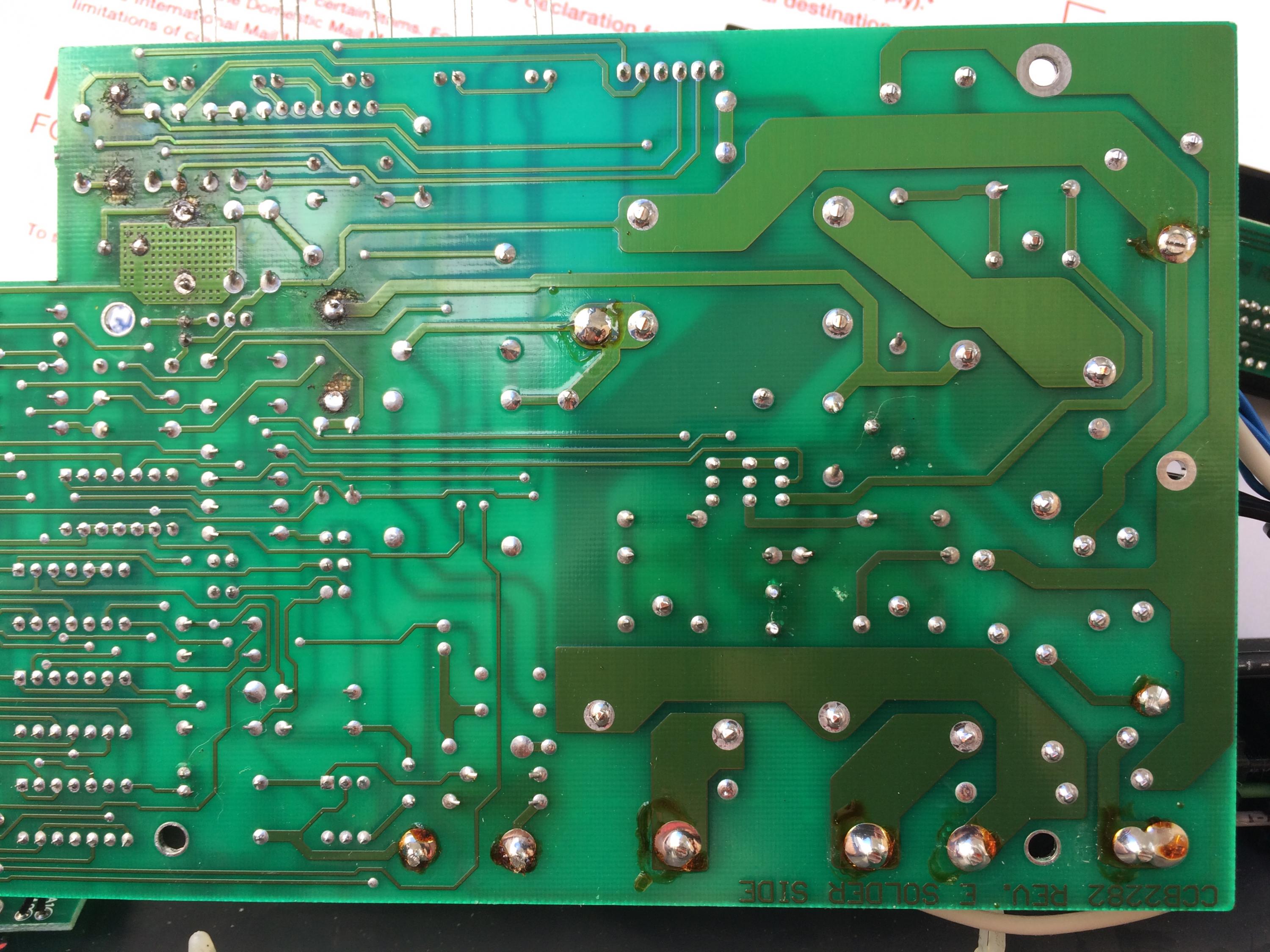

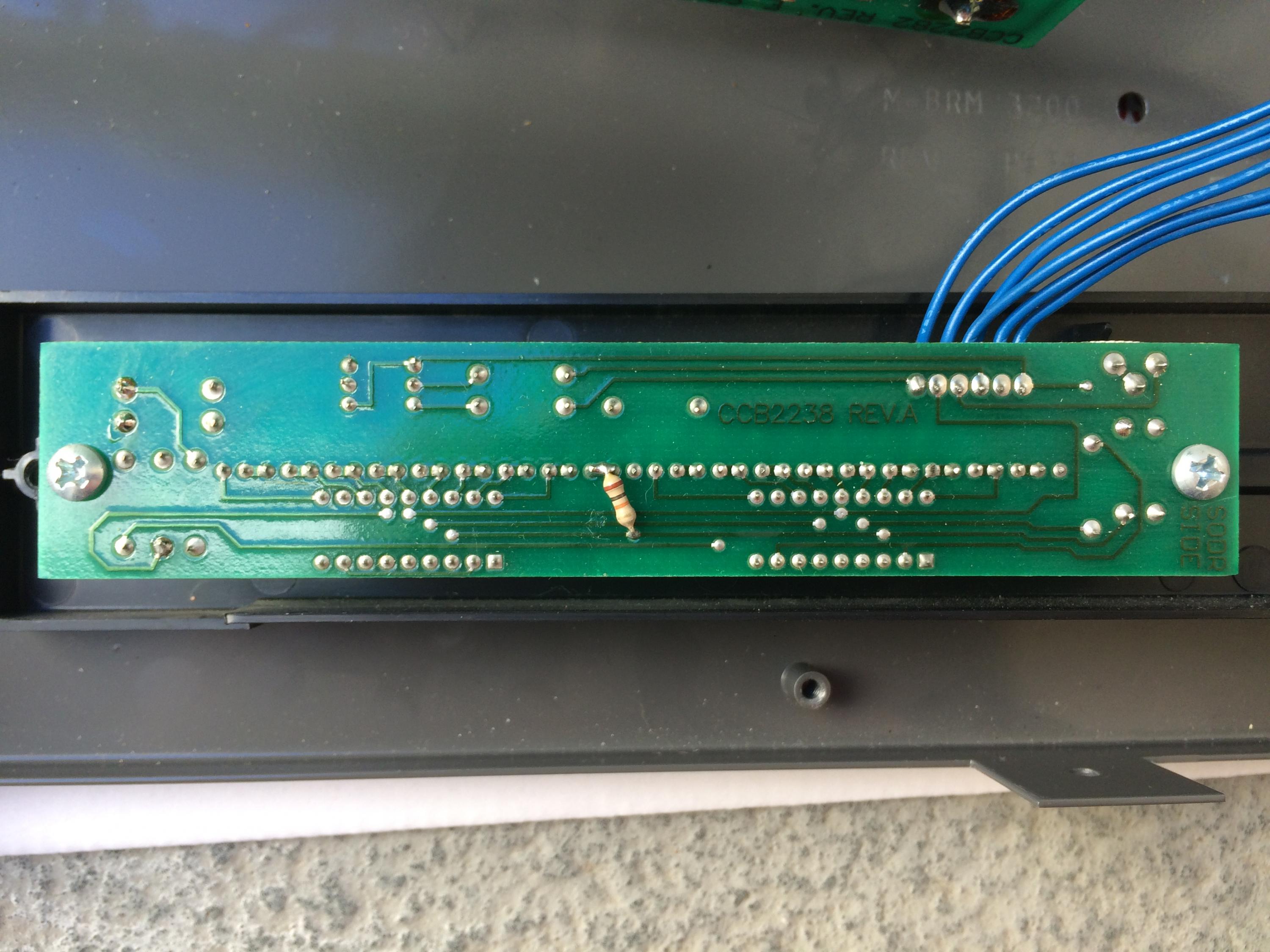

          • dchang0
            • Jun 2014
            • 33
            Re: Replacement cap advice needed for Panamax Max 1000+ Surge Protector/Line Conditio
            Follow up with photos of the bottom of the PCB.
            Hope this helps someone.
            I'll be testing the transistors and diodes near ZD1 and will probably just replace them all since they're low-cost.
