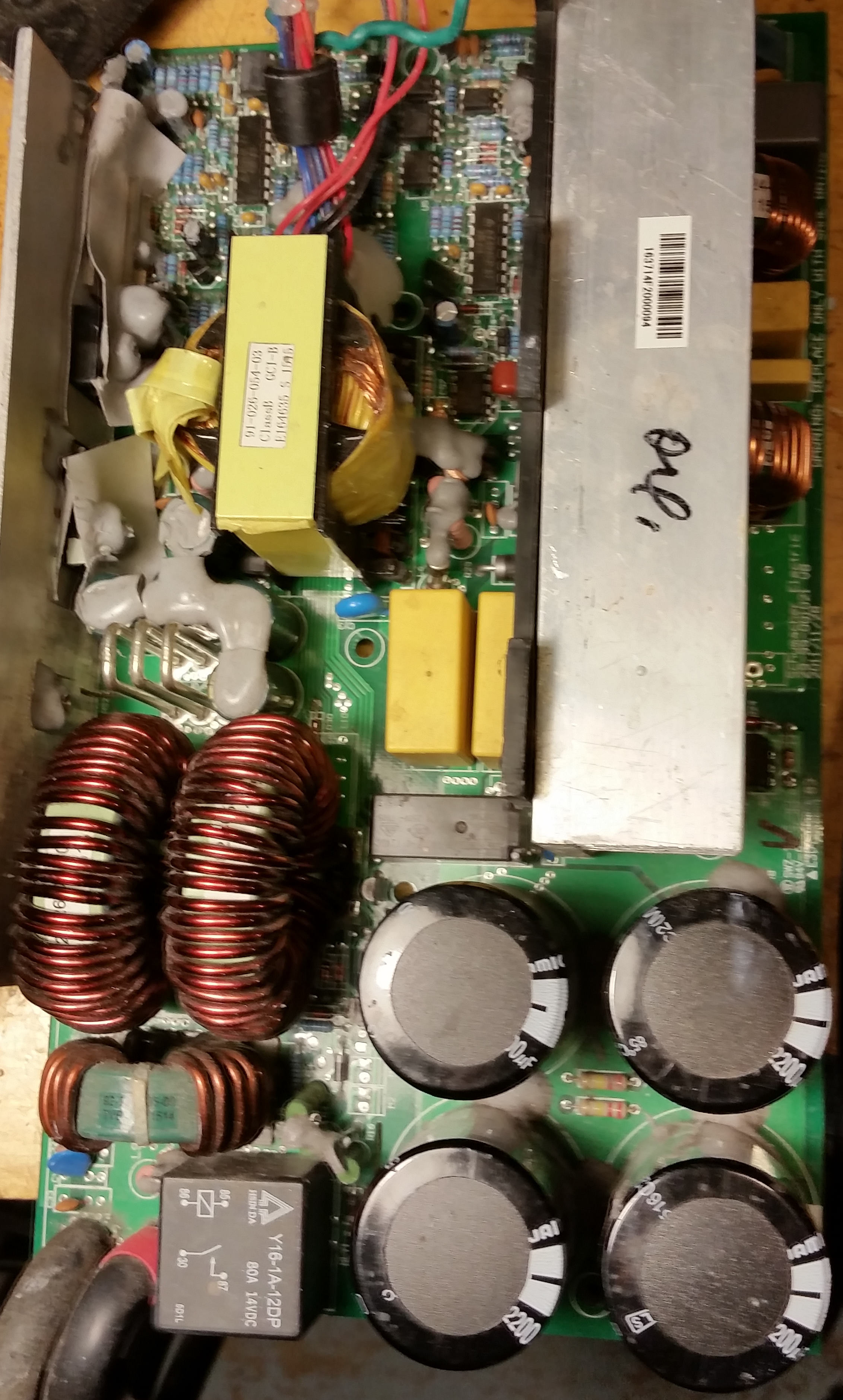

    Have this car charger, not working, not sure what is wrong with it. Display is not coming up.
    I have poked around the board, have not found any glaring defects.
    • Jul 2011
    • 6040
    Please post pictures of all of the boards front and back of the boards

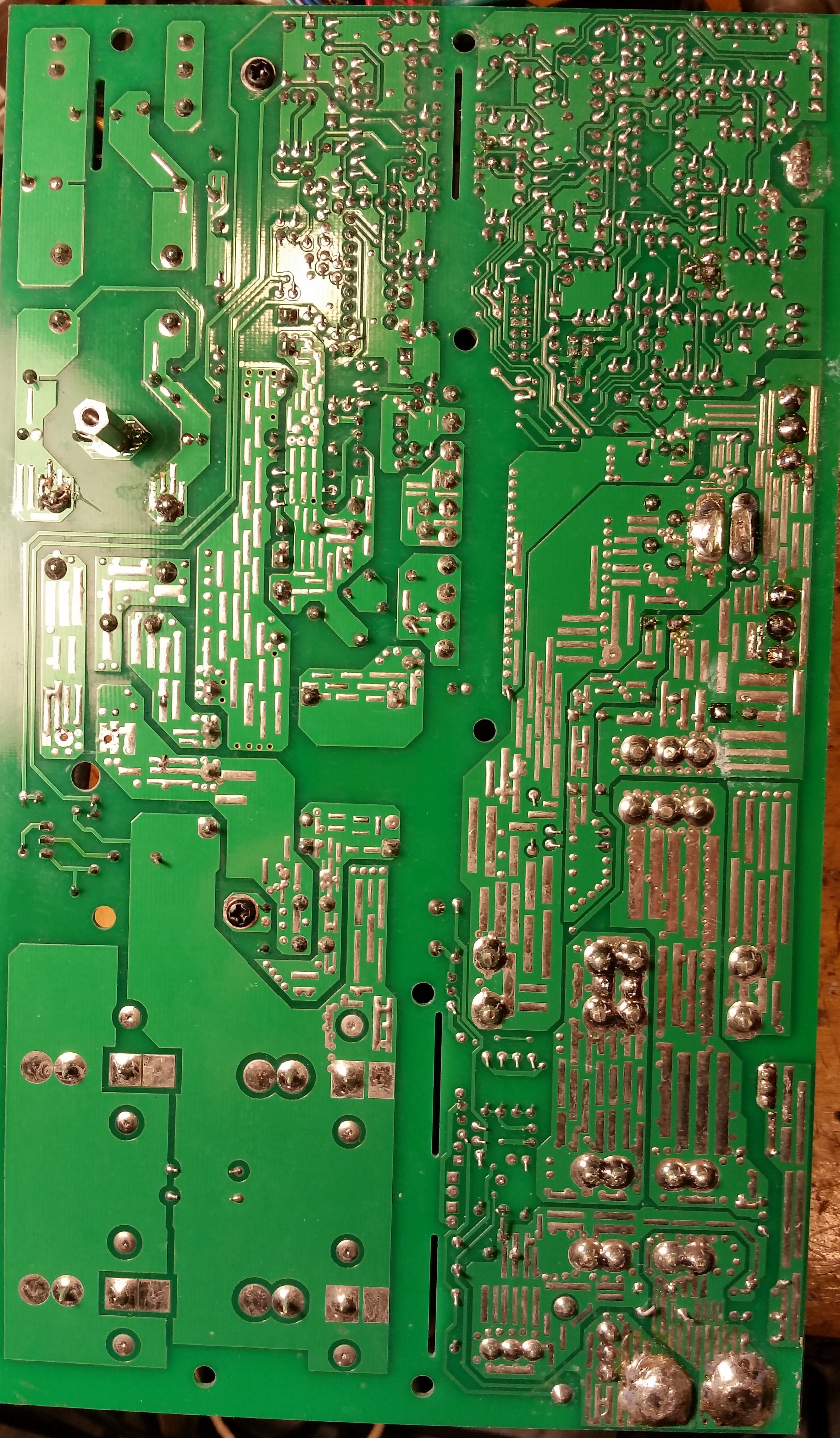

      Attached are pics of the front and back of circuit board.

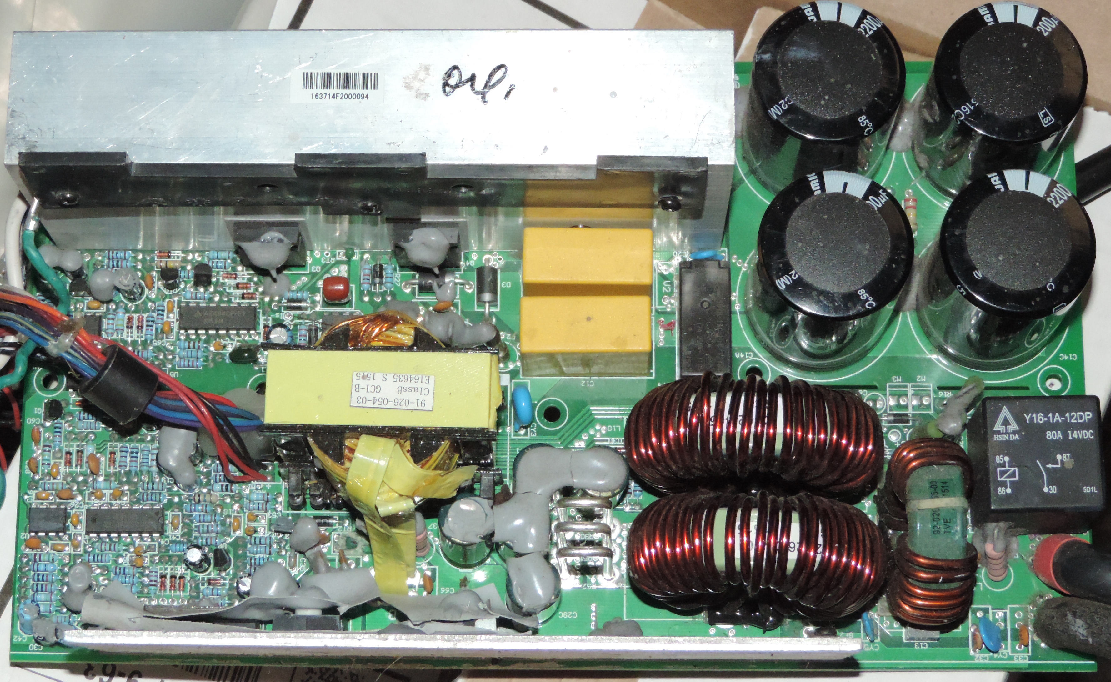

          Here is a better one.

            I can see at least one fuse under the gluefest. Vertical F2 by D3 and the transformer. Check the fuse. If it's blown then we look for shorted out parts like Q4, Q3.
            The glue is also cracked on some caps in the C29 cluster (by the current-sense shunts), which means they got prego and likely took the piss. Scrape off the glue and take a look.
            The small black relay looks like for cap precharge so it should click once the DC bus comes up, if there is power on the primary side but I'm not optimistic.

                How many amps output is this rated? I imagine those 5 caps get stressed out and run hot.
                I can't see a primary-side startup resistor, or a small transformer for a small aux switcher to make say 12V to power the primary IC. Somewhere this thing has a LV power supply for that- it must be under the heatsink then.
                Can you post a pic of the backside of the heatsink, to see the parts there.

                  Second thing I always do with repairs is a visual inspection. With a magnifier and bright light, spend a couple minutes staring at it.
                  I forgot to mention I see some issues with the soldering on the PCB.
                  There's quite a few joints where the solder did not stick, like in the first pic.
                  Another joint looks like it was touched up but way too much heat was used. So the flux is burnt and likely the PCB trace and pad lifted off.
                  You can use a q-tip and IPA to gently clean off the old flux. I think the PCB is damaged there though.

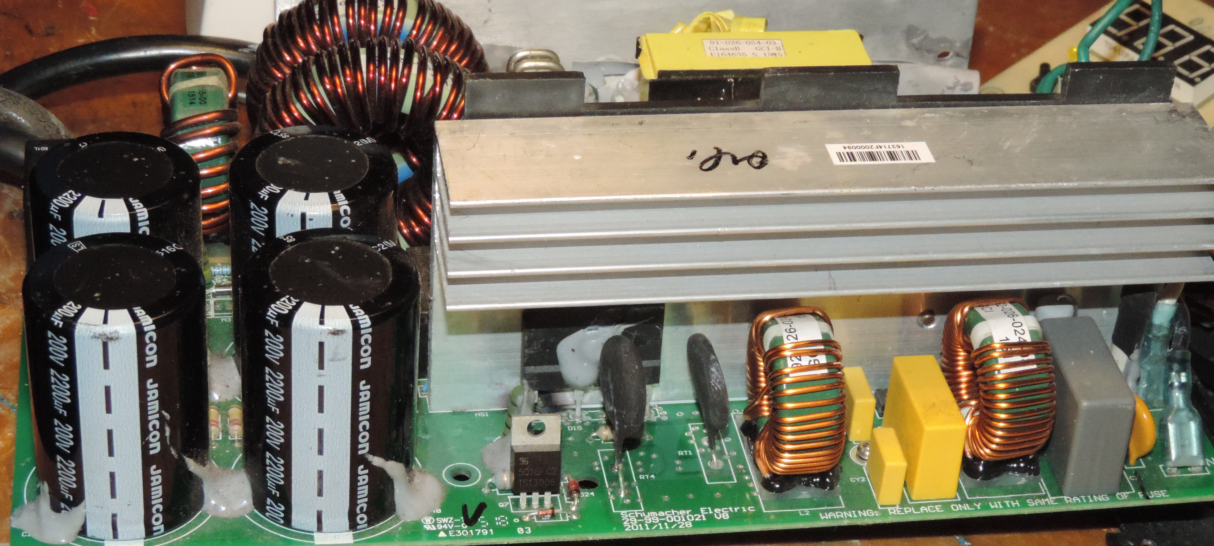

                    70 amp output.
                    I included the pic under the heat sink.
                    I see 168v dc out from the rectifier.
                    I have reviewed the two issues you highlighted in the pics.
                    For the first pic, the solder joint is fine, it's just the lighting.
                    For the second pic, overheat issue, I cleaned up the spot and there is continuity between the joint and the trace.

                      OK, I see black carbon spit? out of the bridge rectifier D15 on the heatsink. But you measure 168VDC so it's working. Hmmm.
                      I think Q7 TS13005 provides a low voltage for the control IC to start up. I would expect low voltage on its emitter, something like whatever zener D24 is rated for, let's say 15VDC. (168V on the collector tab).
                      Be careful with this board, it's got massive primary caps 8,800uF total can bite if tghey have stray charge. The 220k's should discharge them slowly.

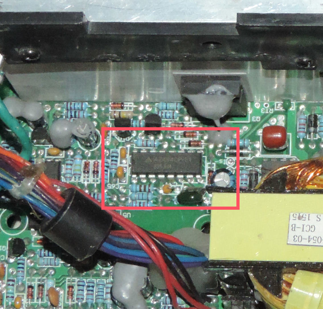

                            That chip is AZ494CP (on the back side of the large heatsink, right (see pic) ?)
                            Chip voltages:
                            1: 1.7 16: 1.7
                            2: 3.5 15: 3.4
                            3: 0 14: 3.6
                            4: .2 13: 3.6
                            5: 1 12: 4.7 (Vcc)
                            6: 2 11: 4.7
                            7: Gnd 10: 3.5
                            8 4.7 9: 0

                              The PWM IC AZ494 does not have enough supply voltage, it should be 12-15V on pin 12 VCC and you measure only 4.7V, I think that power comes from the TS13005.
                              Hard to tell at this point if the rail is overloaded and has sagged down, or the startup regulator is just weak and can't supply enough. The pics need more light and less blurrrrrrr.
                              PWM output E1 Pin 9 I think should not be 0V, so I would look downstream at the gate driver to see if a transistor or power mosfet has shorted.
                              How does Q3 and Q4 (on the heatsink) look for GDS resistances? What is the little DIP-8 part number? It's got a delicate sensor going on top of it.
                              I have seen people use a 9V battery or external PSU to (only) power the SMPS IC to see what gets hot or smokes. No mains to the board though- just powering the IC ans looking to see if the SMPS section is drawing too much current or not.
