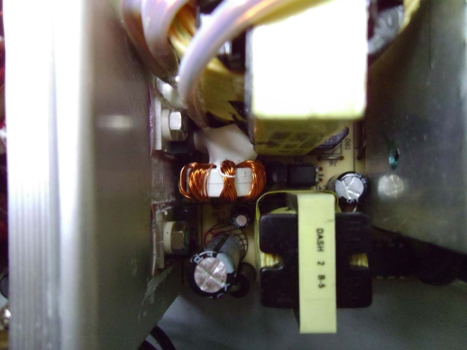

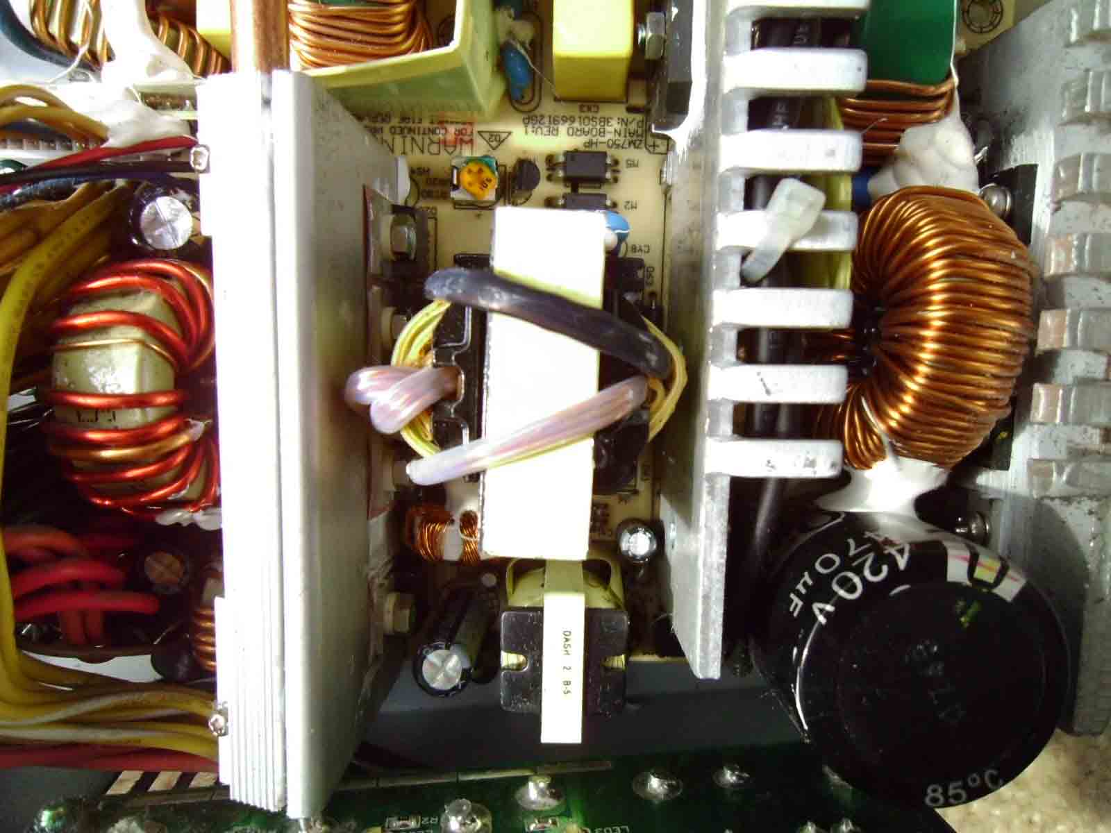

    Got this with fault "doesn't deliver enough power anymore to boot a system"
    Through the fan blades, spotted a tiny capacitor looking a bit bloated
    Opened for closer inspection, found a 100uf 25v Capxon well past its best-before date
    Replaced the Capxon with a Rubycon YXG recycled from (probably) a deceased motherboard
    The Rubycon measured 0.13 on my ESR meter, versus 28 for the Capxon
    Pictures show Before and After
    Zalman boots a system now, didn't try it before the capacitor replacement
    Didn't consider replacing other Capxon - they appeared OK - enough of a challenge doing the one I did

    Re: Thanks Capxon, for my Zalman ZM750-HP
    You will have a repeat customer, then .
      This one's mine now, and it'll lead a pretty easy life
      Was a swine to take apart sufficient to get at the bottom of the main PCB
      Didn't fancy going any further, not to mention I don't have a professional's stock of caps
